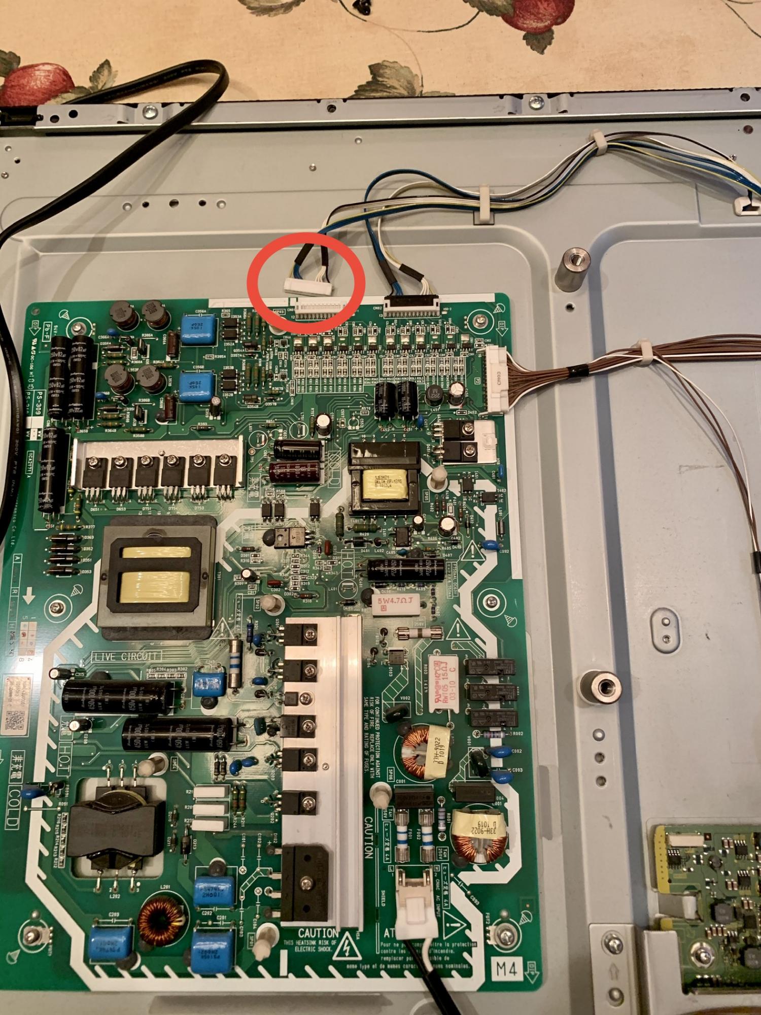

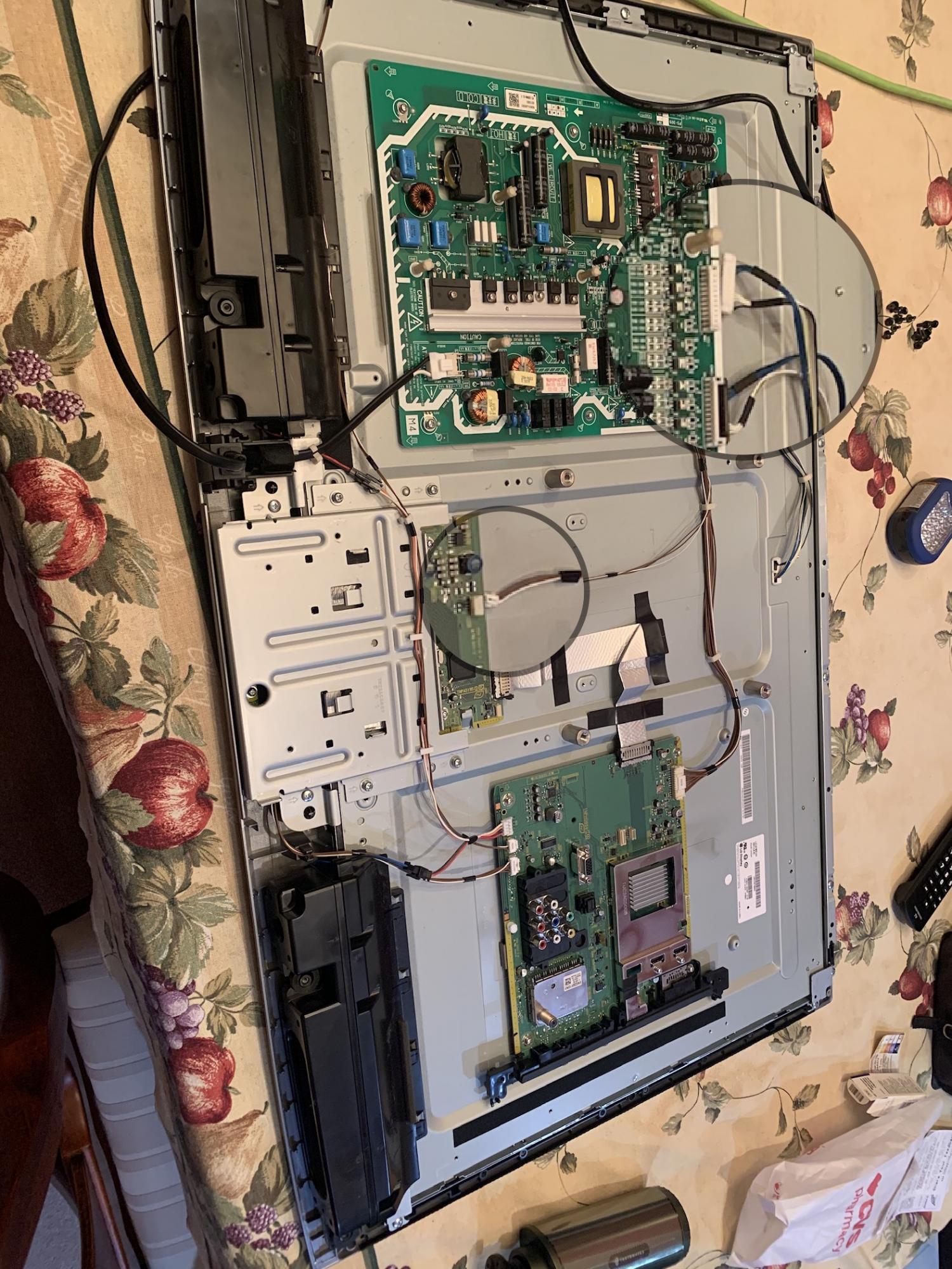

    Picked up a Panasonic TC-L37D2 off the curb. When turned on it powers up and the backlights flash then it goes into shutdown mode with 10 blinks. If I unplug the white connector on the power board that goes into the back of the panel (picture provided) backlights light up bright for a few seconds then get dimmer, but the set stays on.

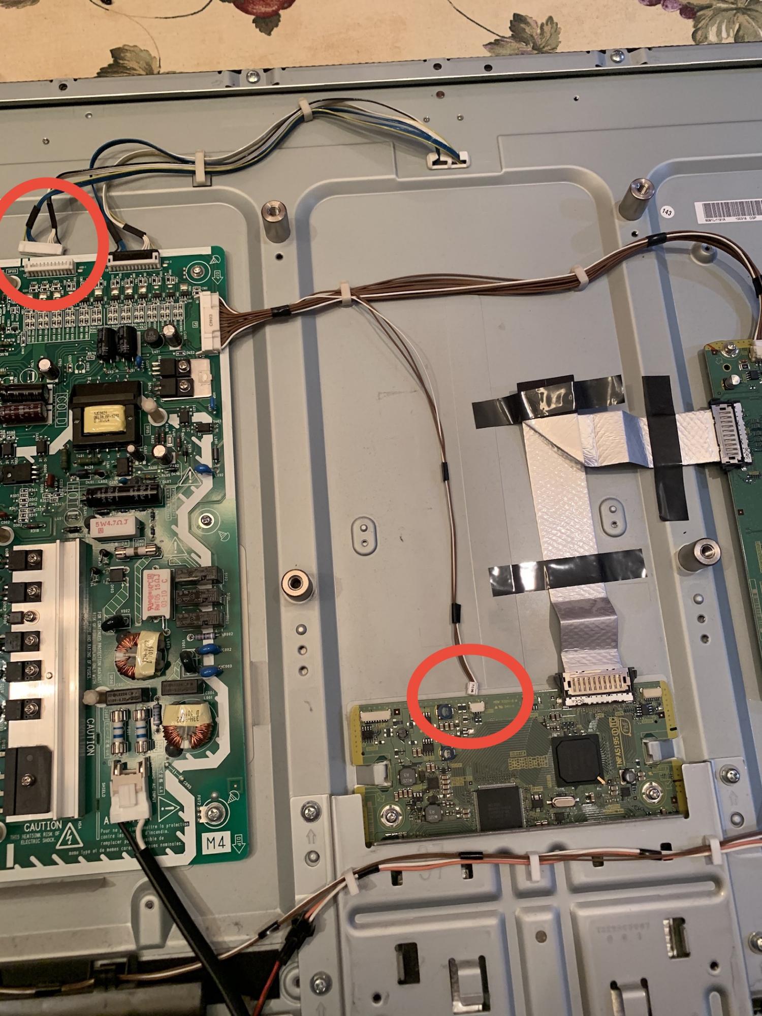

    If I leave the white connector unplugged and also unplug the small connector going to t-con board (picture provided) the backlights come on and stay bright.
    In both scenarios I get a picture with what appears to be some of the colors missing. Scenario 1 gives dimmer picture and scenario 2 gives brighter picture but both have missing colors.
    Any thoughts would be helpful. I am not versed enough to repair a board but can change a board if I know what the problem is. I can use a multimeter with some limitations.

    I googled and found your service manual. They usually contain troubleshooting steps for the blink code.

      I found a service manual and did some testing with a multi tester. I found the white connector CN01 that I unplugged to keep the backlight on is not receiving correct voltage. Pins 1 and 12 are getting 172V. The remaining pins 3, 4, 5, 8, 9 and 10 should get 79v but are showing only 1.4v. When plugged in it causes a shutdown. Does this mean the inverter that powers the LEDs is bad?
      The manual also says 10 blinks points to ZWEI2 sos on t con board.

        Pins 1 & 12 are the LED supply voltage, 172v is likely correct, the other pins are the led string return lines, I would check the return line voltage on each of the 6 strings (with the led's connected) as the tv is turned on (and before the protection cuts in) I suspect one of the lines will check different indicating an open led string.

          Check the return lines with ref to circuit ground.

            I checked all the pins on CN01 and CN02 when tv powered up and before shut down. Pins 1 & 13 on CN01 and pins 1 & 12 on CN02 were 174v. All others were 158v. I didn’t see one that gave a different reading. The manual says they should read 79v.

              Are you testing the return lines using circuit Ground (chassis) as ref ground for the meter's Black probe as suggested?

                If you are asking if I'm grounding the black probe to the television chassis, yes I am.
