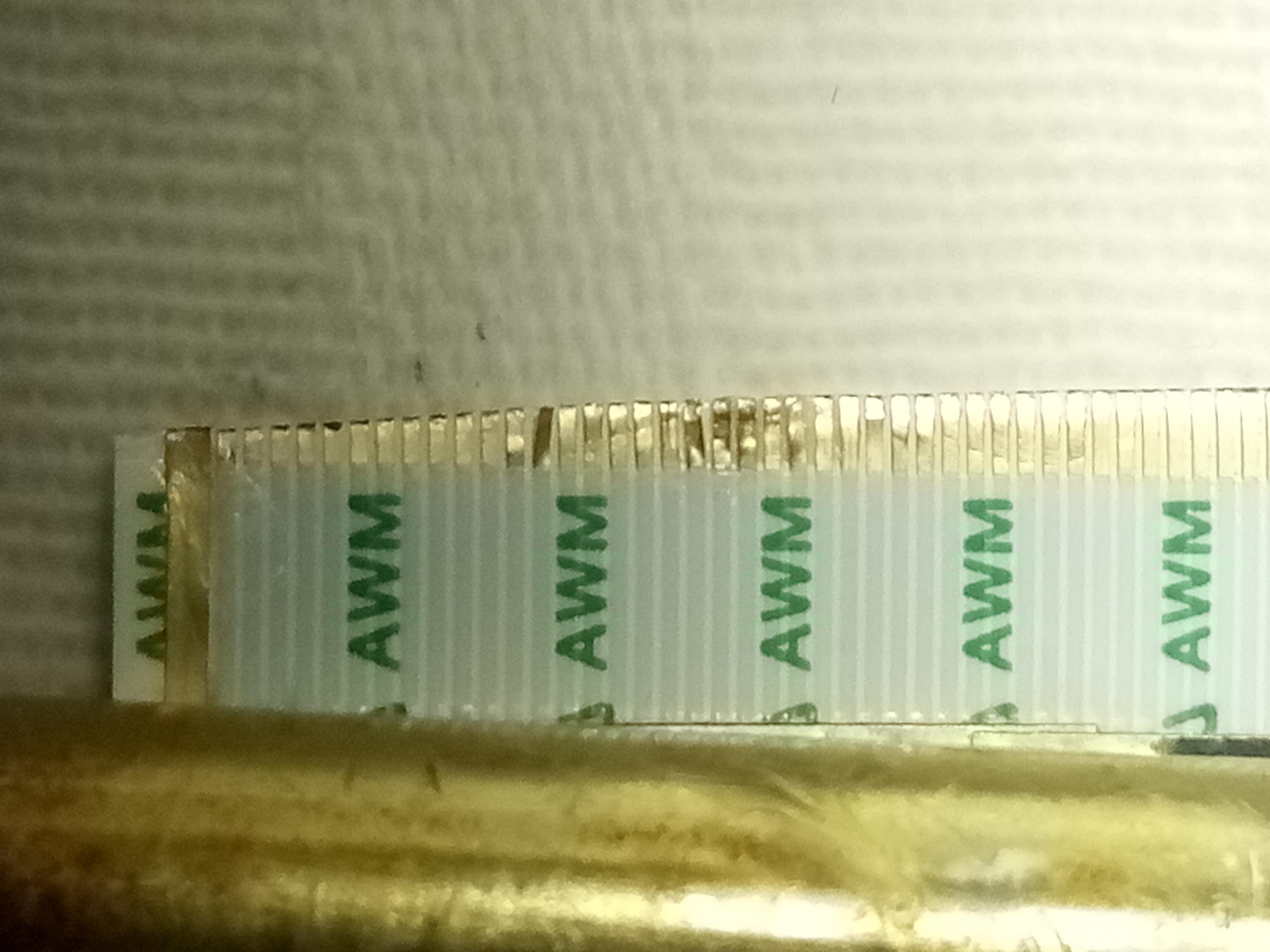

                        looks like the end of the road for this one,at least i found the fault .
                        one of the four tcon foils is faulty
                        to remove both ends is major strip down ,
                        once done if i flexed gently the tv would trip to 5 blinks .
                        i removed the faulty foil and the contacts had lifted and were shorting .
                        trying to find a replacement is nigh on impossible ive kept some foils from scrap tvs but none are suitable

                            yes tried that but all contacts lifted from plastic so when slid in they s/c ,
                            tried to s/glue with coctail stick and head up magnifier.
                            so annoying as these things probably cost peanuts to manufacture

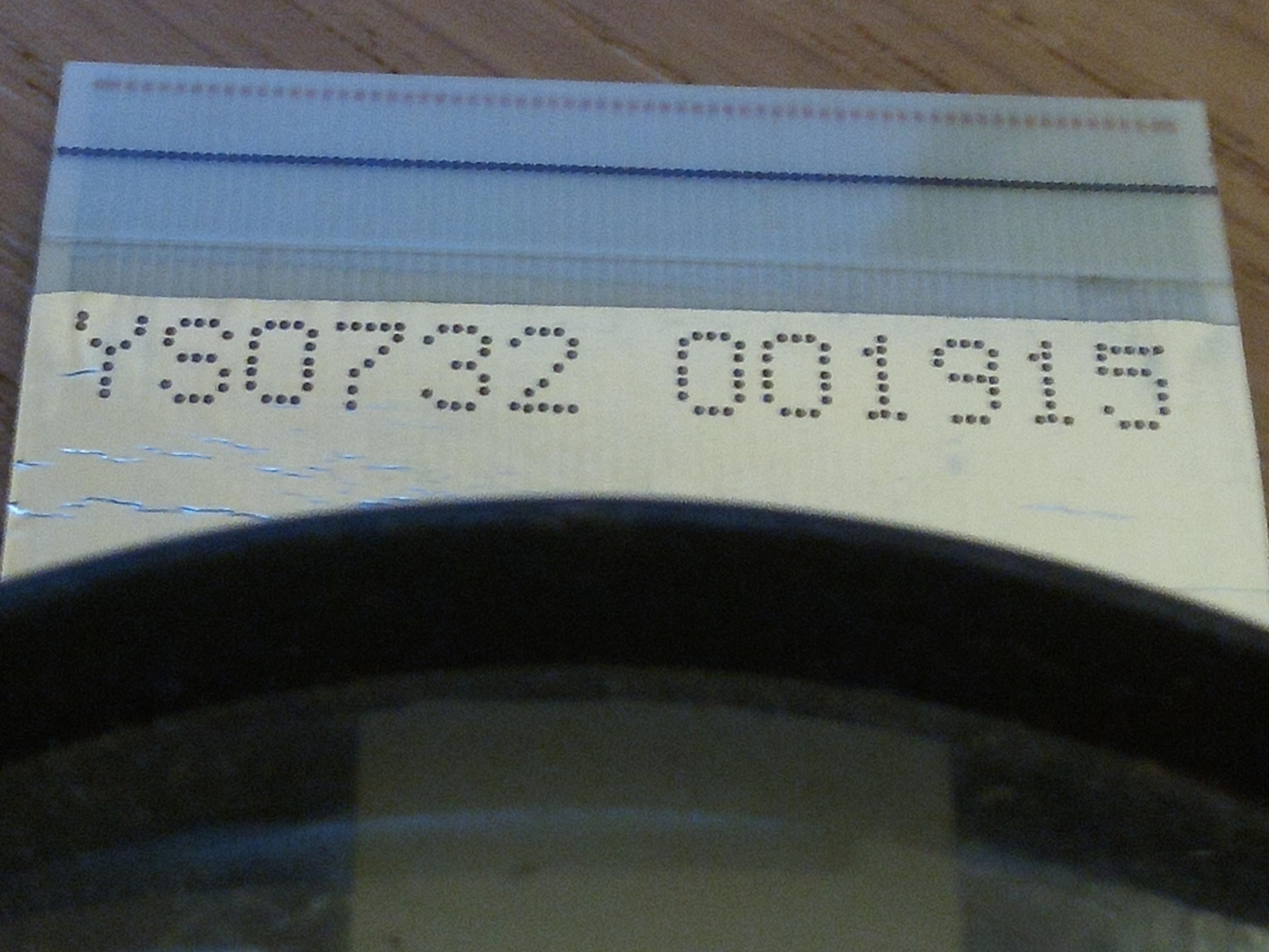

                              well well well managed to find replacement foil ,
                              bingo rewarded with great pic.
                              it lasted 6 seconds ,
                              with scart i/p sound also cut out after 6 seconds now i get 5 blinks
                              removed logic board and t con tested all s mount caps with esr meter measured all vcc supplies for low resistance to deck all ok
                              i think the micro is entering protect mode
                              its nothing to do with backlight
                              ive studied cct ,but cant a find cct for the t con board in the manual
                              t con number:404652hcc 8lv1.8
