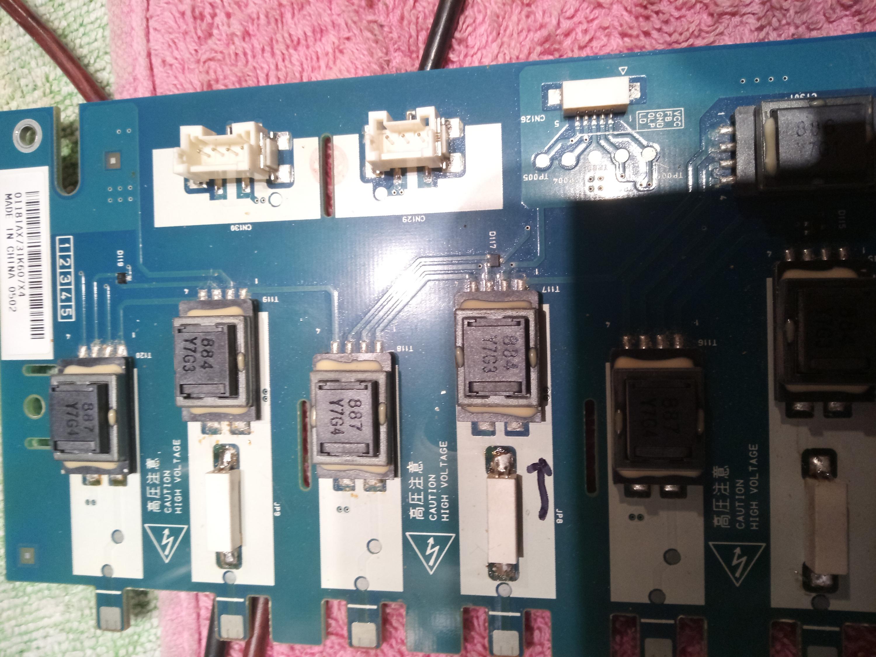

    sony kdl 40x 3500 no backlights

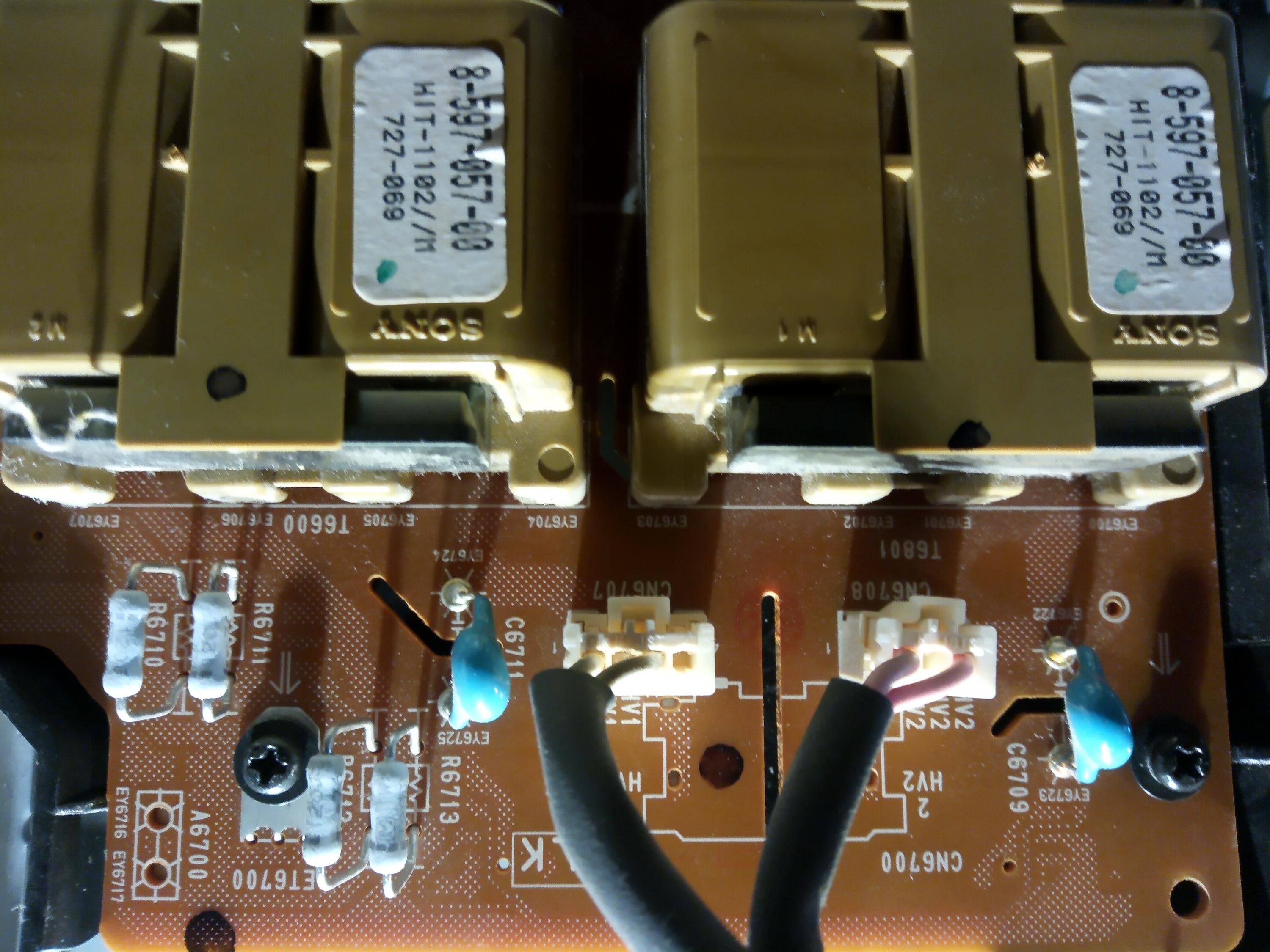

    this oldie works fine , good pic and sound for its age
    but has intermittent backlights at switch on
    led turns from red to green
    when the fault is present there is sound via scart

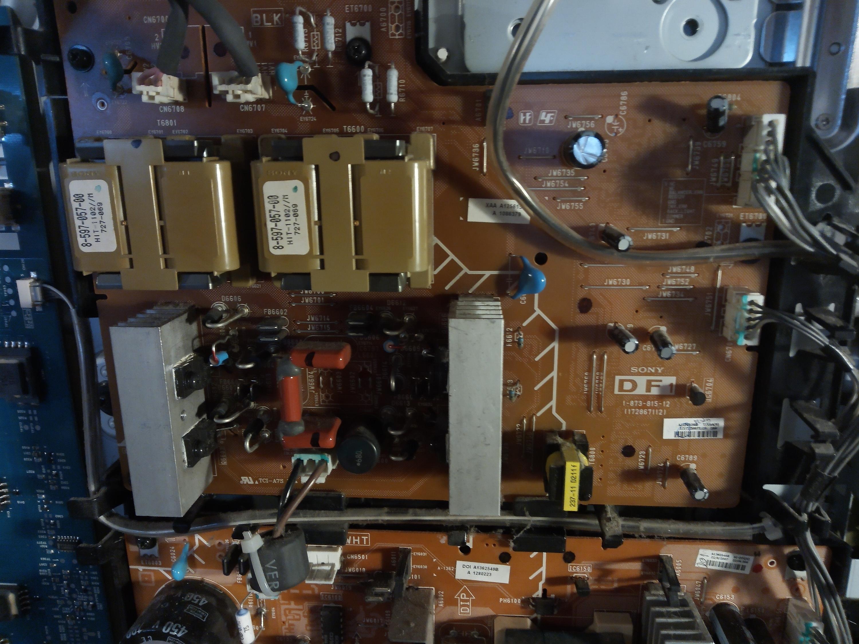

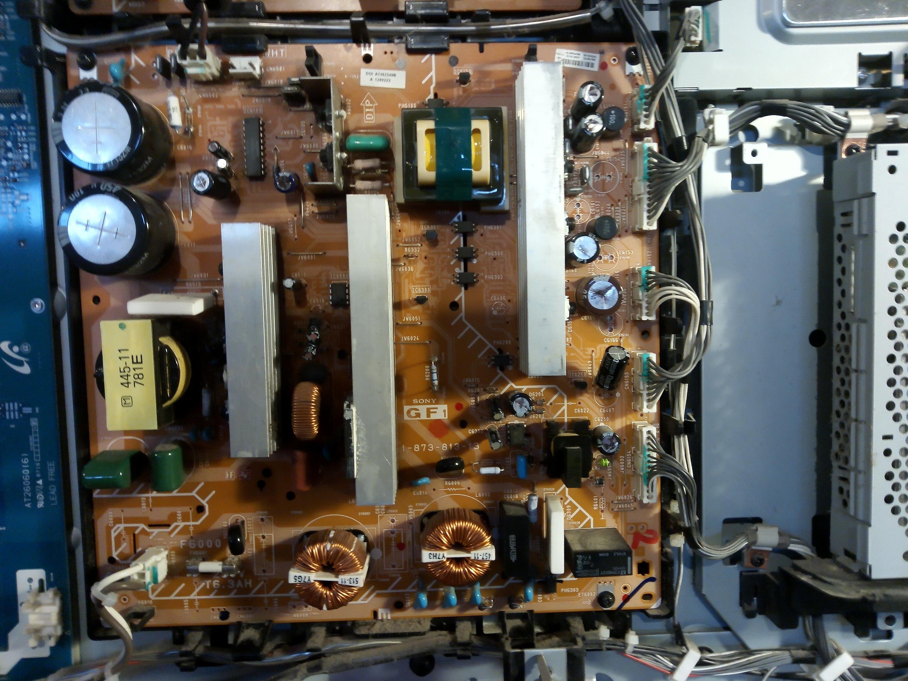

    ive replaced caps in psu which had poor esr readings and soldered up
    then i soldered up the DF1 board above the psu ,i then removed the cover on the inverter board ,tested the small tx s and compared the resistances in case one was causing the backlight to shut off .
    this model uses ccfl and inverter board.(sony call it ballancer board )
    from the service manual the voltage on the pin marked inverter error reads 0volts ,it should be 3.1v .
    the problem is most of the time it comes on as normal
    when the fault is there all the secondary supplies from psu are good
    has anyone had experience of these early models that you could share please
    the inverter board is ssb400wa20s also used in some samsung models

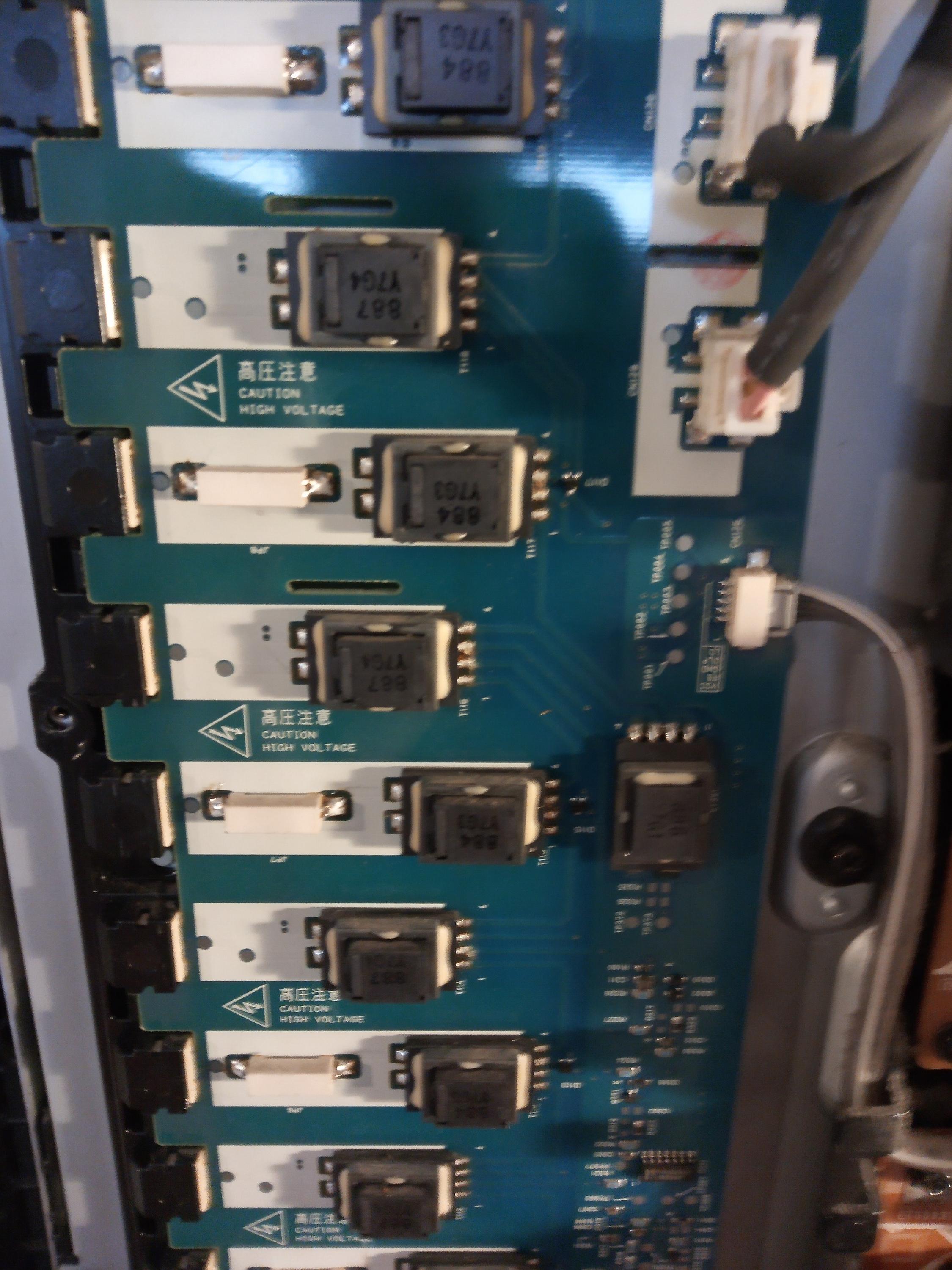

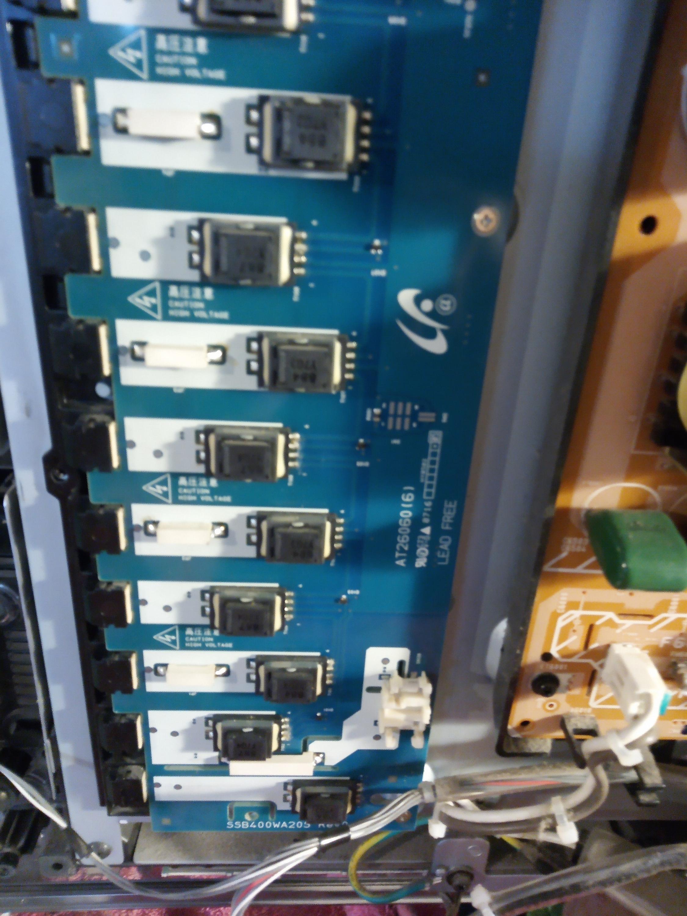

      i cant measure any small a/c volts on the i/p of any of the tx s on inverter board
      according to a youtube vid i watched:
      Troubleshooting LCD Backlight Failure Samsung LNT-4066 by norcal715 .
      i should measure .2v ac on pin 2 of each tx
      could it be a supply missing?
      from df1 board (above the psu board )
      what do you think?
      by the way i tried to remove the inverter board from tv but its solid stuck ,
      is this normal,do you have to prise them out ?

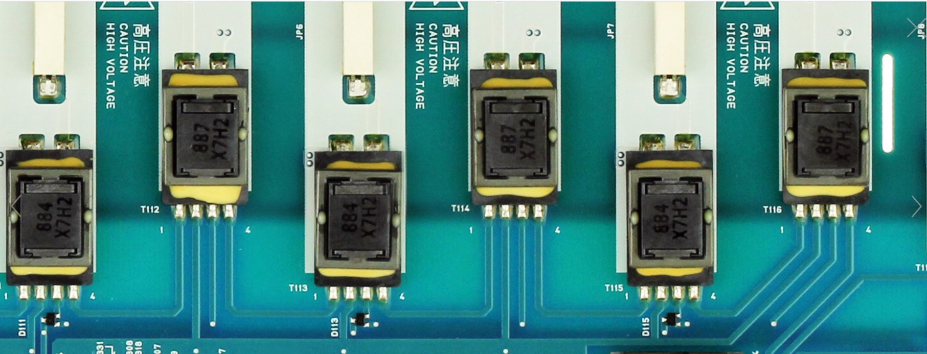

                Looking at the photo from shopjimmy it appears that it's pin No 3 of each transformer that connects the lamp error voltage to the diodes

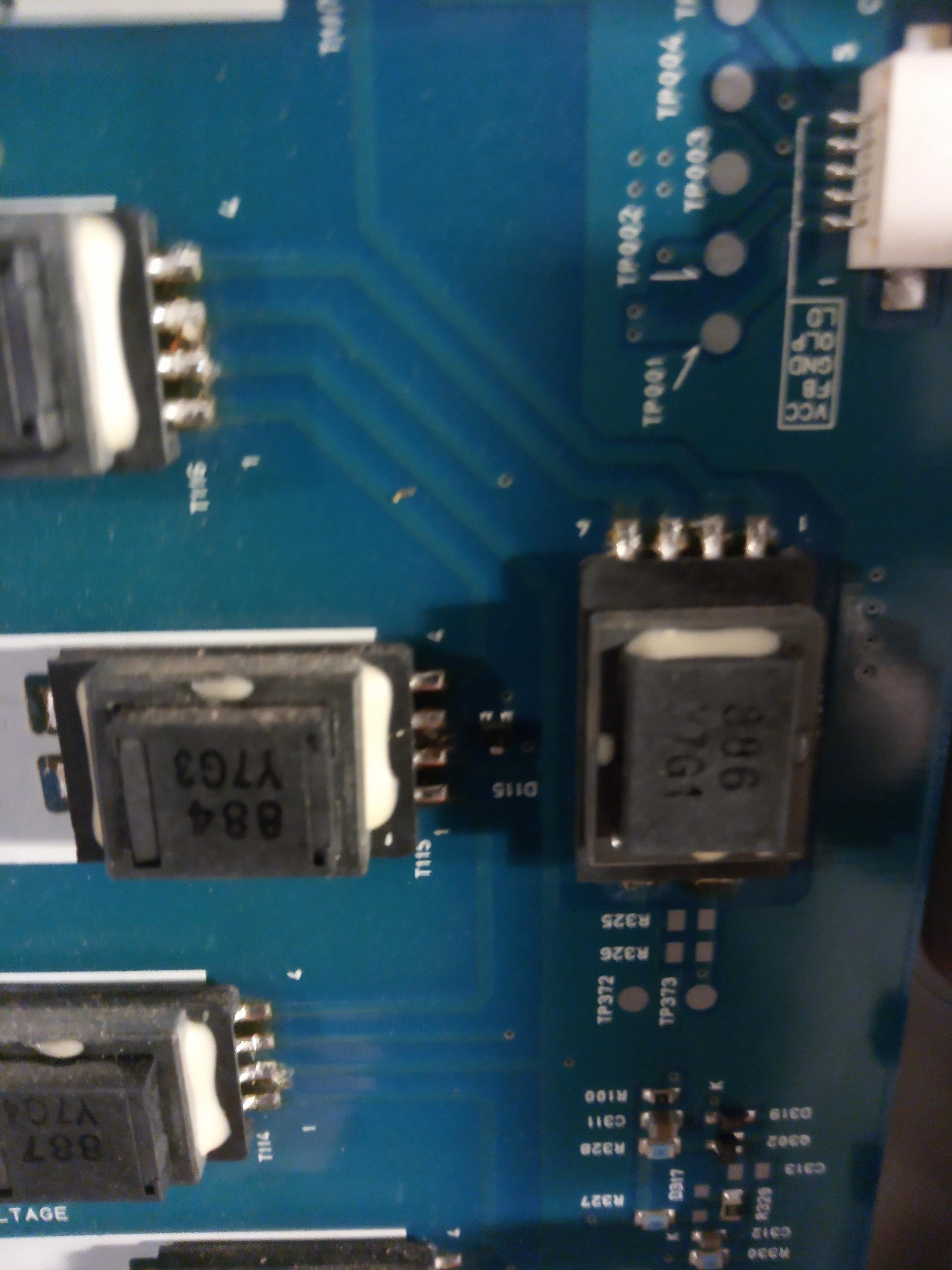

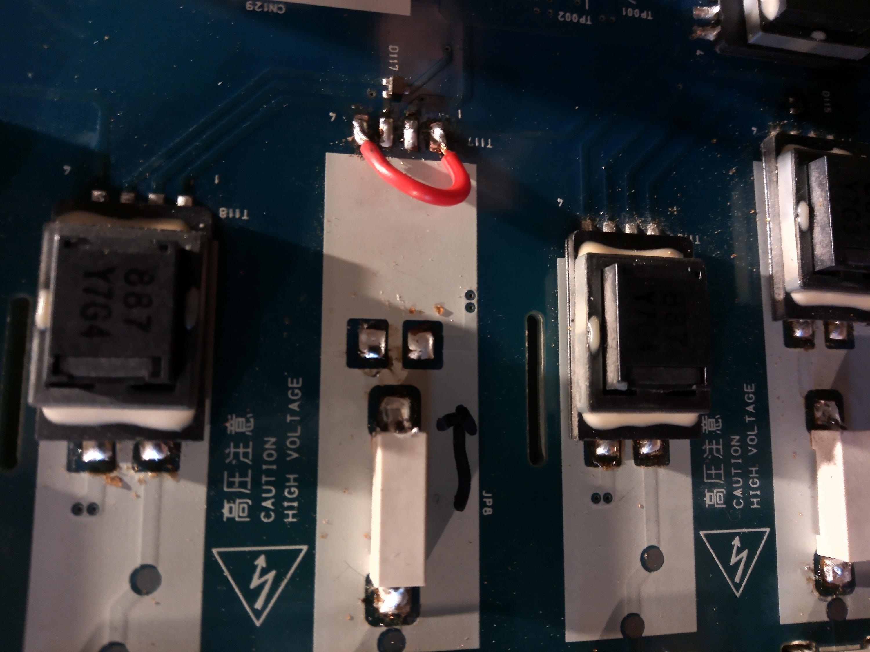

                      i have removed the inverter board ,and its clear one of the tx has been under stress as the board is discoloured see pic
                      its the 4th one along marked with arrow in pic .
                      im going to remove it and link it out just for test purposes ,
                      to see if the fault clears .
                      although im not totally convinced ,because when the fault is present theres no volts at all on the primary side of the tx s
                      i suspect the ccfl its connected to, is drawing more current than the rest.
                      the tx measures exactly the same as the others.
                      sorry about the shadow on the pics

                        Maybe check D117, see how it compares to the others.

                              d117 tested good ,same as all the other diodes on each pair of tx s

                                  i set the b/l to 50%.
                                  i then removed the tx that was causing the ballancer board to be discoloured
                                  i linked out pin 1 and 4 and it has not yet failed to start up YET
                                  i keep trying it every 4 hours ,i intend to refit the tx and see if fault returns
                                  i will post results thanks

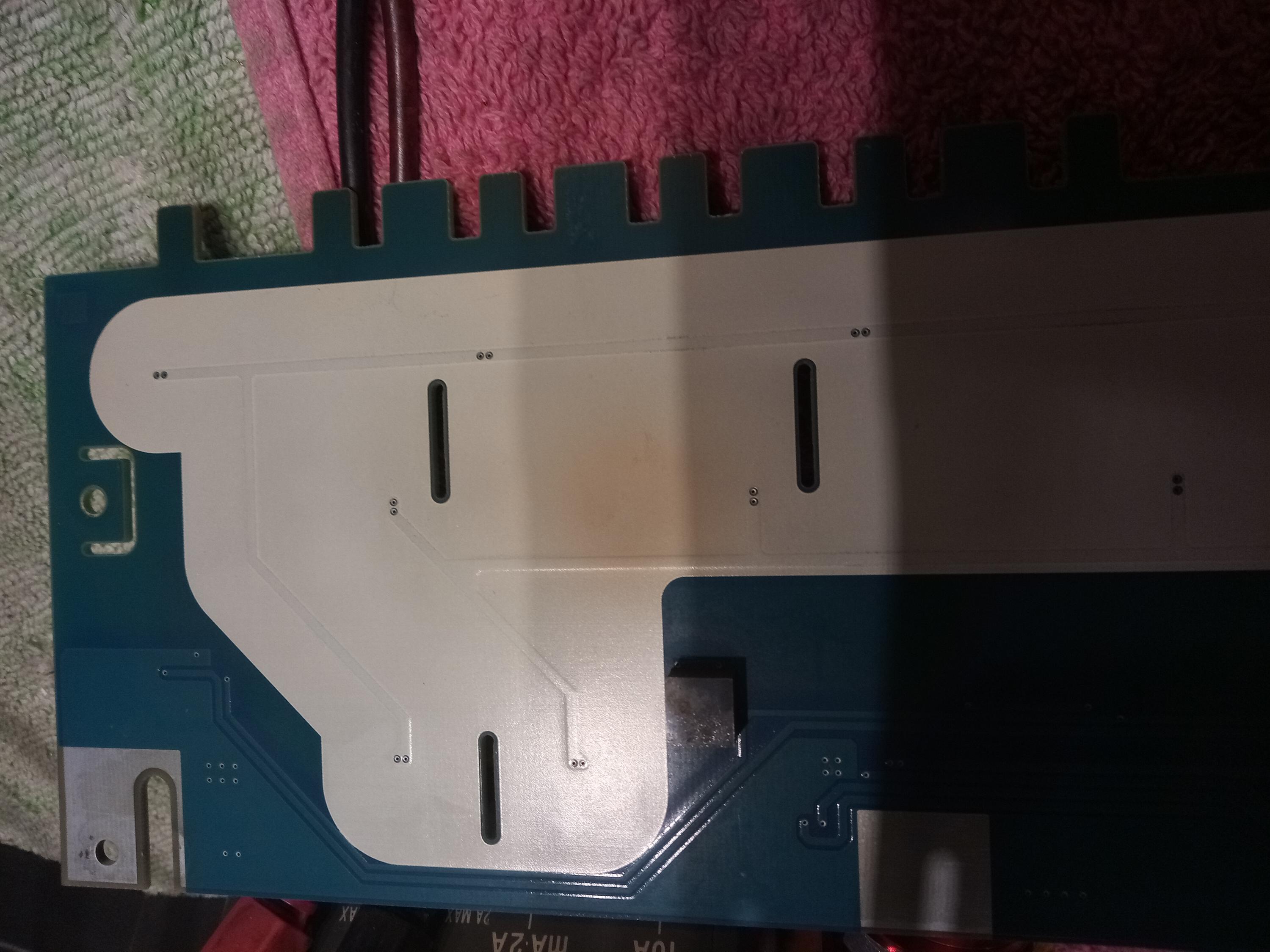

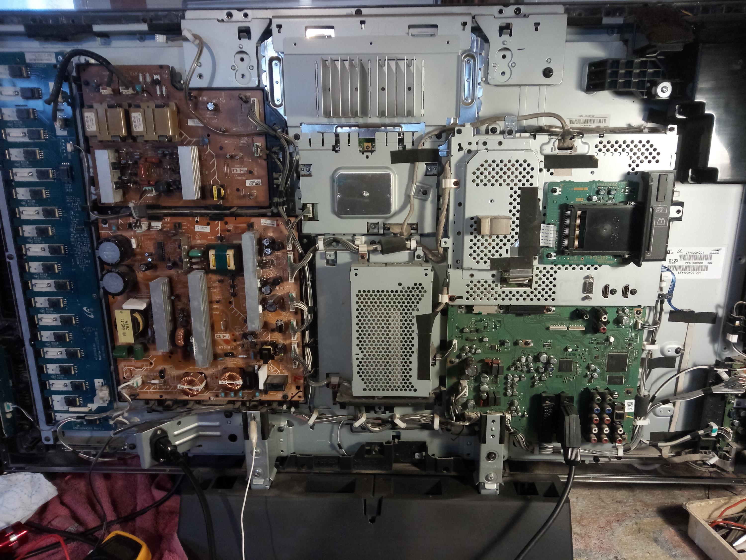

                                      Is the section of the DF1 board where the CN6708 is has dark marking due to heat or that is the shadow?
                                      • jimbofz
                                        • Apr 2013
                                        • 539
                                        • uk
                                        Re: sony kdl 40x 3500 no backlights
                                        the panel pic sadly was just a shadow . see aditional pics ,
                                        ive left the link on for the time being .
                                        thanks for the manuals .
                                        a strange thing this morning ,
                                        although the tv came on as if there was no problem,

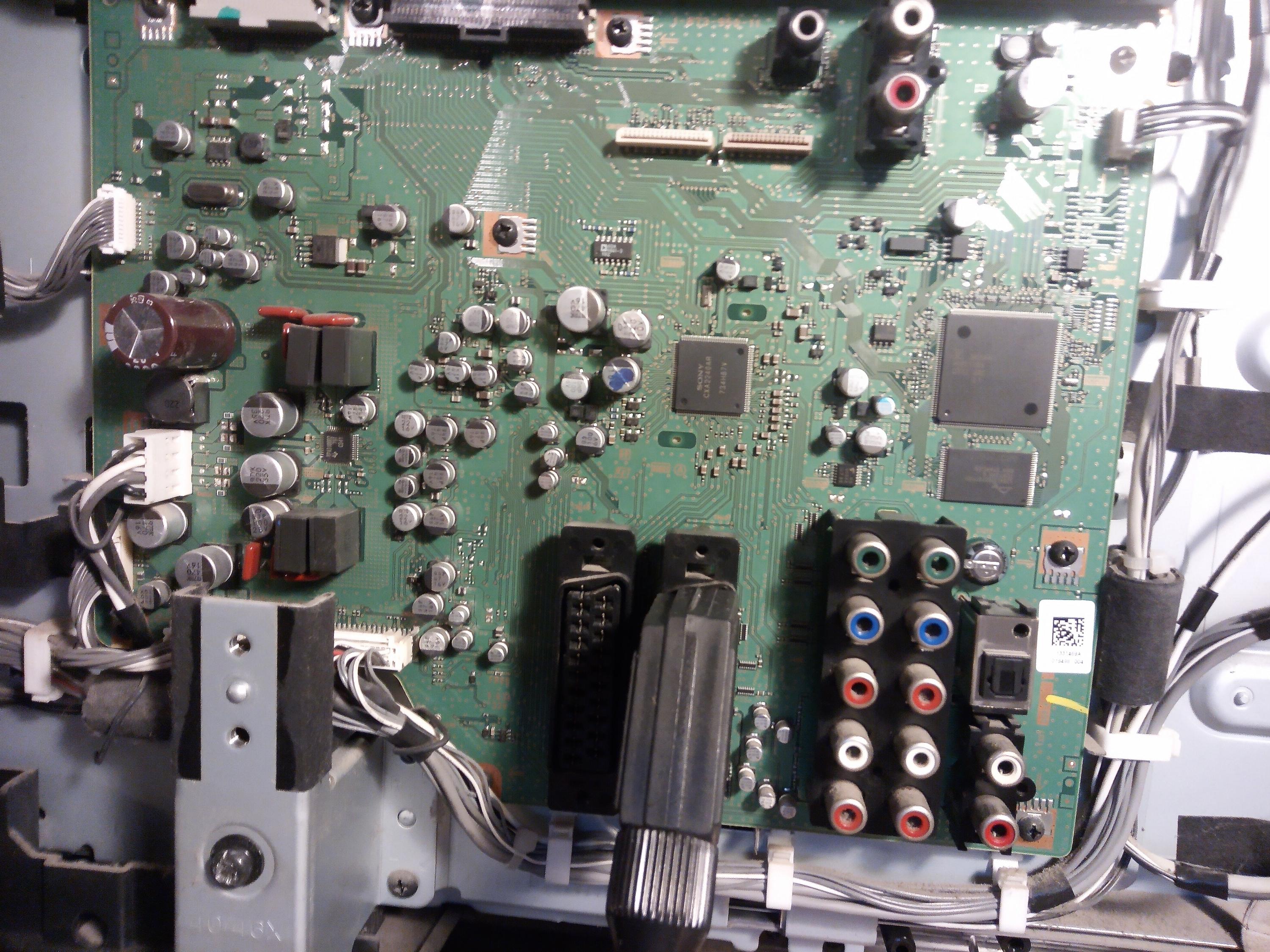

                                        when i used the sby button on TV the pic and sound went off but i still had a feint raster ,ie the backlight stayed on .when faultfinding for no backlight i always use a scart i/p so i can confirm sound is present .it saves confusion .so the sound went off as did the pic info .
                                        when following the flowchart for backlight faultfinding , (i know they can sometimes lead you up the garden path)
                                        if 3.3v missing at cn6153 pin 3 suspect au board (main board)
                                        perhaps i should turn my attention to the main board ? any thaughts please
