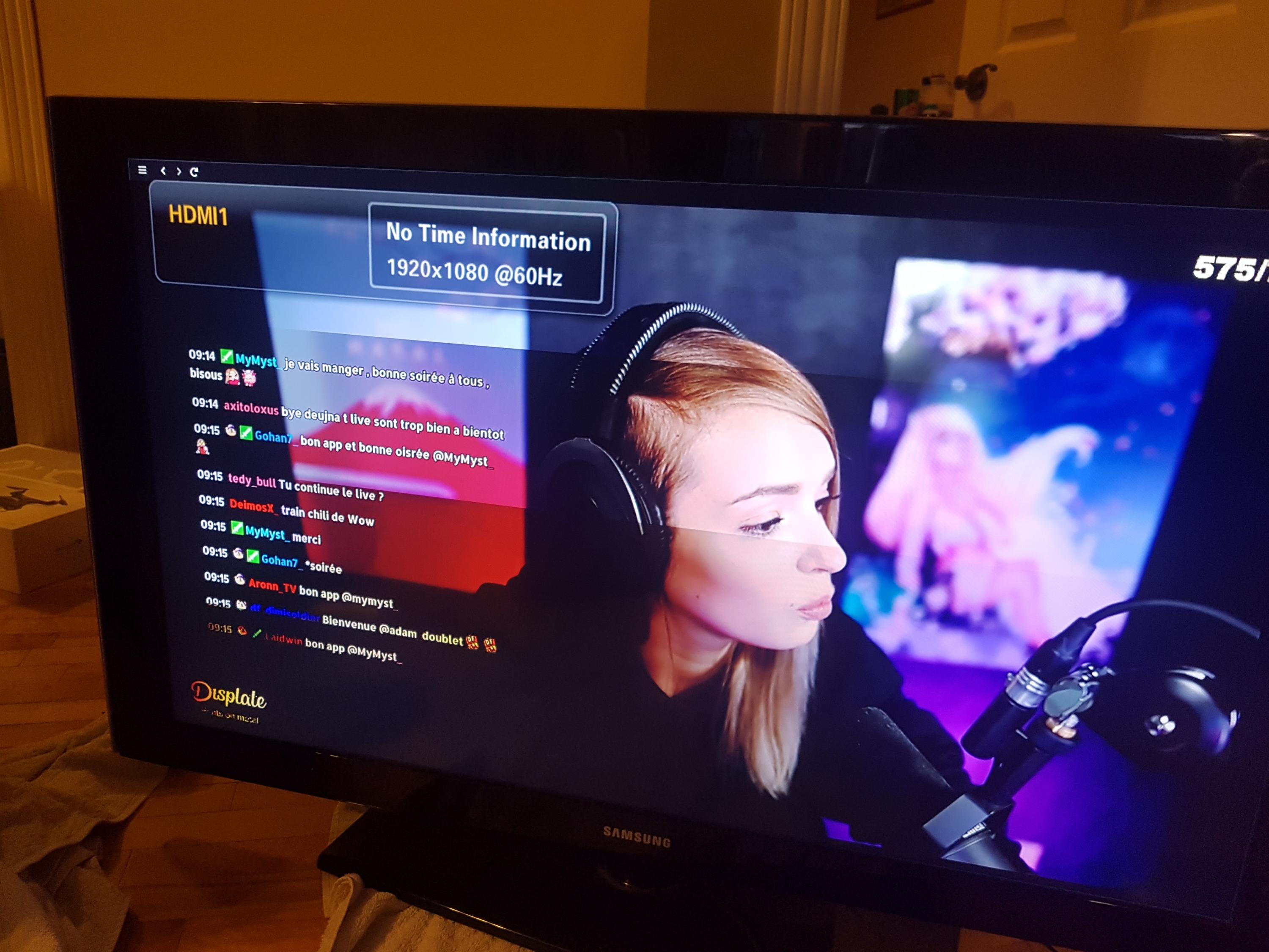

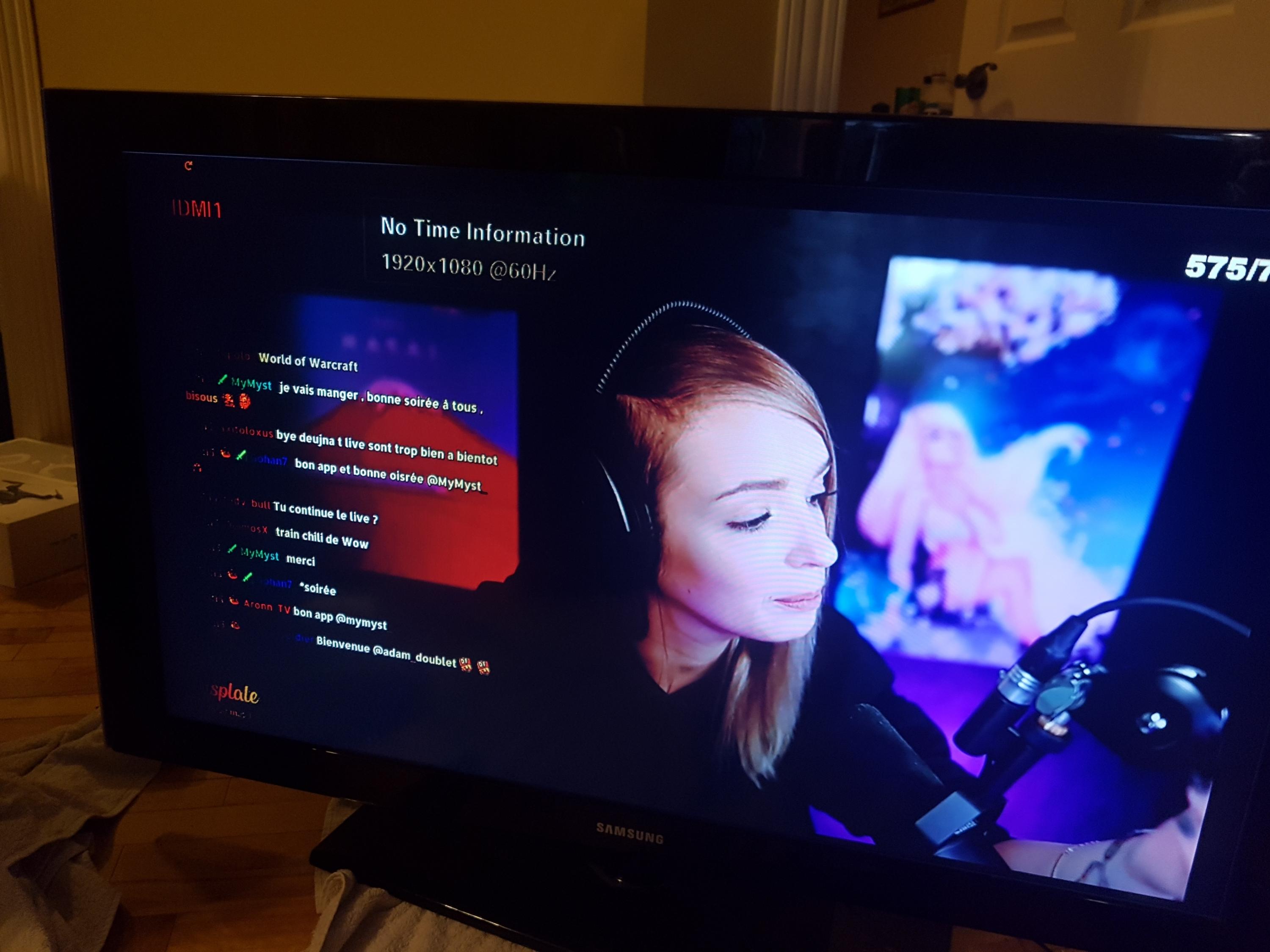

    I have a Samsung LN46A530 TV with an issue at power on. At first, the TV was powering on/off and clicking. I change 3 bad caps on the PSU and the issue was fix.
    But, at power on a part of the screen is very dark and change progressively to be OK after 3 to 10 sec. I checked the connection at the t-con board and all seem to be ok.
    Is someone have any idea of the source of the problem?

      I don't think the problem come from the backlight.
      With a video it will be easier
      https://www.dropbox.com/s/jcxfcvpb52...35.12.mp4?dl=0
      Thank you
        Re: Samsung LN46A530 image issue when power on
        Panel is bad on that side, the side tabs voltage need to be isolated with tape cut-off method or they need to be removed if possible.
        https://www.badcaps.net/forum/showthread.php?t=87395 This is a TV I had and the symptom is very similar.
