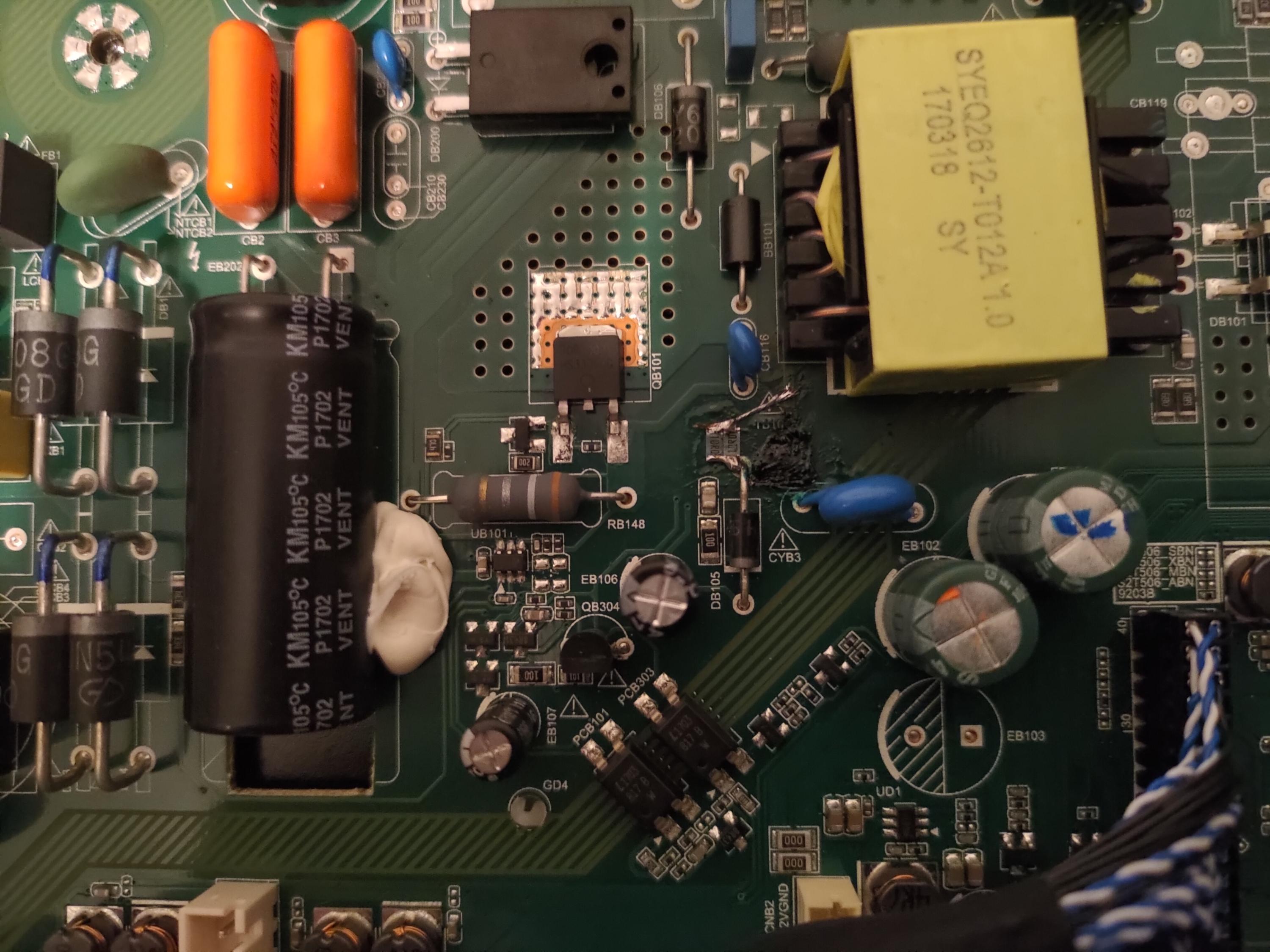

    hello masters,
    need some help again
    got a polaroid (cry) TV to fix. stanby led ok, turn green on power but goes red and the tv not start.
    the power board is a chinese universal TPS.506.PC821 board
    seems already have read this issue but i want to learn more !!! yeah !!
    so the RB114 and RB115 resistor are burn (realy burn), seems to be an overcurent issue but not understand what could be the culprit, so first i have changed this two resitors, and the 2 new ones are dead too now.
    i understand that the tv can't start cause 12V can't be created
    but why this resistors burn ? can you help me ?

    Re: Power board TP.S506.PC821 RB114 and RB115 burn
    Check the diode DB105 using your meter in diode mode and the resistance across EB106 with it set to ohms.
        RB114 and RB115 no way to be defect, however the value not written but they are under load of GND to transformer so they could be turn to black color .. the transformer self could have fuse between pins 9 & 8
          news :
          just cut the connection between rb114/RB115 and TB101.
          now i have a stable -2V on RB114/115 (side of TB101), the tv goes red blinking led continuously and no smoke;
          at this point it seems i'm wrong, primary is good right ?
          can a defective secondary section could cause a resistor burning at primary ? don't know, please teach me !
            Originally posted by disorder
            hello
            db105 is good : 520 in one way, OL in the other
            EB106 : 16Mohm (black probe on minus, red probe on positiv)
            so they are ok
            maybe i coulb be VCC1 to high but not understand on the schematics where it came from and what value it is normaly
            VCC2 = 17.7V which is given on the diagram and is obtainsed from VCC1 through transistor QB304.
            You haven't said what the value of the two resistors were?
            Does EB106 have a voltage rating written on it?
              news :
              common man... are you make exam here?? RB114 & RB115 as i stated no way to be defect...
              why you cut line.. you dont have Iron to lift one legs of parts or take the T101 out from circuit.. use any chinese power supply for LCD projector most had 12 &19V your tv will work.. if main boards okay..... no need to write any more to this threat
                RB114 & RB115 are likely low ohm resistors, around 10Ω ech or less, The initial VCC to start the ic comes from RB101 & RB102, once the ic starts (the first few pulses) A voltage is supplied from the feedback winding of TB101 pins 5 & 6, to RB114/5 rectified by DB105 and charging EB106 to around 20vdc. This is the VCC1 which keeps the ic running after startup. If the two resistors were open (unlikely) I suspect ZDB101 is shorted, this zener could be around 15 volts.
                  thank you guys
                  right, RB114 and 115 are 10ohms resistors (sorry i forgot to mentioned it)
                  i didn't understand the circuit, thought that the current came from vcc1 to TB101, but with R_J i understand that was bullshit, the current comes from tb101 to VCC1 so it is more understandable that RB114 and RB115 burn first...
                  if i have understand it right, so i have an upper consumption of current between TB101 and ub101. in diode mode i have en open line through the zdb101 and 750 with red probe on sgnd and black probe on rb110 side. but i have never really understanded of to test on zener diode.
                  when Diah says that i can switch for a 12V/19V power supply, i don't understand cause main board and power board are on the same pcb .
                  and i cut the line cause pcb is really burnt at this point, prefer put resistor in a proper place.

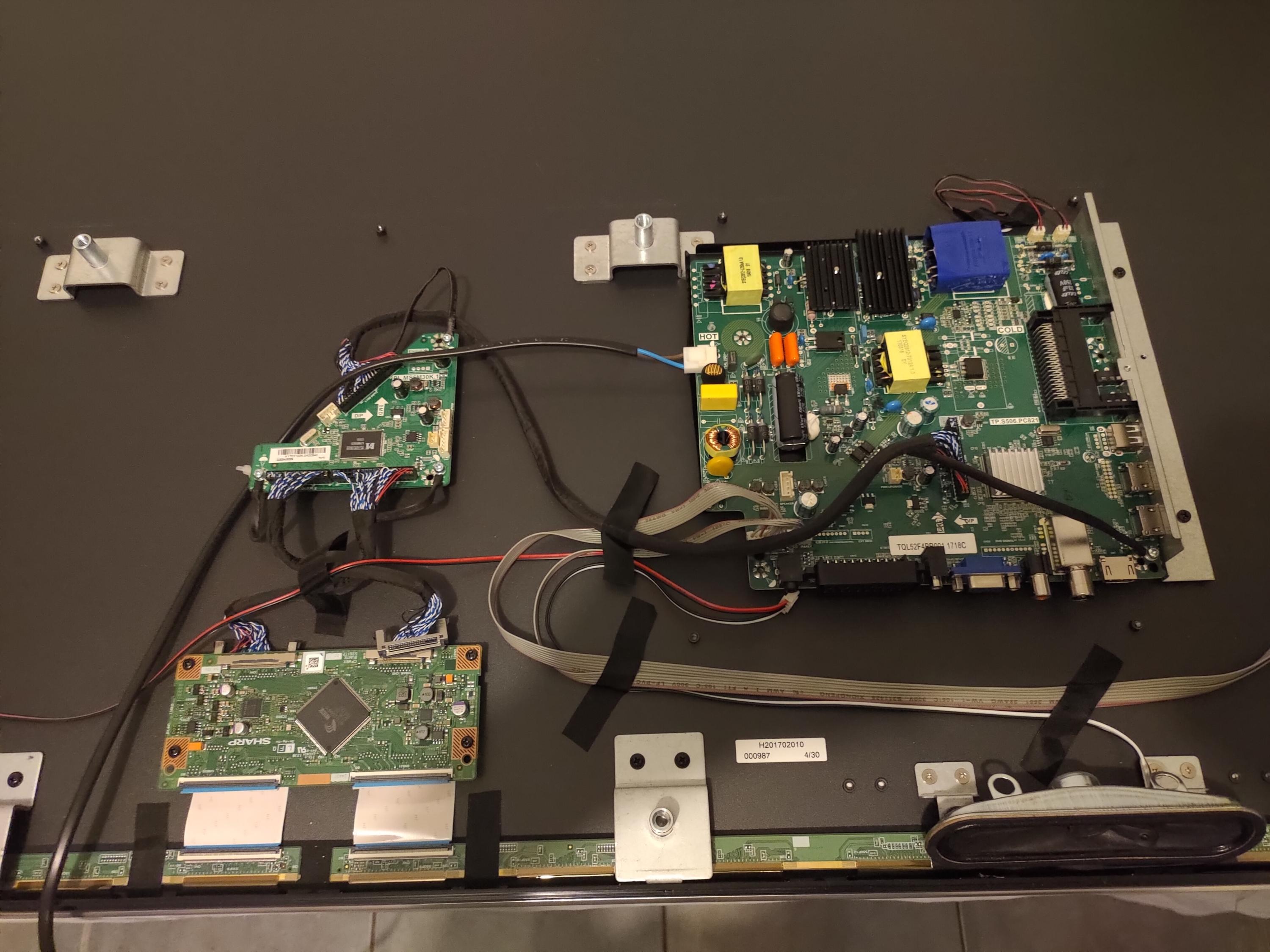

                            Where are the pictures of what we are dealing with?
                            • disorder
                              • Sep 2015
                              • 156
                              • france
                              Hello there
                              I was not at home
                              • dick_barton
                                • Aug 2015
                                • 6643
                                • Wales
                                What is the black stuff on the circuit board?
                                • disorder
                                  • Sep 2015
                                  • 156
                                  • france
                                  It is the burned area. It is for that i had recreates the circuit and vit the lines
                                  Put also solder Mask on it
                                      hello
                                      got a TP.S506.PB801 board in stock
                                      try it (only one led circuit plug cause the second is 3pins so not connected at the moment
                                      got an image but remote not works and panel button not correspond
                                      do you think i can switch the flash rom from the dead one to this ?
                                      thx
                                      • disorder
                                        • Sep 2015
                                        • 156
                                        • france
                                        hello
                                        so i tried to switch spi flash between two board
                                        now i can control the tv with the remote but i have a image problem (that i haven't with the original chip of the pb801 board (that came from a 25inch tv)
                                        the image with the pb801 board and the pc821 spi chip is that i could name "synchronisation problem" : the vertical lines are shifted one by one. so the image is unclear
                                        can you help me ?
