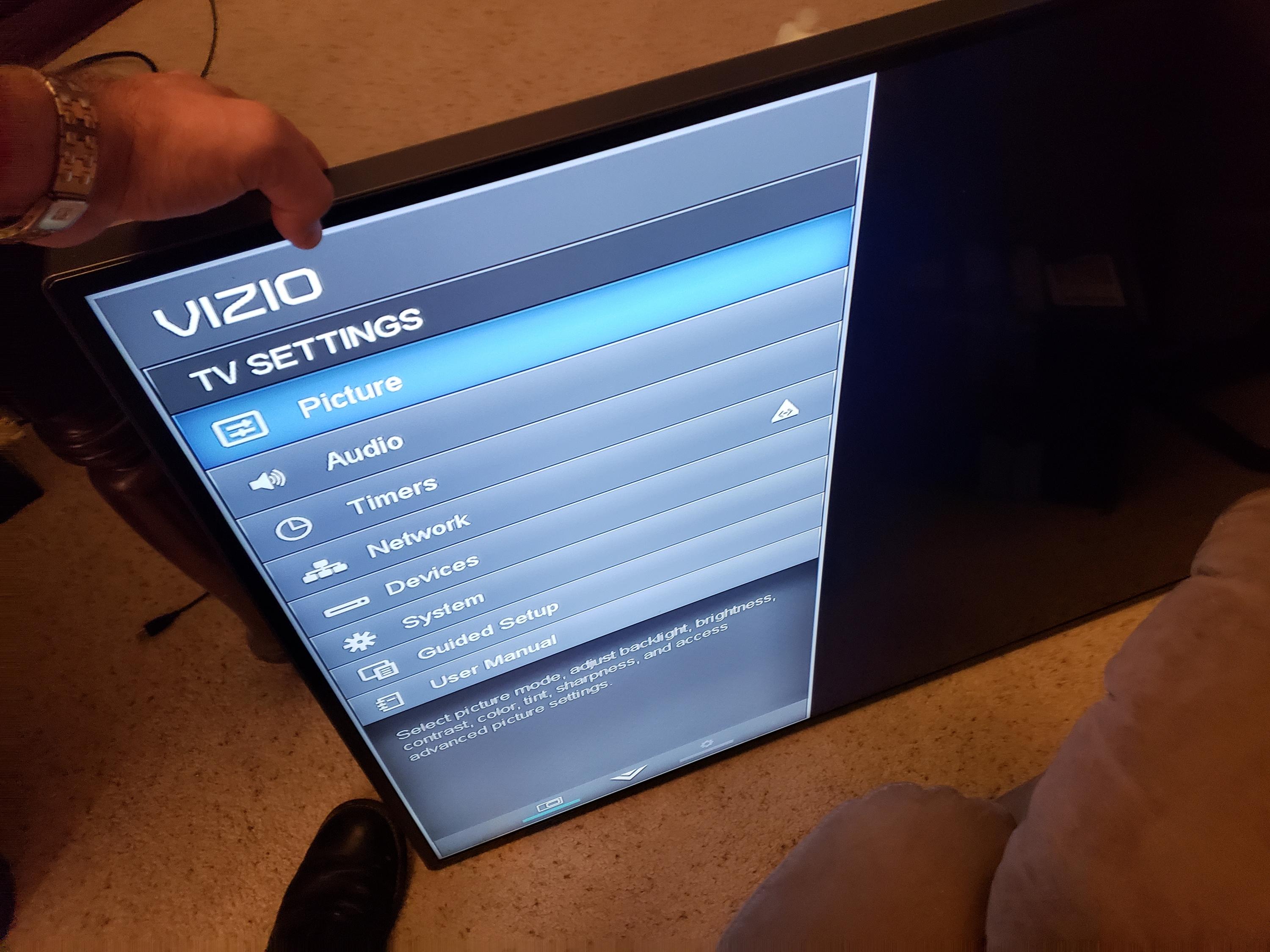

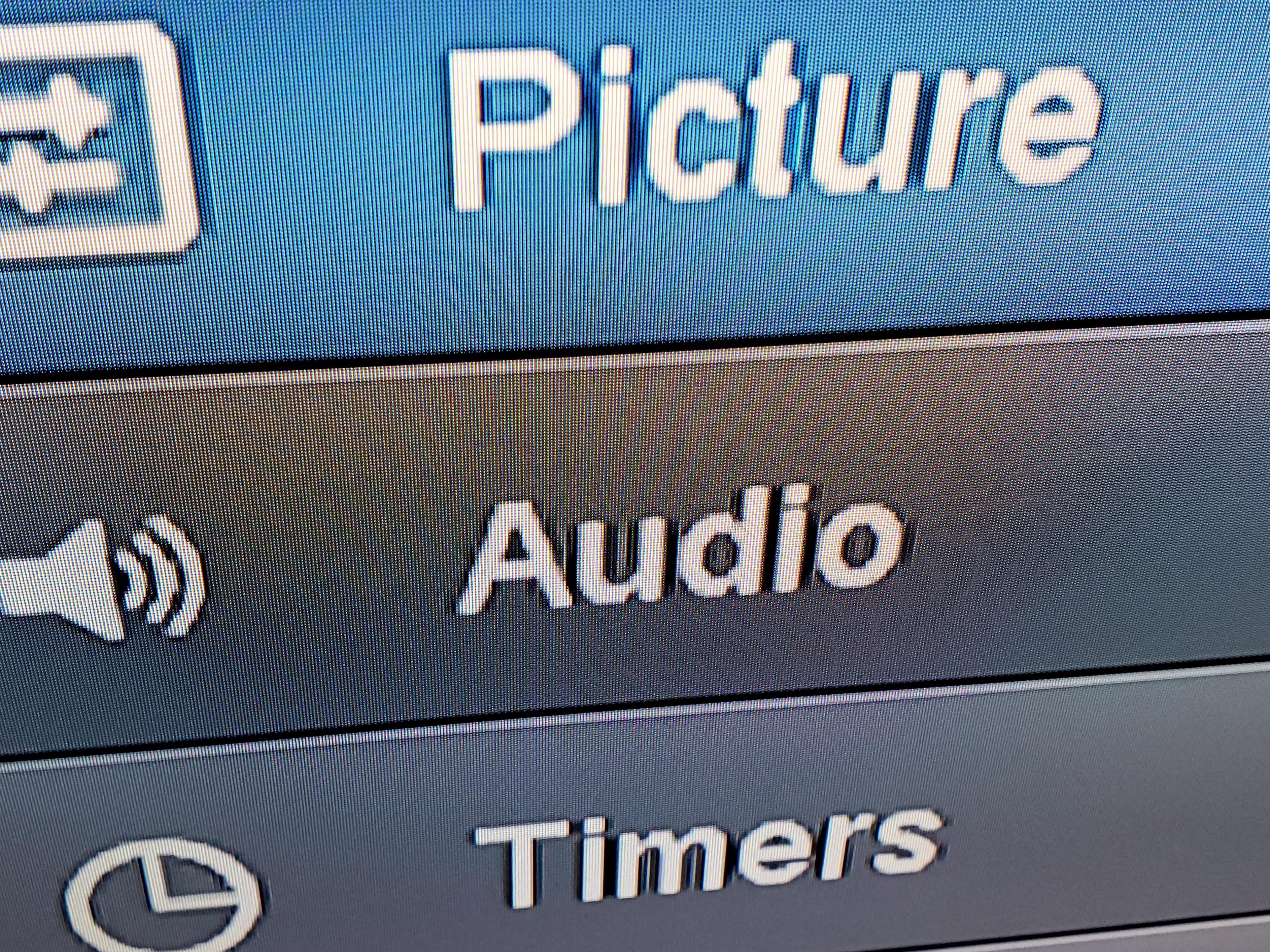

                                  would anyone know if there is a "focus" like feature for this TV in service menu or so? seems there is bleeding (horizontal) and my M70-C3 seems to have much sharper image / text
