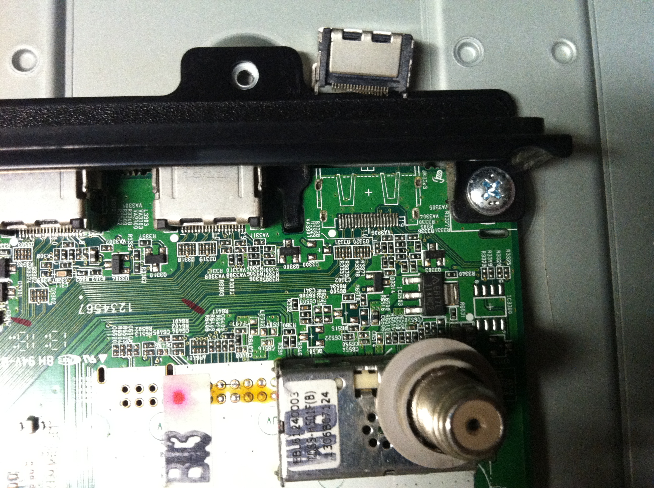

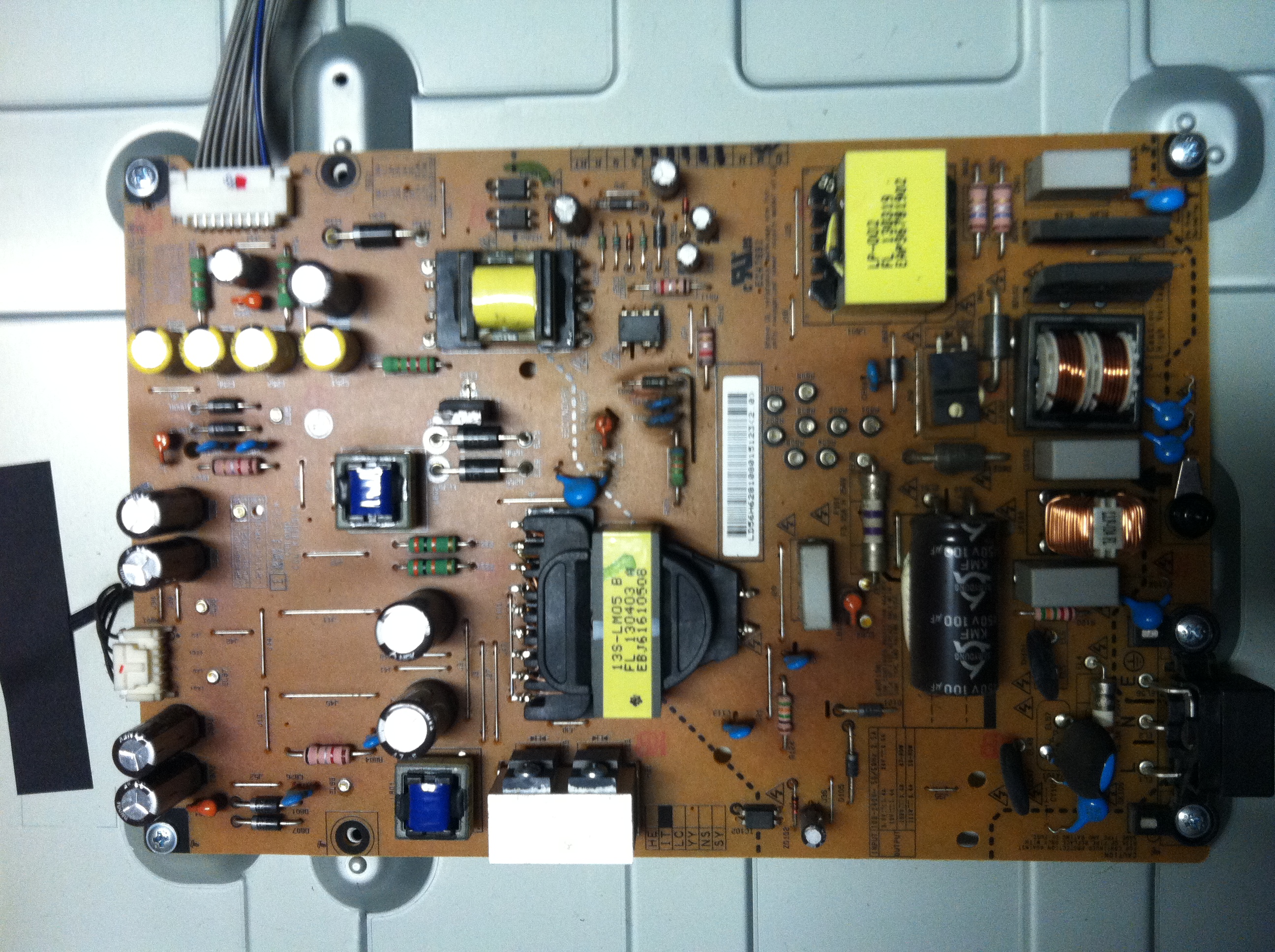

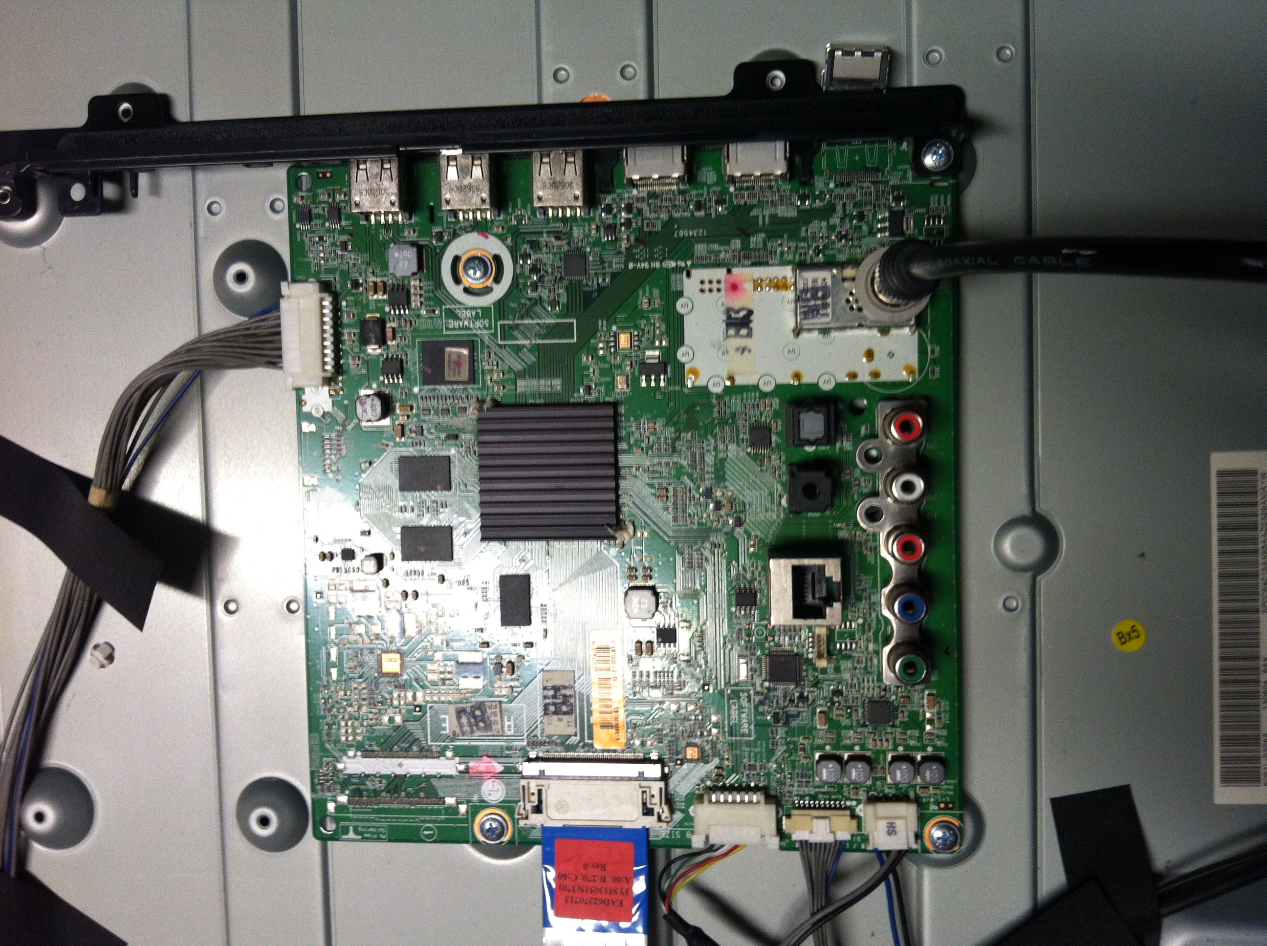

    I recently fixed my Samsung plasma with the help of RJ and TV Timmy so I decided to try another project. This LG 47" was given to me by a friend. When I opened it up, the HDMI IN 1(ARC) input jack fell out. I'm guessing this is probably not the cause. All of the caps look good. Any feedback is appreciated. Thanks.

      Re: LG 47LA6200-UA No Picture - has audio
      Maybe start with testing the voltages at the connector on the powerboard with the cables all hooked up, it's the connector that the cable from powerboard to mainboard hooks into, most times there's a legend/map nearby that gives the expected voltages, you measure them with your mutimeter, set meter to 20 vdc then report them, put neg probe on chassis metal ground, pos probe on pin of connector, measure in standby take note, leave probes where they are then power on tv and again take note of voltages, report them here, example pin 1-ps-on-0 volts standby-power on-3.3 volts.
