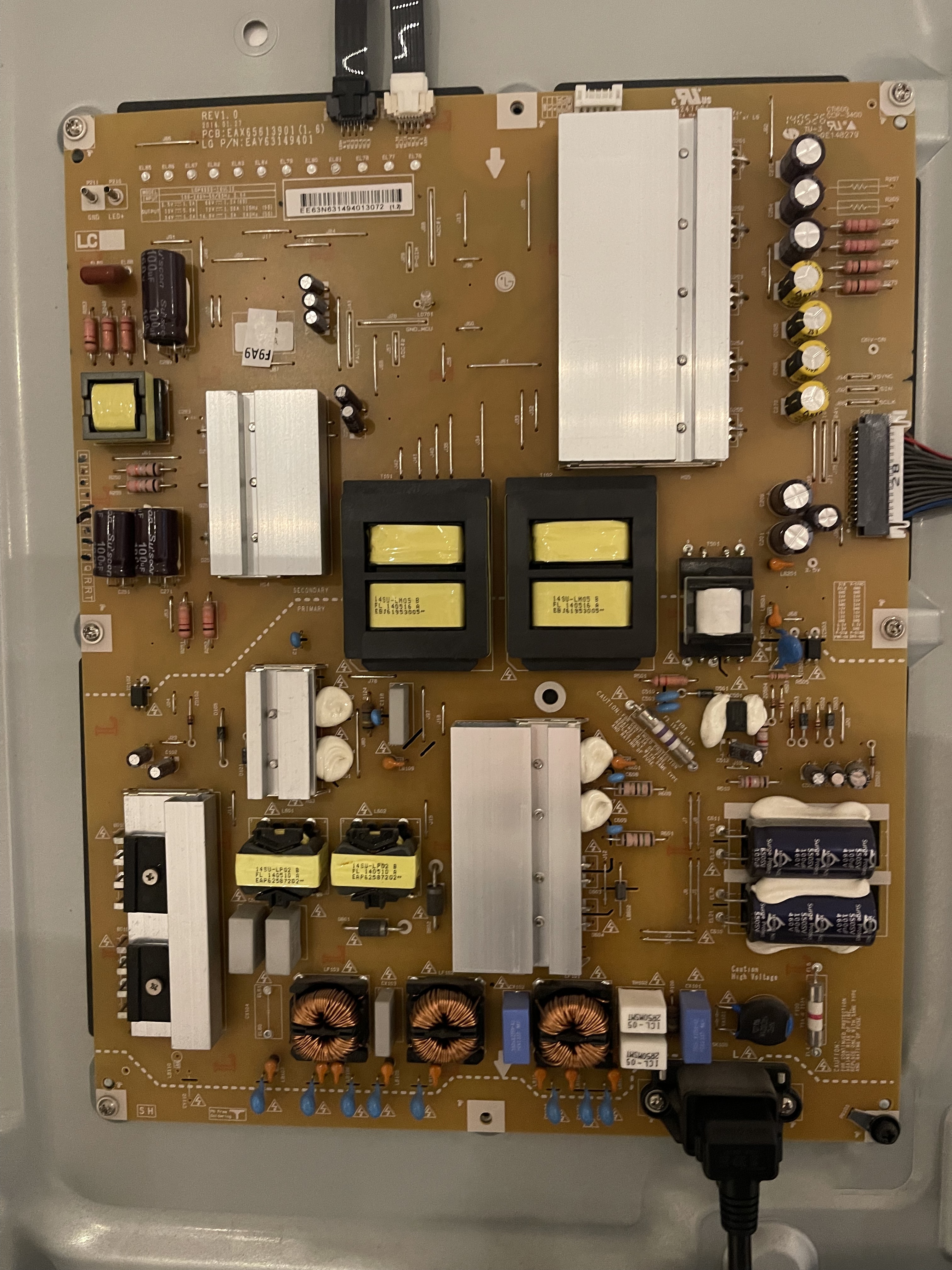

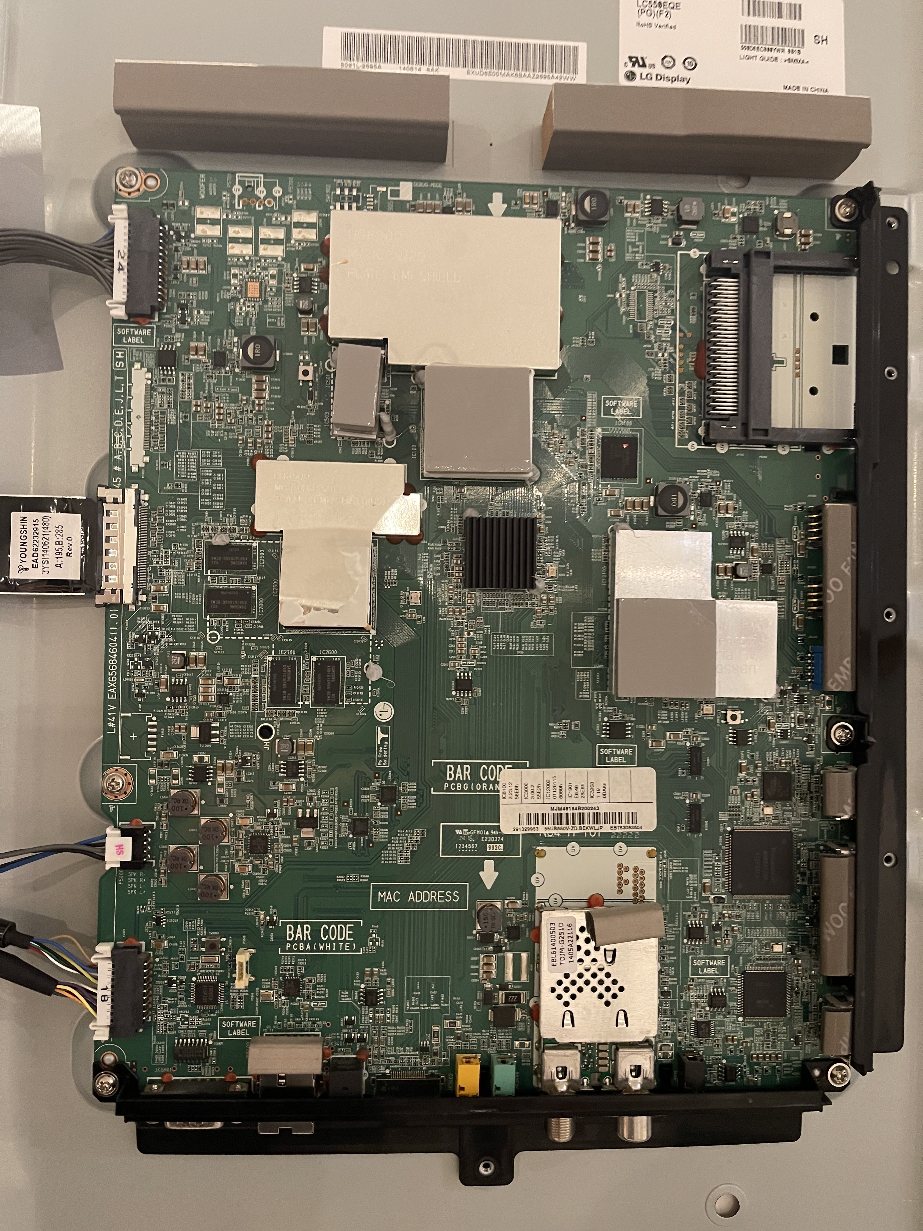

    Here's photos of my boards:

    With the back removed, LED LD1900 on the main logic board lights up briefly for around 1 seconds, then turns off.
    LED LD2300 remains solid red
    After about 1 minute or so, LED LD701 on the power board flashes 5 times in a row, then about a 5 seconds pause, then repeats the 5 second flash. This repeats itself indefinitely.

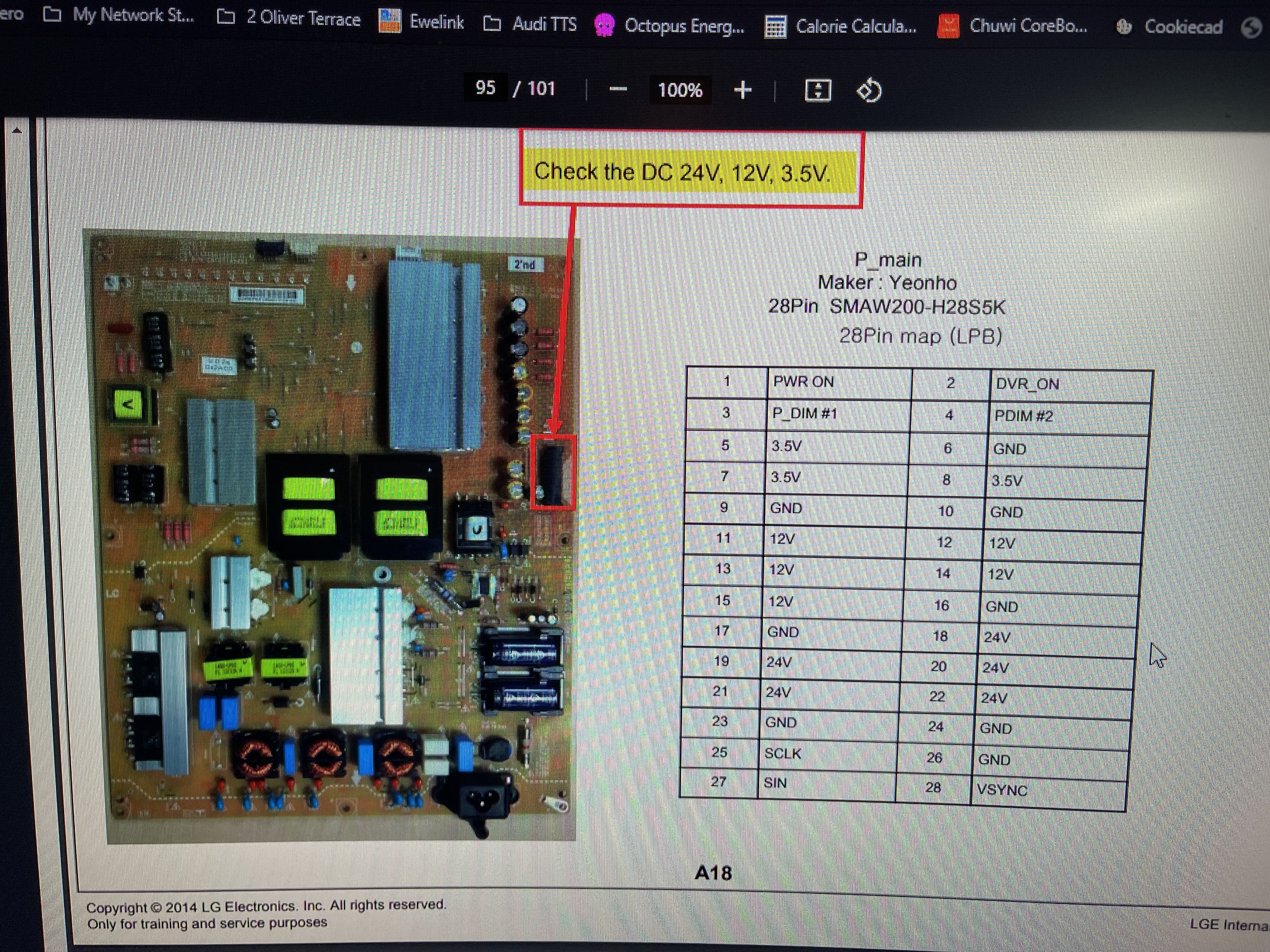

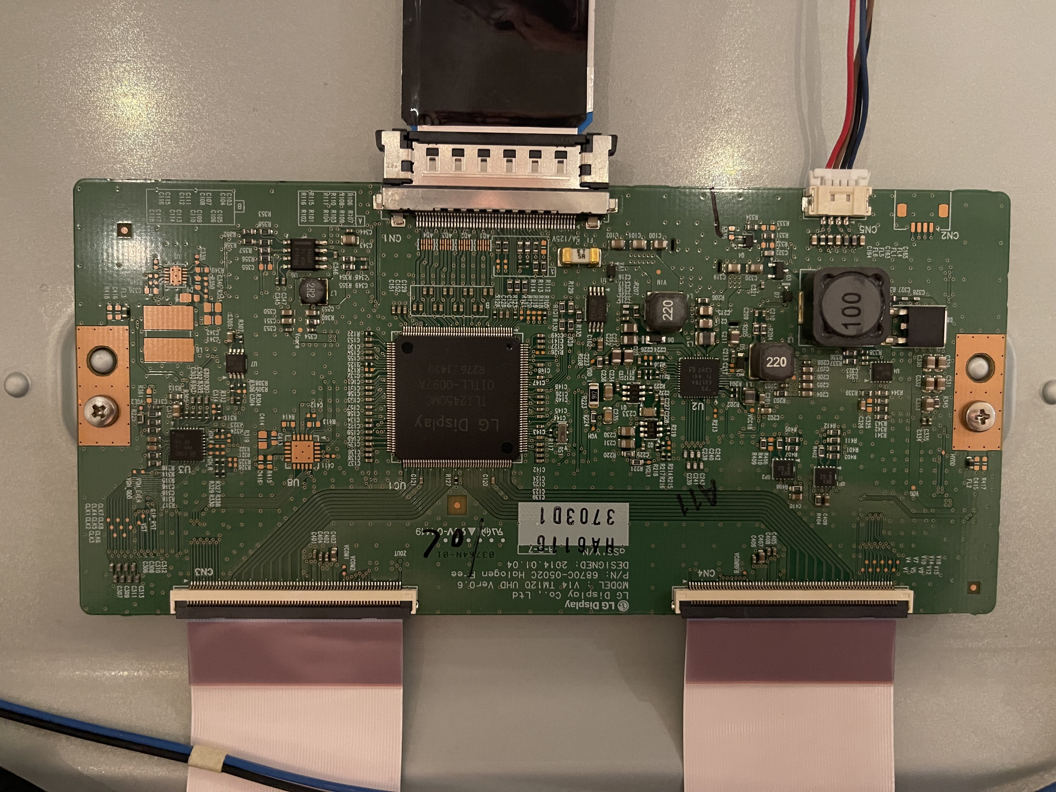

    Fuse F1 on the Display board (aka T-CON as I've come to learn) only give me around 0.835v
    J71 reads 11.8v, J75 reads 23.8v

    Now, the only difference so far compared to that existing thread, is that PIN 18 of my 26 PIN connector is 0v. All other recommended to test pins are correct (8, 12, 14, 20, 22)
    I also unplugged the to connection at bottom of display board (I presume it's panel connection if I read correctly?) but the Fuse F1 was still at 0.835v.

    OK - I am summarizing these as my problem was exactly the same as the post#1 on your post and the reference post #1 https://www.badcaps.net/forum/troubl...-s-help-please ---------------- I am coming in at post number 176 on page 9 on that larger thread ------------
    THIS IS A MAINBOARD PROBLEM. In 2025 these TVs and boards now have been here a loooong time and so can be hit and mix with caps , chip movements etc... any repair too involved makes near no sense financially as a new 55" TV is 500 Euro - so spending more than for me 150 EURO max would make no sense as any other components could fail. Power board priced at about 45, t conn 50, mainboard 80 (range to 250 euro for greedy sellers) screen/LCD ??? backlight ??? so it can quickly add up. So the only reasonable repair for me would be OPTION 2.

    I found a solution that many people with medium electronics background may be able to repair.
    Option 1.
    If you have the exact same problem as post#1 - the most direct repair is to replace the mainboard- yes hard to find , or send the mainboard off to have the flat chips under the heatsinks heated and reflowed.
    Option 2.
    If you have the exact same problem as post#1 - you can reflow it yourself I will outline what I used and an explanation in the next post - this is not exceptionally hard , I used a good quality heat gun(not even electronics grade) with temp setting and and aluminium tape / masking tape as well as flux and solder (the solder was not used on the board only used to get a gauge for the heat need to melt the solder and dial in the time and heat setting for the heat gun for me it was 300 degrees celcius and less than a minute - using the flux around each chip to determine when to stop)- probably the hardest part is unsoldering and removing the heatsinks and putting them back in place. I DID NOT FEEL CONFIDENT DOING THE BAKE TECHNIQUE - reason being there are so many plastics and micro caps and components that baking could damage and start another set of problems.

    my setup / problem - I used Option 2. to repair.
    tv model: 55UB850V-ZD
    outer casing model 55UB850V-ZD.BEUWLJP
    mainboard model: EAX65684604 (1.0)
    mainboard sticker: MJM48164B300287 287216546 55UB850V-ZD.BEEWLJP EBT63083605

      Thanks for the response - For the record, this post is 1 year and 8 months old.
      I reflowed it myself 1 year and 8months ago (ish) using an oven! It's been working ever since without issue
      I appreciate the response though as other users now and in the future will find it useful.
