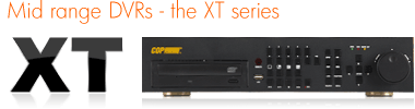

      Hello I have not explained things very well the unit has no output it just whines internally and it looks like this externally
