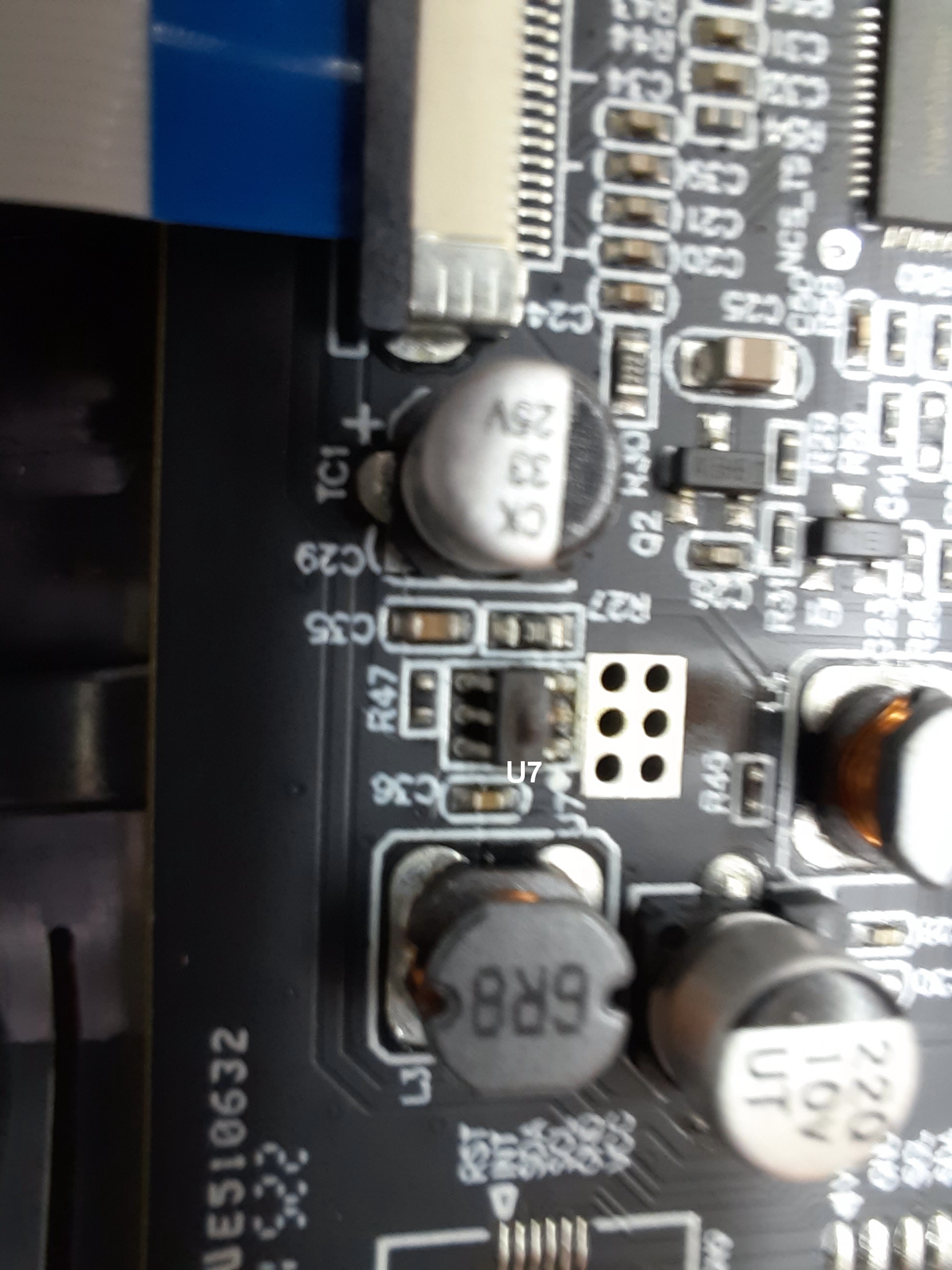

    Hi all, won't go into details but managed to cook it myself.
    Has two sets of codes on it.
    Top code JWN8T
    Just below code 2GL 4B
    PCB code ZM11E-T30 V2.1
    Out of a Hiseen CCTV monitor with no model of course.

    Re: Buck regulator chip ID help required.
    JW5352M
    https://www.joulwatt.com/en/proinfo_4329.html

        Can you kindly suggest an equivalent,as I can't seem to find a reliable supplier for original.

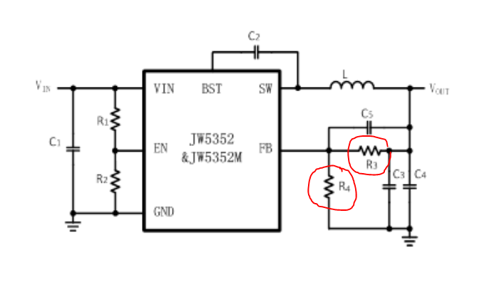

          Here you need to know the pinout of your DC-DC (pin1-x, pin2-x, ....) and select an analogue from this pinout.
          • lotas
            • Jan 2016
            • 4803
            • Russia
            You know what fixed voltage should be at the output, it is usually selected using a divider of two resistors.
                if you have no datasheet, the resistor calculation is impossible..

                  It's ok guys, managed to find supplier for original part from China of coarse.
                  Will update when it arrives.
                  • zen
                    • 511
                    Well, that was a waste of time.
                    Regulator arrive from China, fitted but output being pulled down by main micro.
                    This one is destined for the great scrapyard in the ground.
