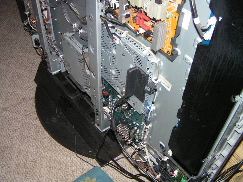

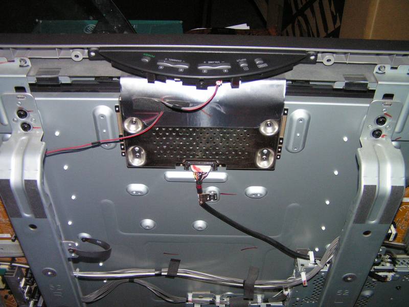

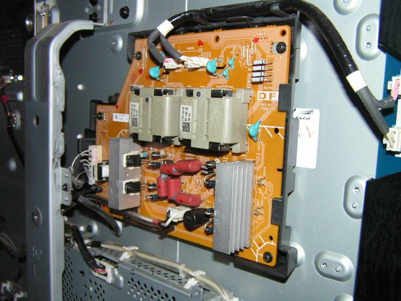

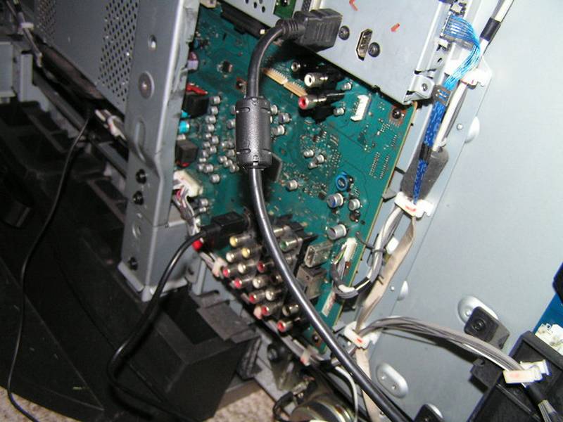

              #66
              Re: Sony Bravia no picture but backlight on

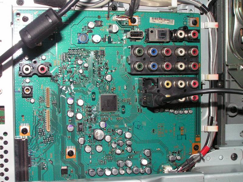

              OK, not sure on the rules of pics here. but I sized them to 800x600 and have many....
              Here are some of the pics, any close ups needed just say so. Thanks...

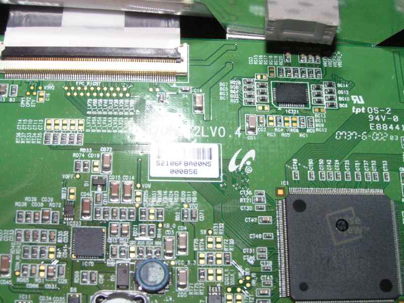

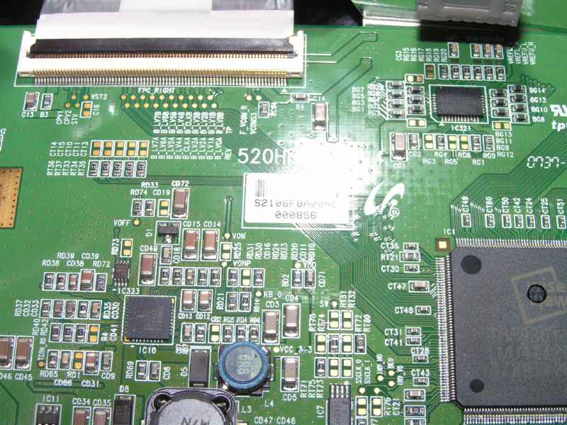

                #67
                OK here is the TV-Cont. board, which one is the fuse that I should check????
                Also what is the best way to get those top cables off? The bottom one you just squeeze on the sides, but not the top ones...

                  #68
                  Rules of the pics. Ideally you would get them as close to 2000x2000 as possible (maximum dimension on one side) so that we can see the details.
                  The top connector is fragile -- the black part swings up to a 90 degree angle and the cable slides out.

                    #69
                    Cool thanks, and thanks..
                    Looking at average the part goes for around 120.00 so not to bad if it is the correct part to fix.
