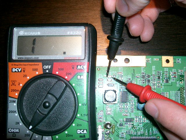

              So, I replaced the fuse and started testing smds again but the meter still isn't reacting when I touch the ends to the smds. Am I doing something wrong?
              Please see pics below of the meter when the ends are not touching, when the ends are touching and when I try to test two smds.
              Maybe the meter is faulty? I have another meter but doesn't have a setting at 200...

                #47
                Re: Sony Bravia no picture but backlight on
                To mangle Wm Shakespeare '“The fault .... lies not in our meters but in ourselves.”
                Follow this logic.
                The T-Con board gets it's power through that fuse.
                It converts the power to drive the LCD display, as well as using some for itself.
                One thing that can go wrong is a SMD cap shorts, loading the power line, and blowing the fuse.
                Per Wizard, when that happens the cap will have a reading below 80 ohms.
                You do not find a cap with a reading below 80 ohms.
                Conclusion: None of the SMD caps are shorted. (Just for luck check ALL SMD caps)
                Other possible causes of this problem is a fault in one of the ICs, a fault in the voltage converter, a bad inductor, a fault in the LCD panel. One thing that helps troubleshooting this is the total current through the fuse is only a little over 3A.

                  so, I've gone as far as my limited knowledge permits me...
                  I will be ordering the t-con online. However, there is a minimum quantity order, so I will need to purchase more than one item. What other boards are known to fail on this tv? I'll order that board too!
