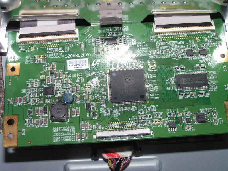

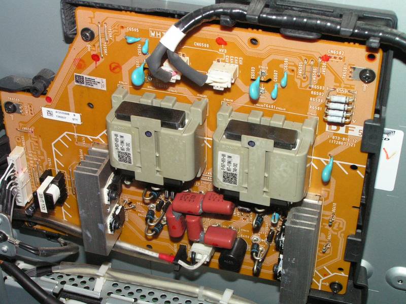

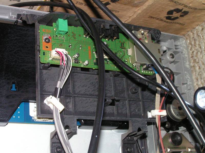

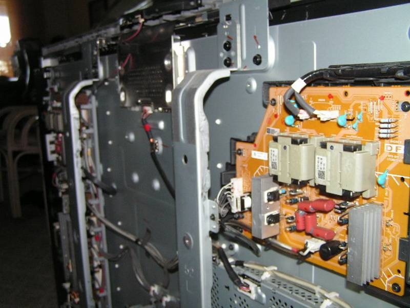

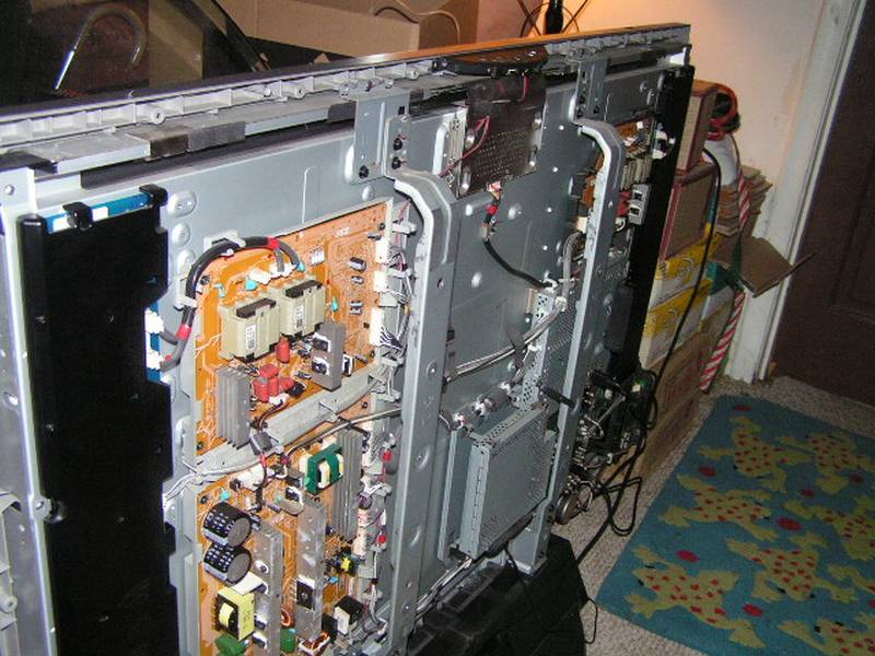

              #66
              Re: Sony Bravia no picture but backlight on
              OK, not sure on the rules of pics here. but I sized them to 800x600 and have many....
              Here are some of the pics, any close ups needed just say so. Thanks...

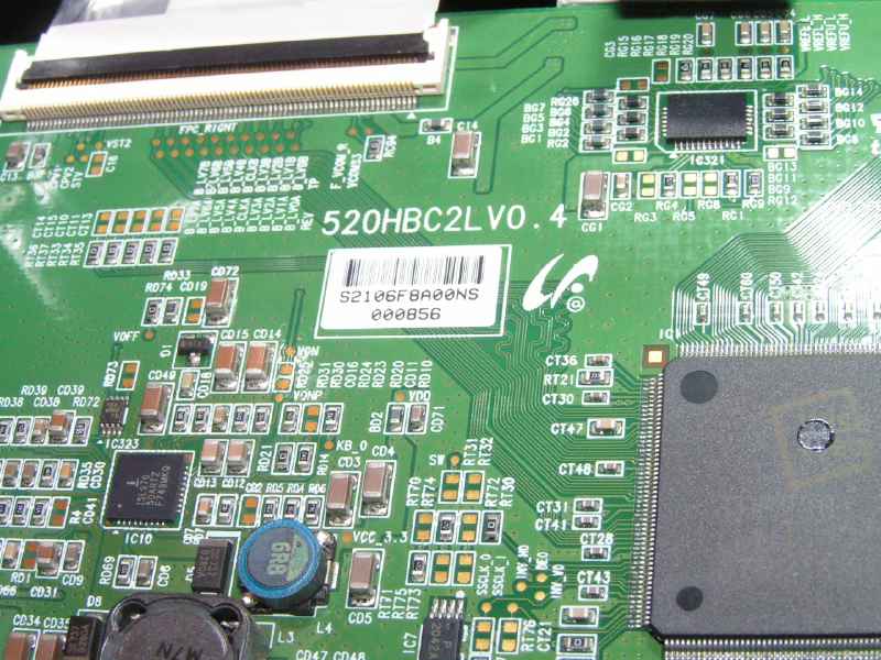

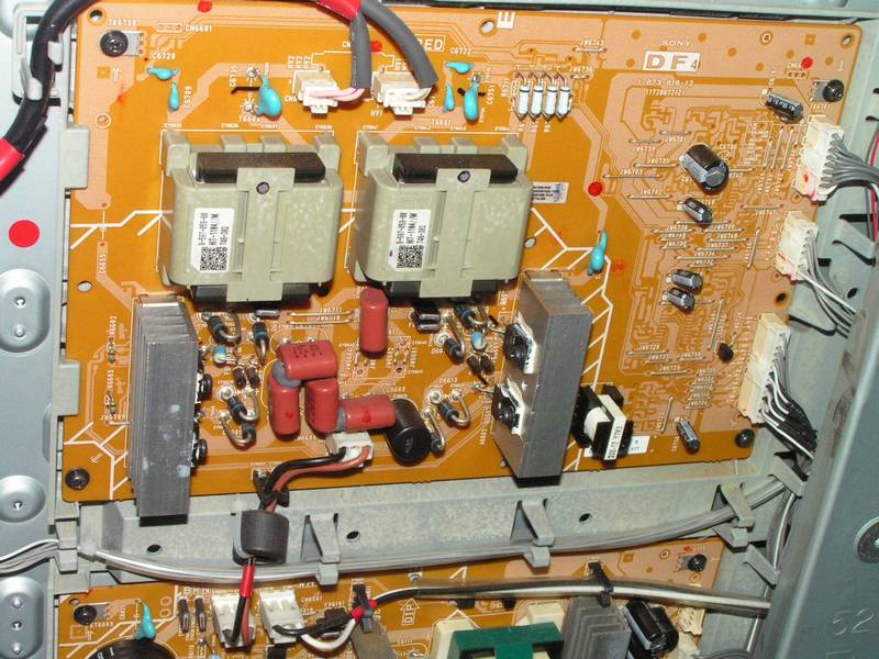

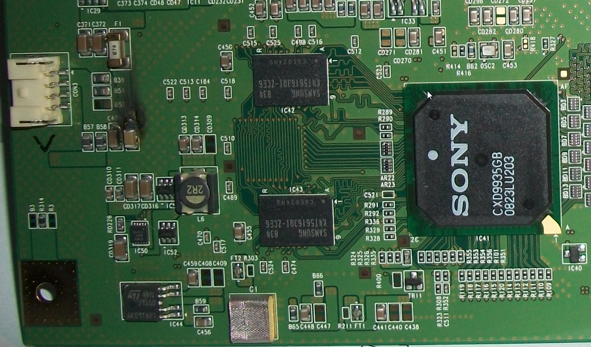

                #67
                OK here is the TV-Cont. board, which one is the fuse that I should check????
                Also what is the best way to get those top cables off? The bottom one you just squeeze on the sides, but not the top ones...
                  #68
                  Rules of the pics. Ideally you would get them as close to 2000x2000 as possible (maximum dimension on one side) so that we can see the details.
                  The top connector is fragile -- the black part swings up to a 90 degree angle and the cable slides out.
                                hi hope someone can help i have a sony bravia kdl 40v2500, it swicthes on fine with steady green light and sound is perfect but no picture can hear channel change and volume works fine, you can also c the backlight on, i have changed the t con board and when i first done that and turned it on two white lines came up, turned the tv on and off again and the lines are now gone but still no picture the same as before so now am stuck dont know where to go have checked all wires and cracks and everything seemd fine so i hope someone can help thankyou.
                                  #76
                                  Originally posted by Wizard View Post

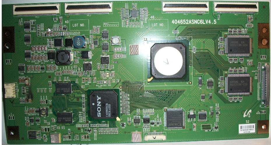

                                  T-CON is staring right at you. Right in middle at top hiding behind the vented cover with 4 little screws.
                                  Do you have multi-meter? Take T-CON cover off and find a small SMD fuse and measure this first, tend to be very near the LVDS connector. You want very low ohms. If high ohms, bridge this old fuse with 2A picofuse secured with bit of soldering job on both ends. Take very clear picture of the exposed T-CON board.
                                  Make sure T-CON have thermal pad atop the big square chip and any smaller ones if are there.
                                  Cheers, Wizard

                                    #77
                                    Changing fuse or solder a picofuse over the old fuse is sufficient.
                                    Cheers, Wizard
                                    Wizard:
                                    I apologize if you receive this twice but I am new to this forum and I am not sure if the first reply went through...
                                    Your post 6+ years ago exactly describes my issue with my Sony KDL-46V5100 (TCON board 46NN_MB4C4Lv0.7 with LTY460HF07 LCD). It looks like the fuse blew yesterday based on my continuity check on the TCON board.
                                    I am planning to solder another fuse on top of the blown fuse on the board per your suggestion. Do you know what fuse specifications I need? (amps and volts)
                                    It looks like the markings on the fuse are "LF7A" which I think mean a 7 amp fuse from Littelfuse. The closest fuse I found at mouser.com is a 8 amp with 125 voltage rating. It is a NANO2 fuse not a PICO. Do you think this will be okay?
                                    I appreciate your help as I am pretty new to this,
                                    Ram
