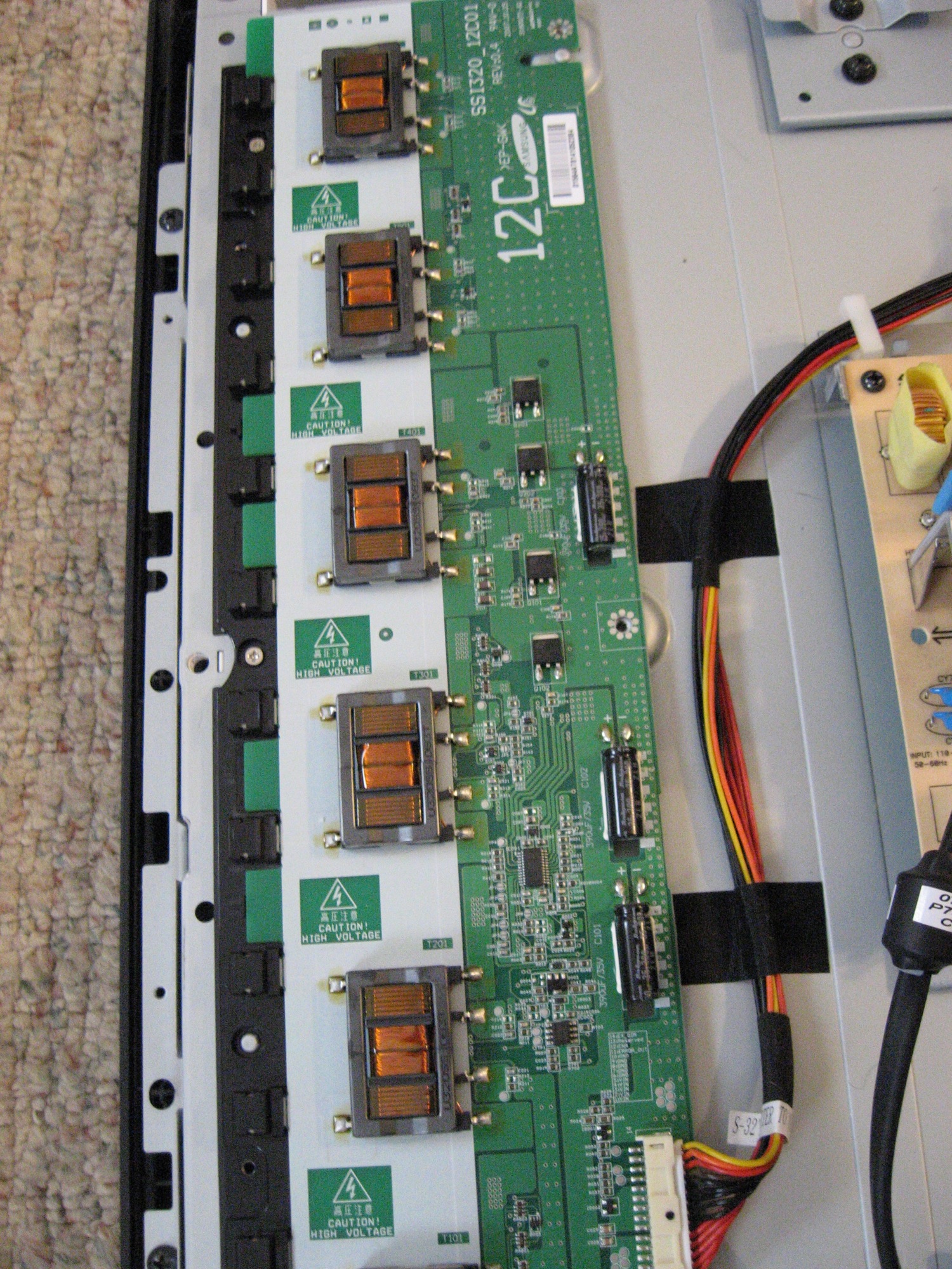

                    Well, since the backlight is looking good and bright, would the inverter board even be an issue? All it does is backlighting right?

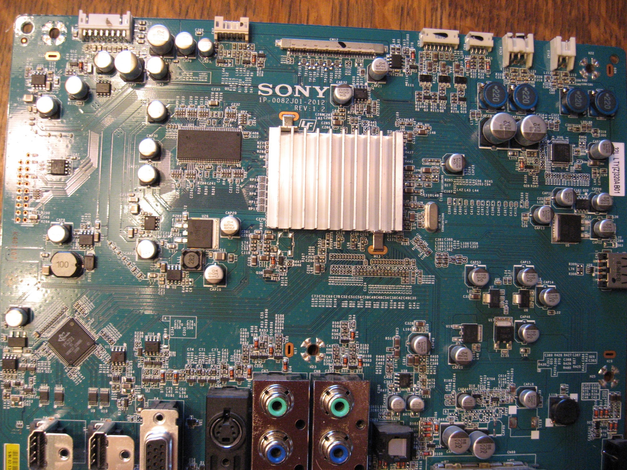

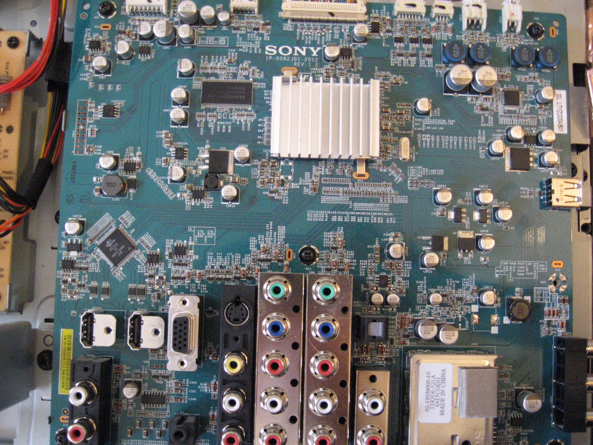

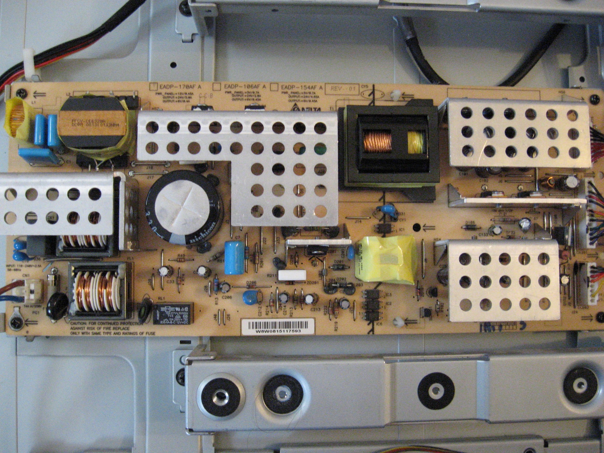

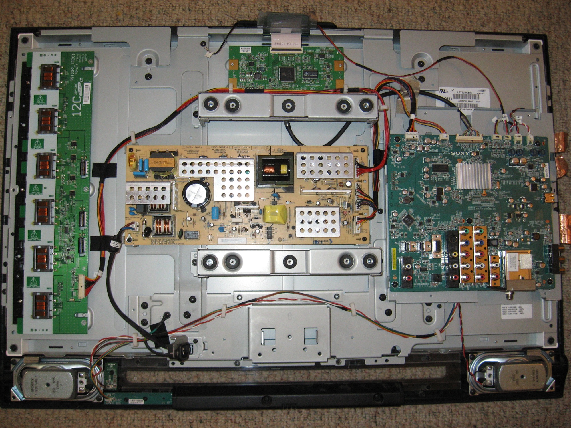

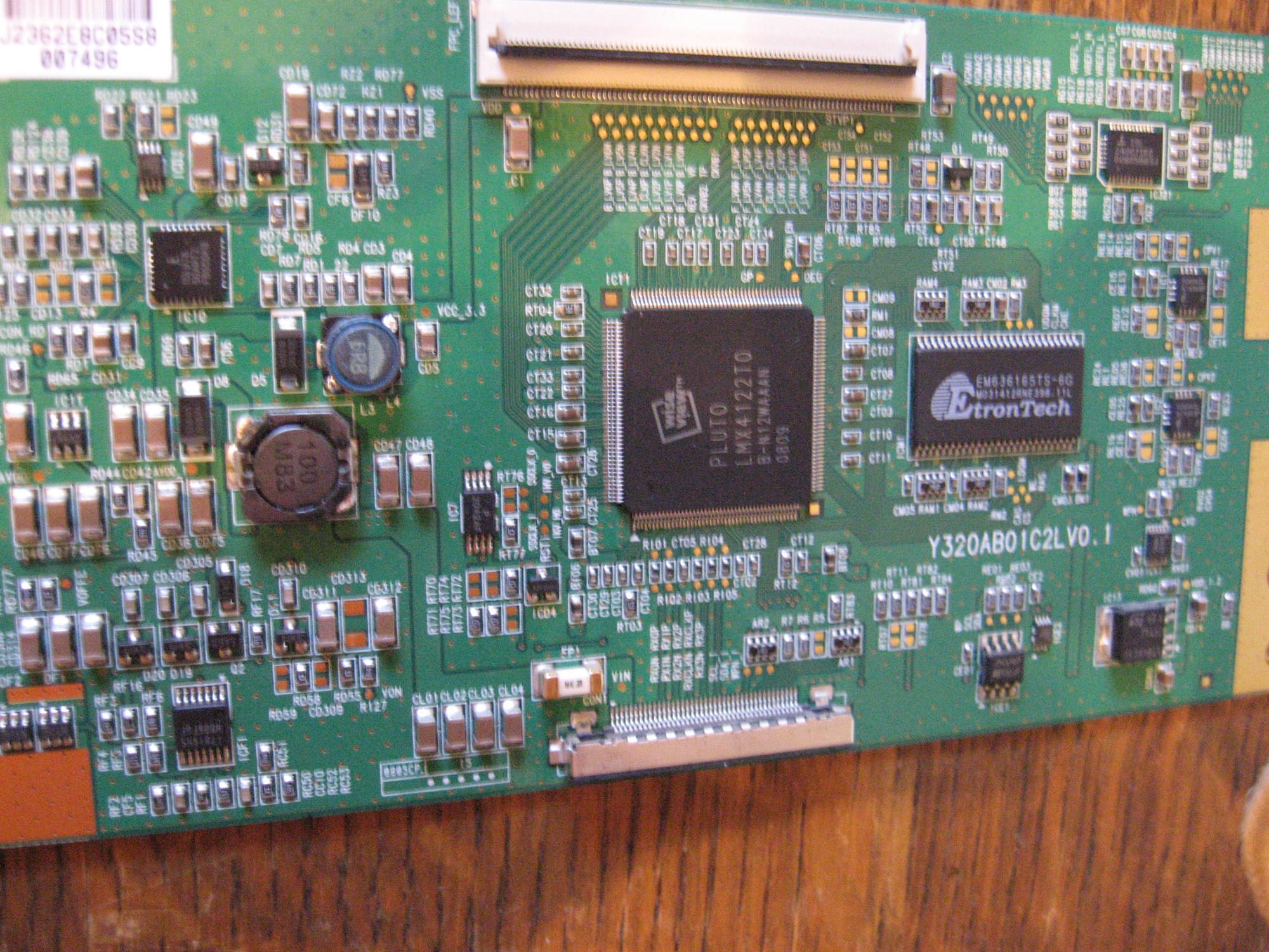

                      Here are the pictures
                      The first is of the back of the tv with all boards uncovered
                      second is the main board
                      third is a closer view of main board
                      fourth is the inverter board
                      fifth is the power supply
                      and last is the little board at the top of the tv between main board and LCD screen

                        Re: Sony Bravia no picture but backlight on
                        Blindly change to a video input with video and audio attached. If you get audio, that means TV is fine and whole LCD panel is probably good, that why I suggest check fuse on T-CON board, fuse is small and usually marked with a one letter and is very close to the LVDS connector. This can fail. That last picture is called T-CON (timing control). If fuse is still good, see if you can get one from sony or ebay or google may find one.
                        That one is a square cross section fuse with metal square end caps and it does have a number marked on white body. Fuse is just above the LVDS connector to the left. They sometimes fail for no reason. Changing fuse or solder a picofuse over the old fuse is sufficient.

                          Yes, I had already checked the fuse on the T-CON board (thank you for the new name). It tests positive for continuity. You said to "Blindly change to a video input with video and audio attached". The only connection like that I can think of is HDMI or the coaxial, am I correct? I'll have to find someone with an HDMI output device since I can't see anything to set up with my converter box... I'll get on that soon hopefully.

                              oh, well then yes, I can indeed get audio from Component #1 with the television. I can't seem to make the audio switch to the other sources though with the "input" button.

                                This means mainboard is fine. Either replace the T-CON, but make sure you have voltage on that fuse. Failing that, LCD panel itself.
                                T-CON on used market is usually 50-120 dollars. Panel is around 800-1,500 in that size.
