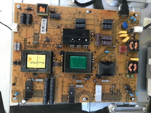

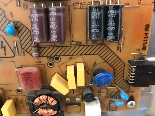

    Hi, this is my first post!
    I have a Techwood 40AO2USB TV which when turned on flashes a blue led and then steadies this. I assume this is a Standby Mode. I can not make the TV do anything else (other than switch off - blue light flashes again and then goes off). I assume the TV goes through it's checks, then finds something that is not right and goes into Standby. Can someone please suggest what I should check/test to narrow down whether it is the PSU Board (markings: Vestel 17IPS20, 23250360) or the Main Board (markings 10099021) or the Backlight Assembly, OR something else. I have a Fluke Meter and I am competent in using it, and I am electrically-aware on safety. I am not after component identification & replacement, rather to know what replacement board to change without spending money unnecessarily. I can provide photos if helpful.
    Thank you!

    Re: Diagnosis of a 40AO2USB TV that's stuck in Standby
    There are quite a few versions of the 17IPS20. What version number is given on your power supply.

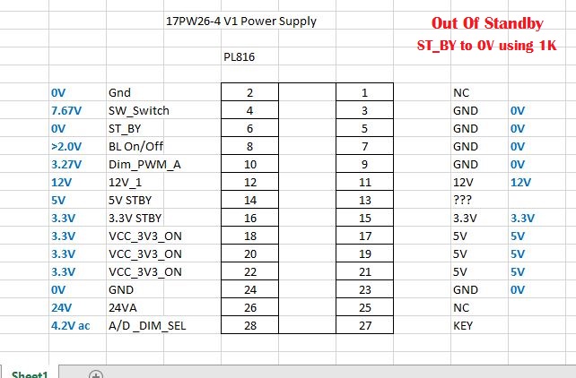

    Have you measured any of the voltages on the various connectors?
    eg these are readings from another power supply as an example

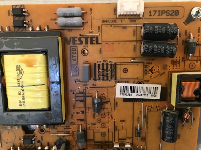

      Hi, thanks for responding.
      1. The markings on the PSU Board are: Vestel 17IPS20, 23250360 - 27447736 1006.
      2. No, I have not taken any measurements as yet, but will do so once I have a table confirmed such as the one you suggested.
      Thank you again!
        The photo is too hard to make anything out. The black connector at the bottom right hand side has a parallel set of pins similar to the one I listed where you need to take the voltage readings.

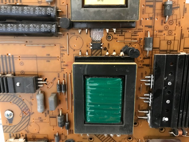

            As I said earlier there are several versions of this power supply so a good high resolution picture could help to identify it.
            Attached is one schematic but I don't know if it's for your power supply.
            Can you match the connectors to the diagram?

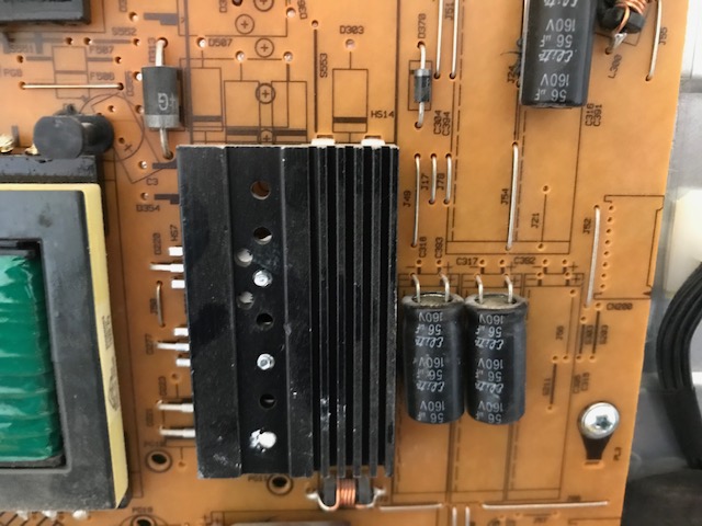

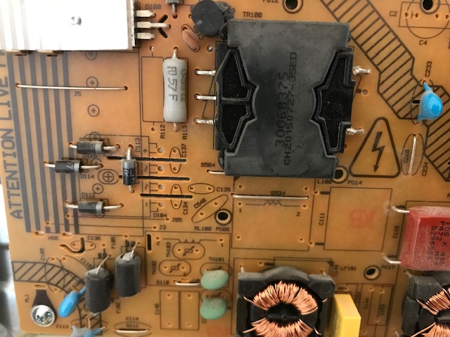

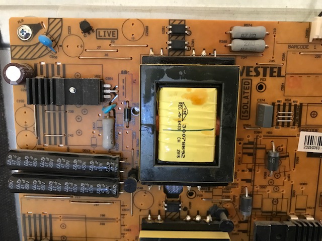

              Thank you Dick-Barton
              Yes, I have realised there are several deviations of the PSU Board. I have taken a few more photos, hope they have better resolution. There is a label on the last Photo (Bottom Right) reading: 071114 R9; does that mean anything to you?
              Thanks again!
                It looks as though it's possibly revision 9 so 17IPS20-R9
                Unfortunately the pictures are still too small to make out any of the component labelling. Can you post a photo of the full board well focused.
                The power supply schematic is within the attached manual
                Take a look at the last page. If you have CN4 can you give the readings.
