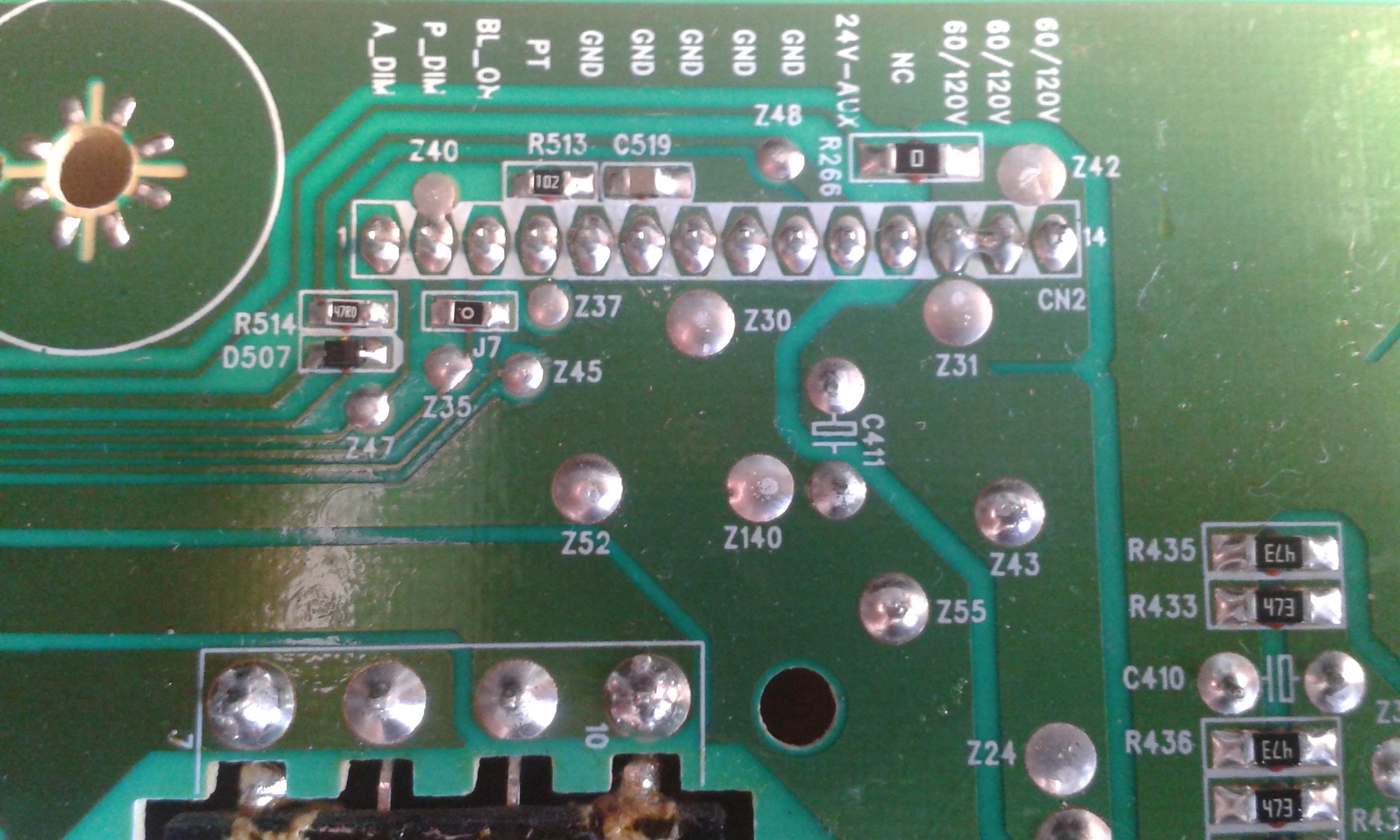

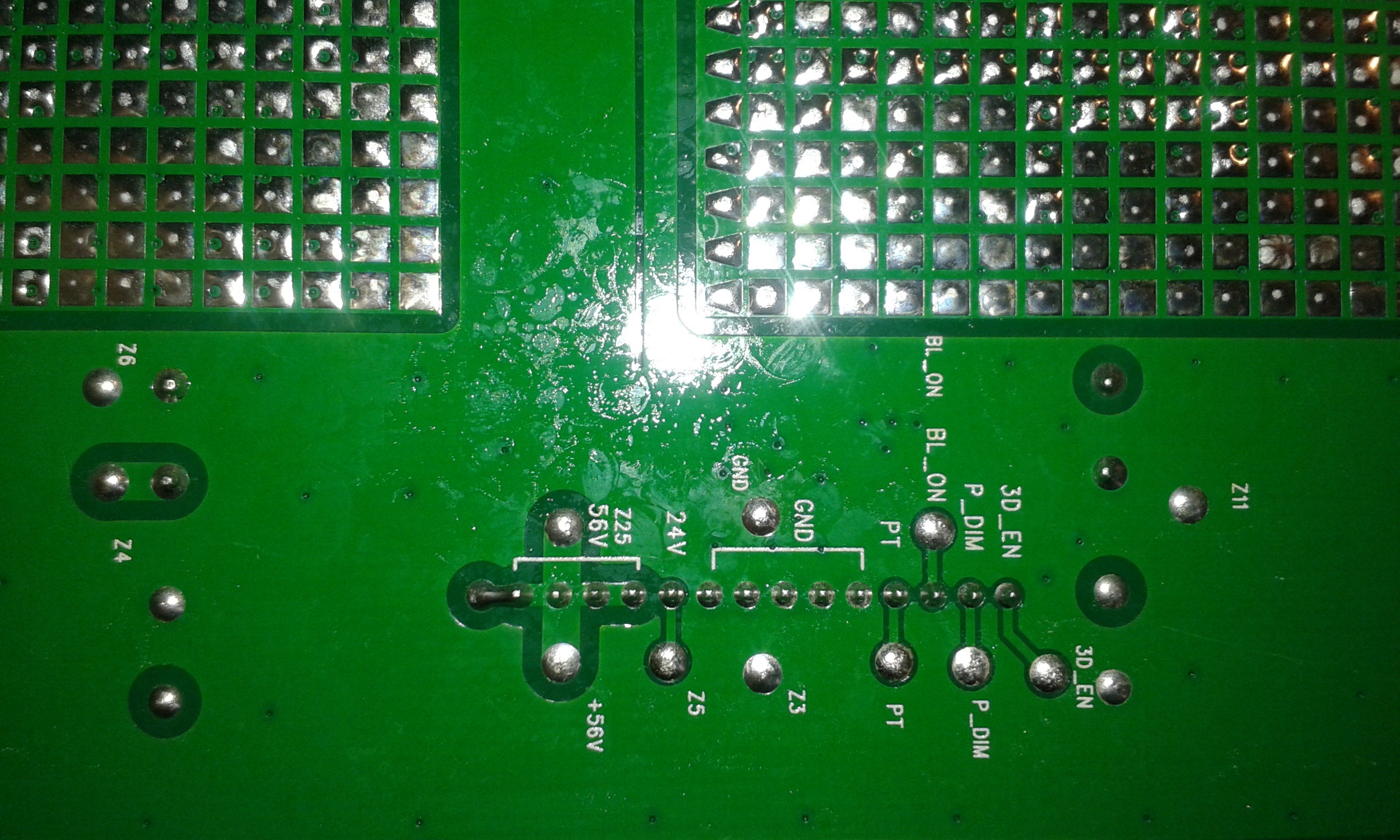

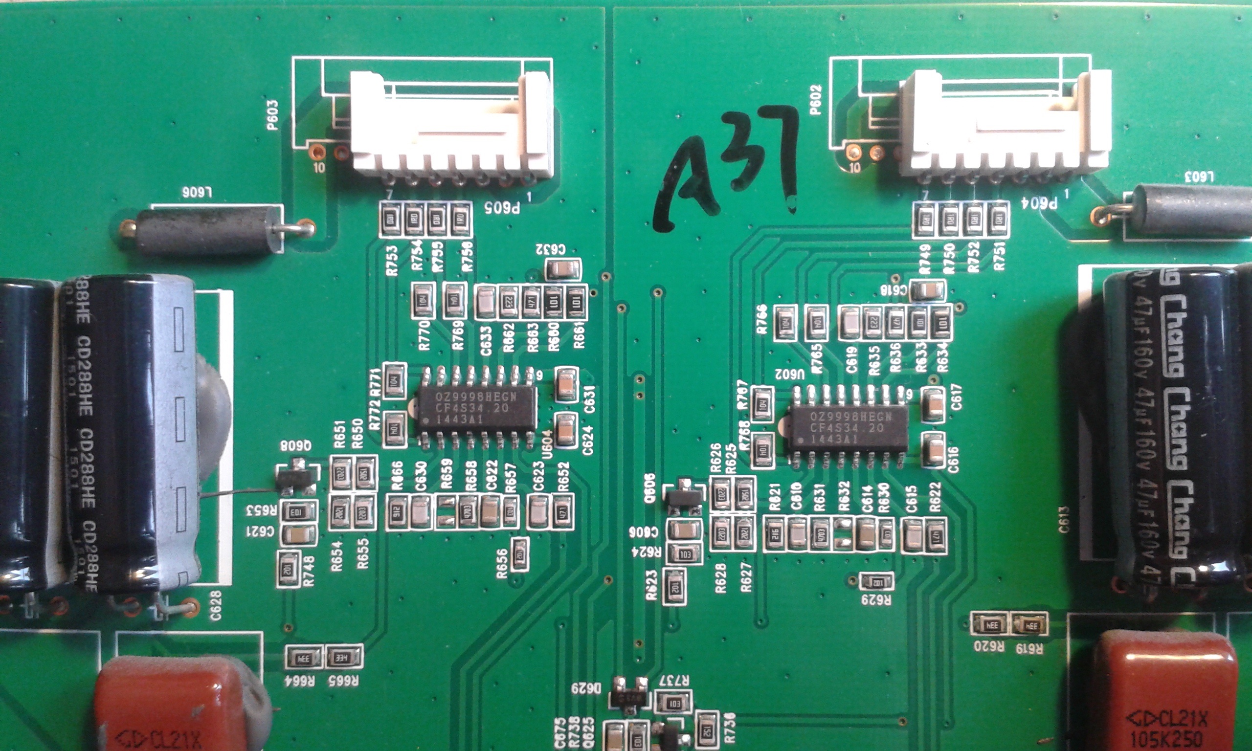

    1) The pictures of the boards are very poor, I cannot read the pin label (the oin names are printed on the bottom side of the board) of the connector of the power supply board that goes to the LED driver board.
    Yes, below is new, do they help?
    Originally posted by budm
    2) Were you getting 24V to the LED driver board? And now you don't since you start playing with FSFR1700XSL and D404?
    This 24V comes to inverter board from psu pin no. 10 (marked red). And yes, I have 22.92V before but after disconnect/reconnect this 14pin cable, I dont have this anymore, also, no standby.
    3) The 24VDC is generated by FSFR1700XSL so the circuit was working. I do not understand why you start messing with the FSFR1700XSL.
    Because (also question 4) ) one technician suggested to measure C401 22uF/50V voltage and there is 1.6V, they told that I must check this part of circuit, I then measure this SMD components and find this zener conducted both ways, soldered it off and checked with a zener tester - same result, 0.0009V zener voltage.
    4) As you can see that D404 is connected in parallel with resistor. So when you check D404 off the board, does it show conduction and low resistance (<10 Ohms) in both directions.
    See previous.
    5) Right now you need to get the FSFR1700XSL working again before going back to troubleshooting the backlights issue, or just buy a new power supply board assembly that match the number on the barcode sticker, not the blank PCB part number..
    I dont know this zener real name value - if I order new FSFR1700XSL and if there is this broken zener...i dont think that this new IC helps, they also fail probably.

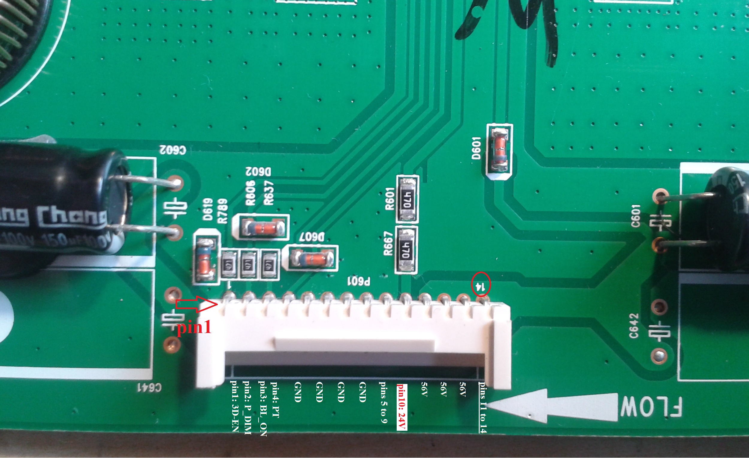

    6) Where is the pin that is supposed to have 56V?
    In inverter board, pin 11 to 14 is marked 56V, in PSU, pins 12 to 14 is marked as 60/120V, 11 is not connected (see 1. (PSU connector) and 4./5. picture (inverter connector).

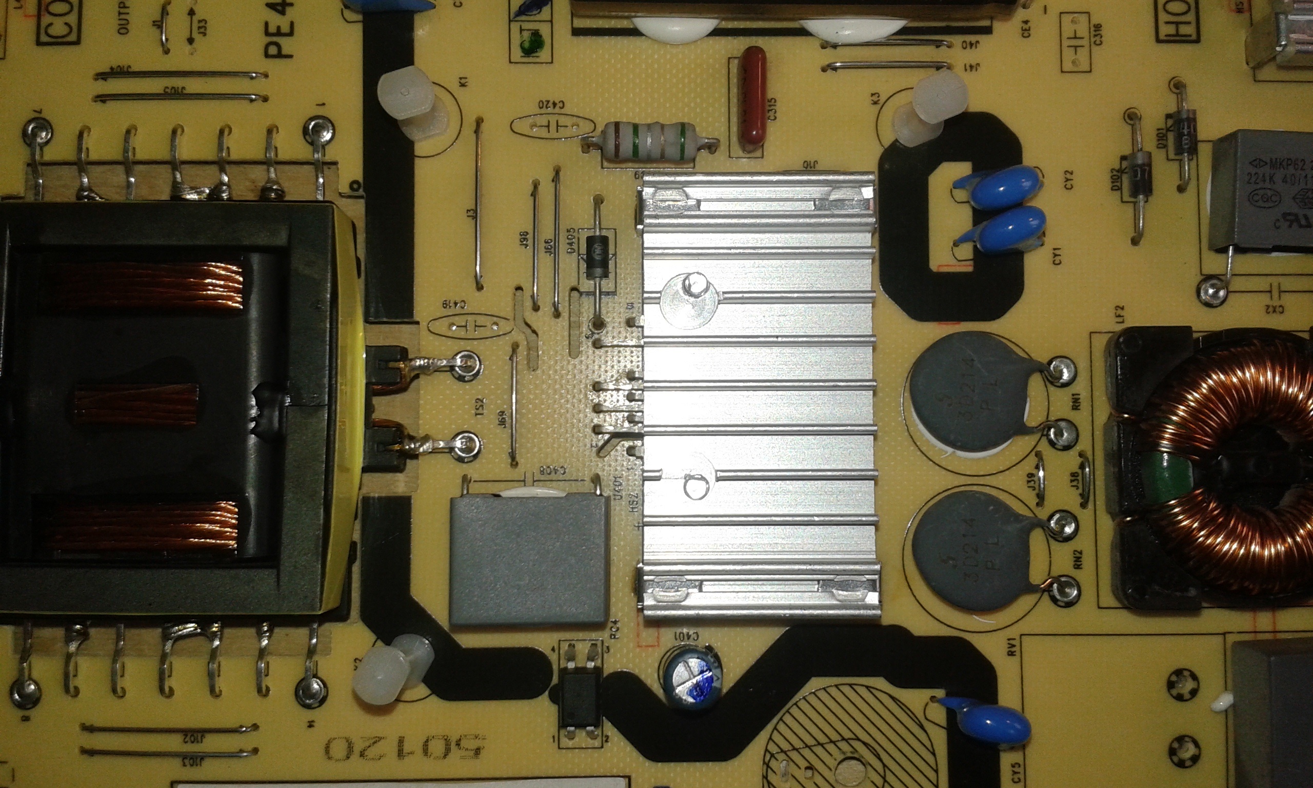

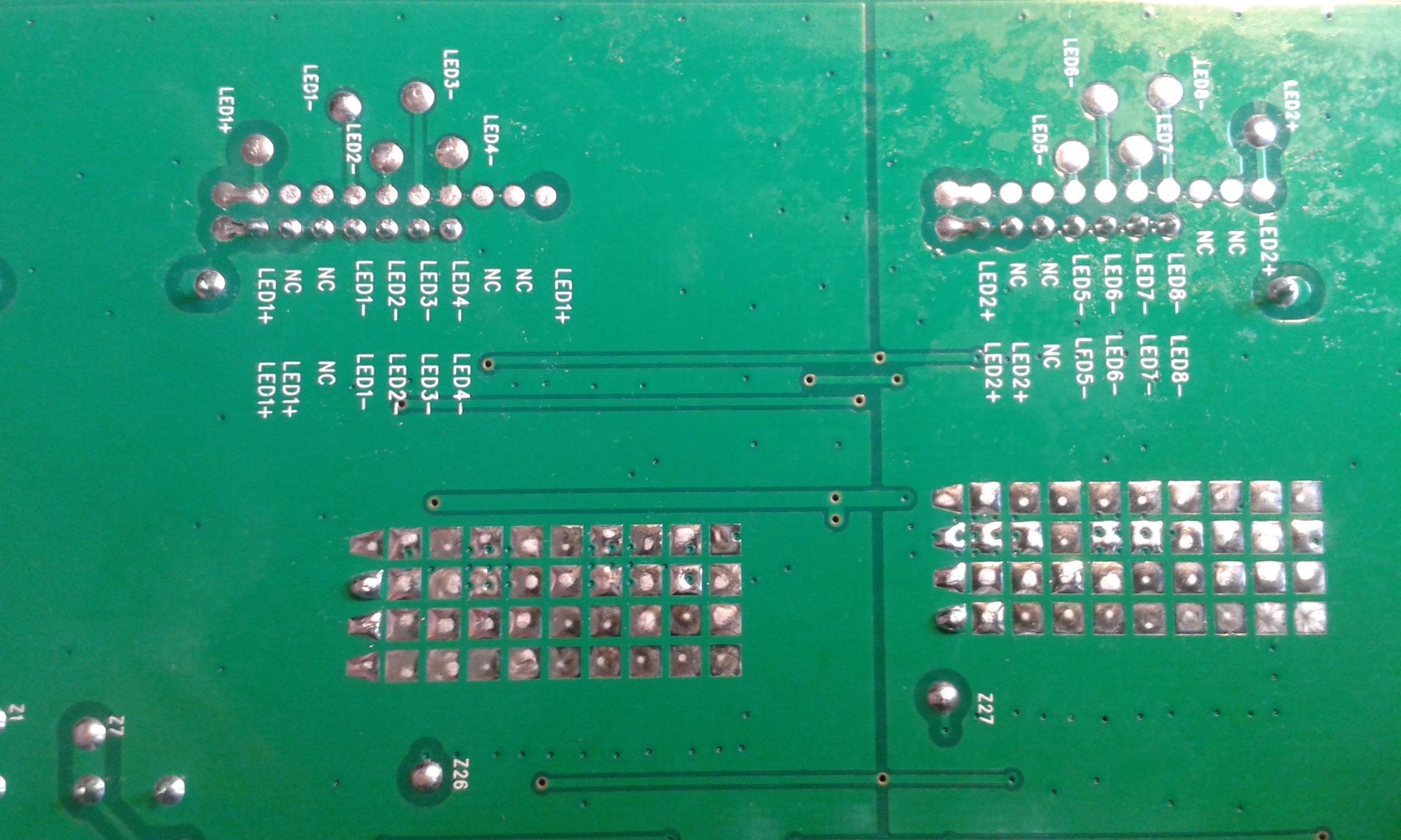

    Pictures 2 and 3 is LED stripe connectors from inverter board.

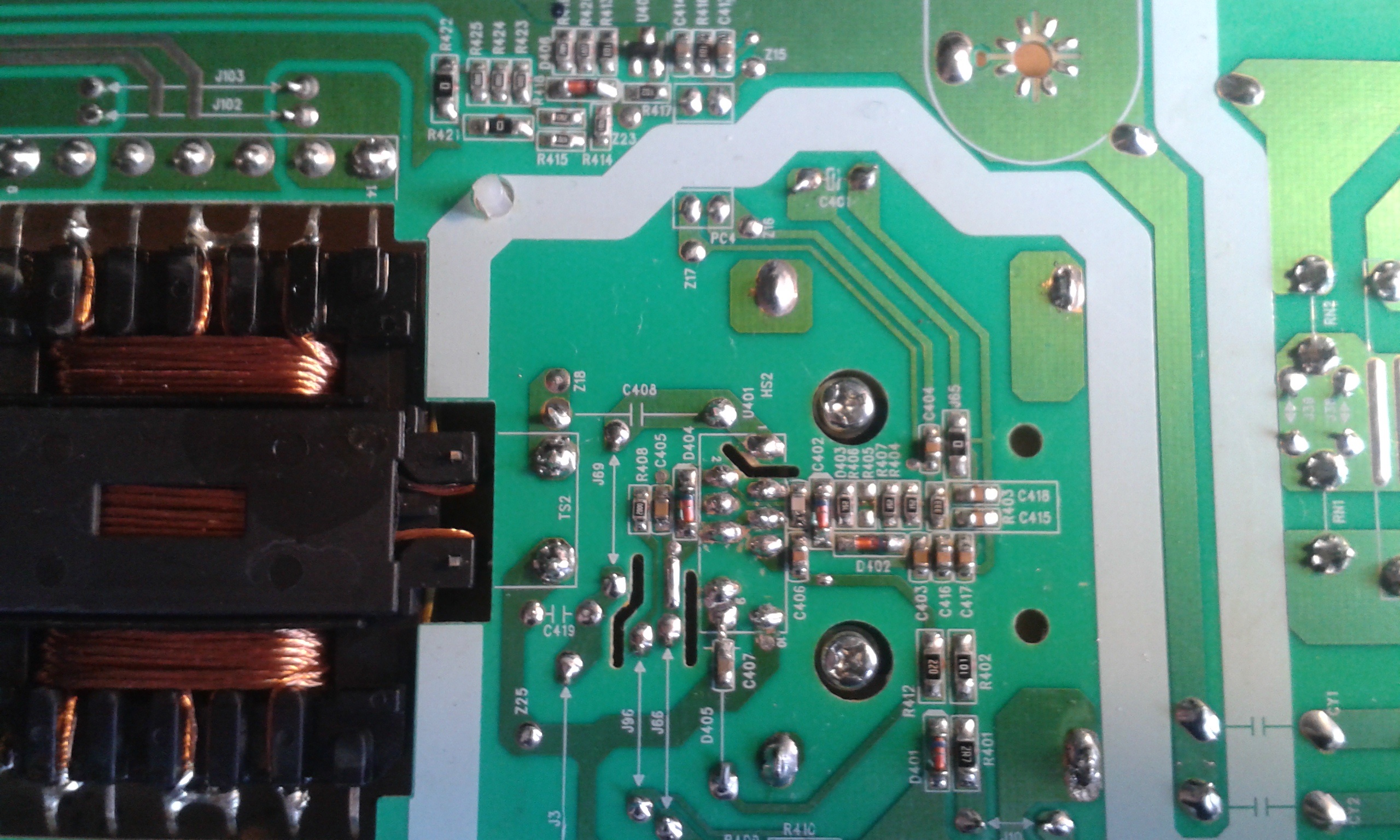

    Last 2 pictures is PSU FSFR1700XSL circuit top and bottom view

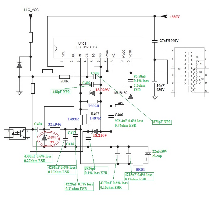

                I finally got new PSU chip and now is still only one problem - this damaged zener.
                Like as I say some time ago, I was measured all components which located near this FSFR1700XSL chip and clear is that this D404 (some kind of zener) is damaged BUT - how can I be sure what value zener this must be?
                I draw this part of PSU zircuit and measured all little SMD parts, this circuit is below and there is also componets values which I measured.
                Now - how I can calculate this D404 value? Or rather what does this value depend on, on which should I proceed? There is no this kind of zener circuitry in FSFR1700XSL datasheet.
                If I choose an incorrect zener - I am afraid thst this ends badly to new FSFR1700 chip?
                Therefore - how I can choose correct value zener?
                • dick_barton
                  • Aug 2015
                  • 6643
                  • Wales
                  Re: Thomson 55UA7706 LCD TV startup problem?
                  The data sheet for the IC says VAR (Autostart Reset Pin Input Voltage) = MAX VLcc
                  VLcc on the data sheet says maximum 25V
                  So it's possible that the zener may be somewhere around that value.

                      Yes, this is weird but - I was measured this maybe tens of times and compared to others and this is clear that this zener is defective. I dont know why? Also, first time I have this fault but lets see when new IC is in place and also new zener.
                      I have now 17V, 18V and 24V SMD zeners too. I think that maybe I`ll try then 18V here?

                        Zener has a 18V value. If this zener breaks, then also FSFR1700 fails and need to be replaced, no empti place here! Although it may seem to work even without this zener it not work without a zener.
                        Now this TV works again.
