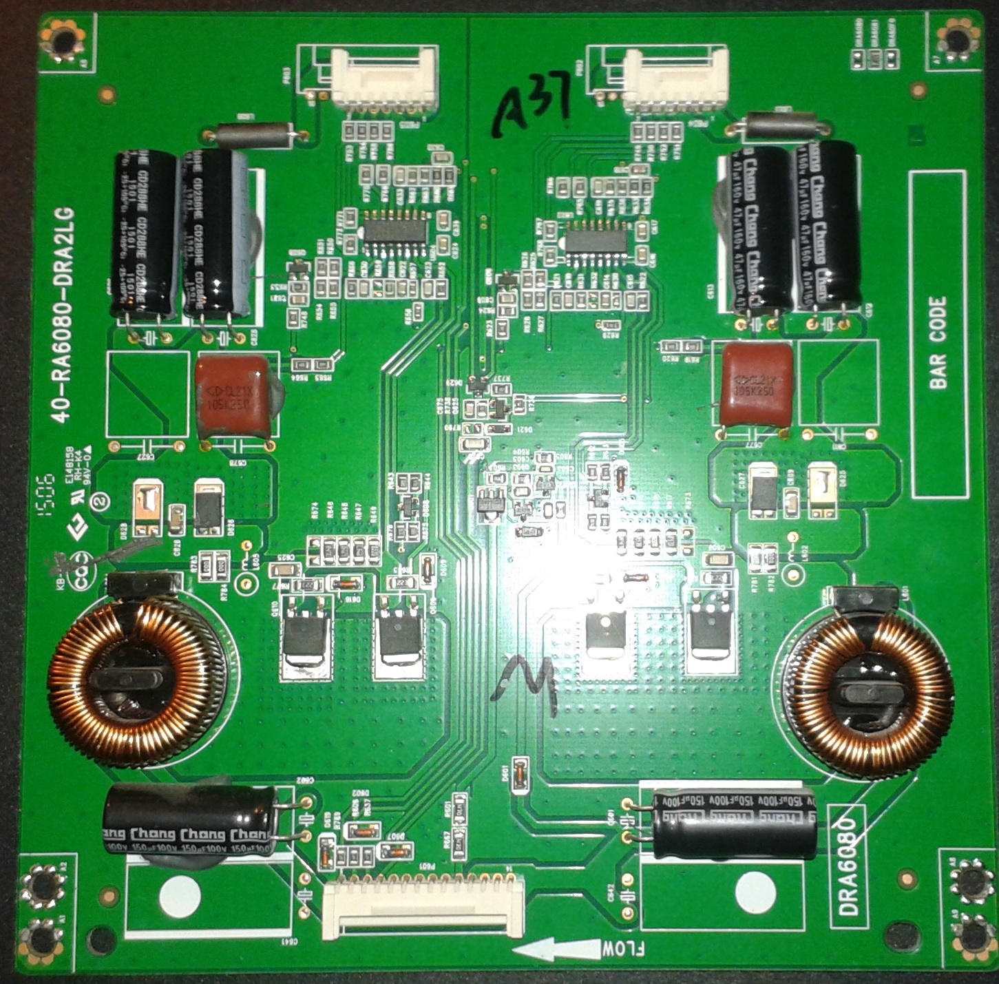

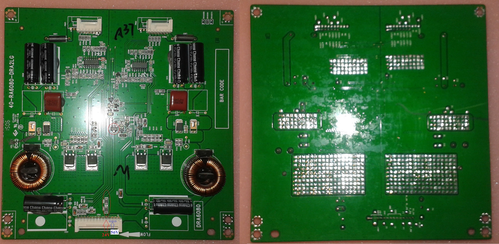

      Re: Thomson 55UA7706 LCD TV startup problem?

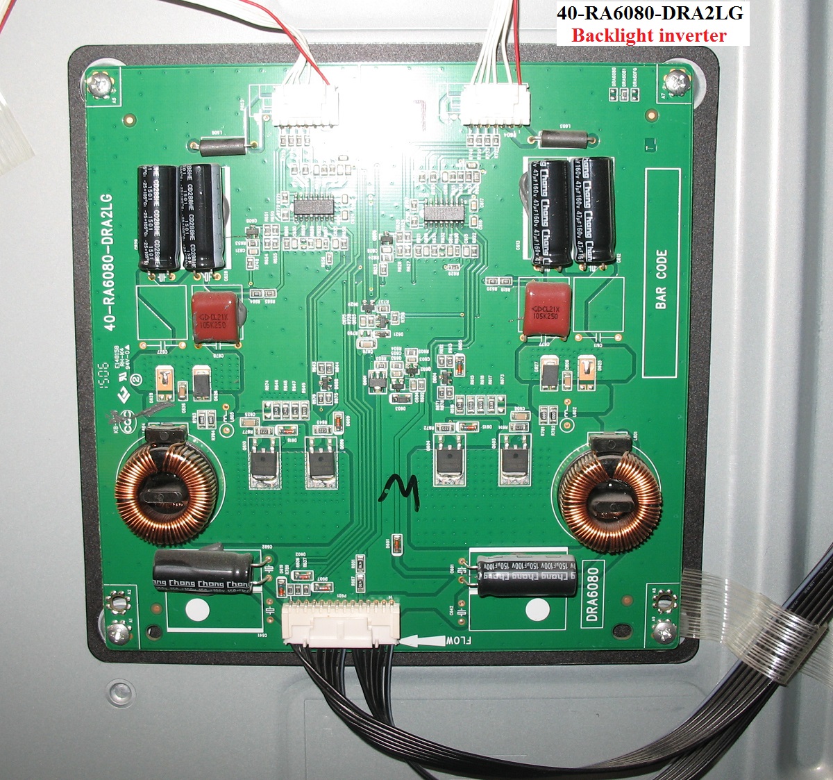

      Here it is.
      This is inverter board.
      I try this method but can you tell me - what is the purpose of this 24V node? 56V seems backlight power (72 LED in one strip, 4 groups 18 LED per group) but for what is this 24V purpose?
      EDIT: No image if I illuminate the screen from different angles with a flashlight, I forgot this to mention in the first post.
        Originally posted by SMPS
        Here it is.
        24V this the led voltage which it converted to high at led converter boards.
        you wrote you have 3,3 on BL on.. so i assume the main boards working and send signal power on and bl on..

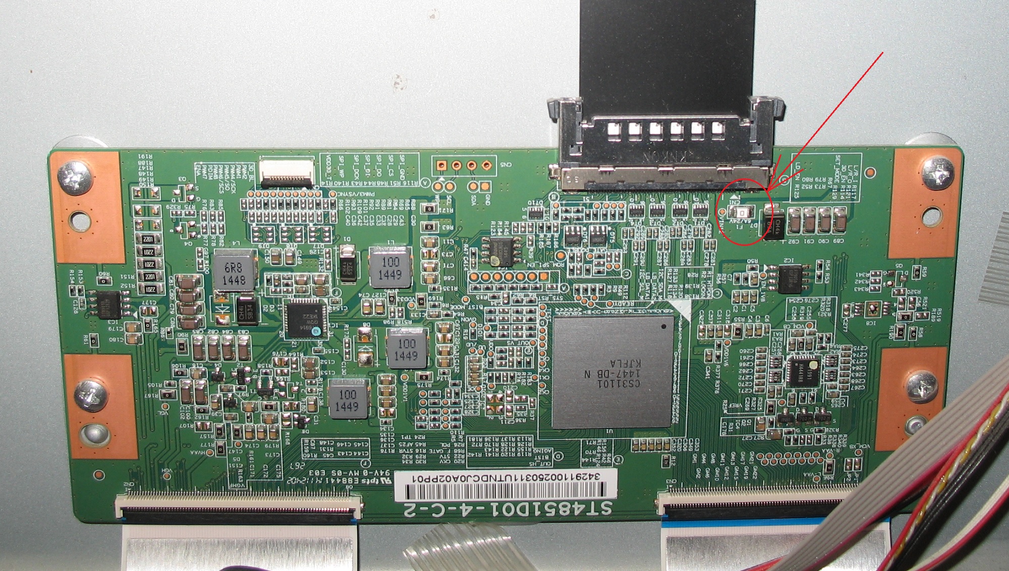

        if there is no image on screen.. you need now to check if you have 12V on the T-CON .. it had fuse on it you need to check both side of the F1

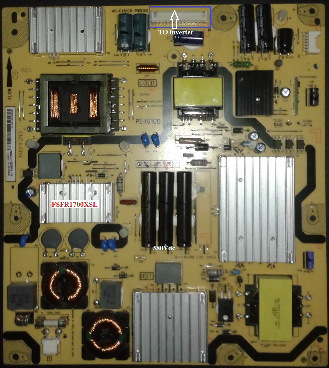

          You mean this in red circle?
          • Diah
            • Feb 2013
            • 6435
            yes this is the F1 fuse. put yours voltmeter black probe on chassis and the red one on each side of it and check do you have 12V.?

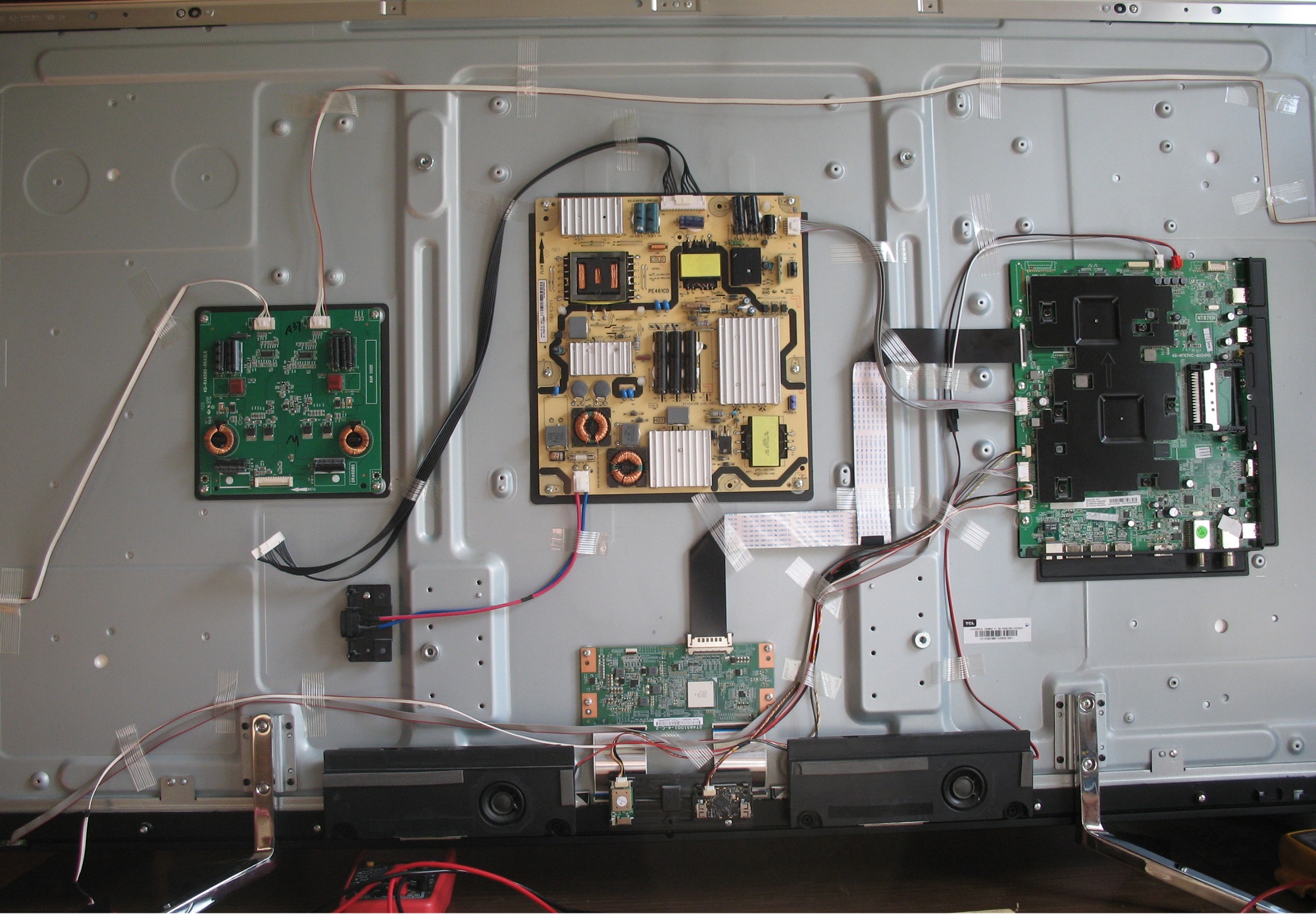

              1) Show us the pictures of the whole backside of the TV so we can see how all the boards are connected together.

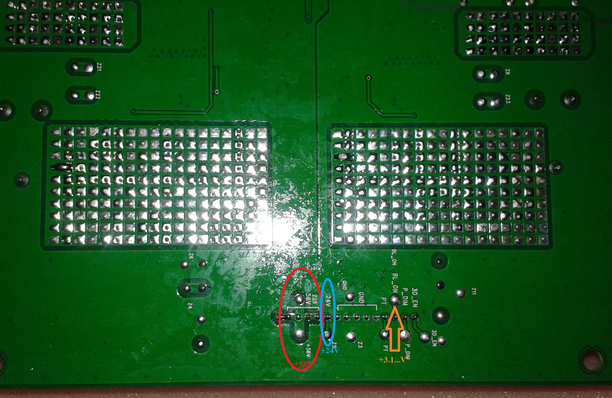

                Sorry for delay.
                Image from rear side, at below.
                Quick measurement from T-CON fuse shows that this fuse is in good conditions (continuity test).
                I haven't done this 24V circuit test yet but I will soon. How long can i turn on the tv without this 24V node? Can it damage the power supply if there is no load in this node longer time?
                If I connect a relay between this 24V wire and turn on the relay (from aux power) a few seconds after turning on the TV, will it not damage the power supply itself?
                Also, in a moment I can measure this P-DIM. When I get the result, I note here.
                EDIT
                Results are:
                P_DIM +0.430V
                Fuse F1 from T-CON, +11,988V (both sides)
                Measured at inverter board IN DC MODE:
                +56V pins: measured +41.45mV it is not very stable also - here seems something wrong ????????????
                +24V pin: measured +22.92V (little low but not very?)
                PT pin: measured +0.55mV
                BL_ON: measured +3.109V (little low?)
                P_DIM: measured +0.4316V
                3D_EN: measured +0.62mV
                  no need any relay ..
                  its save if you unplug the socket of 24V between PWB and LED converter boards.
                  so keep the socket unplugged.. and measure the 24V to see it come high to 24 or remain 22.92V.
                  by the way you should hear sound and can see picture on panel with torch ... if no sound or picture.. you can put back the socket of 24V in place.. and just disconnect the panel from T-CON ( just unplug the 2 ribbon cable from T-CON side) and turn on the TV ..check the back light come on or not
                    OK.

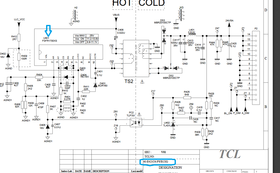

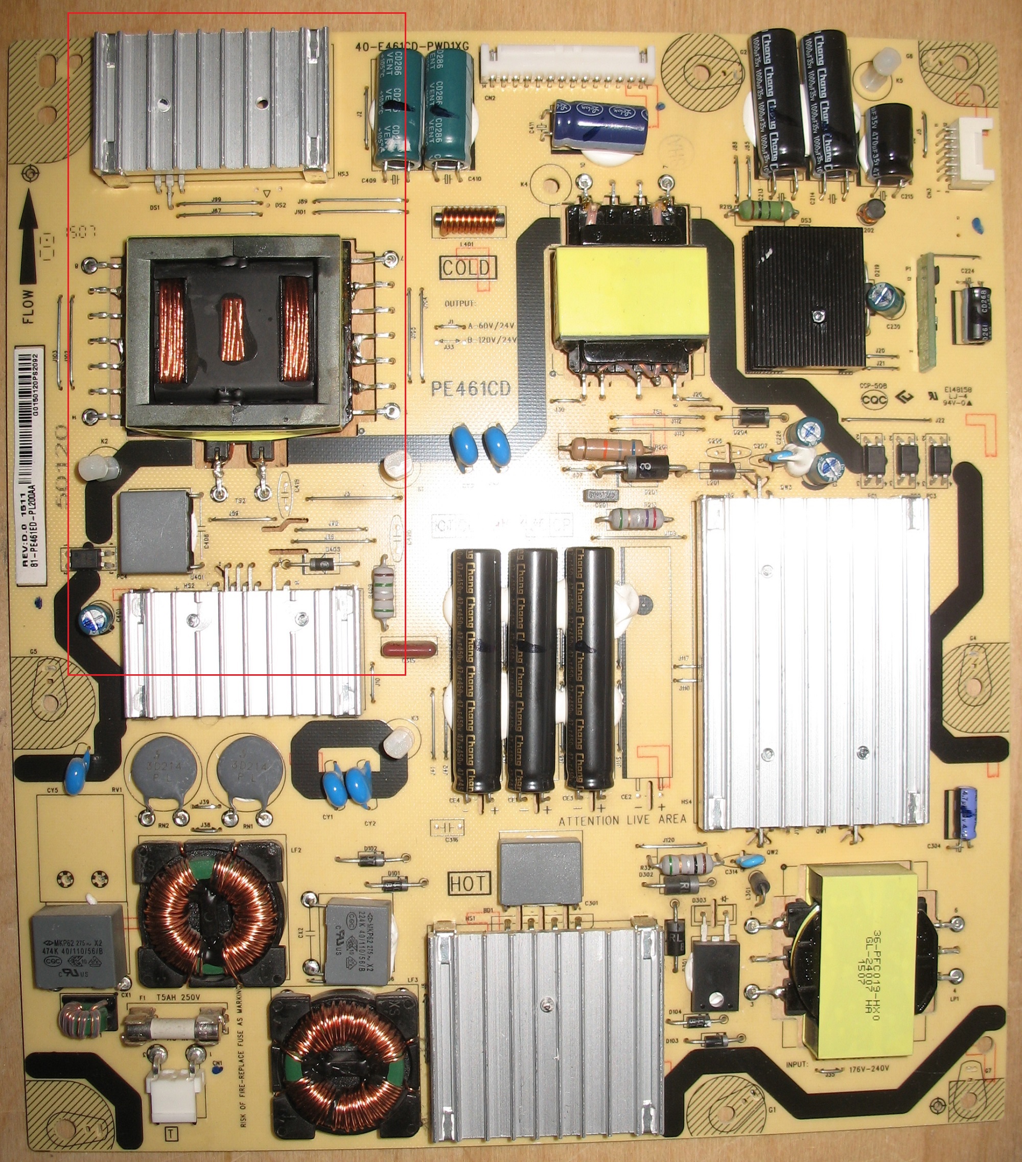

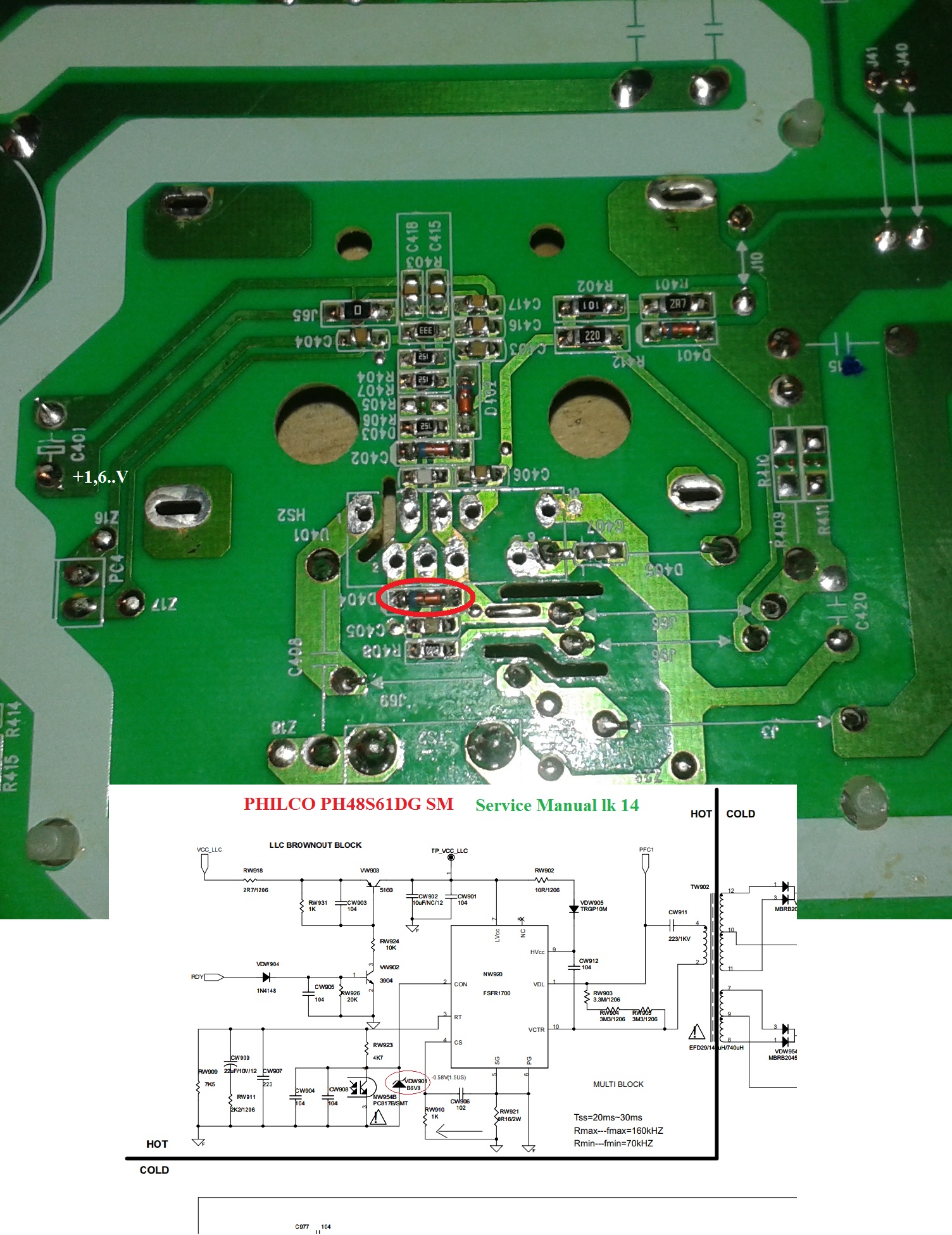

                    Haven't tried it yet but main PSU contains a FSFR1700XLS resonant converter switch https://cdn.badcaps-static.com/pdfs/...f141f56ce1.pdf
                    Found that there is one zener diode in this circuit part which is shorted, it is not exact circuit like Philco PH48S61DG (service manual page 14) but there may be some reference, this part of this main PSU produces LED driver +56V which I dont have. Hope that this FSFR1700XLS itself is good but I cant see any marking in this shorted zener (D 404 in picture) body, only blue band - what it is?
                    • SMPS
                      • Aug 2020
                      • 18
                      • Eesti
                      Nobody
                      I searched with different methods to maybe find some circuit diagram or fragment but nothing, in this PSU board is printed also: 40-E461CD-PWD1XG
                      But google says - no circuit diagram or even fragment this FSFR1700XSL part.
                      There is multiple PSUs which use same IC but all are little different - and I dont know what zener I can use to replace this D404 (measured, shorted) - there is also D402 and D403 and they are both 18V zeners (measured).
                      What happen if I connect this D404 place for example 9.1V zener or 12V (i dont have this 18V at this moment and local store does not sell SMDs).
                      Or can I just series connect two 9.1V one and just try? But if there must be some other (higher/lower) zener value, what is the result?
                      Most closest circuit I find is 40-E421C6-PWB1XG, there is weird note thereat D404: 79C18V (bzx79c18V?) but why - other zener is marked just 18V, why this exact D404 is marked like recomended model?

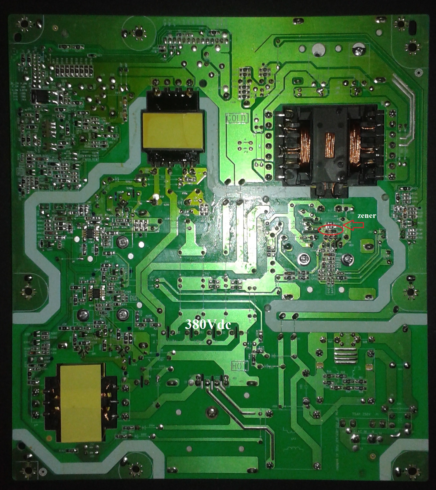

                      • SMPS
                        • Aug 2020
                        • 18
                        • Eesti
                        Want to EDIT last post but I cant
                        OK, last post here - no help and seems like there are not even like-minded people
                        Anyway, replaced this broken zener with 18V THT component but no change.
                        If before red standby light came on then now it stays off - broken zener=standby, new zener=no standby and no power.
                        I cant any information nor google, nor yandex, nor other search engine - why this zener is here? what they do here? What happen if they are too high or too low values or what happen if you leave it out at all? I cant get any information - from FSFR1700 datasheet there also not either even a little similar reference design...
                        There is not problem this 24V node, nevermind - this TV LED driver need 56V to feed LED stripe, there is 18 LED in one string, there is 4 strings in one stripe, one string need 56V to came on, no 24V , no, this 24V pcb track is maybe 0.5mm wide and there is no change that this current which 144 LED needs can get through this trace.
                        And this +24V is close enough +22,9V but - can't forget that there must be +56V, much higher current than this 24V and there is very little voltage at this +56V node, this is much biggewr problem I think...but OK, seems like there is no help anyway, some ask picture but no any words afterthat...hope that this "TV-inside picture collection" gives something interesting.

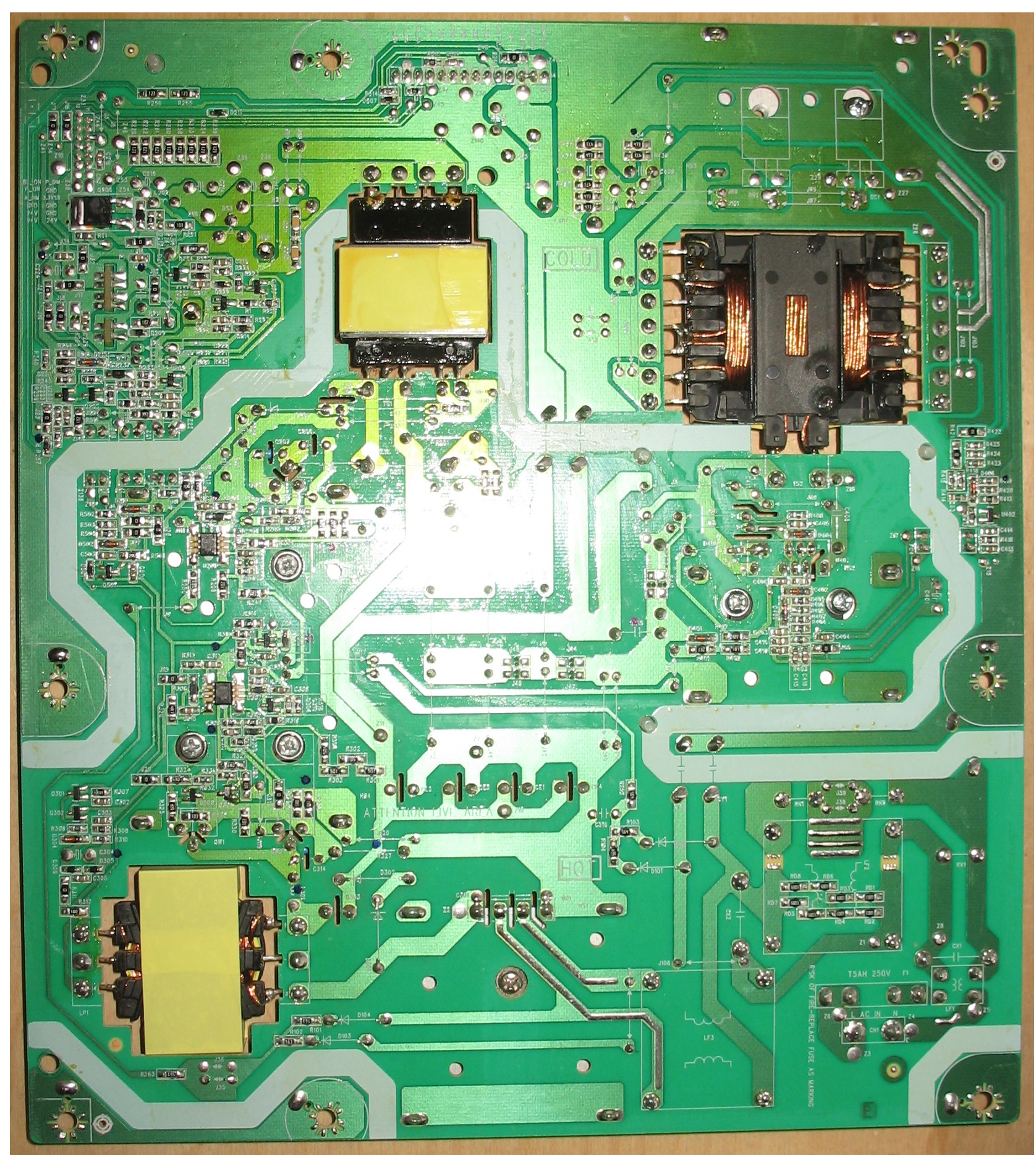

                                    2) Can I get good clear straight shots pictures of the whole top and bottom side of the power supply board? Right now your pictures are not clear enough for me to clearly read any prints on the board.

                                      I think that this maybe is also not good but I have night and my phone cam is not good to make better pictures.
                                      And if I want take a picture to whole pcb, i cant take it very close
                                      There is limit also if I take many shots closer and put them together.

                                      Maybe now is really time to throw it away or only new PSU because (this service manual searching led me trought multiple manuals) all TV PSUs nowaday seems very bullshit - tens of different "failsafe" circuits which fail first itself... for why?
                                      At this moment I dont really know anymore - maybe this fault is now gone further now because there is not a way to sort it out - sure that I have very little change to get this model PCBs at my country..
                                      Need to order and even then there is 50/50 change. This psu IC also - I can order it but if there is "failsafe" which lets smoke out this IC to protect this "failsafe" circuitry - what is the point to order and solder. I dont really understand - broken zeners, weird voltages...I have to repair some time ago much valuable PA amps and there is no this kind of "failsafe" things, I was made this year some IR2153, IR2161, IR2156 based smps to my DIYbuilt amplifiers and there is not this kind of "failsafe" there is no problem also if user know what they do...TVs and their "systems"...i dont have a words more
                                        1) The pictures of the boards are very poor, I cannot read the pin label (the oin names are printed on the bottom side of the board) of the connector of the power supply board that goes to the LED driver board.
                                        2) Were you getting 24V to the LED driver board? And now you don't since you start playing with FSFR1700XSL and D404?
                                        3) The 24VDC is generated by FSFR1700XSL so the circuit was working. I do not understand why you start messing with the FSFR1700XSL.
                                        4) As you can see that D404 is connected in parallel with resistor. So when you check D404 off the board, does it show conduction and low resistance (<10 Ohms) in both directions.
                                        5) Right now you need to get the FSFR1700XSL working again before going back to troubleshooting the backlights issue, or just buy a new power supply board assembly that match the number on the barcode sticker, not the blank PCB part number..
                                        6) Where is the pin that is supposed to have 56V?
