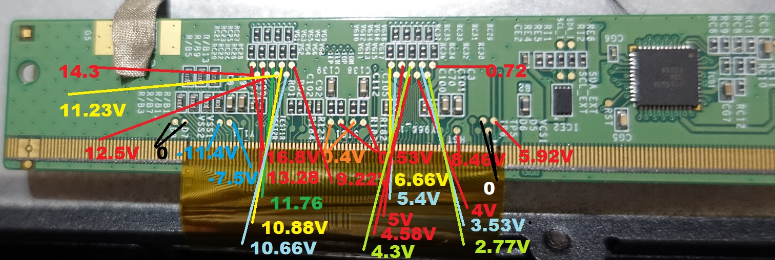

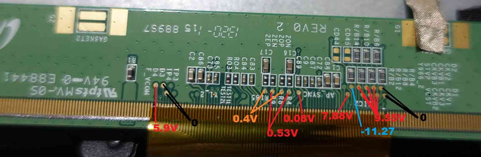

    LED JVC LT-40N530A half screen black.

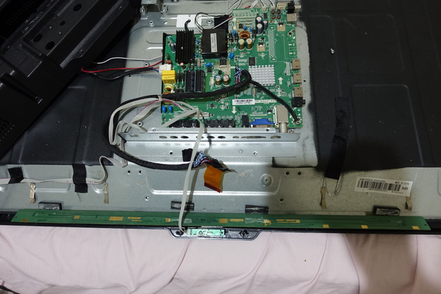

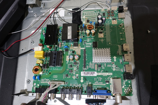

    Main:
    tp.sis231.p83
    T-con
    KSZ80_OB_S4LV0.2
    E88441
    T-con has:
    rt6503a
    bm81204 317 h56
    AMLCD LQF6041T0B-01

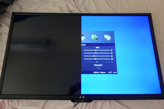

    First, it had stripes on the right side. Pushing the top corner changed them, but not removed. I disassembled the TV, and since that all that side is black without stripes.
    I checked a lot of suspicious things. Found that no matter where I push there will be no stripes anyway. Seems, there are different issues.
    Found dodgy voltage INV_V randomly jumping from 1.4 to 1.8V on T-con. But I also not sure that the main board is fine.
    Also, on the problem side of T-con there is no negative 7.5 volts, not sure it by design or a bug.
    Any ideas?

      Re: LED JVC LT-40N530A half screen black.
      Show us the screen shots of what the image looks like on the screen.

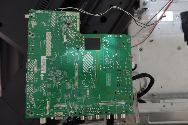

                  could you please upload photos on the LVDS socket at main boards and the area around from both side,, there should be R or F1 for VCC

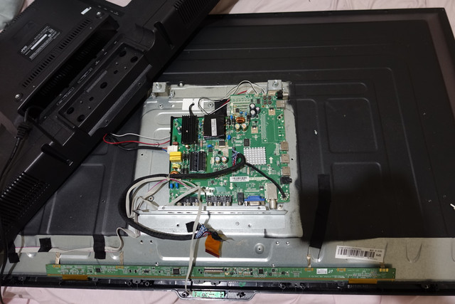

                    Can you show us the whole length of the board and also the pictures of the whole backside of the TV showing all the boards?
                      LVDS is 40-pin, unplugged for better view. Not sure about R or F1.
                        this is JVC TV !!! its Chinese DIY TV LOL
                        you need to take out the LVDS complete out from this DIY and sitting at comfort place and start with yours DM Beep Ton to test all pins from MB side to the end of ribbon cable which it goes to the panel socket.

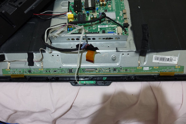

                          T-con in good res
                          https://freeimage.host/i/26oVMx
                          https://freeimage.host/i/26oW6Q
                                Maybe try hitting all the boards driver board included with a hairdryer, warm it up kind of toasty and see if there's any difference on display.
                                  https://www.badcaps.net/forum/attach...0&d=1601724264
                                  Did you check the resistance of those MLCC (Multi Layer Ceramic cap) in that section to see if any of them show low resistance reading, I.E. <100 Ohms?
                                    Checked all, found 3 groups below 100 Ohms. From left to right:
                                    1) 0 Ohm, both signed as test
                                    2) 44-45 Ohm each.
                                    3) 10 Ohm each.
                                    There is nothing like a single broken one. Either whole group is broken, or fine.
                                      Measure just the capacitors, skip the resistors for now, the caps have a C by them on the board.
                                        2) 44-45 Ohm each.
                                        3) 10 Ohm each.
                                        You tested the wrong the parts.
                                        C = Capacitor
