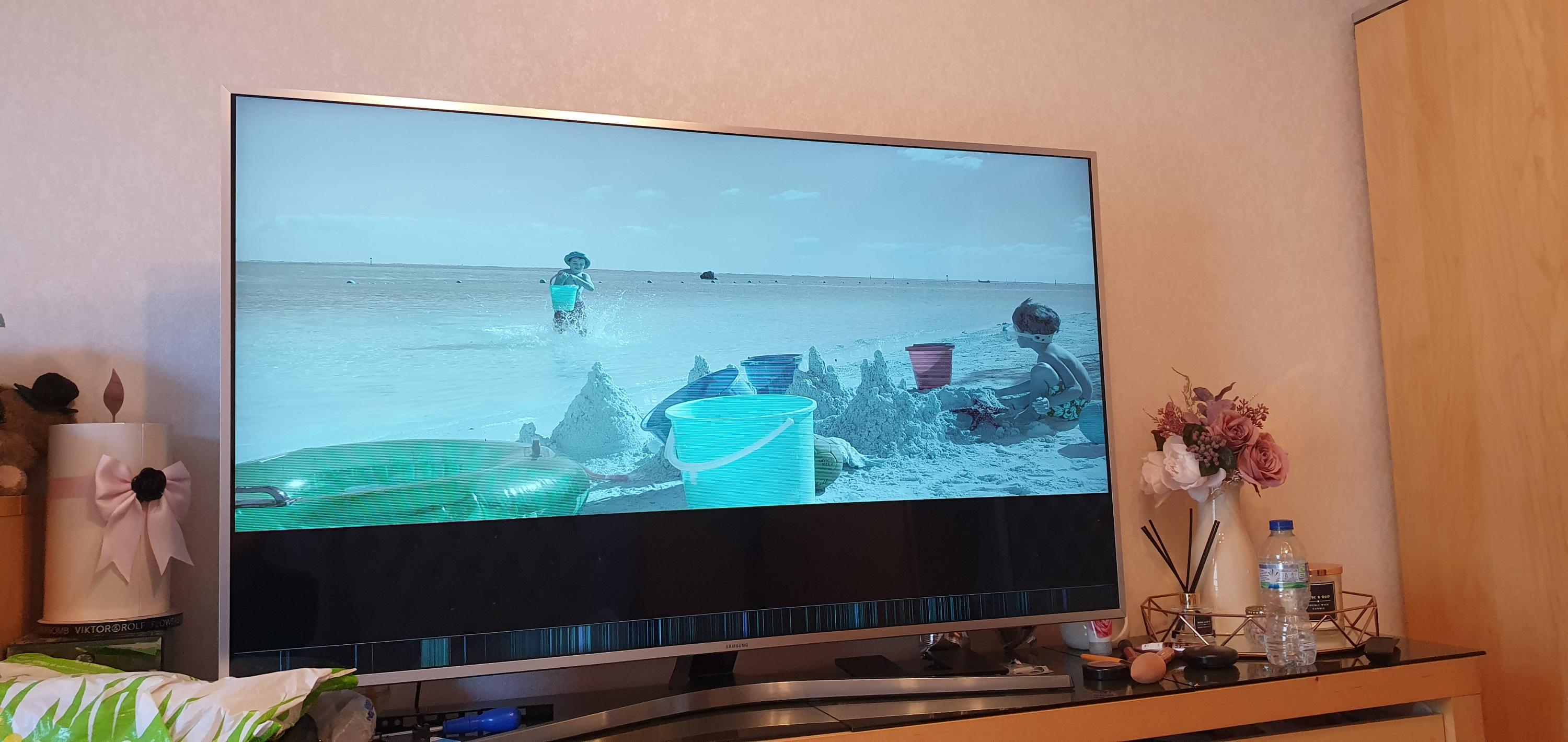

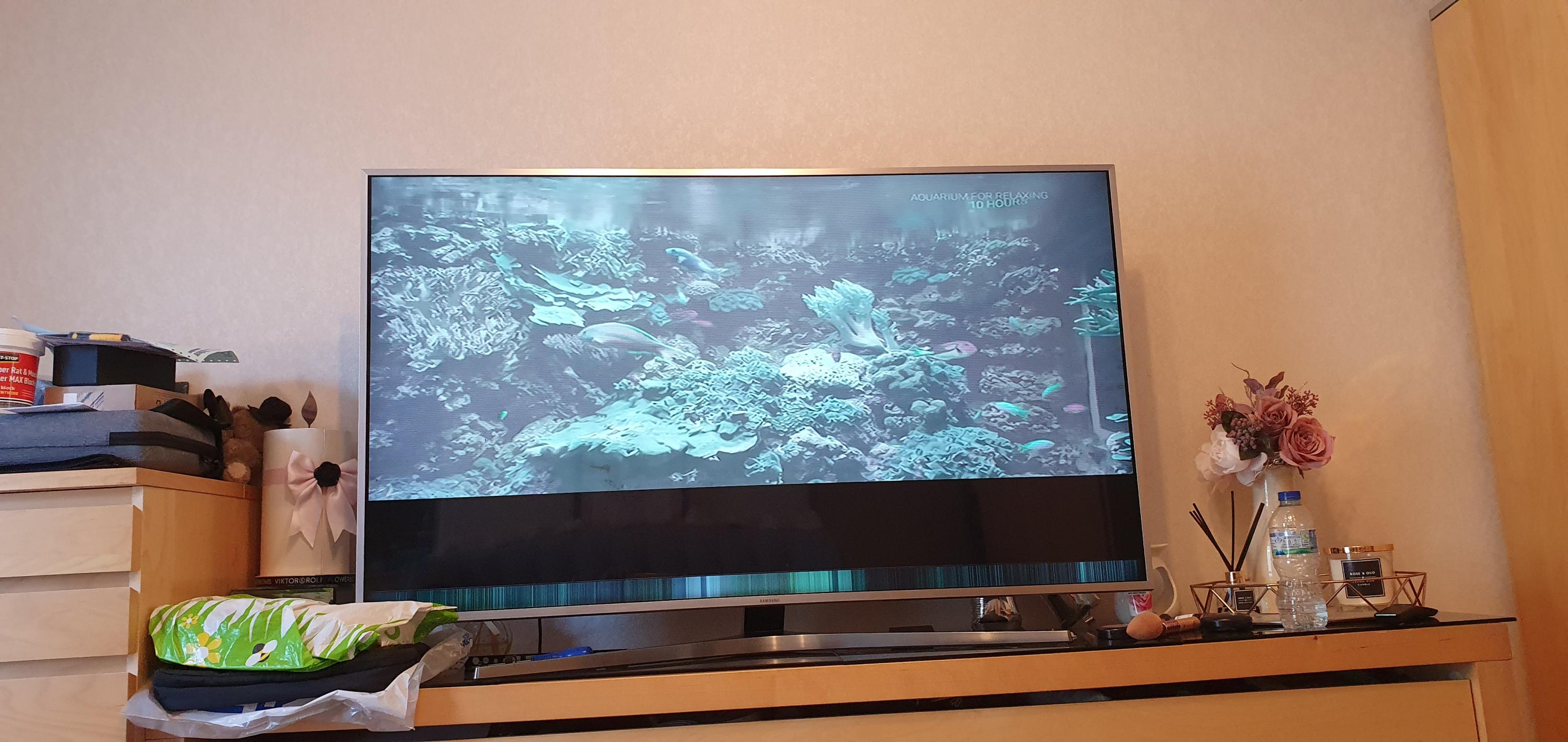

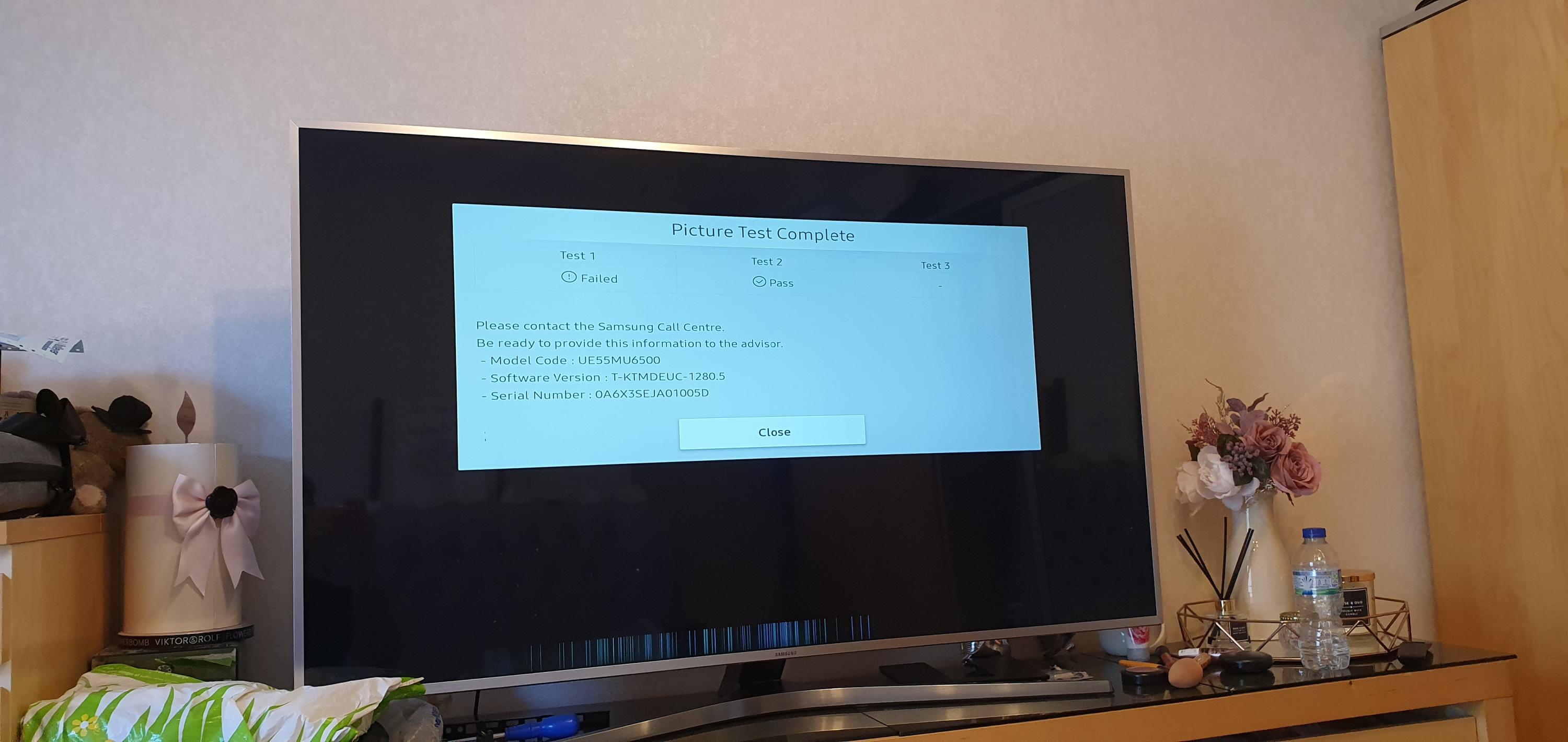

        Ok all - I have managed to kind of fix this, the issue was indeed the mainboard. I have bought a mainboard for UE49MU6500, and change the settings in the secret menu so that it now reads as UE55MU6500 for my 55 inch - BUT the picture is all messed up? Any way to fix this????

              Been playing around with them for days not found anything that seems to fix it. I have selected the correct panel which matches the code on the tv still no luck
