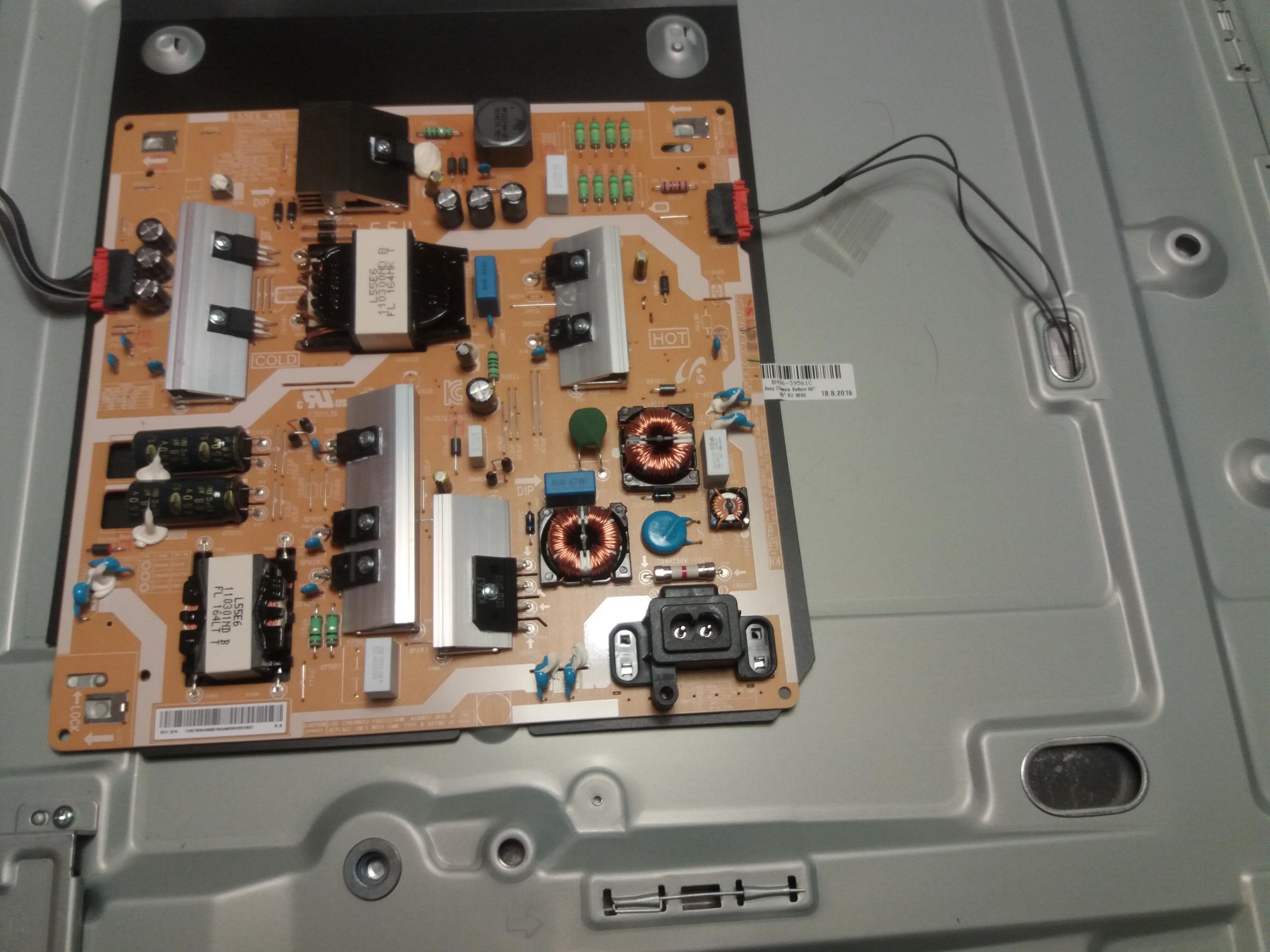

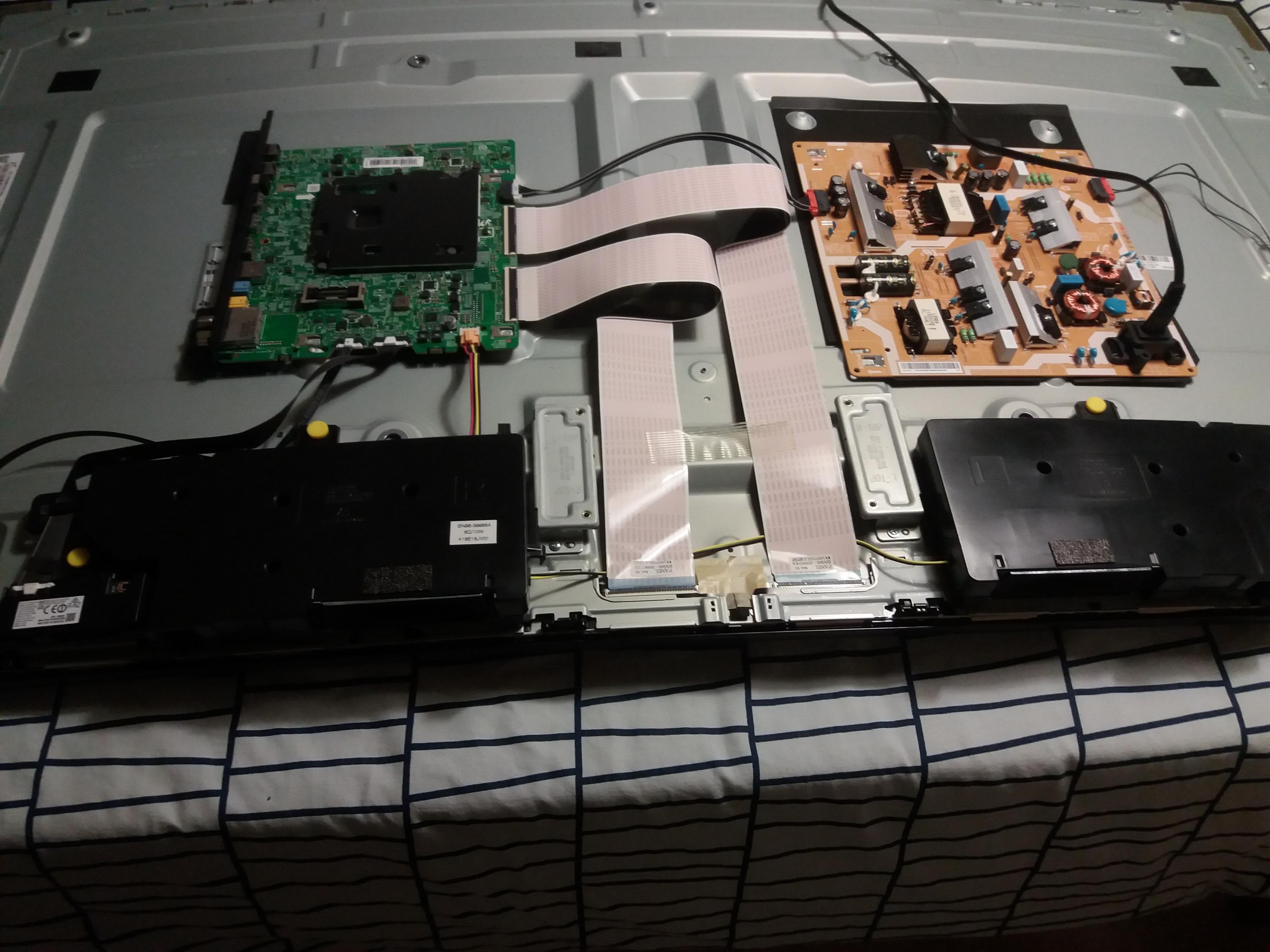

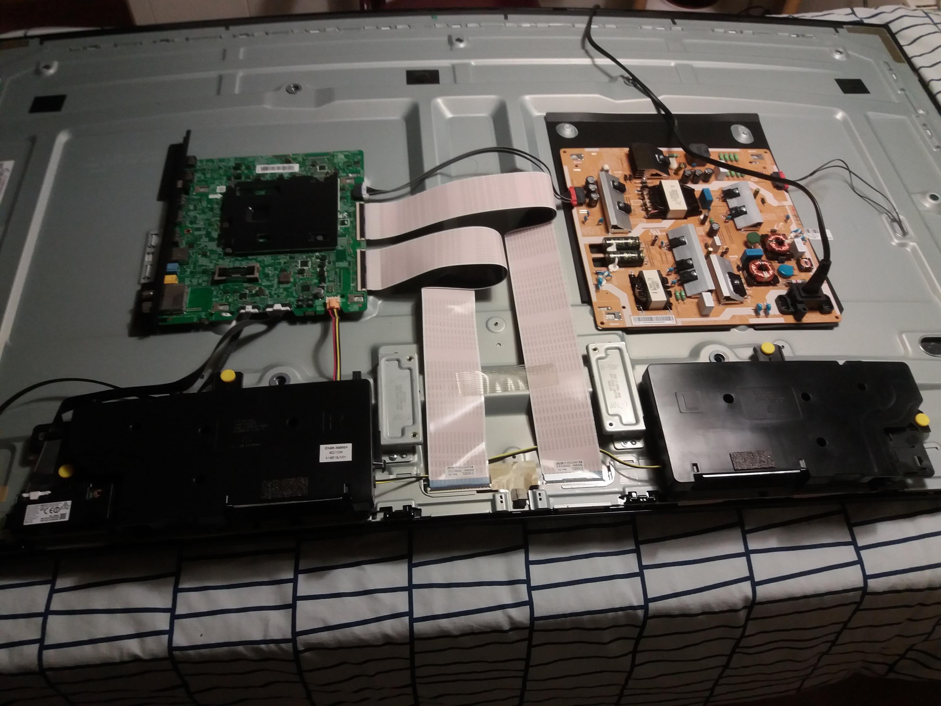

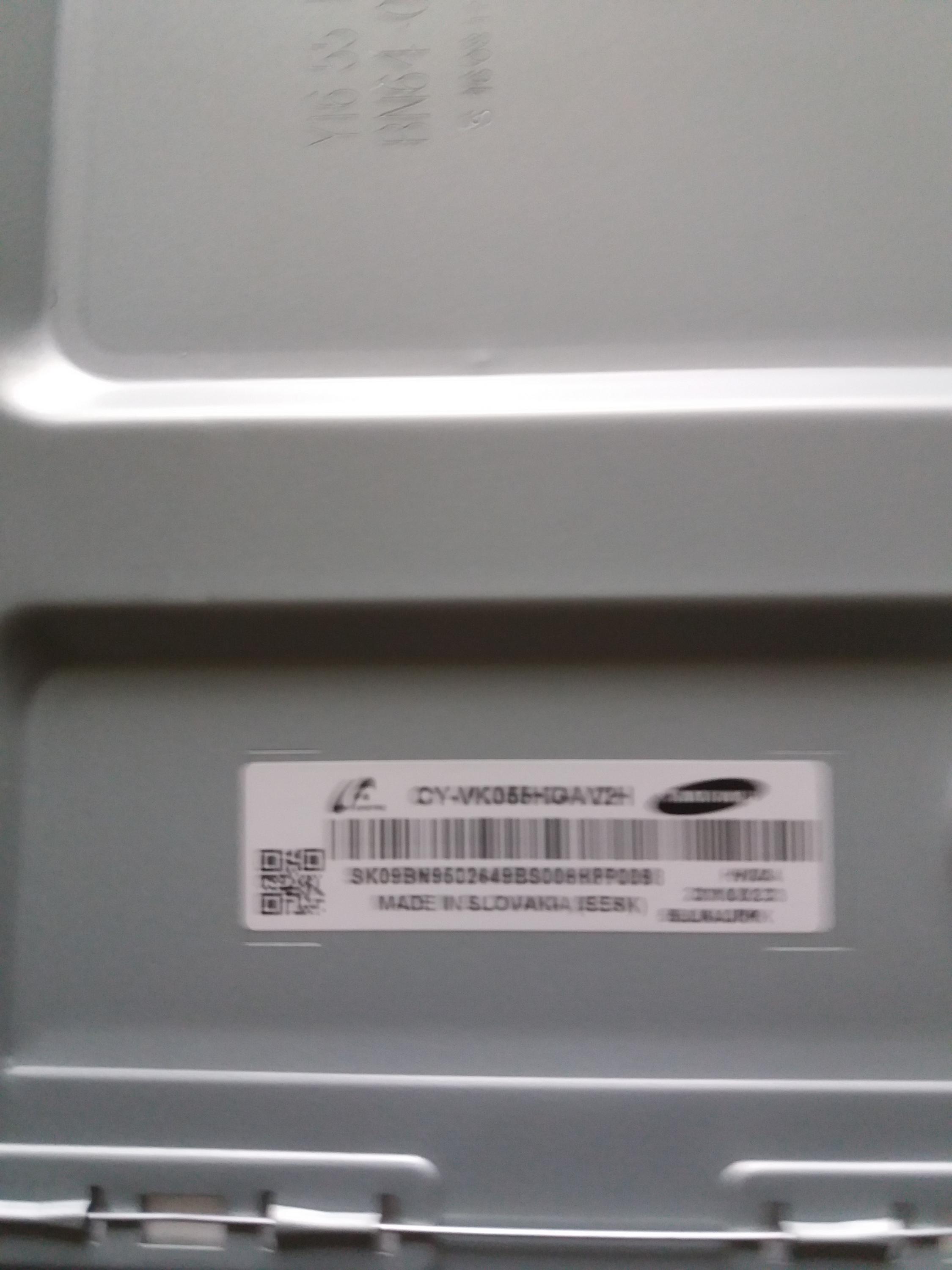

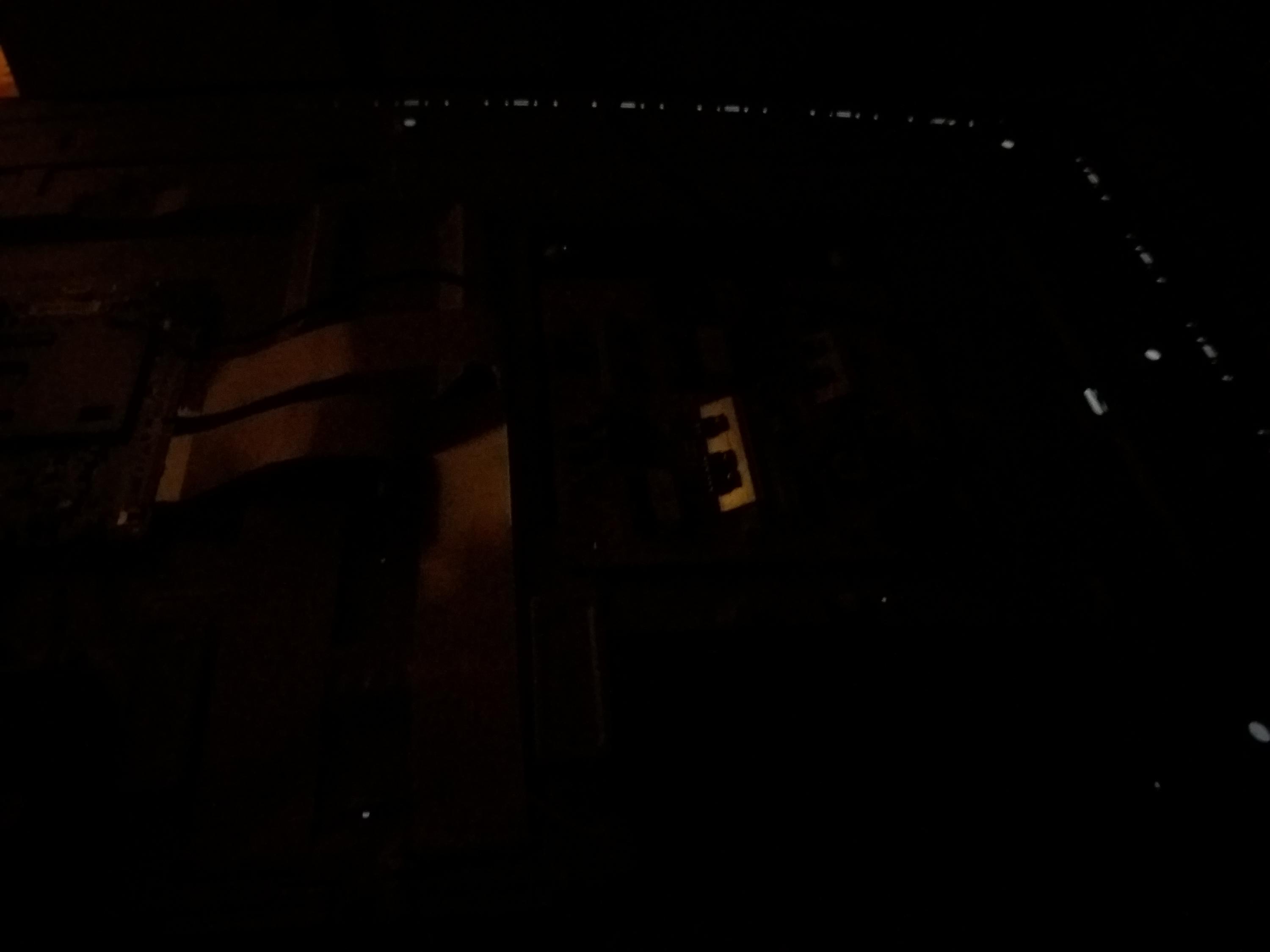

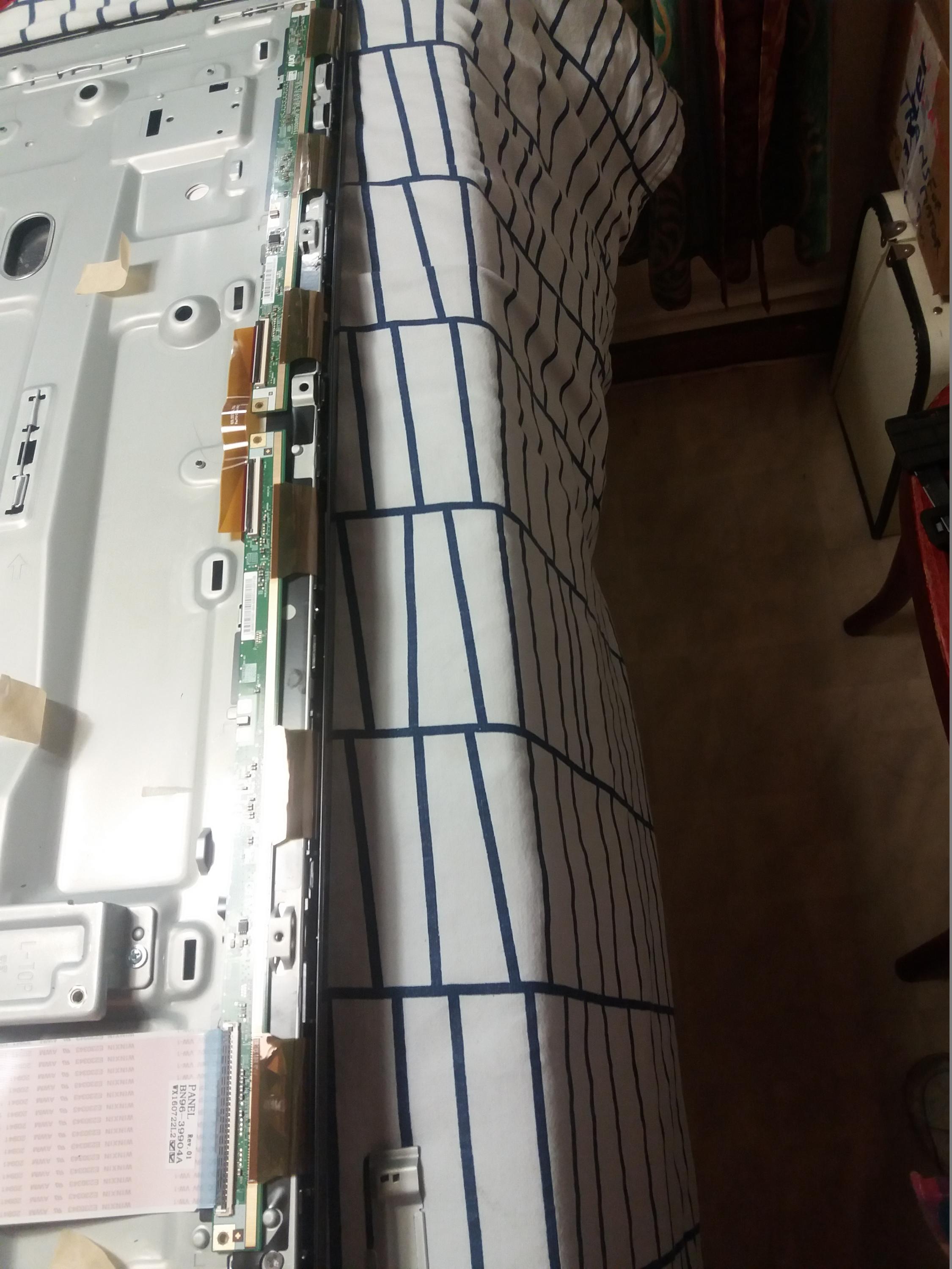

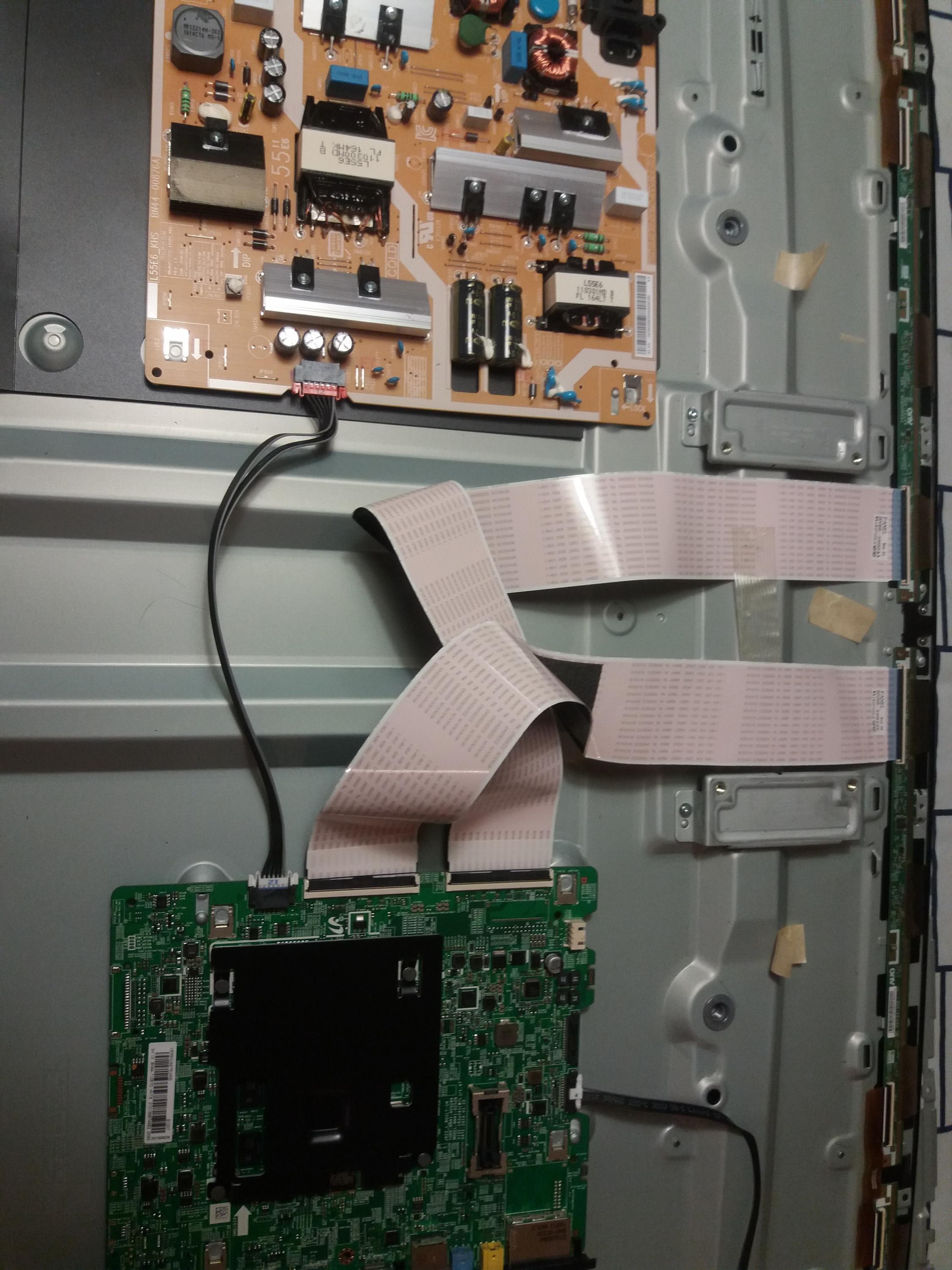

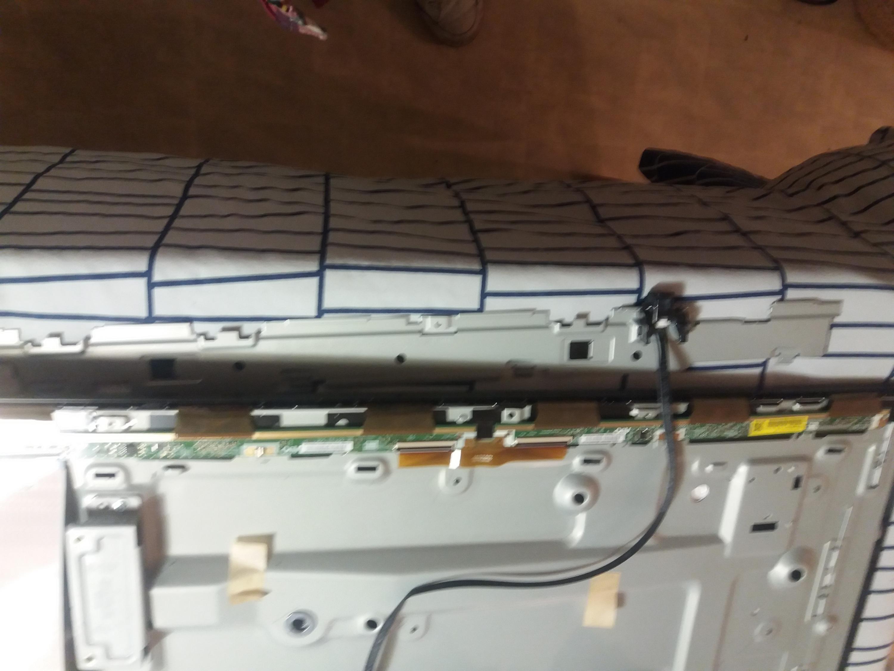

    hi As the title says this curved tv works but shows only half the screen wondering where the fault lies thanks.Here are some pictures
    Note: First and second pictures show the back of the TV the side that works very dark picsorry

        Re: Samsung UE55KU6575U SHOWS ONLY HALF SCREEN
        Looks like the backlights are out on one side. Test the backlight LED's with a tester or if you can read the value off the psu a dc power supply set to about 60% of that voltage can work as well.

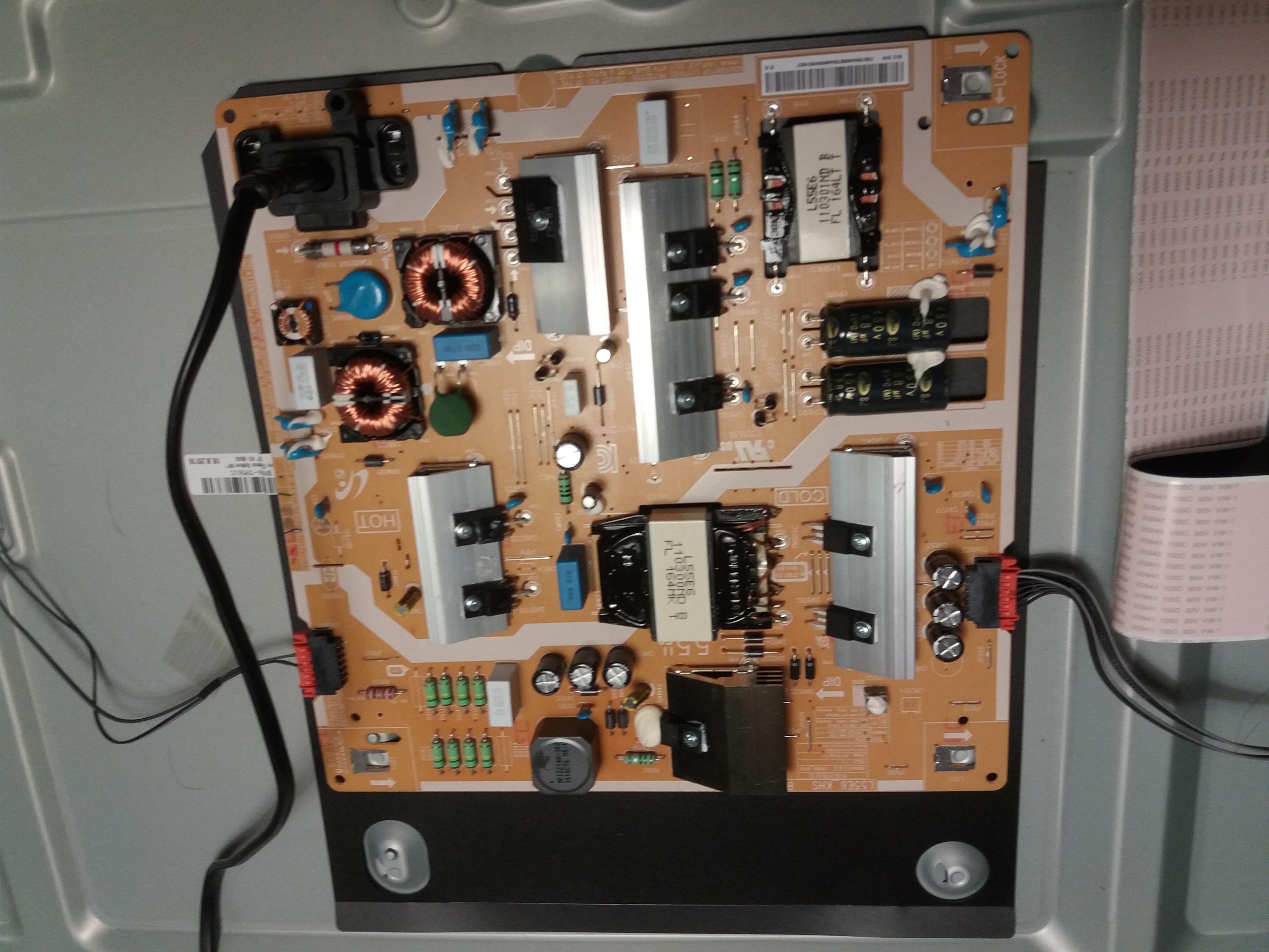

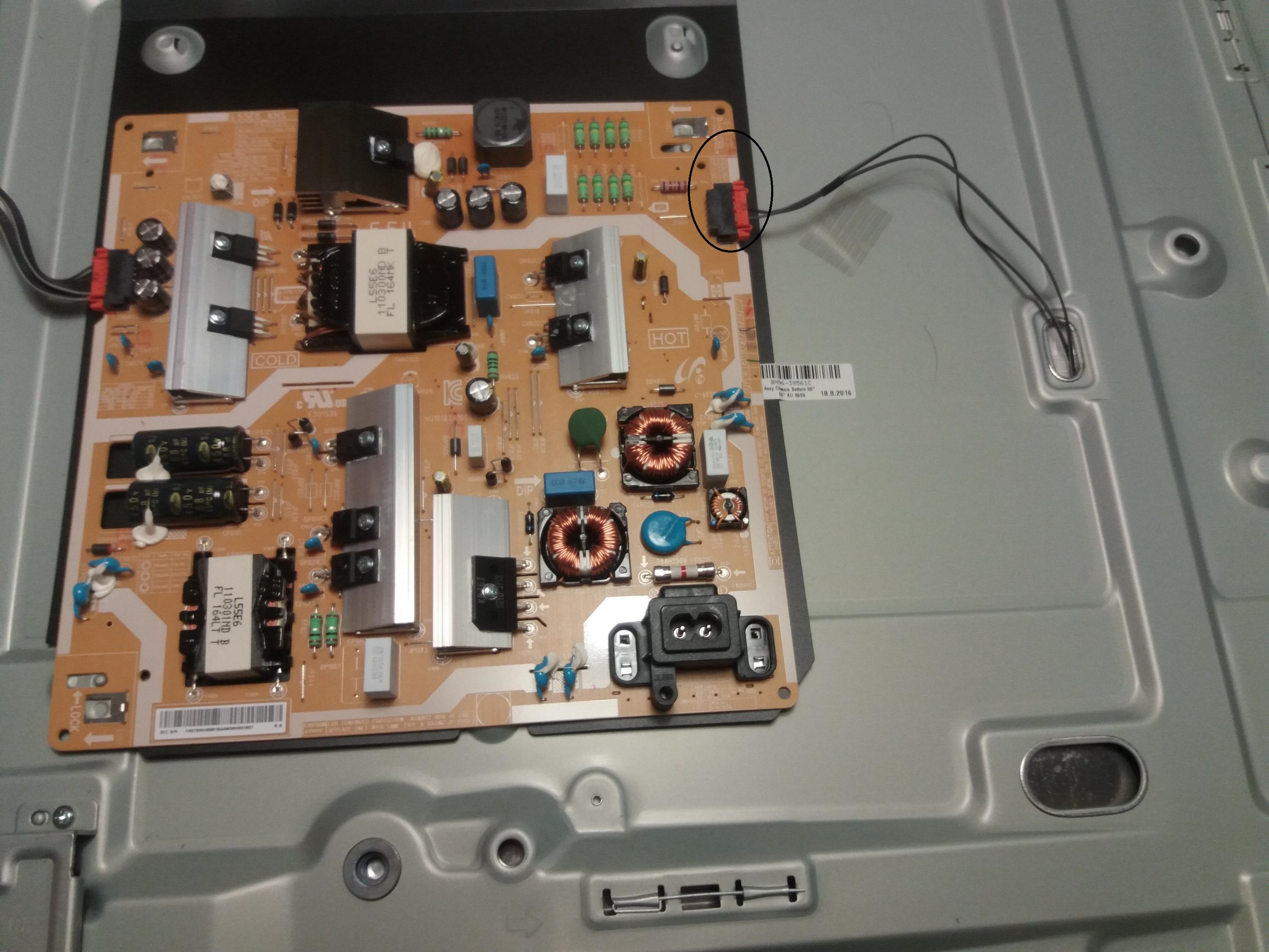

              look at / near the cable running from the power board to the panel (leds). There is likely some labeling for the pin outs. You can monitor / measure the voltages there at startup. Go from the results which will likely tell if you have led problems. Post a better picture of the power board area to help the forum and yourself.

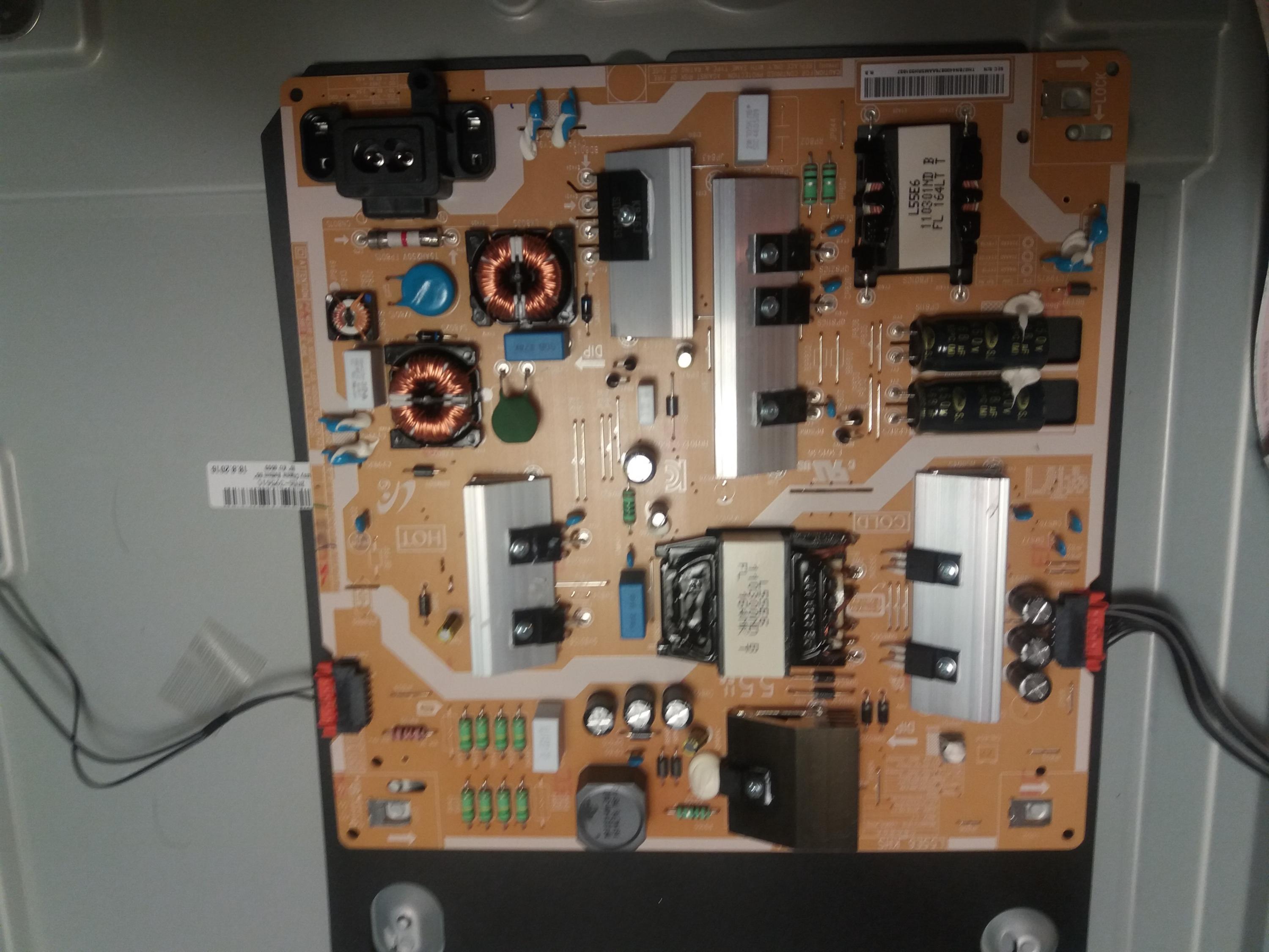

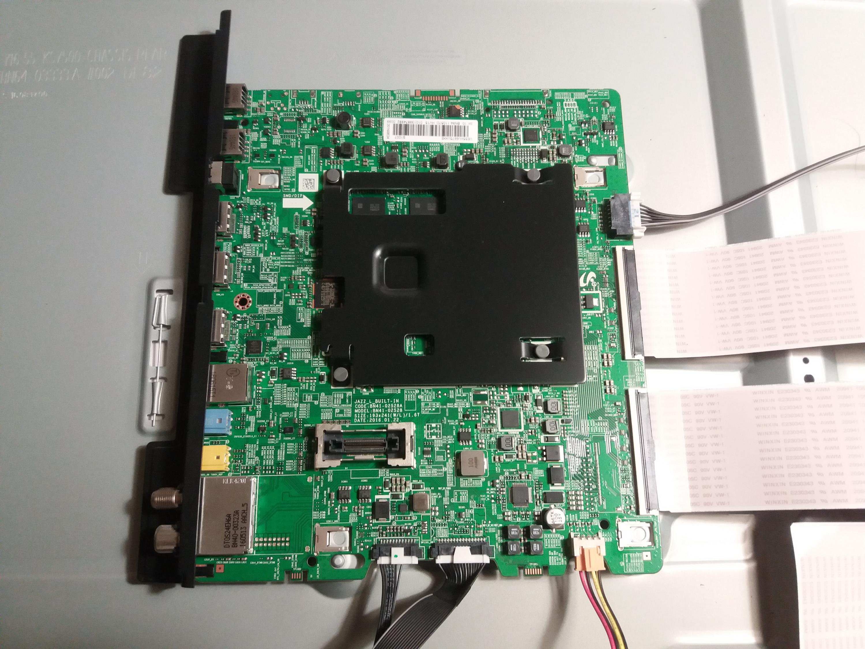

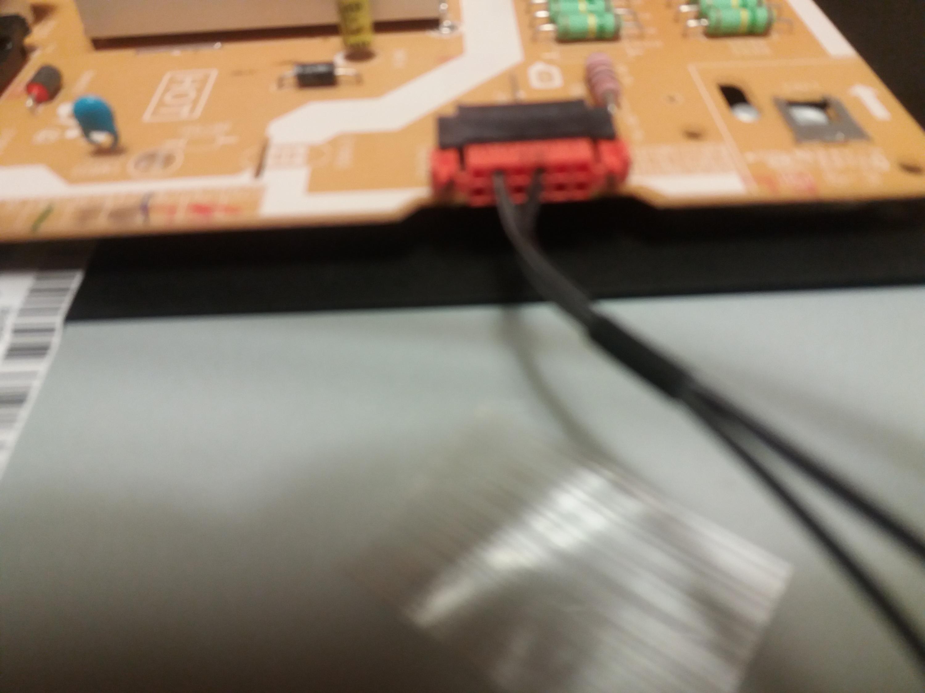

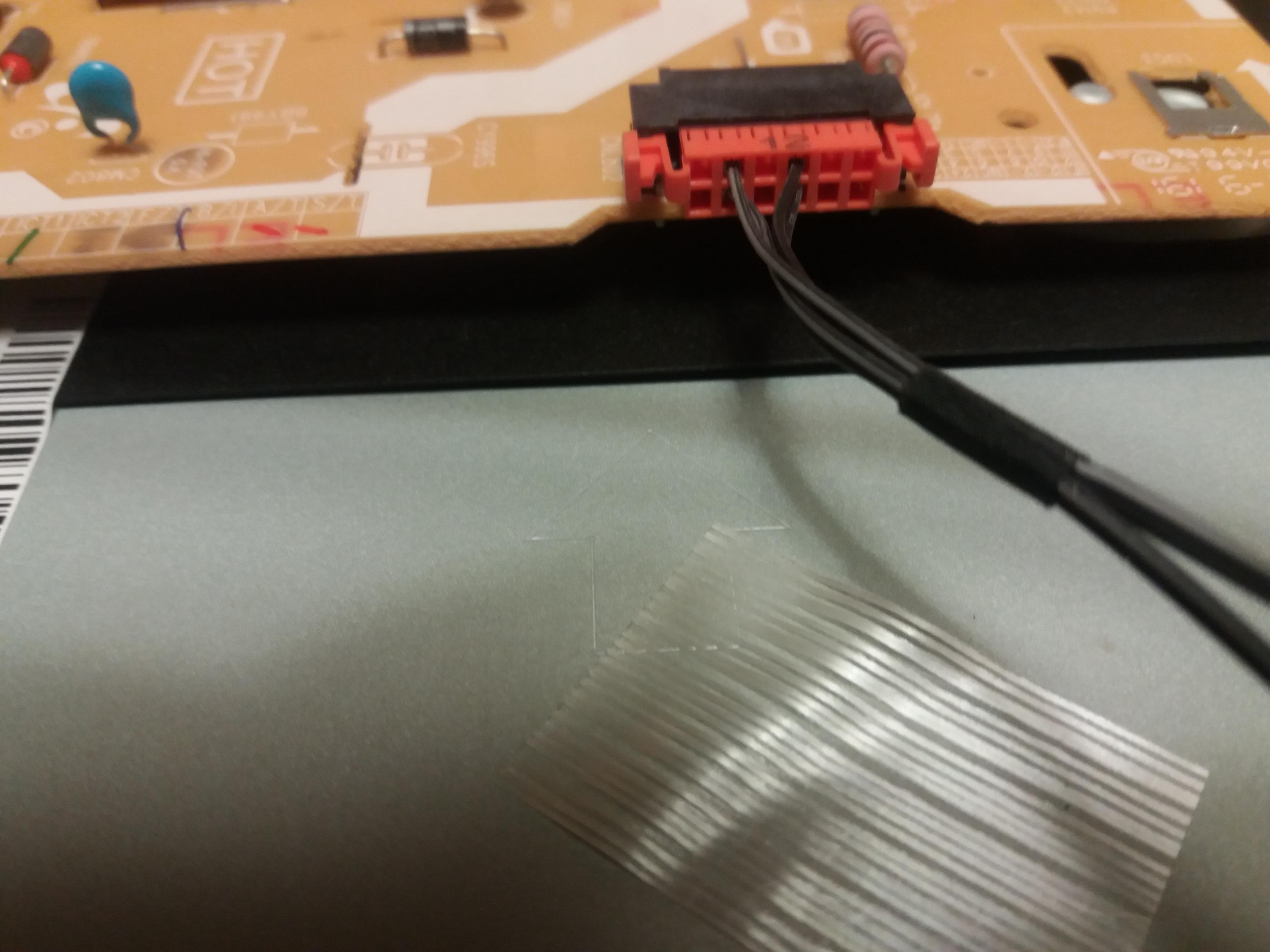

                Hi there is not any label to point to any pin you can se it on the pics i hope they are better this time

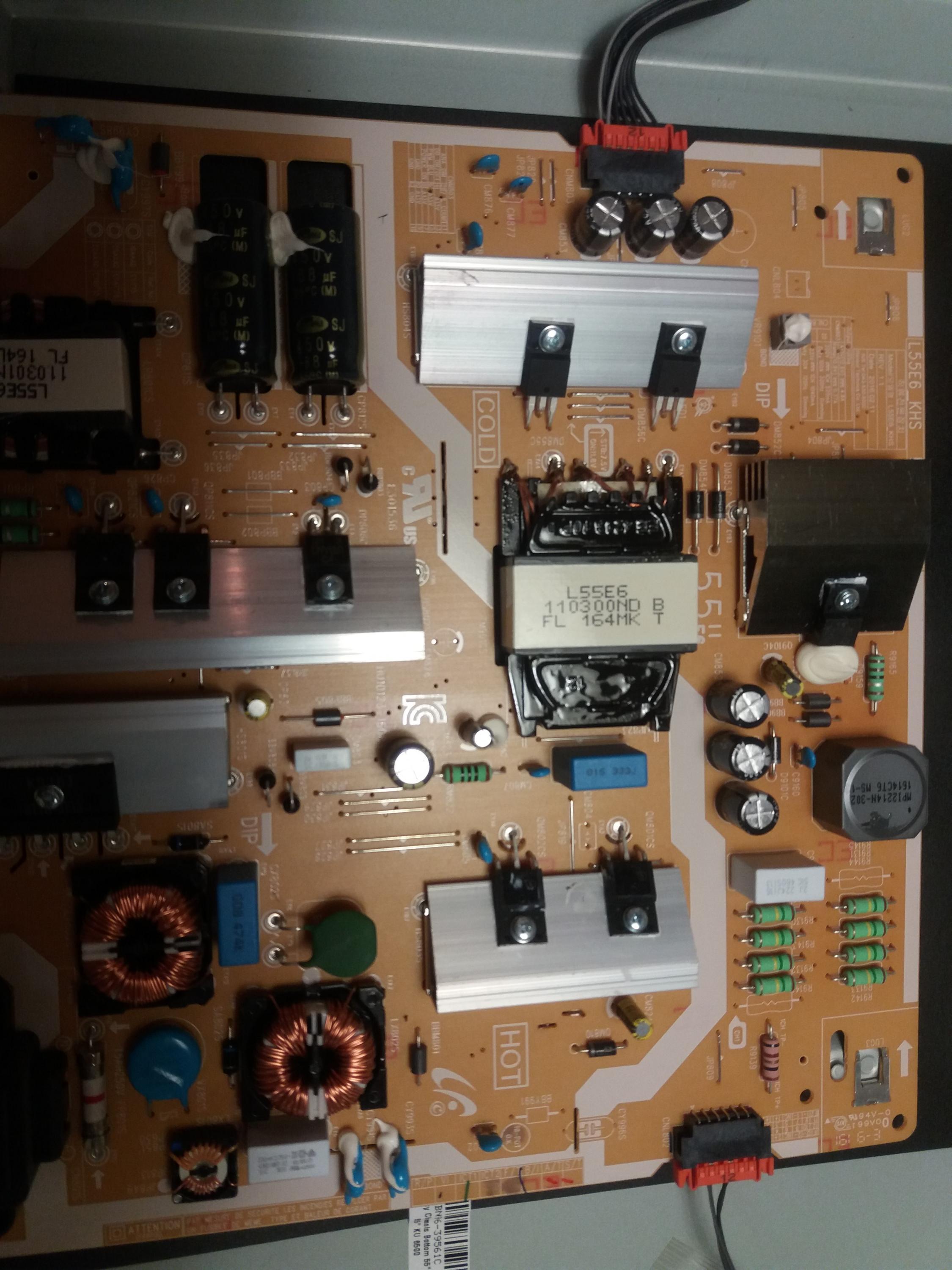

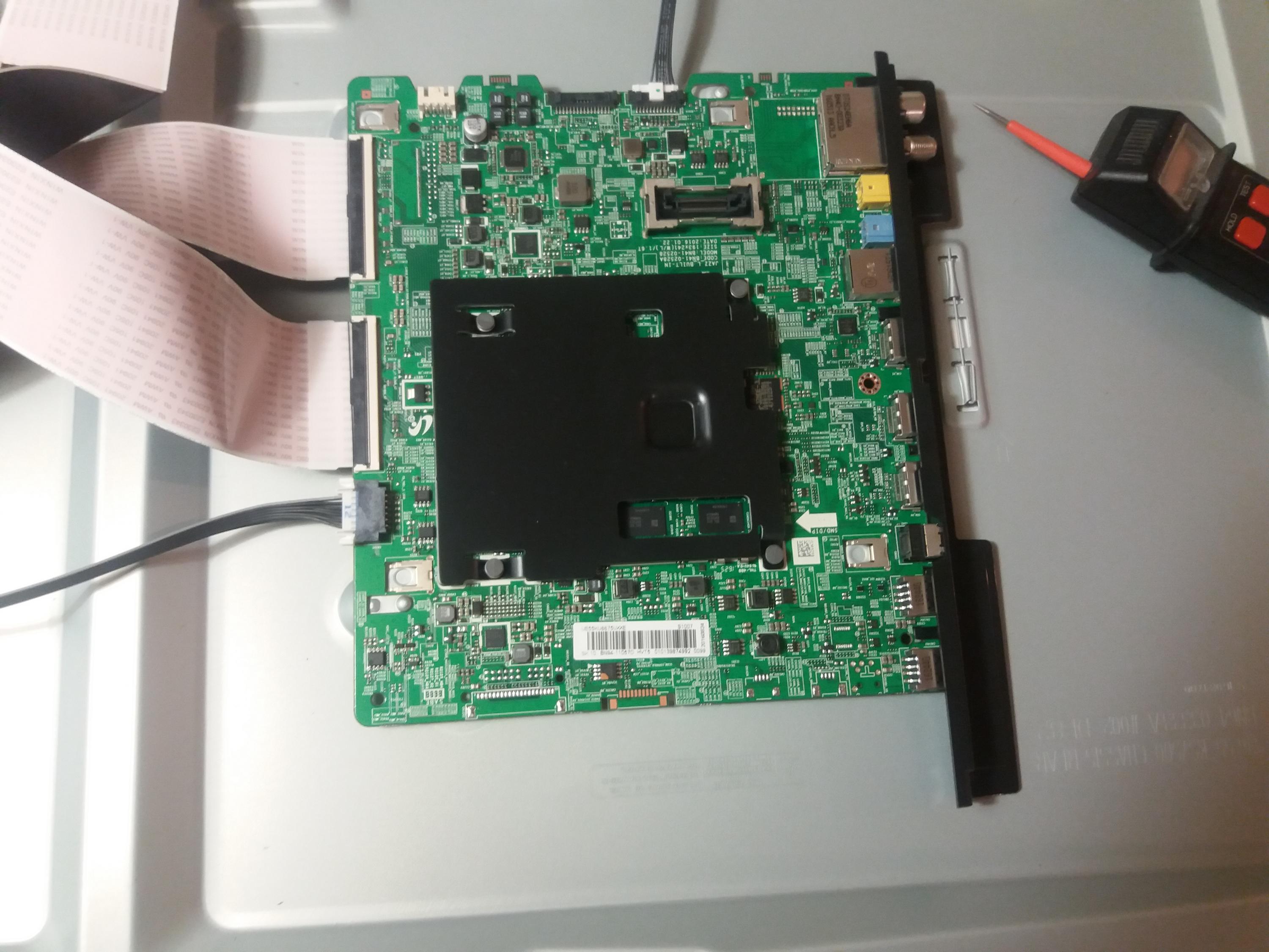

                  Kilroy2k1 are these the leds on the last 2 pics?
                  • Kilroy2k1
                    • Aug 2009
                    • 69

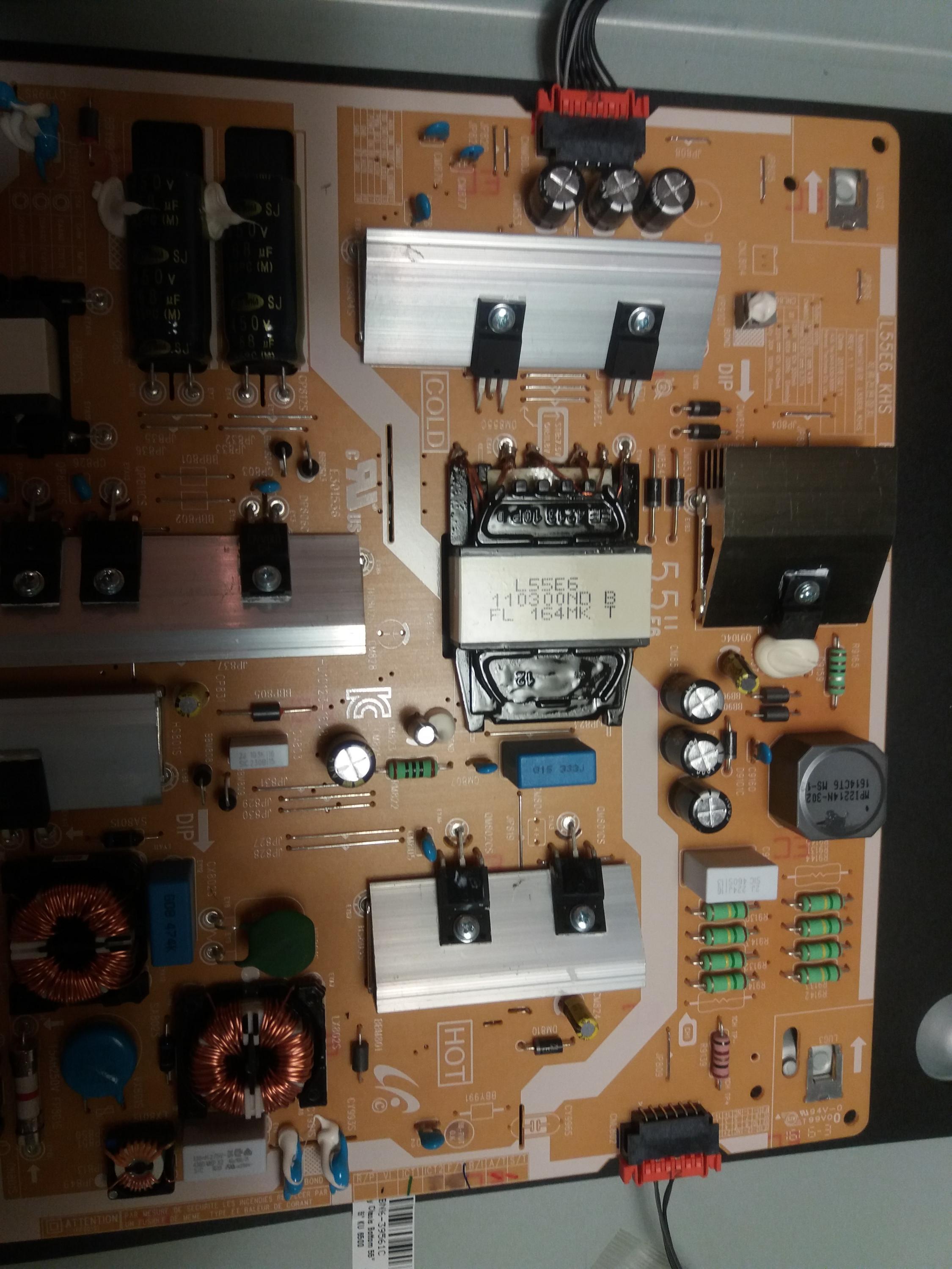

                    No those boards in the last 2 photos are the boards that run the LCD screen. They have nothing to do with the LED's
                    The LED's are on that plug thats on the opposite side of the board from the cable that goes to the main board.
                    You will find the pin numbers and what voltages they should have printed near that connector on the power supply.
                      please can you point on my pictures because I do not find or do i have take some more pics thank you
                      • Kilroy2k1
                        • Aug 2009
                        • 69
                        Circled in the connector for the led's and printed above it looks like the pinout.
                          thank you how can i test it
                            The printed above it is realy difficult to read but here wats on it .
                              There can be some fairly high voltages there, if you dont know how to test it then perhaps you should enlist the help of someone who does to check it over in person.
                                well i know there are such highs i can handle it but what tests do you want me to do?
                                  First unplug the cable to the main board and then plug in the power, the back lights should light up.
                                  If they do measure voltage across 1+ and 1- then 2+ and 2-
                                  My guess is you have some backlights out.
                                    Hi again from the ground to 1 cord I get 309v and the bottom one which is also 1 I get 224 it is the same cord I could not decide which is + or -
                                    and secondly that is marked 2 all the time the black probe to the ground I get on the top 224v and for the lower 131v
                                      here are some close-ups of the contact in question I think the top row is + and the bottom is -
