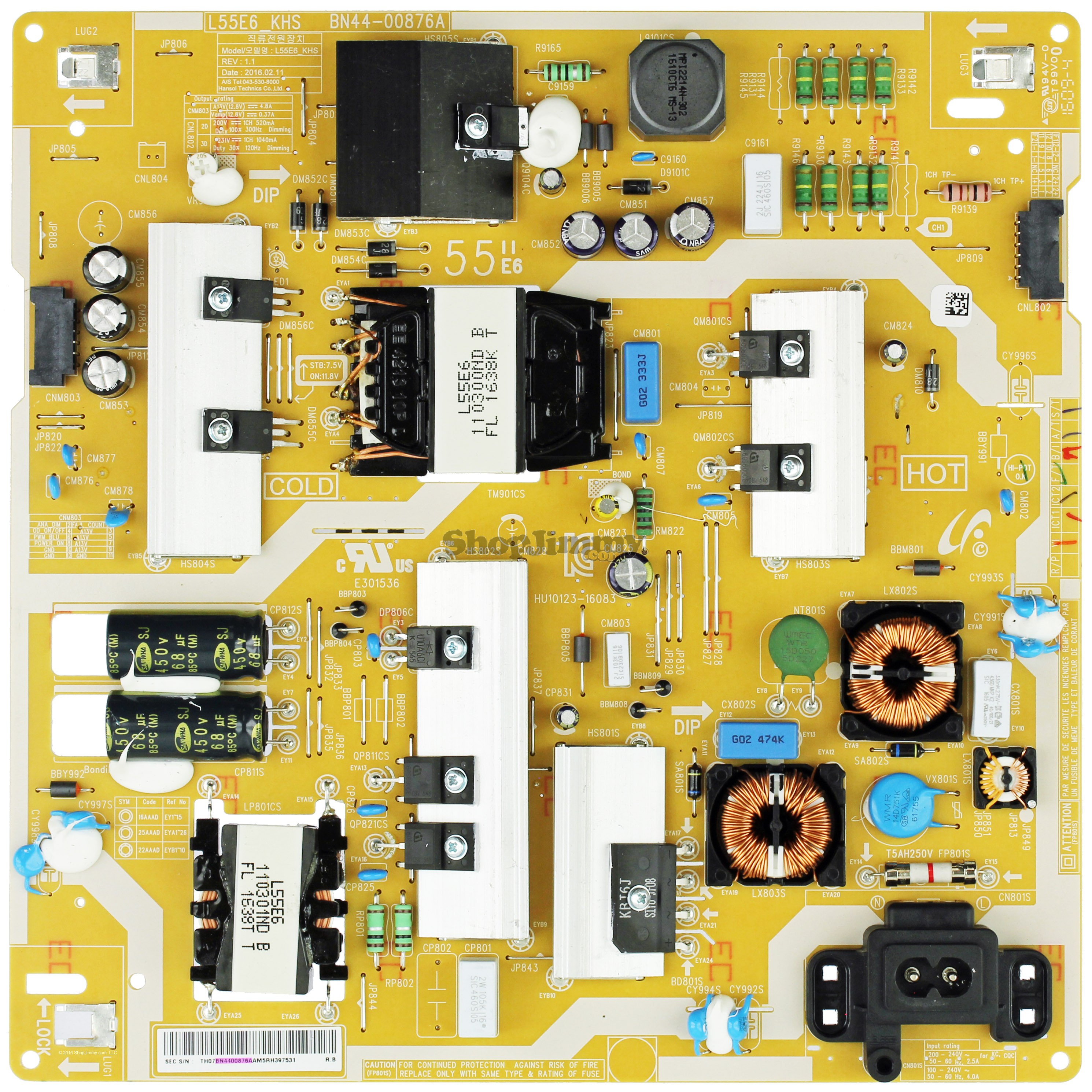

    Hi budm BN44-00876A

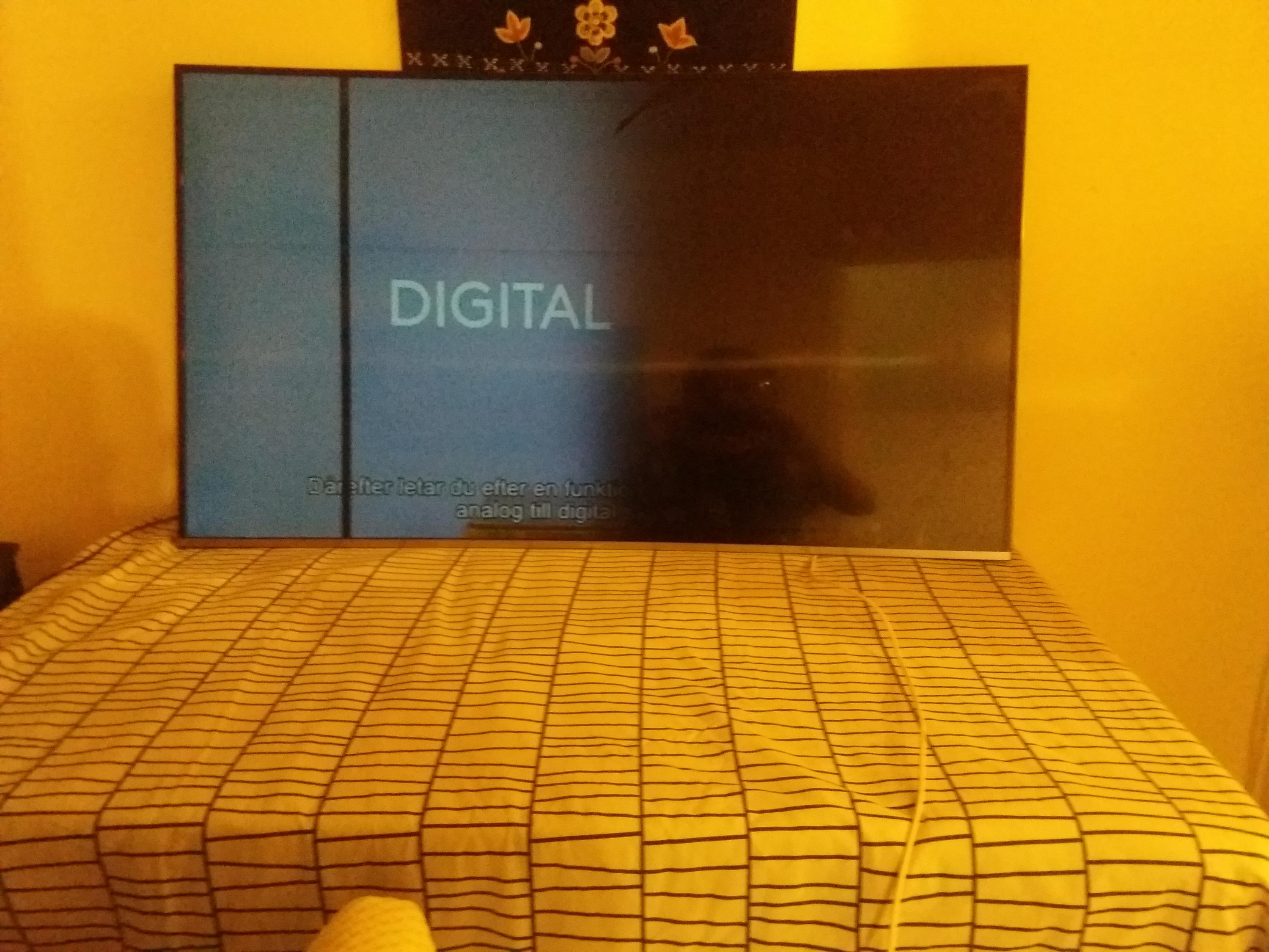

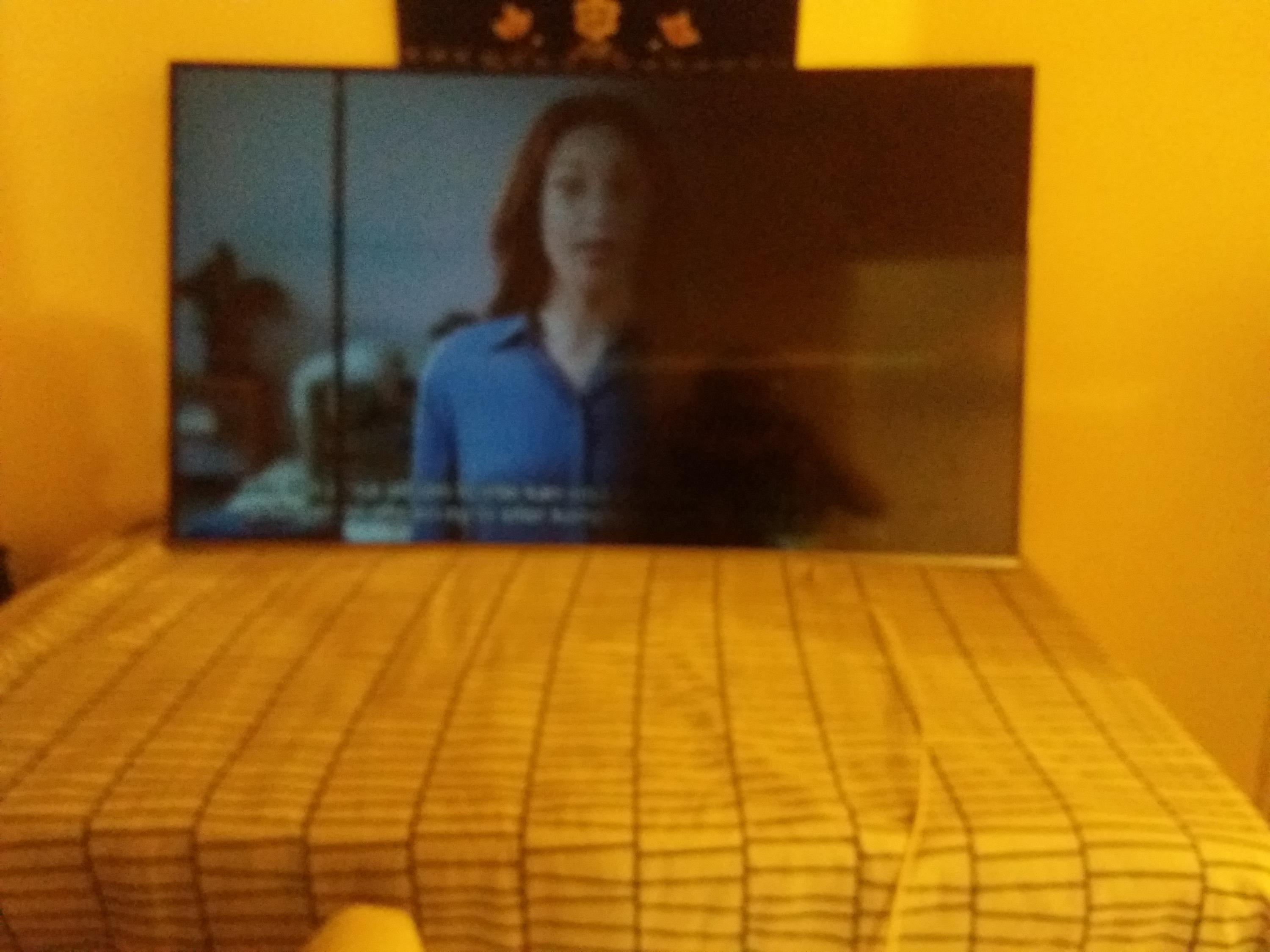

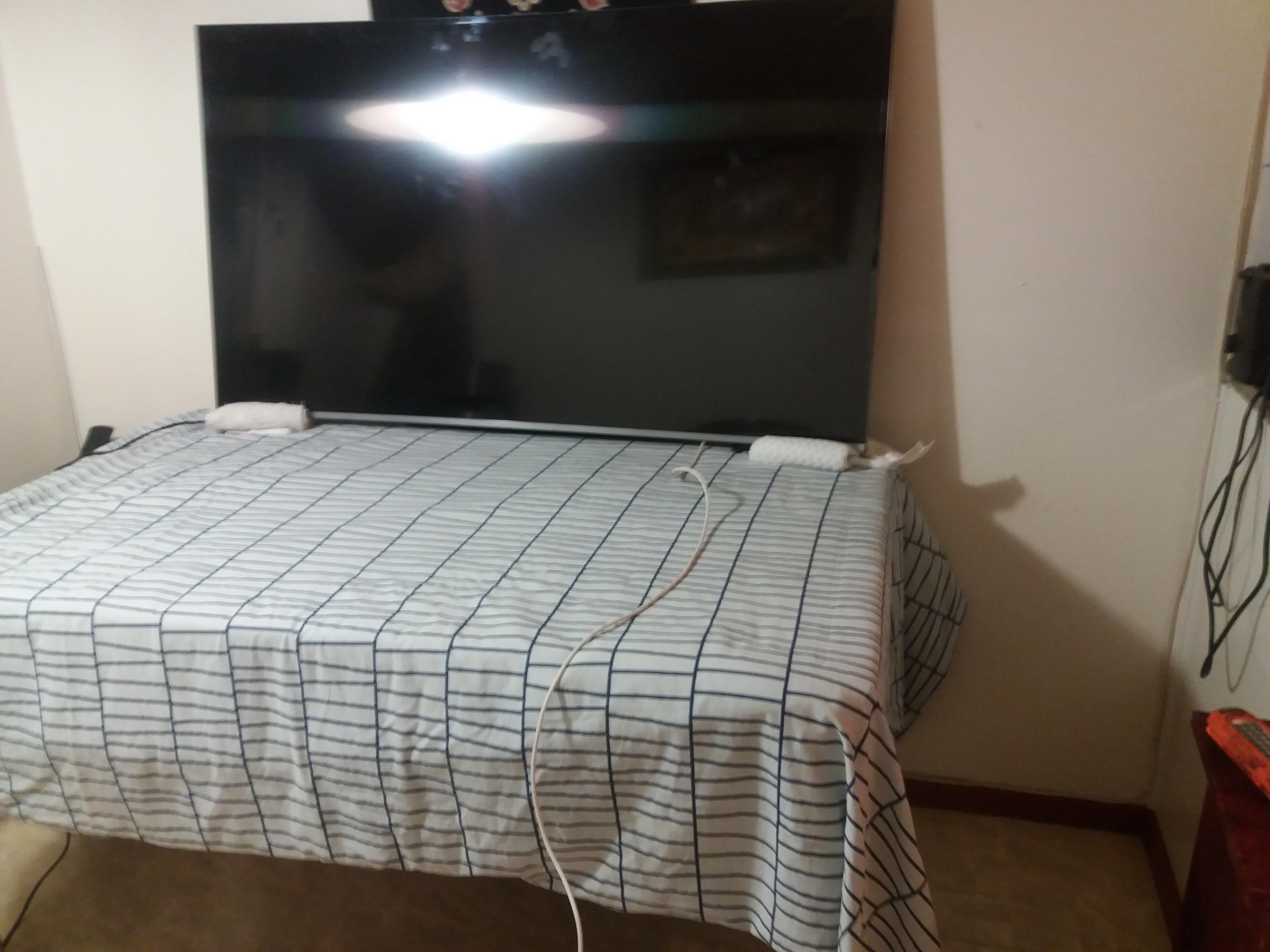

      No way! 21 posts and neither one photo of the screen.. is this a game?

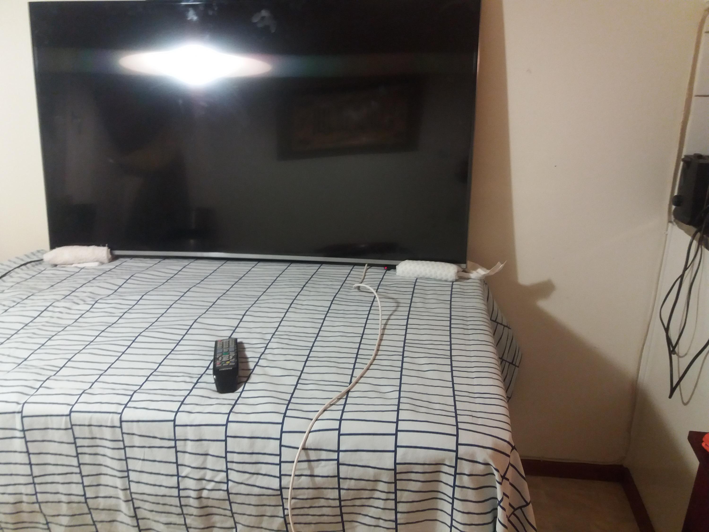

        Re: Samsung UE55KU6575U SHOWS ONLY HALF SCREEN
        i couldn't find the pic where someone said it looks like back lights out one side

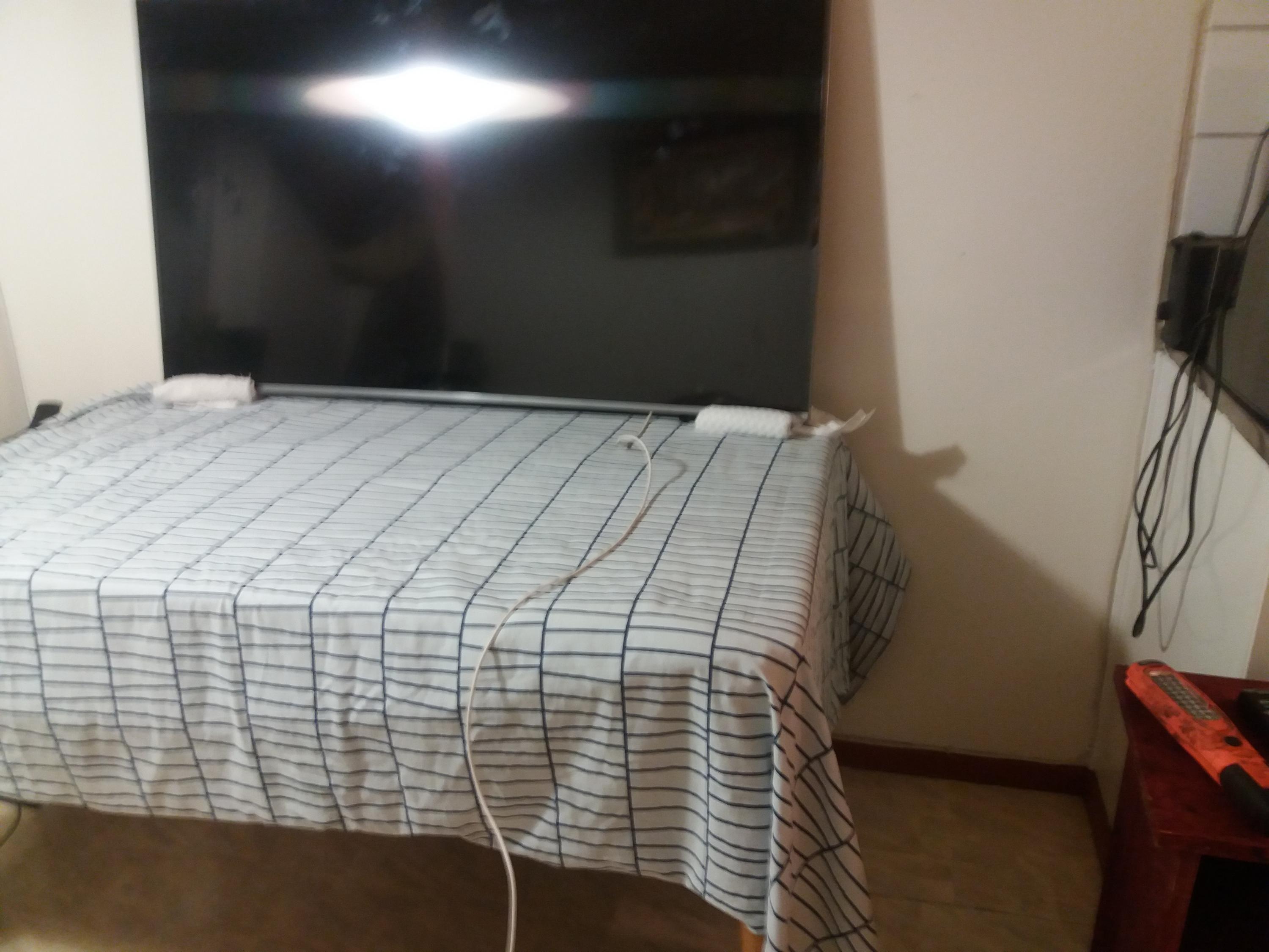

          whenianswered budm i had a blackligt just halv the tv now it is just dark
            petehall347 here it is inthe first post the first 2 pics

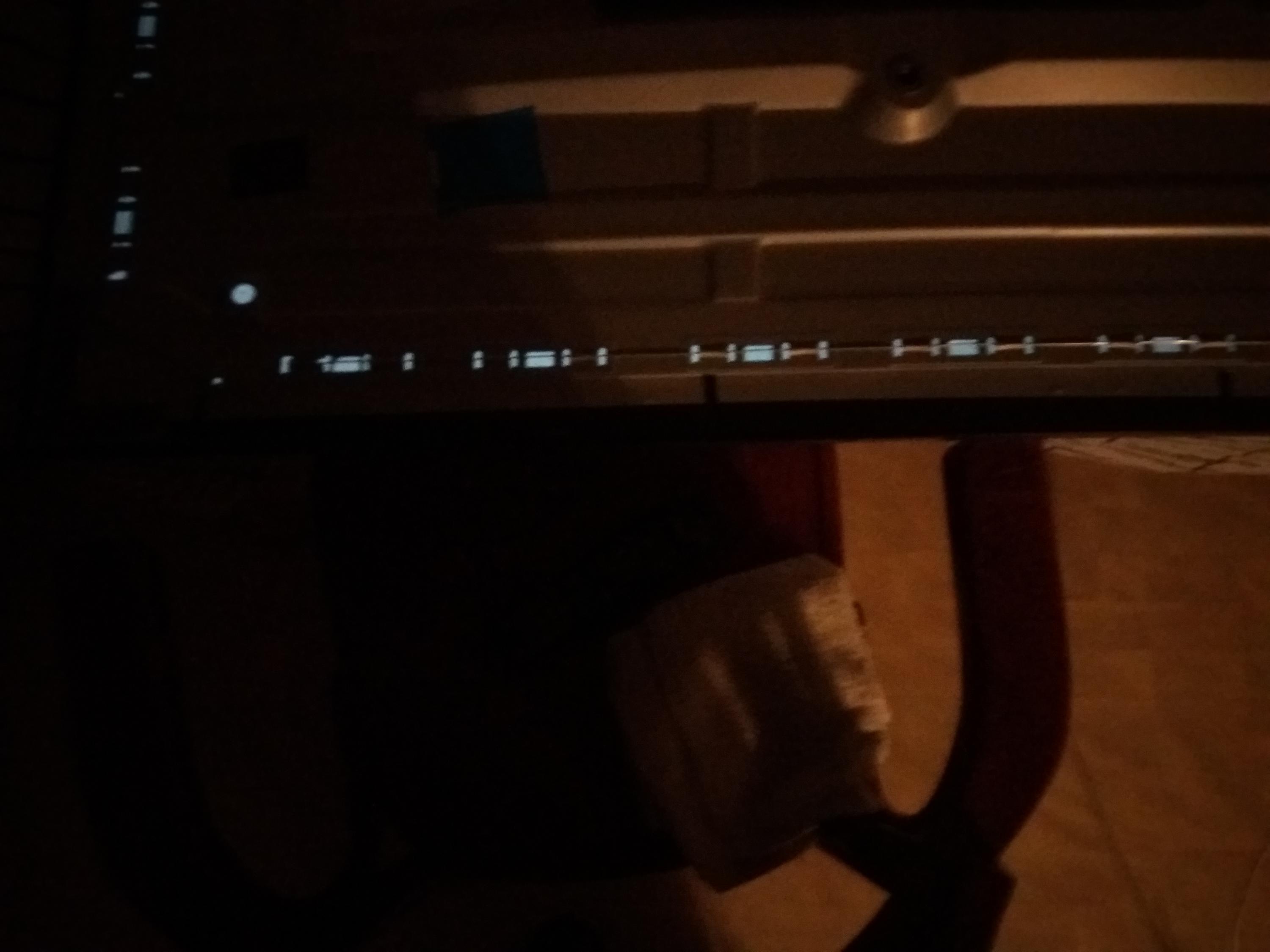

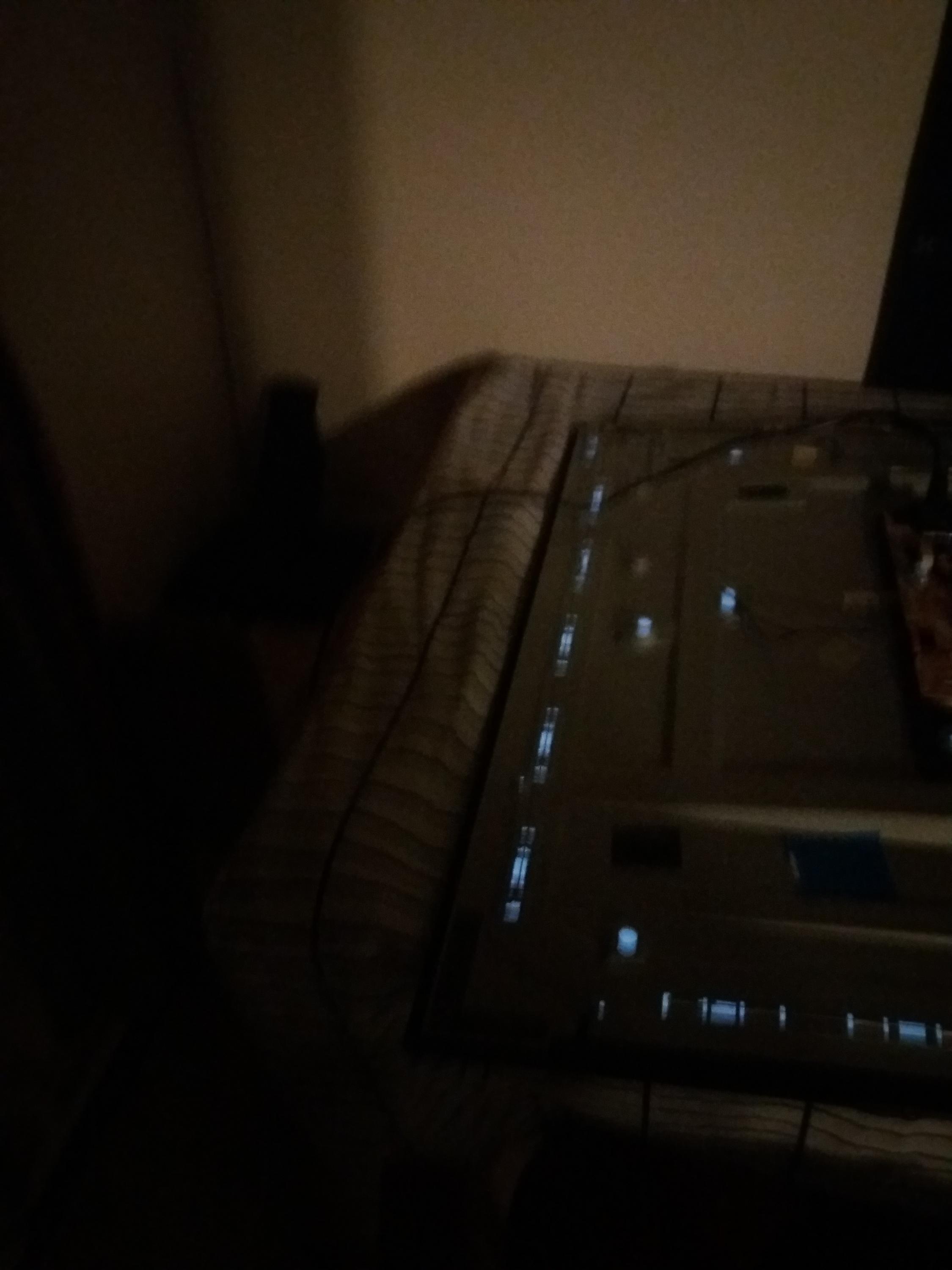

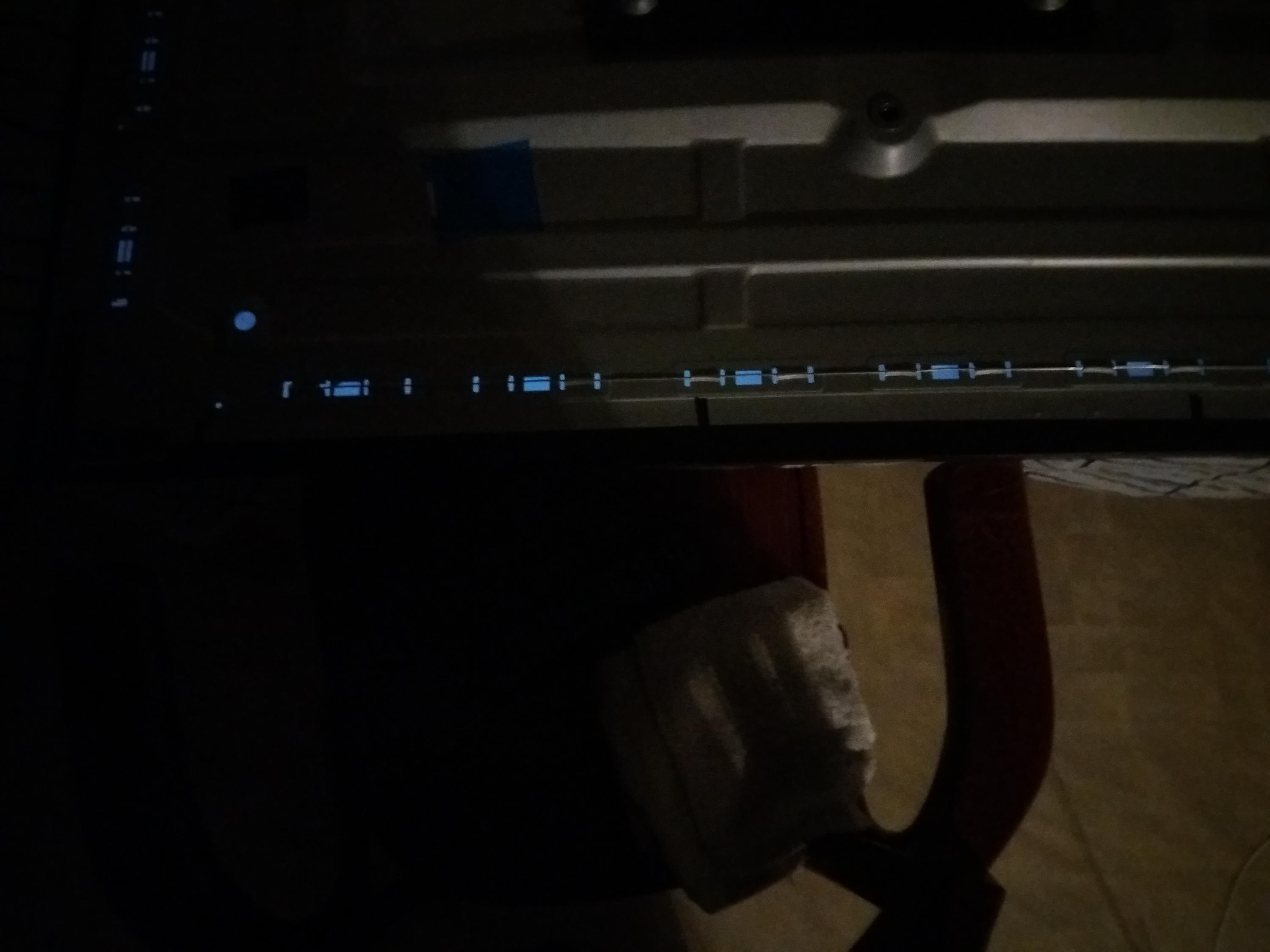

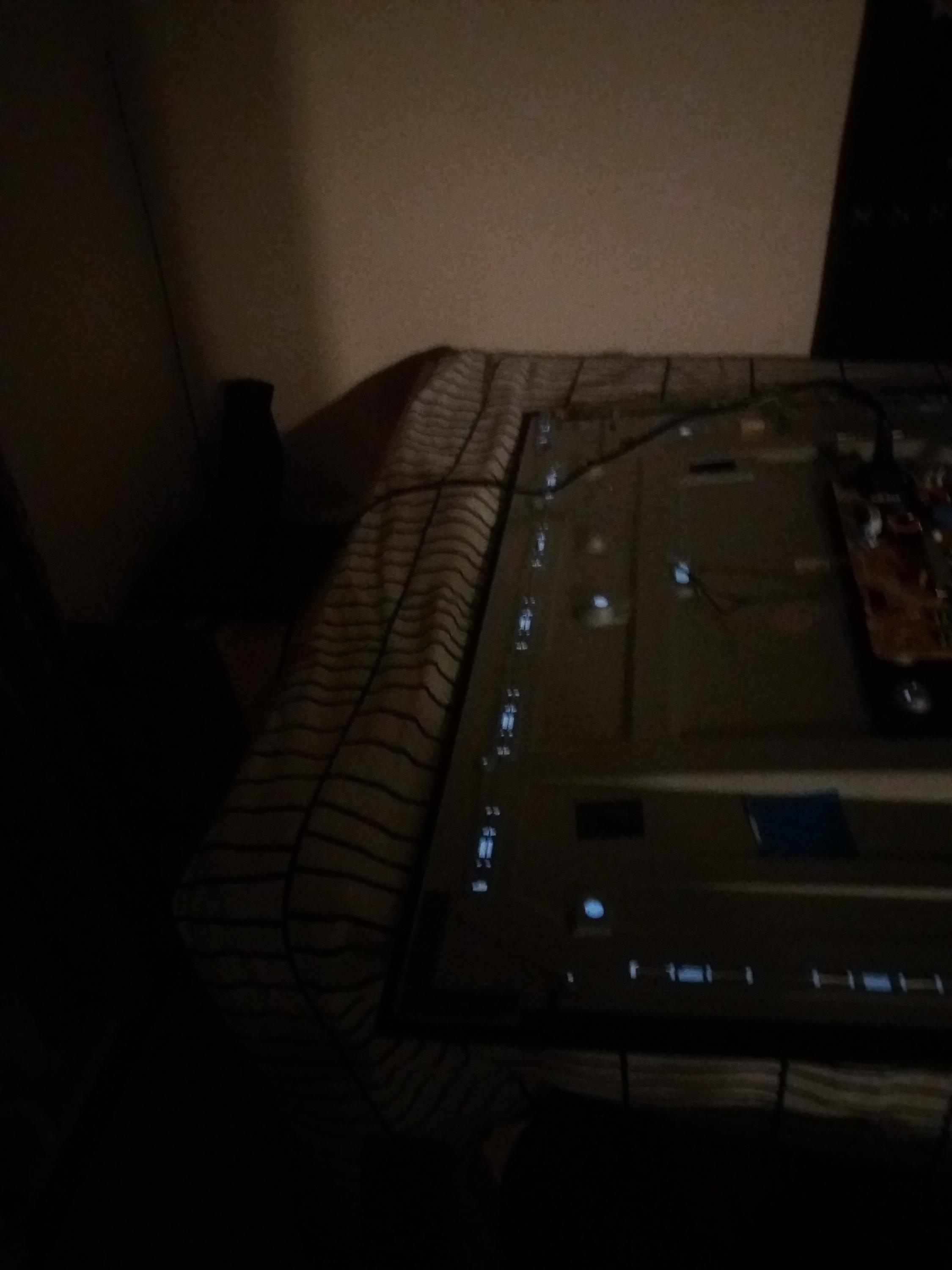

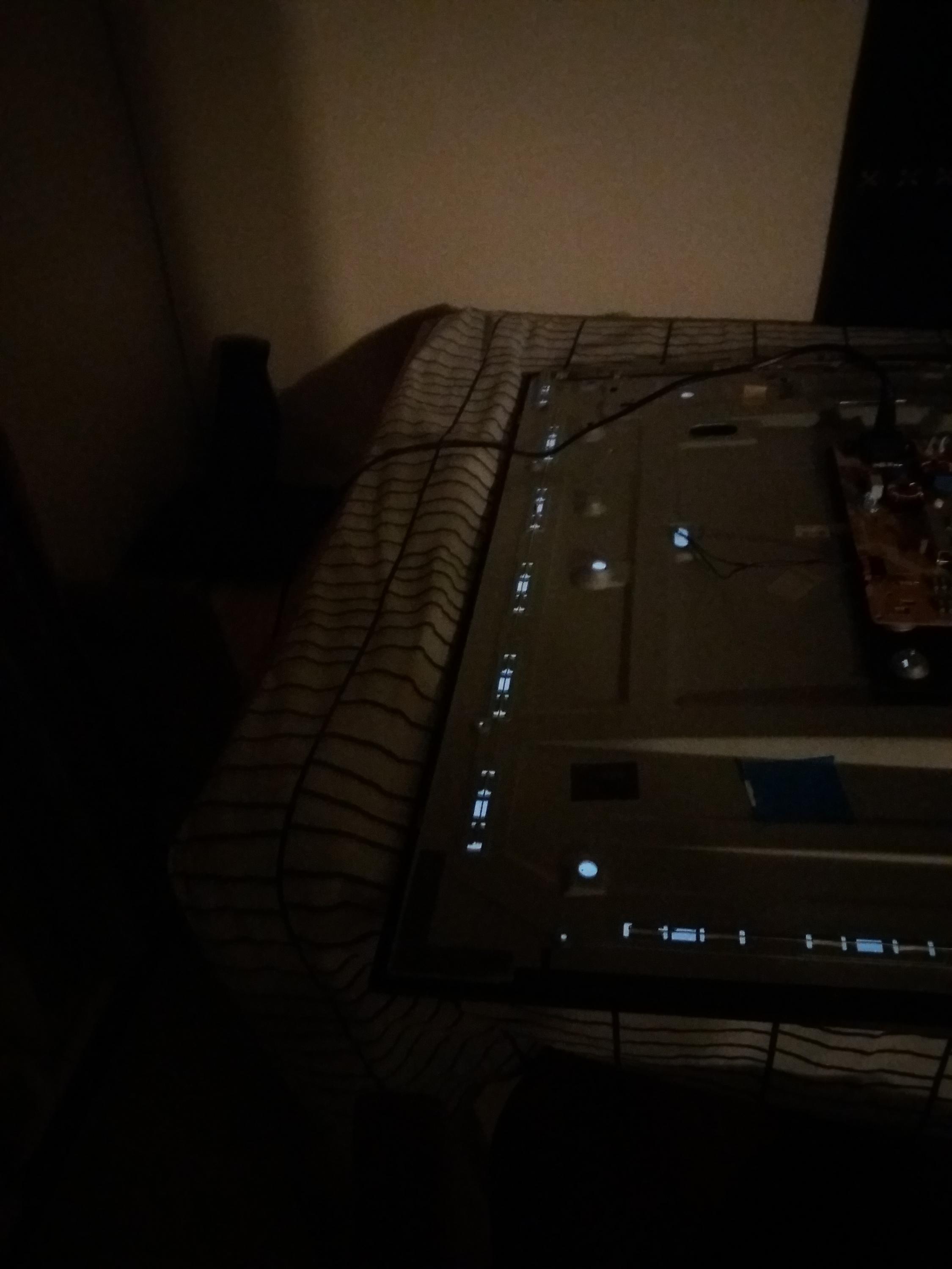

              watch what happens now when tv lies on the table but it does not light up continuously, it lights up and goes out as if it were giving a code
              here are some pictures

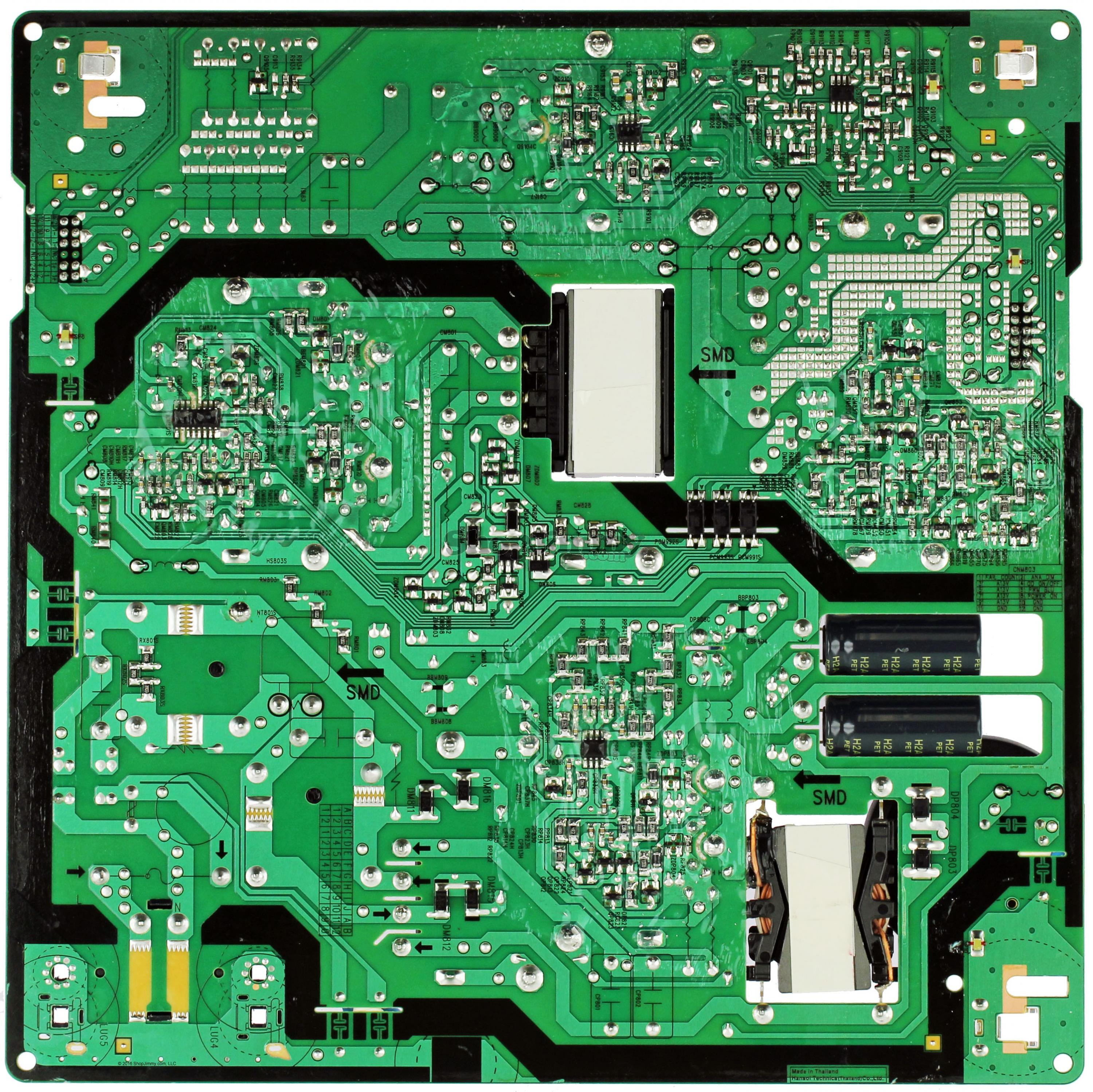

                sorry all my measurements were not right because i forgot to have all the cables in their proper place now they are right
                on number 2 on the contact and top row 260v
                on number 2 bottom row I hart 160v
                on number 1 top row 346v
                on the bottom row 246v
                and now the picture back
                  Originally posted by bohaboha
                  Hi budm BN44-00876A
                  OK, so the LED string #1 and #2 are connected in series to form one large string.
                  If you look at the output Voltage as printed board, you will see that the LED power supply is rated at 200V 520mA, right now you are seeing over 300V because the power supply is not seeing the load, so you have open circuit some where in the LED circuit path.
                  Do you have LED tester for testing the LED strings?
                  BTW:
                  Pin 1 (1+) and 3 (1+) are tied together, they are Anode pins for LED string #1.
                  Pin 7 (1-) and pin 9 (1-) are tied together, they are Cathode pins for LED string #1.
                  Pin 2 (2+) and 4 (2+) are tied together, they are Anode pins for LED string #2.
                  Pin 8 (2-) and pin 10 (2-) are tied together, they are Cathode pins for LED string #2.
                  Your report in your post #27 does not make any sense because the pins assignment are 1+, 1-, 2+, and 2-, you do not indicate what the 1+, 1-, 2+, 2- readings are.

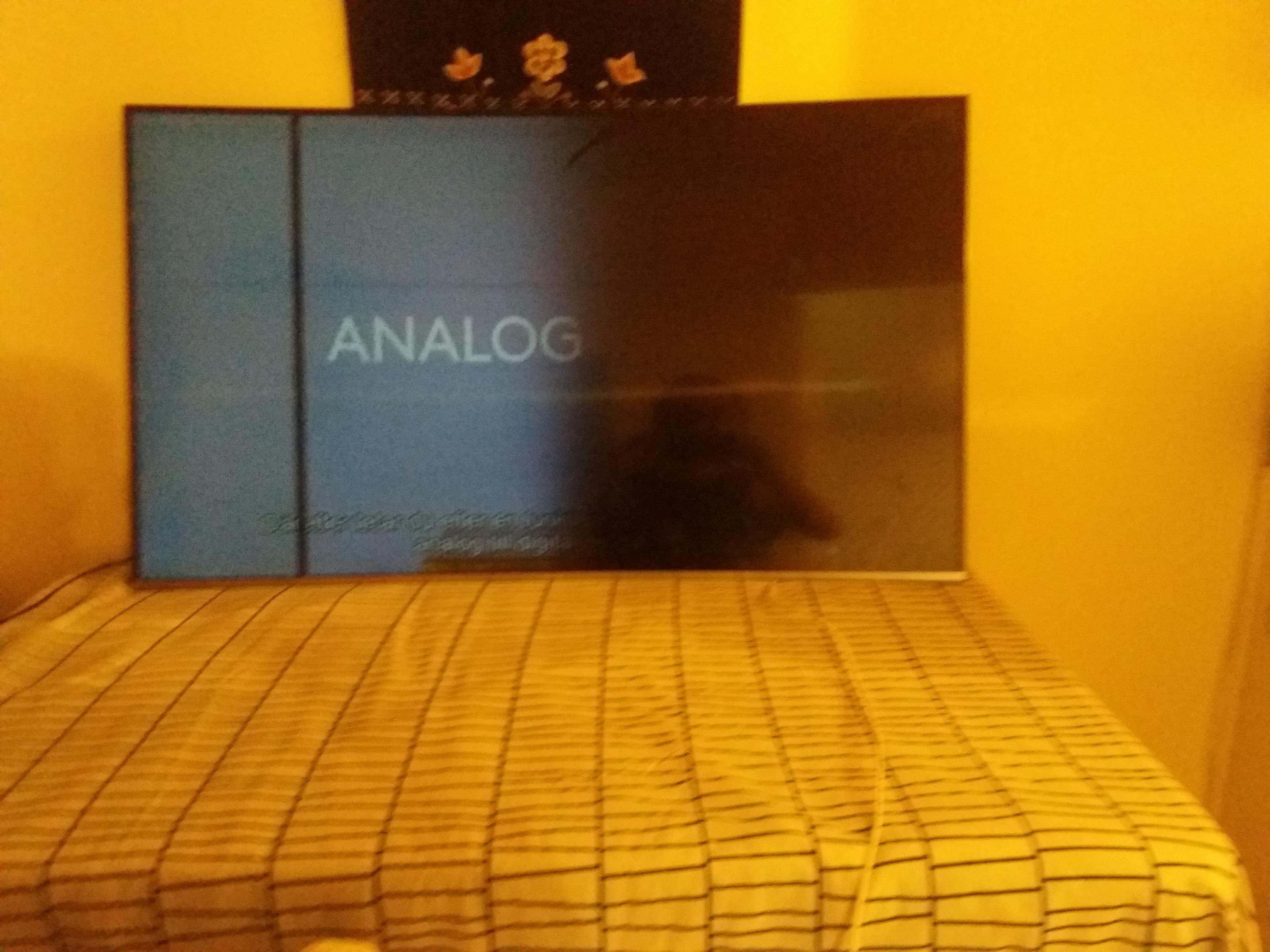

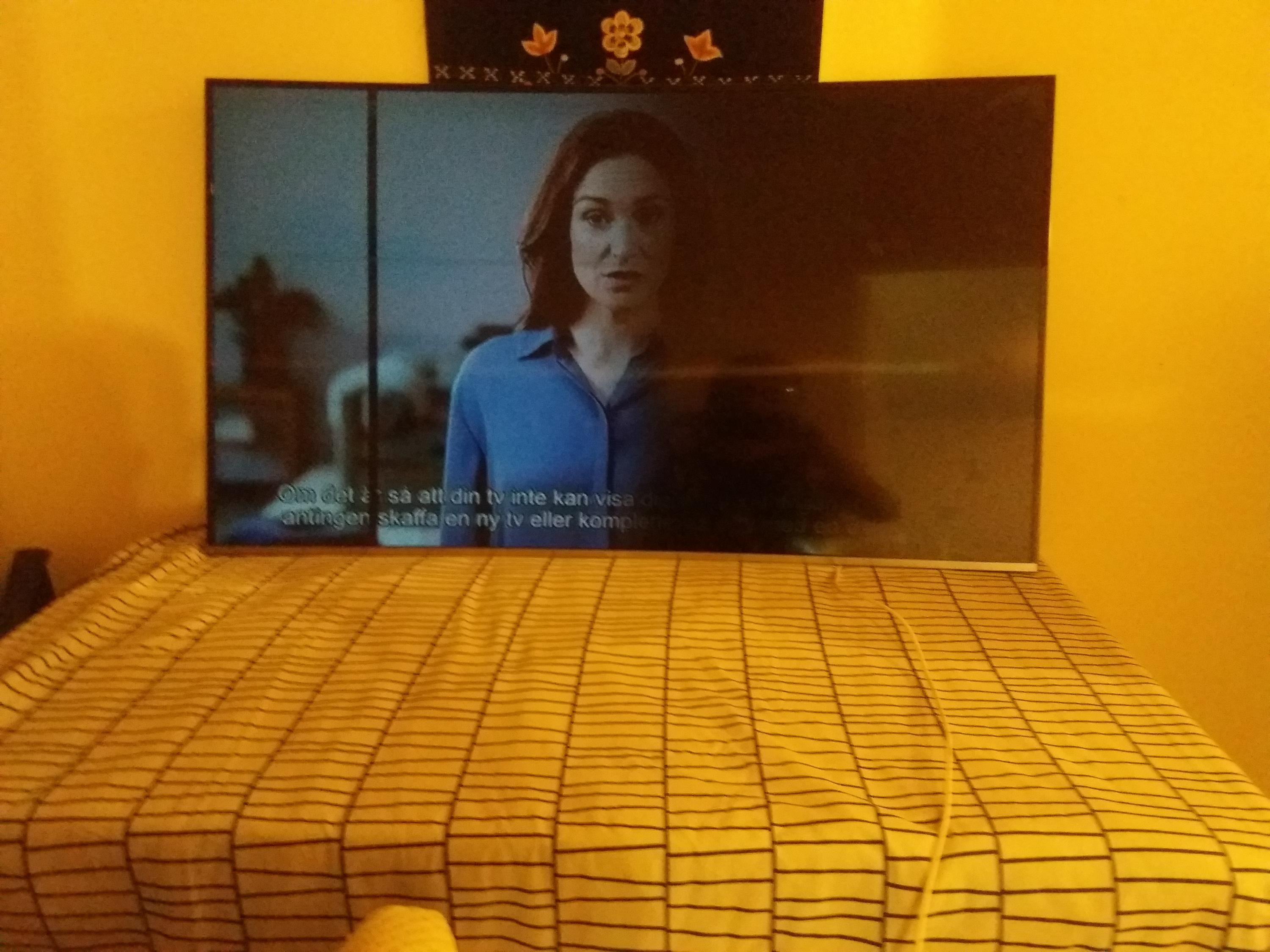

                    #29
                    Now the things goes better, the main problem is the backlight but have you noticed that also the screen matrix is defective (black vertical bar)? is it worth repairing? You better contact an electrician to install a surge discharger in the electrical circuit breaker panel.... and sell the beast fort parts...
                      #30
                      Yeah, I just notice that vertical bar to.

                        #31
                        One moment, it returns in my mind a very similar case, it was some months ago here, if i remember well the user had found a visibly burnt side screen tab/cof...
                        PS: maybe is this: https://www.badcaps.net/forum/showthread.php?t=78997

                            #33
                            So you have picked it up for repair? Check the link well, it spoke about a broken corner after failed led replacement, not the best start, my advice after many years of this sort of business, two question to always make are if the tv is already been serviced because this reveals often bad surprices if you don't want to go mad, the second if you are not a smoker ask if the previous he was, the smell of them is really disgusting!!!

                              #34
                              There's also a horizontal line on the screen. It doesn't look repairable to me....unless I'm missing something.
