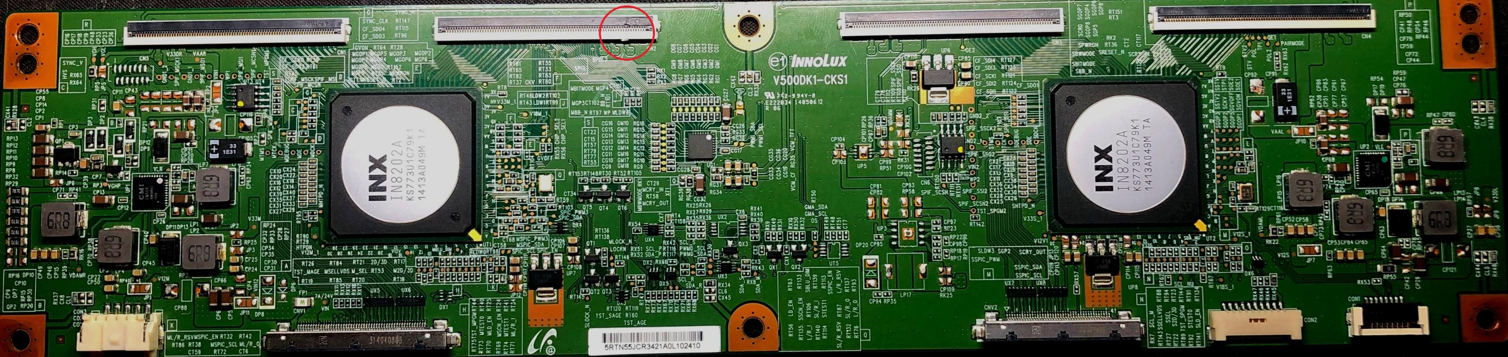

              Here are images of the tcon
              https://ibb.co/86hW74v
              https://ibb.co/P57mz8j
              https://ibb.co/RyRBzRz
              https://ibb.co/7VjSBFY
              https://ibb.co/5cD47D0
              History is tv worked fine for a few years, nothing untoward, then powered on one day and screen looked like this.

                Re: TCON board compatibility question
                from yours photo screen washed out early to judge T-CON fault before do some more test.
                1- did the photo of the T-con are related to yours original parts or its for example you took from the web? because i can see some damage on it.
                2- how about when you press menu .. did the menu UI come clear or its also washed ?
                3- did you inter by chance the service menu and changed some things at swprofile.bin ?
                4- did you tried to inter service menu and see the UI menu of the service option showing correctly or washed up ?
                5- disconnect the last 2 ribbon cable from T-CON to panel ( the 2 on yours right hand when you stand behind the tv ) then turn on and see how it look the half screen. ( repeat point 5 on the other half side )

                  1 - that is my actual tcon board. where can you see damage?
                  2. yes menu UI is also washed out
                  3. never entered service menu
                  4. I have tried methods from here https://factory-reset.com/wiki/Panasonic_Service_Menu to try to enter service menu but none seem to work. Are there any other common ways?
                  5. half the screen goes black, other half is washed out
                    see attached your socket ( marked with red circle ) where there are burnt on the socket which i assume its related GAMMA feeds pins. you can trace and check under very good loops yours ribbon cable if there any burn or cut at the pins
                    method 1 should work
                      I'm not sure if I see anything burned. I've attached some close ups for further inspection.
                        BTW, that 'V500DK1-CKS1' is the blank PCB P/N, you need to match the PCBA P/N on the bar code sticker.
                            my point 5 did you try the other half to disconnect ?
                            about the socket and its ribbon cable.. to my poor eyes they are not normal.
                            about sticker... vestel share all 65 brands such Toshiba / JVC too with same screen type under same driver of this T-CON ( its tomato boards ) can be cooked at any same size dishes ..
