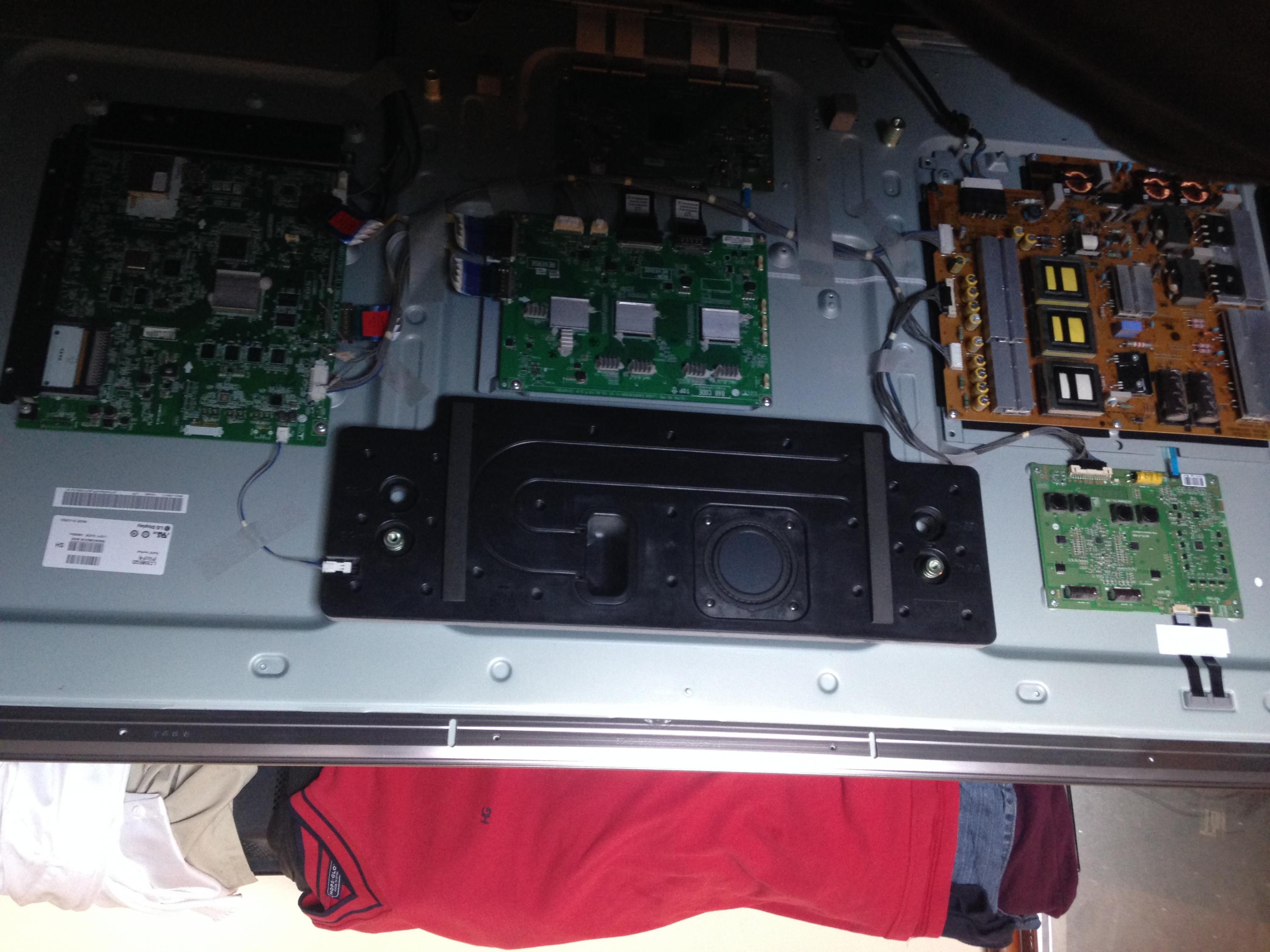

    Hi , i would really like some help to diagnose and repair this TV.
    I'm not an expert but have knowledge of electronics, i actually work on high pressure cleaning equipment. I have various pieces of test equipment, but no oscilloscope.
    I'll try and keep it short as to what happens and what i have tested.
    Tv was working fine , then just went off.
    plug it in and the red standby led is on solid.
    turn on TV, the red led blinks 3 times then goes out.
    No picture or logo comes on the screen.
    Turn the Tv off and back to solid red Led.
    Checked voltages when tv turned on.
    All voltages as stated on power board apart from the INV ON 3.3v. When measuring the P dim there was no voltage but the meter fluctuated whilst turning on and off , but still no reading .
    I have read about the 'wake and bake' repair in the oven but would actually like to know why the 3.3v is not coming from main board .
    According to the flow chart in the service manual it requires a new main board.
    Some of the heatsinks over the chips on the mainboard are warm, also on the ultra Hd board.
    There is a lot of what looks like silicon oil on the heatsinks, which has also migrated onto the boards, can this cause problems?
    Any help would be appreciated on this ,
    Many thanks ,
    Andy

              Re: LG 55la965w Black screen no 3.3v INV ON signal
              Hi , here should be a picture of the back of the TV
              I don't have the power readings / voltage readings from the power supplt to main board at hand.
              I tested the led strips with an led tester and they were both around 230v.
              The DRV on 3.3v was missing and no pdim or Adim as mentioned.
              I depinned the DRV on and both DIM wires , as i read a similar problem on this forum that was very informative. I did order some 1k resistors to do the test mentioned in the post .
              I thought a 3v battery would suffice seeing as the wires were depinned.
              I powered the DRV on wire with the battery and the backlights came on but just a white snowy screen .
              There is a small ribbon cable from LED driver board to Tcon board . I disconnected this and still the same on the screen.
              Now i beleive i have to test the 12v power to TCON board, there is a supplementary power connector according to the Tcon training manual i read .Will this be all i need to test?
              Many thanks for any help given , i have got this far by reading other posts and i am gaining a much better understanding of it all .
                  Can you please re-take straight shot pictures of the back side of the TV?
                  It is hard to see how all the boards are connected together in your picture.

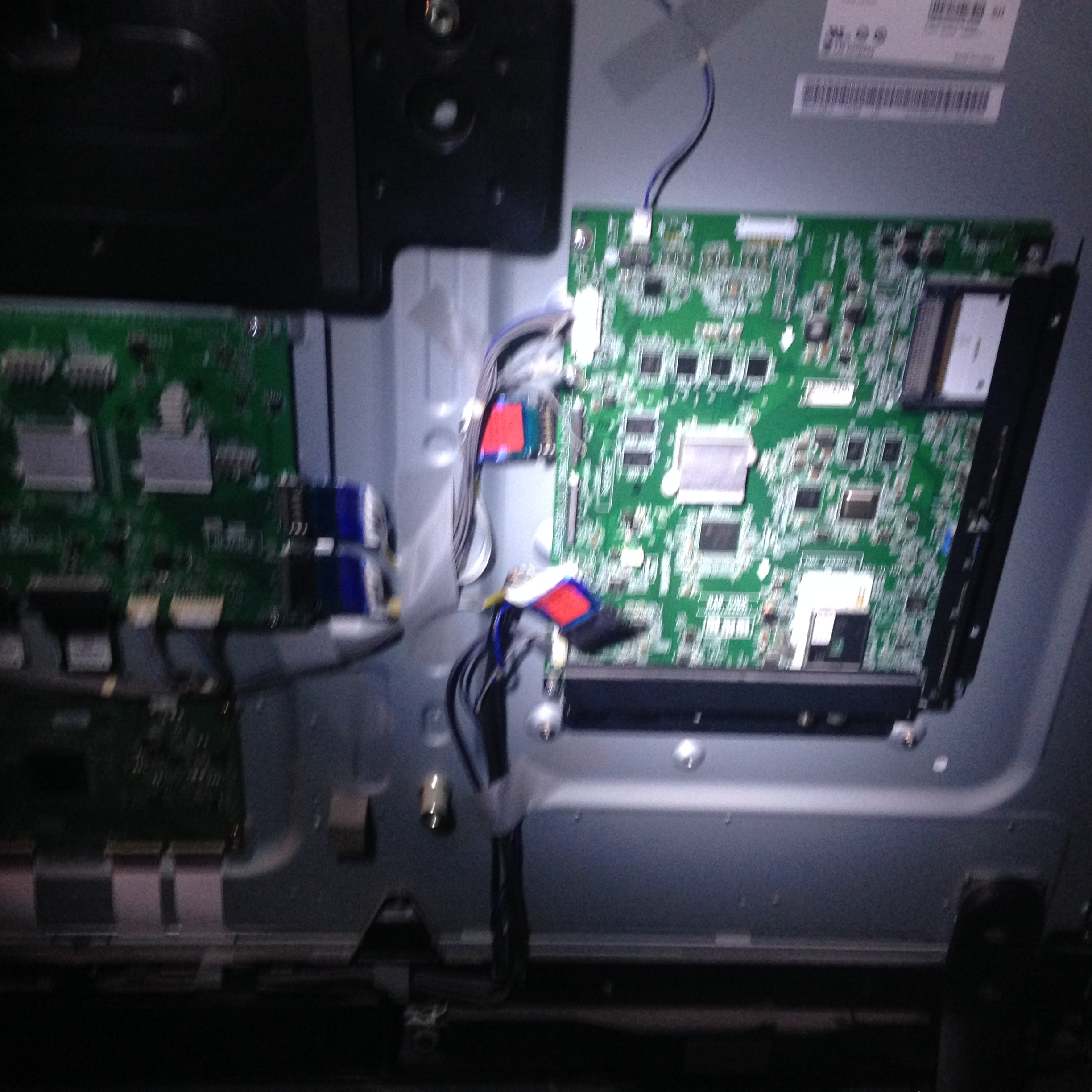

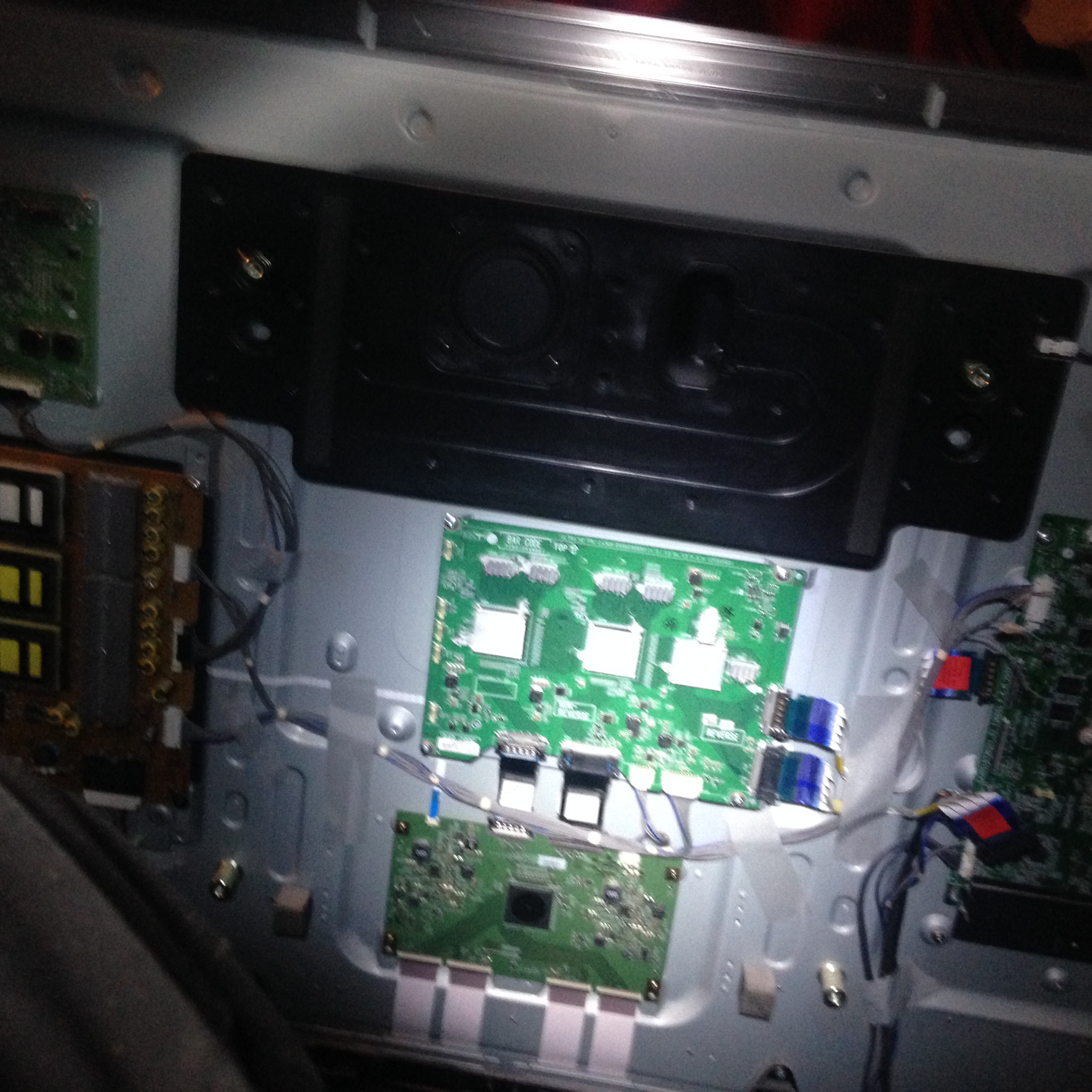

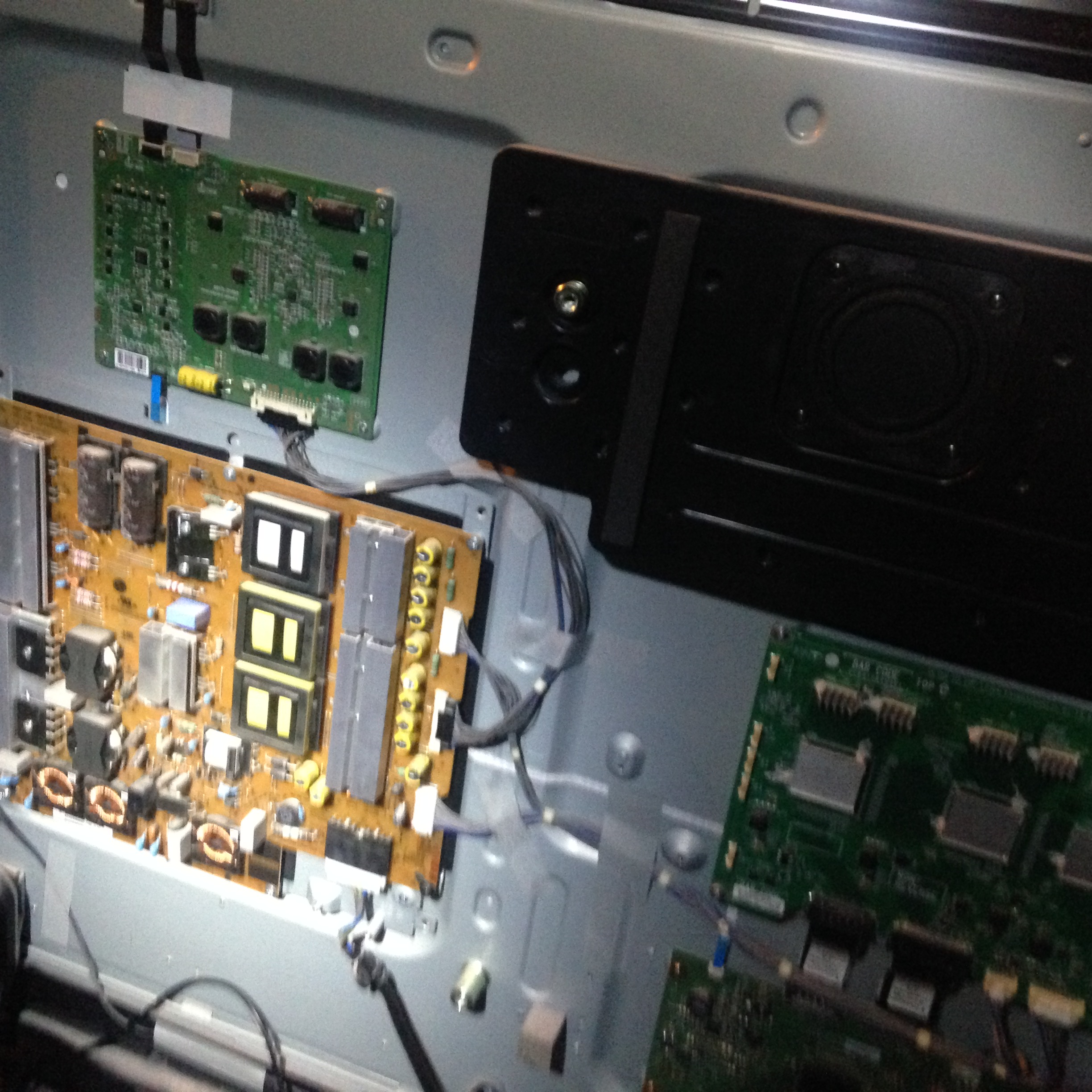

                    Sorry just realised hat pic was upside down too.
                    here are more , but at the mo i have very low light levels so had to use a flashlight to take pics.
                    I will take better ones tomorrow if needed .
                    many thanks
                      I will wait for better and focused pictures.
                      There are so many cables between boards but the pictures are too poor to see how they all connected together.
                        If DRV_ON is not going high to turn on the backlights then the main board is suspect since the signal comes directly from the main processor. You can try baking the board but it usually doesn't last. Heating the processor with a hair dryer could expand the joints enough to make contact and turn on the TV to confirm the failure.
