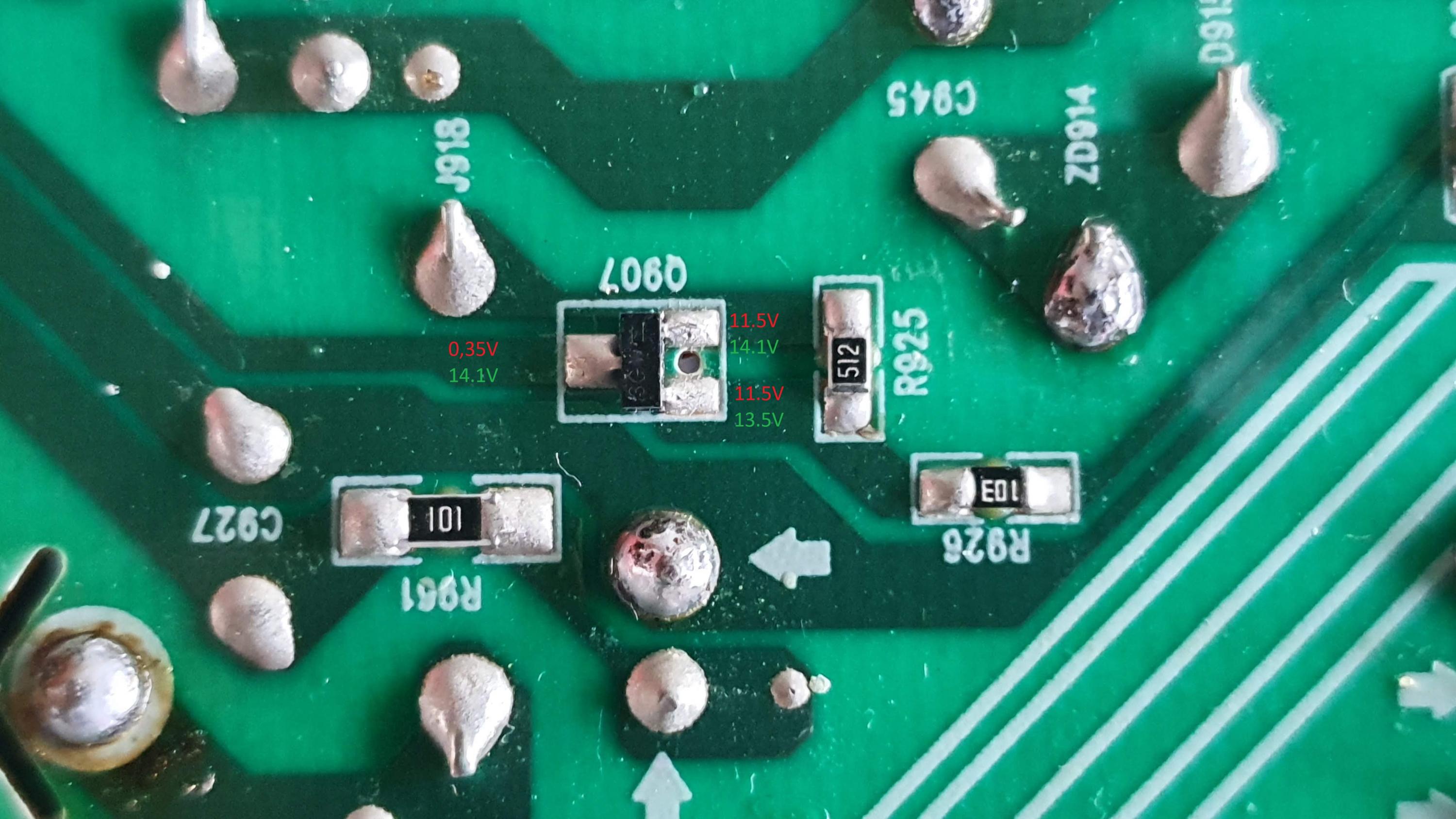

    The voltage at the emitter should be around 12v to 15V. Trunks81 could give you the correct figure. So maybe something could be loading this supply.
    Can you meaure the resistance of IC902 between VCC (pin 8) and ground (pin 6)
    With Q907 lifted out of circuit what is the voltage across C946

      This my measurement from an other topic !
      Also at one of my boards Q906 was defective

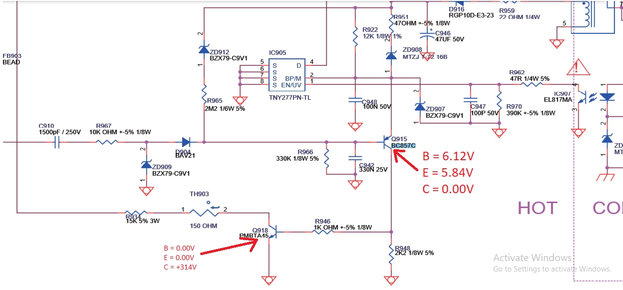

          Resistance between VCC (pin 8) and ground (pin 6) on IC902 is 233k ohms in both directions.
          I also measured voltage across Q915 (part of the brown out circuit, equivalent to Q906 on trunks81's board) anq Q918 while the mainboard was plugged in.
          Q915:
          B = +6.12V
          E = +5.84V
          C = 0.00V
          Q918:
          B = 0.00V
          E = 0.00V
          C = +314V
          That means that on my board the brown out circuit is active, is that correct?
