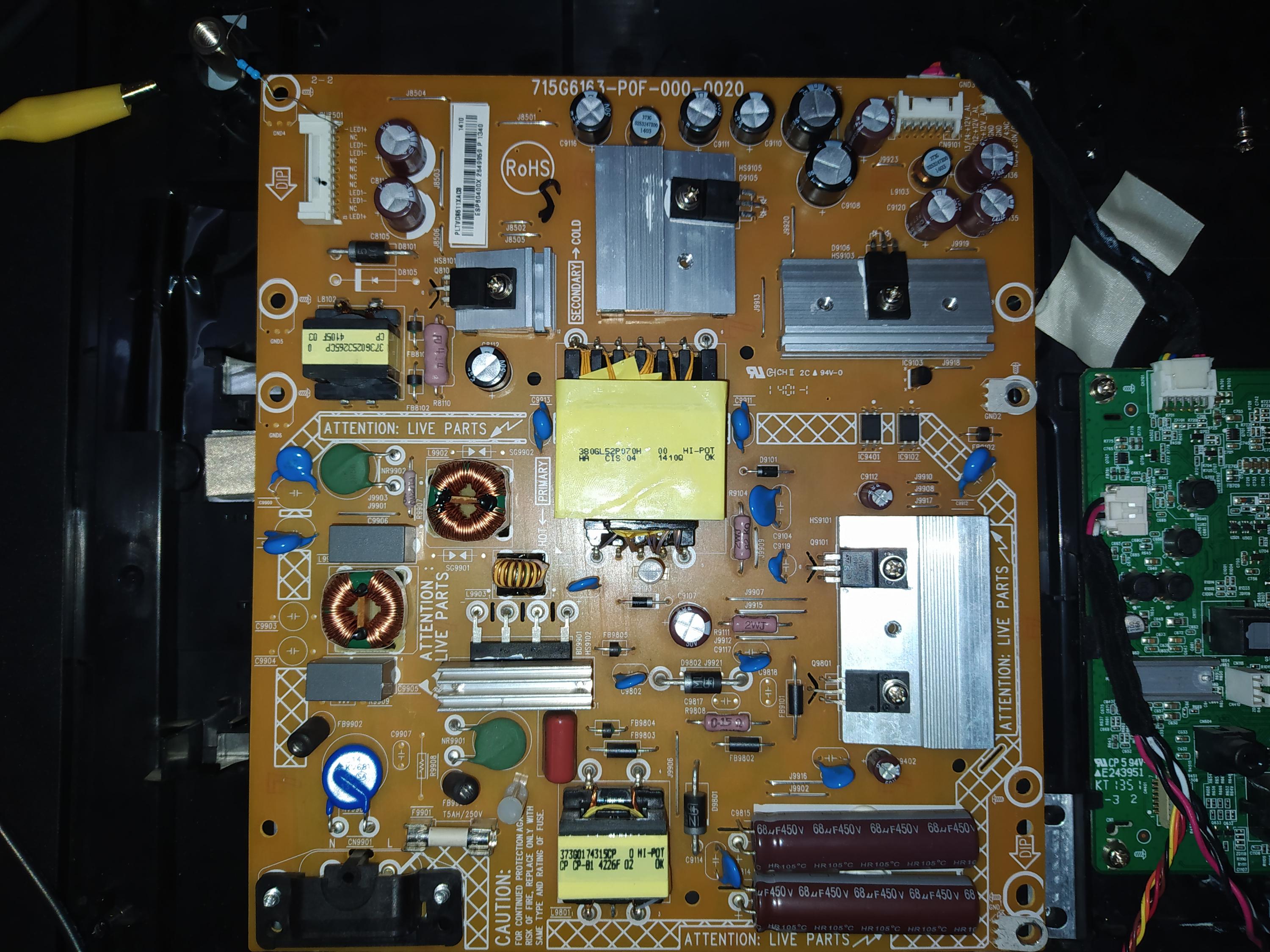

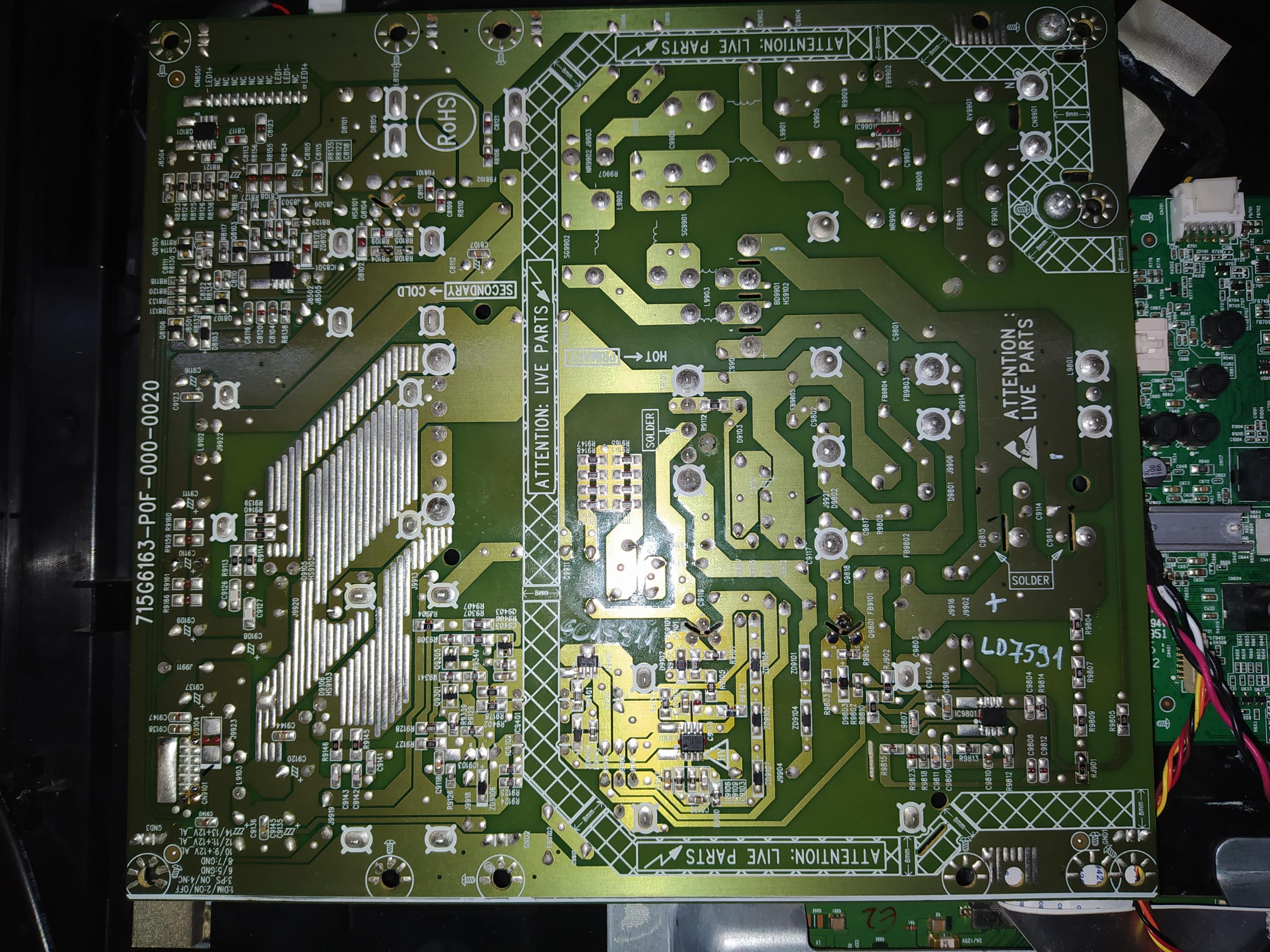

    Hello!
    So i have a Philips 47PFH4109, and when i powering on the tv just blinks once, then after a 2 seconds blinks again, and does not turning on.
    I mean i measuring voltages such like 30V on the leds and the 12 volts on the other panels, which seems to be okay.
    I checked the backlight no issues with the leds.
    I checked every component such as all the mosfets, all the diodes, i dont see any bad capacitors (unfortunatelly i only can measure up to 200uF).
    I even took out the LD7591 chip and without it doing the same as before.
    Im just seeking for advice, or even someone enountered a similar problem?
    Im attaching some pictures if thats help.
    Thanks in advance!

    You are getting voltages on your mainboard?

          So you have image. On power board do you have a BL_on? Should have voltage on that terminal. Probably bad LED.

            You likely have a bad led in one of the strings, if the current draw for the string is wrong, the tv power supply will detect that and shut down. I suspect one led is shorted and supplying a voltage from a bench supply will not detect the bad led but light the others in the string.
            The LD7591 is for the pfc circuit not for the led's

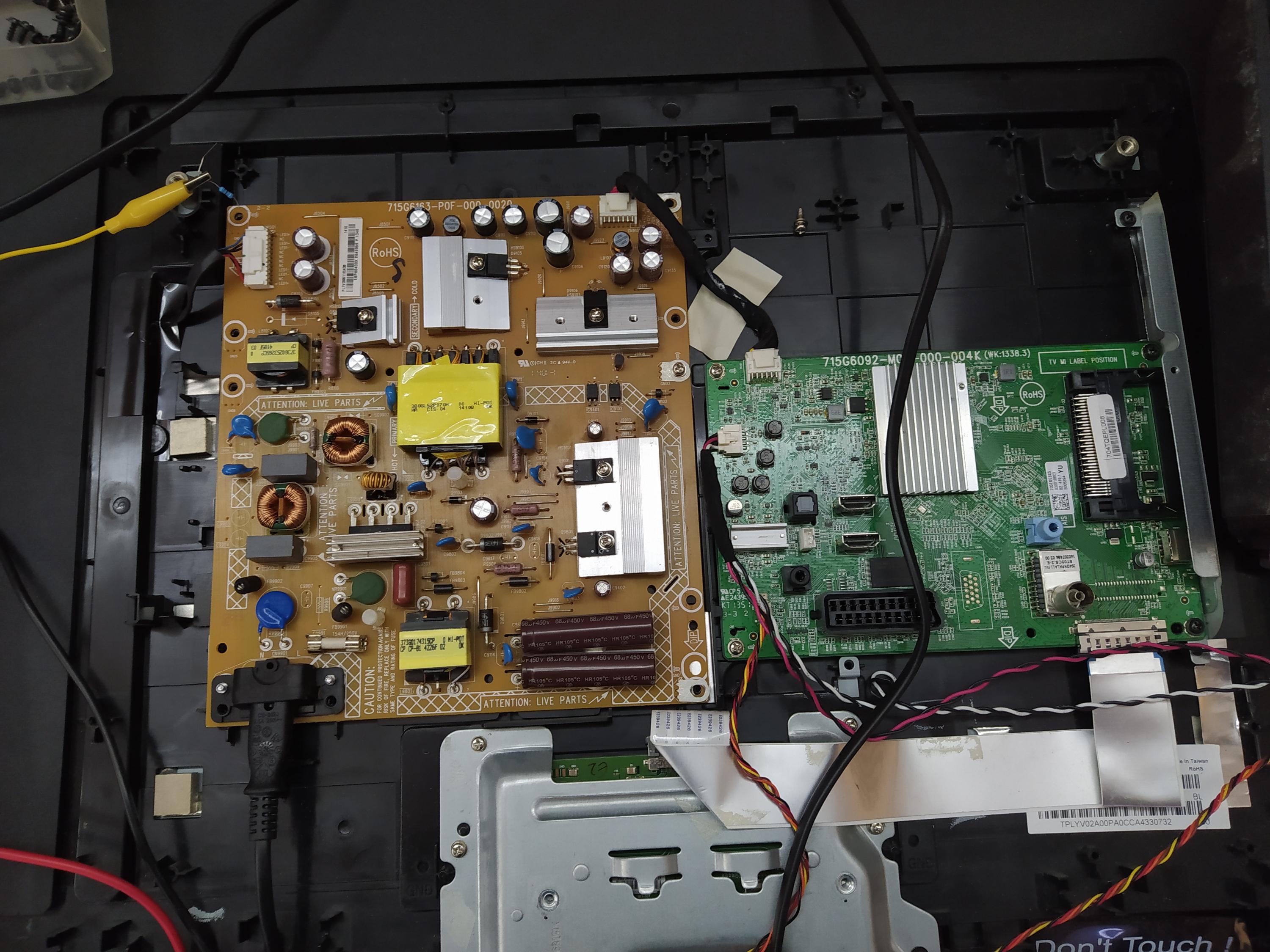

                So im back, i tested the leds, every led strip is lights up nicely. I assembled the tv back again. Im starting to suspect maybe a capacitor lost its capacitance, and causing the trouble here? Primarily the ones in nearest to the led connector?

                  How did you test led's?

                    I disassemled the whole tv took out the screen and applied dc to the strips.
                    I will try tomorrow to test the capacitors.

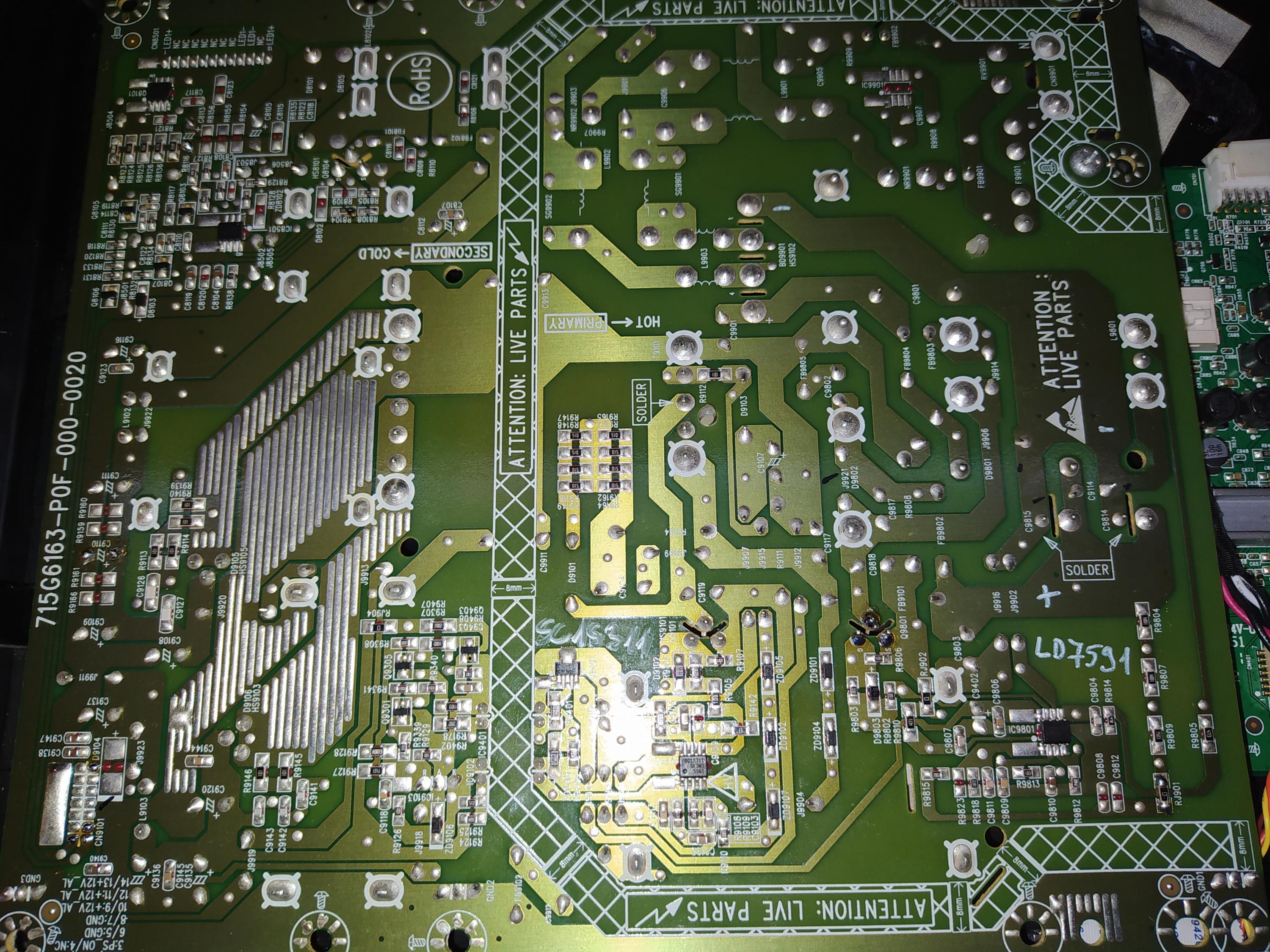

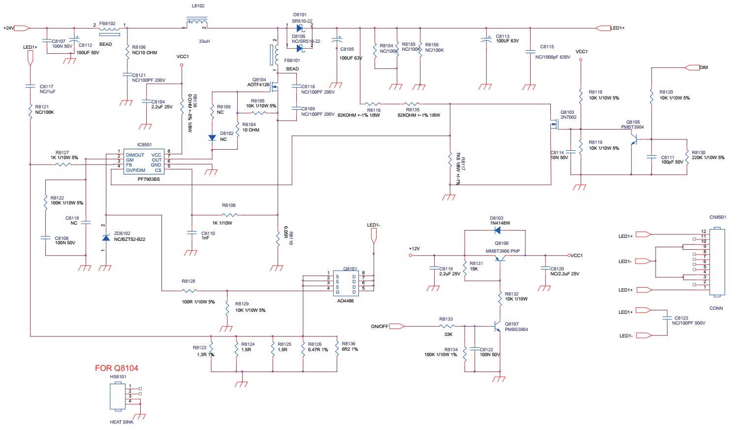

                      So i tested out the capacitors, all showing the right parameters(what is written on the caps). I found the exact schematics on the net, and according to the schematics everythings is fine.
                      The problem is whenever i turn on the tv, it flashes 2 times(trying to light up the backlight), but unfortunatelly gives up and after these 2 try remains unlighted (i have screen logo etc btw).

                        just a thought, although the led strips light up using dc volts one strip maybe using more amps which maybe putting the set into protection mode
                        the latest led testers show voltage and amps

                          Will led's come on with t-con disconnected?

                            Re: Philips 47PFH4109 blinking 2 times when powering
                            Nope, with disconnected tcon remains the same.. I measuring the +30VDC before the step up converter, seems that maybe the converter chip doesnt doing its job properly (PF7903BS) Sadly i cannot find any kind of data of this chip, so i can temper maybe with the feedback leg or ovp leg, to make it work...

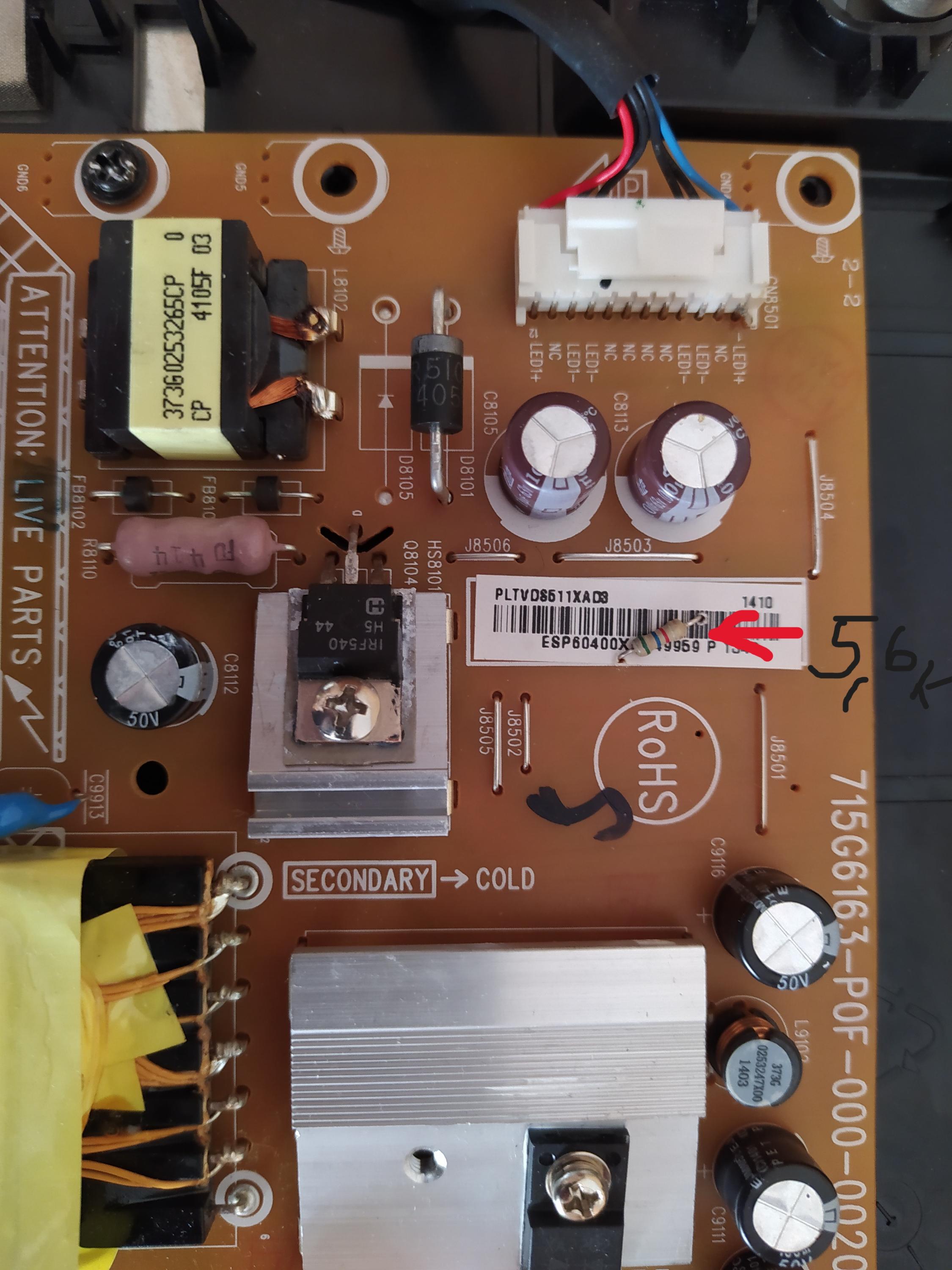

                              Hello guys again. I managed to solve the backlight issue with this tv.
                              So i managed to take out the mosfet (in the datasheet is Q8104) and i figured out even though it was not shorted, but i couldnt open the fet with multimeter.
                              So I searched for a replacement and i found a random fet which had the same pinout. And it worked, lighted up the strip nicely. After i made sure that the mosfet is the problem i searched for a better replacement bc the random i found had 5ohm rds on resistance.
                              So i placed an IRF 540 and stopped working..
                              Hm.. then i found out if i decrease the resistance of the R8117 resistor from 7,5k to lets say 5,6k, then i can trick the ovp/dim pin of the PF7903BS chip. And thats that.
                              Thanks for the help and the suggestions!
