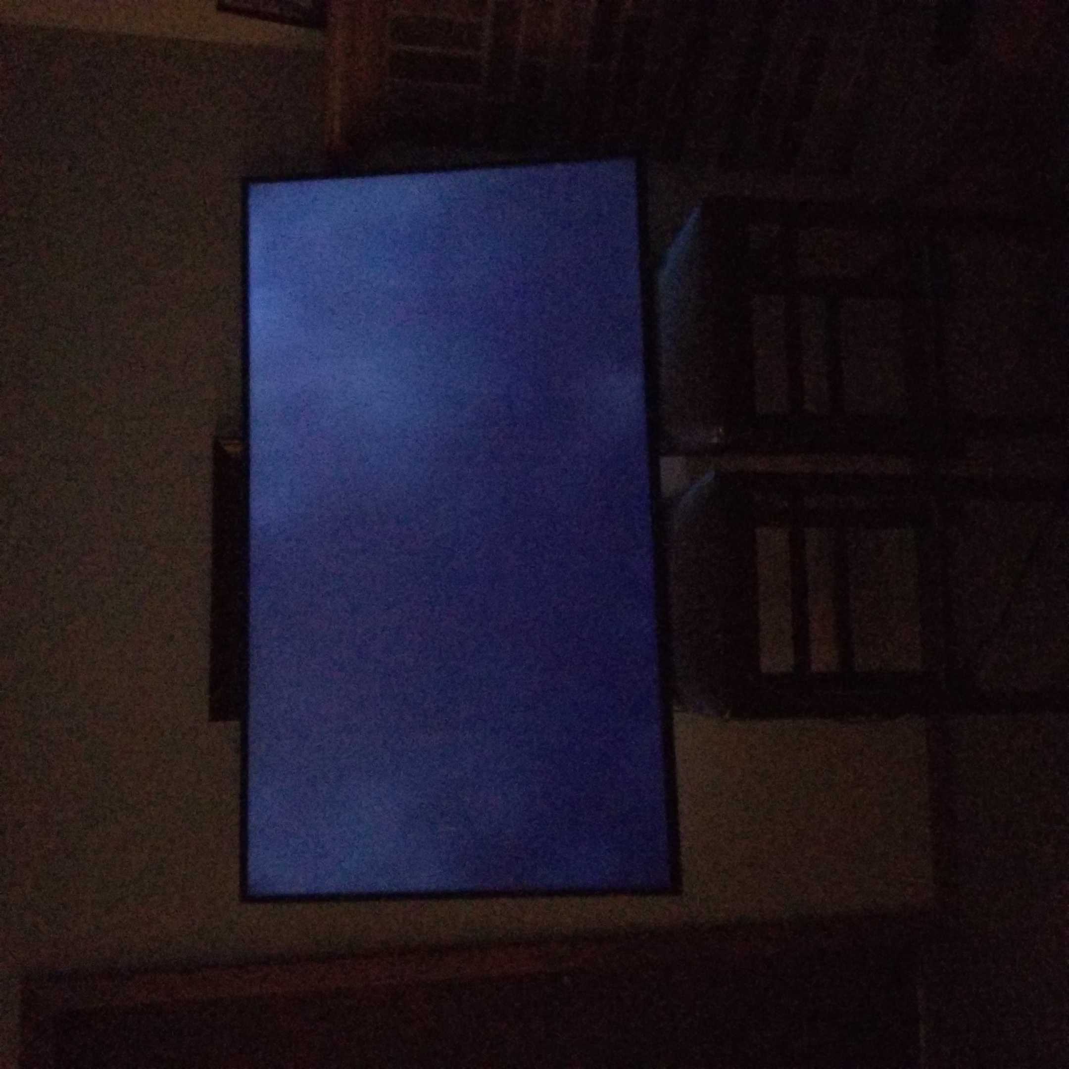

    Re: Samsung UN65KU6300FXZA no picture

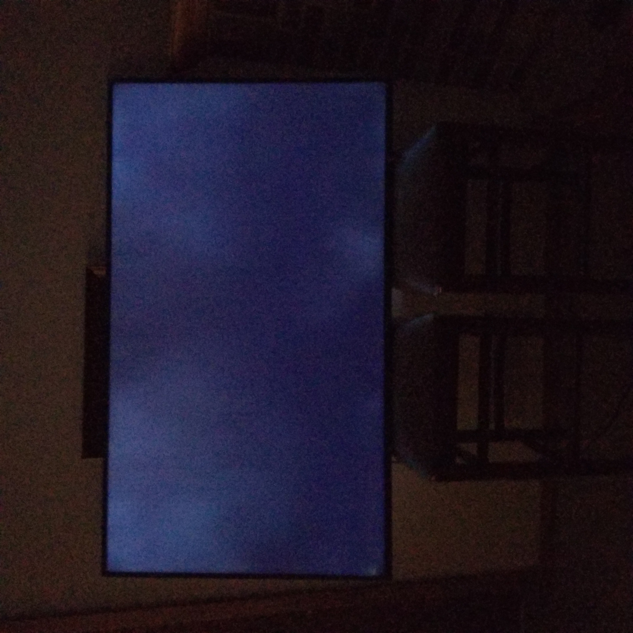

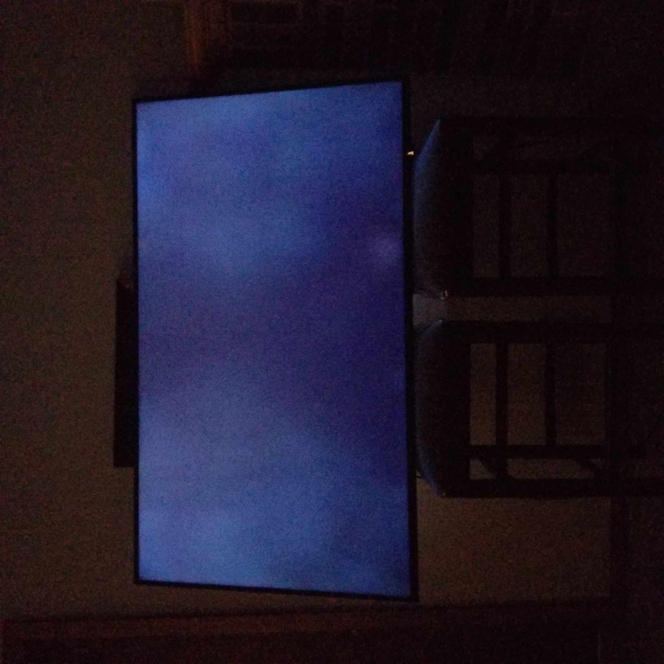

    Budm I get nothing but a blue screen that flashes bright then dim then off then repeat. Disregard post 10 if you will, I tried getting some voltages but they are all over the place in accordance with the screen flashing on and off. The only stable voltage I can get is the Panel-3.3v on the main board test point and the 12.66v coming off the power supply but only if I disconnect the cable that connects to the main board, with the cable connected the reading is all over the place for the 12.66v.
      Budwich, I already tried disconnecting the U connectors with no change at all.
            budm the cable I referred to is the cable that connects the power supply to the main board.

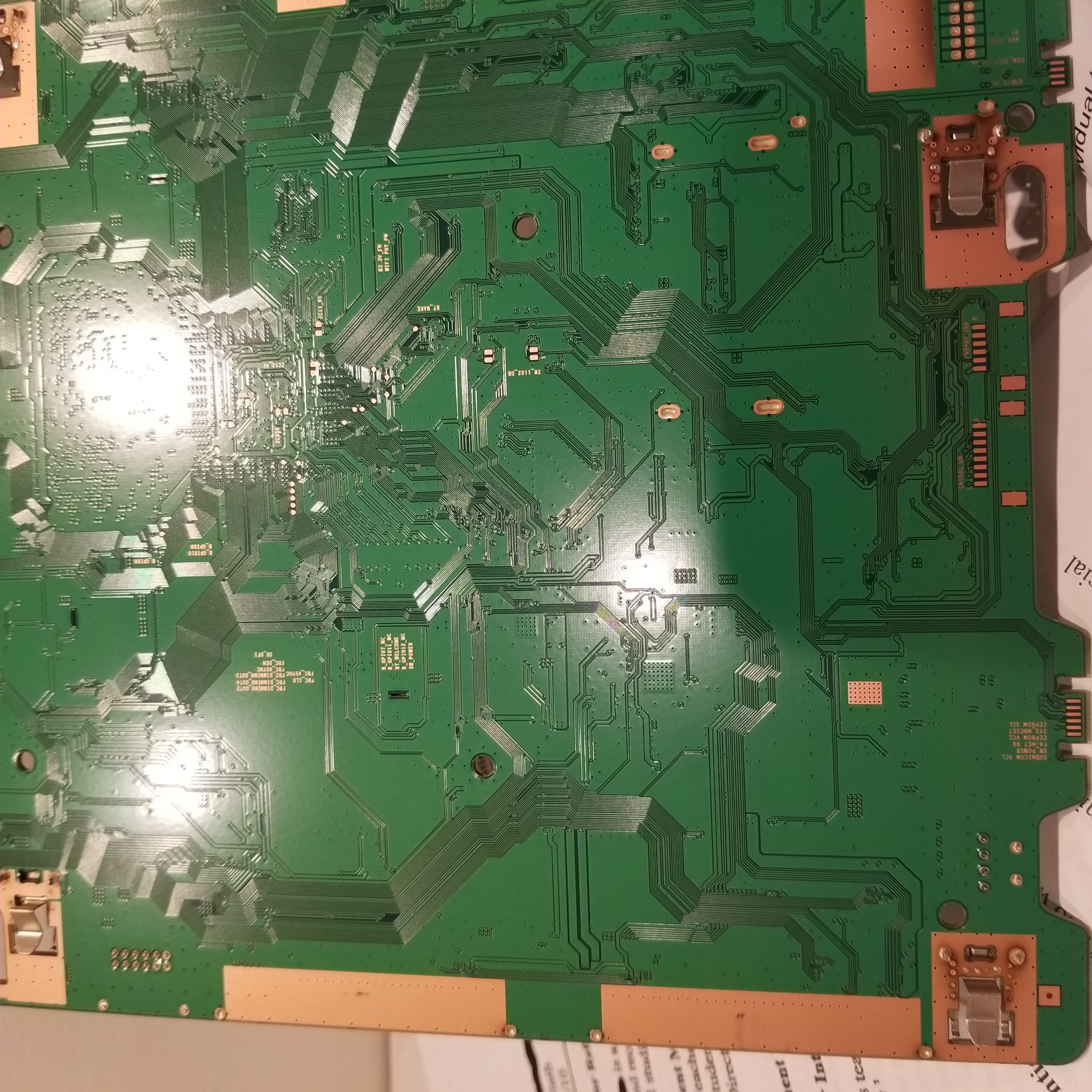

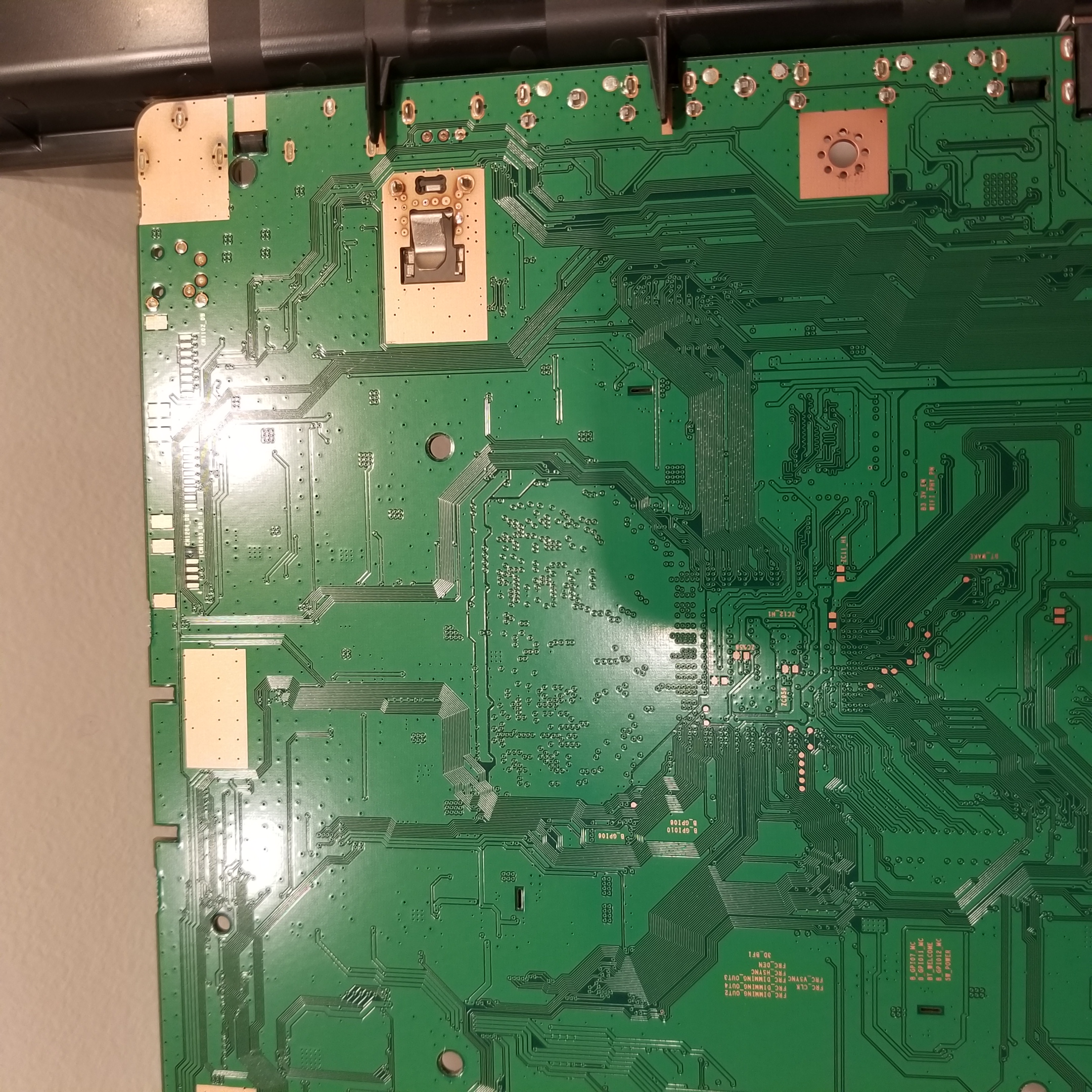

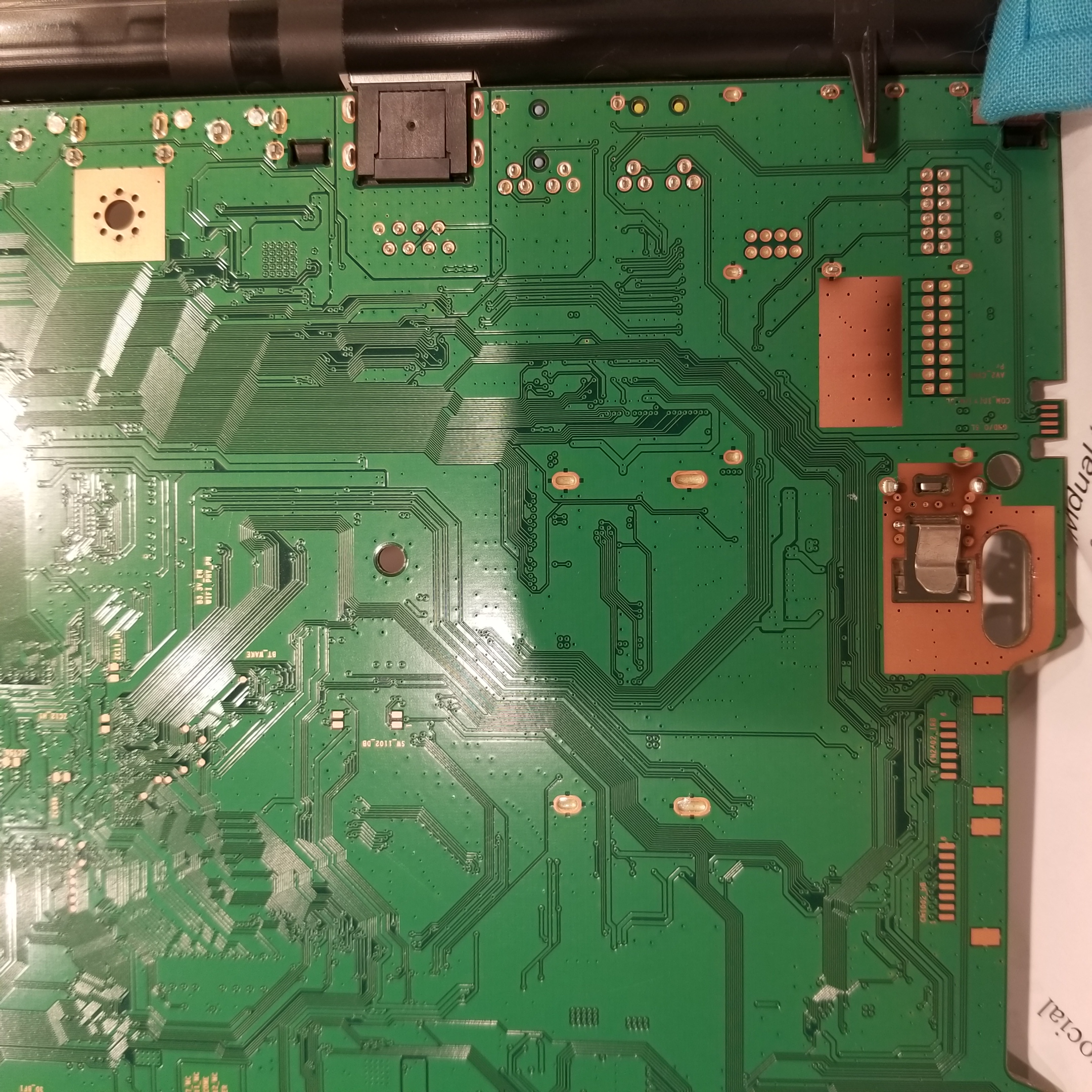

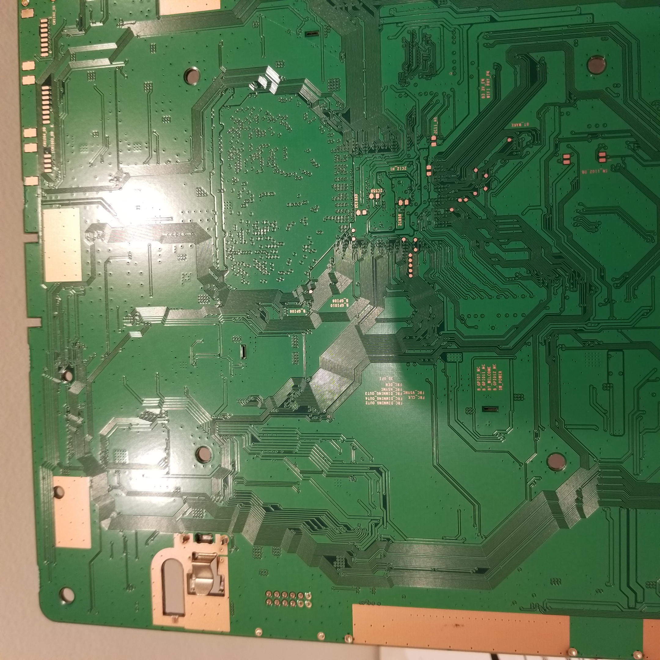

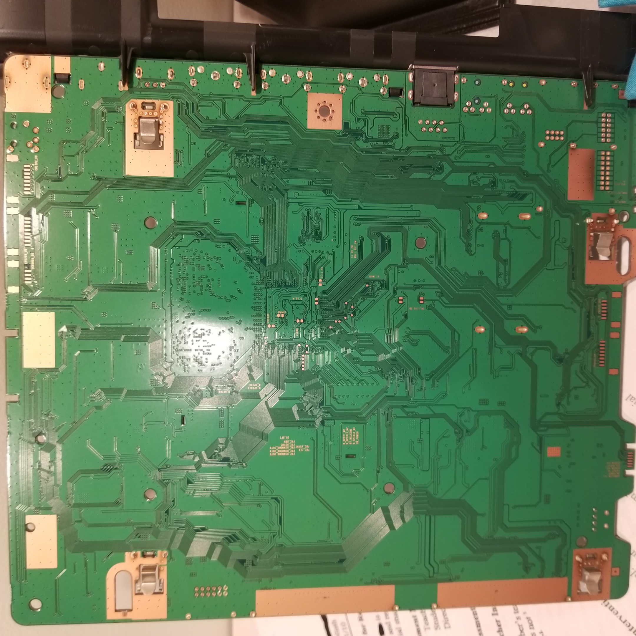

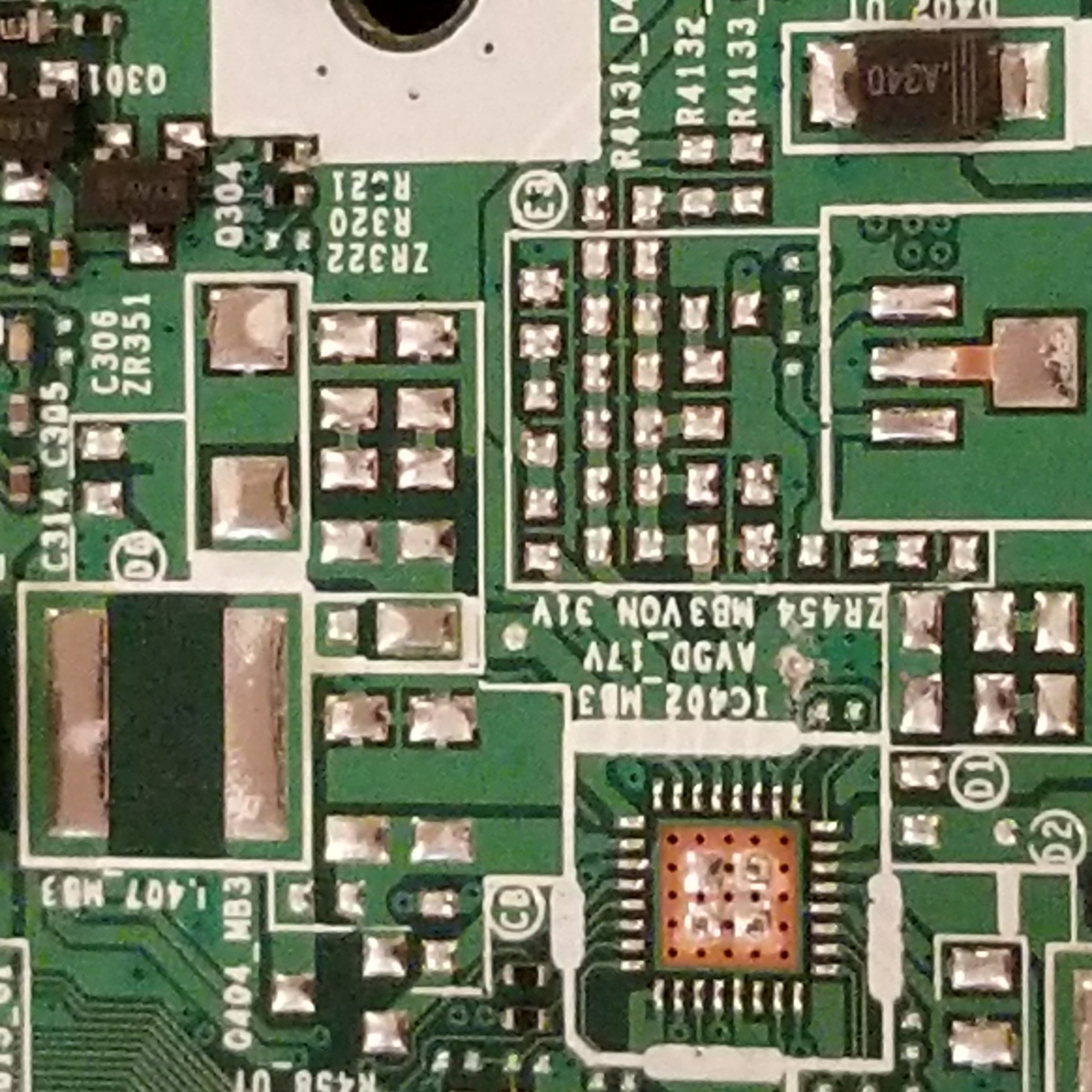

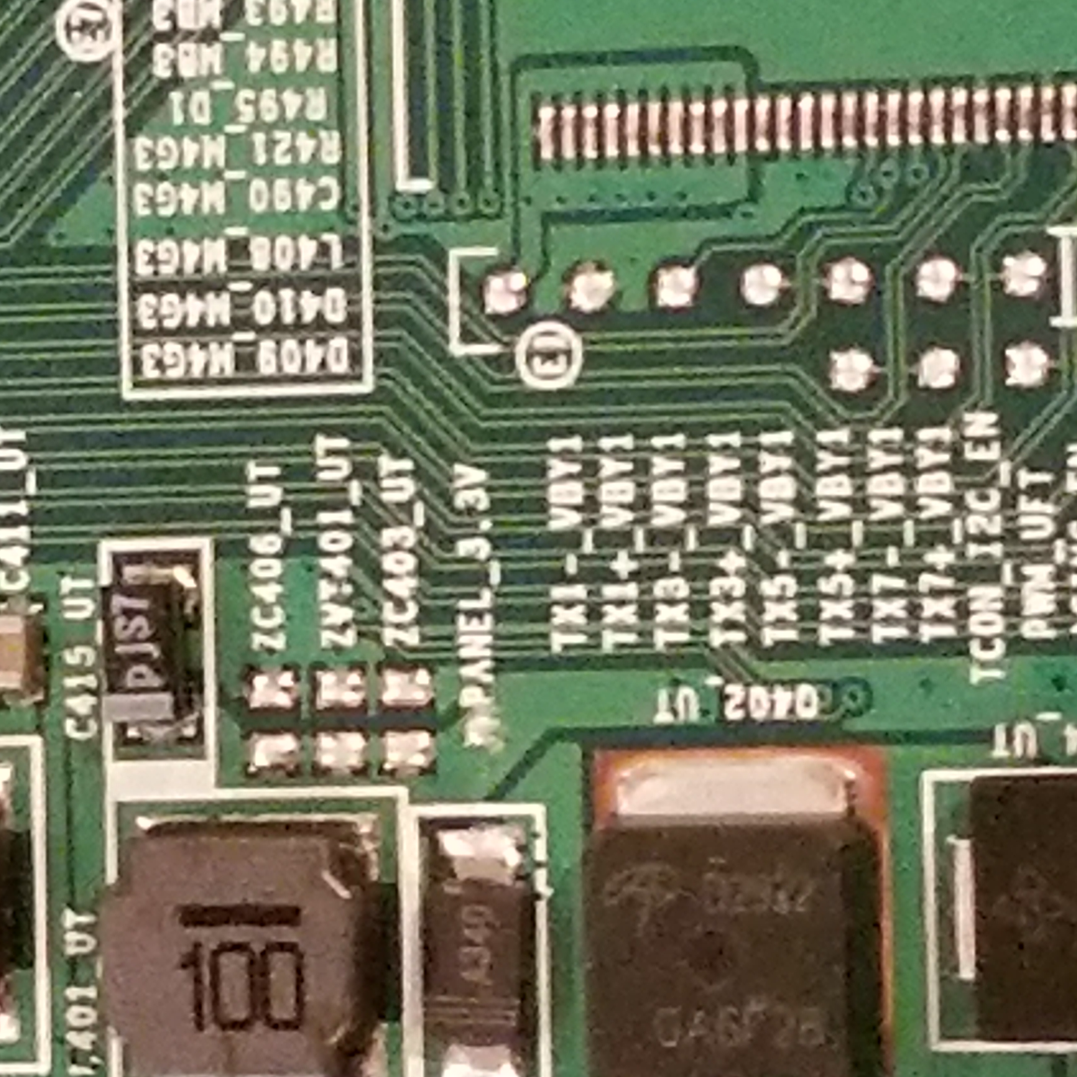

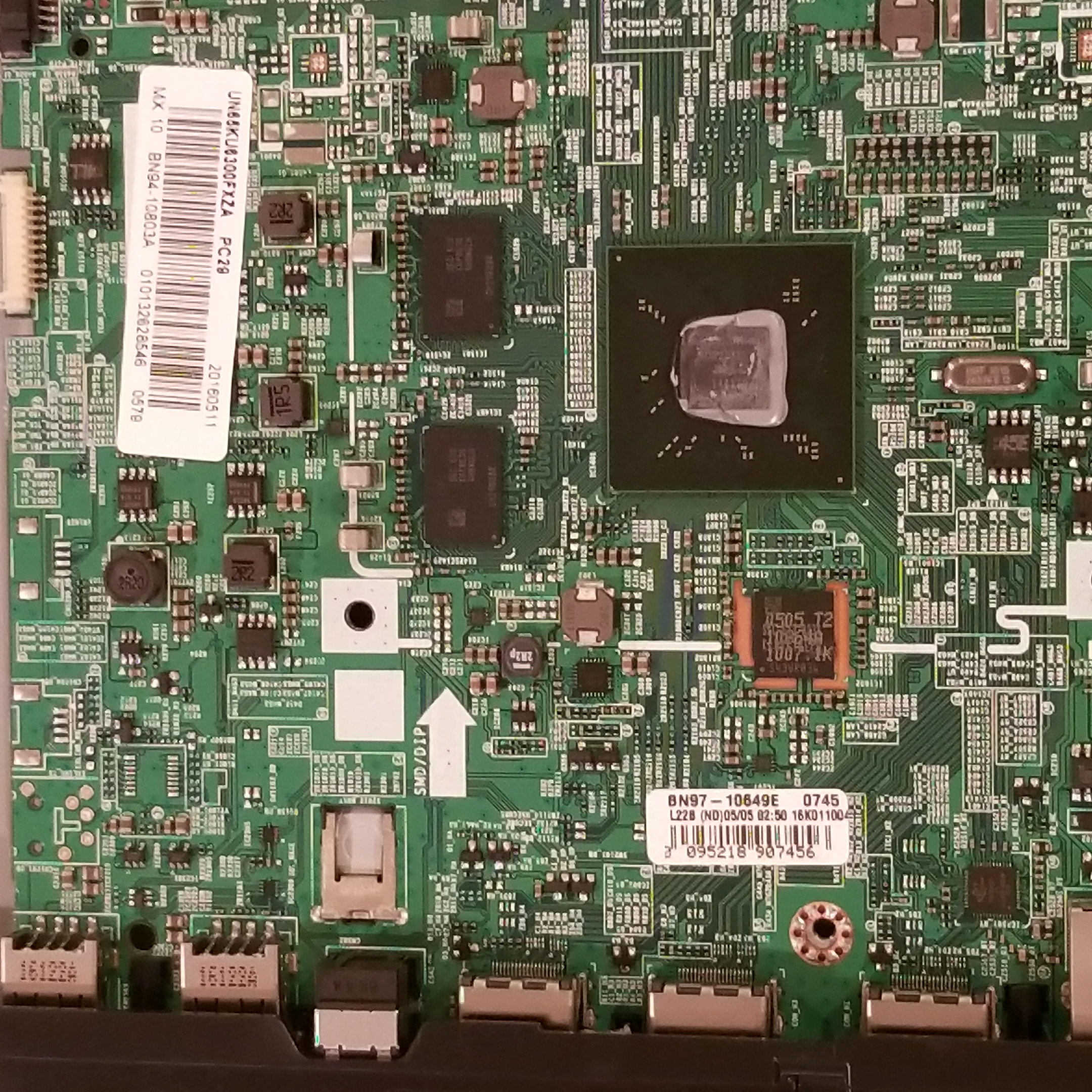

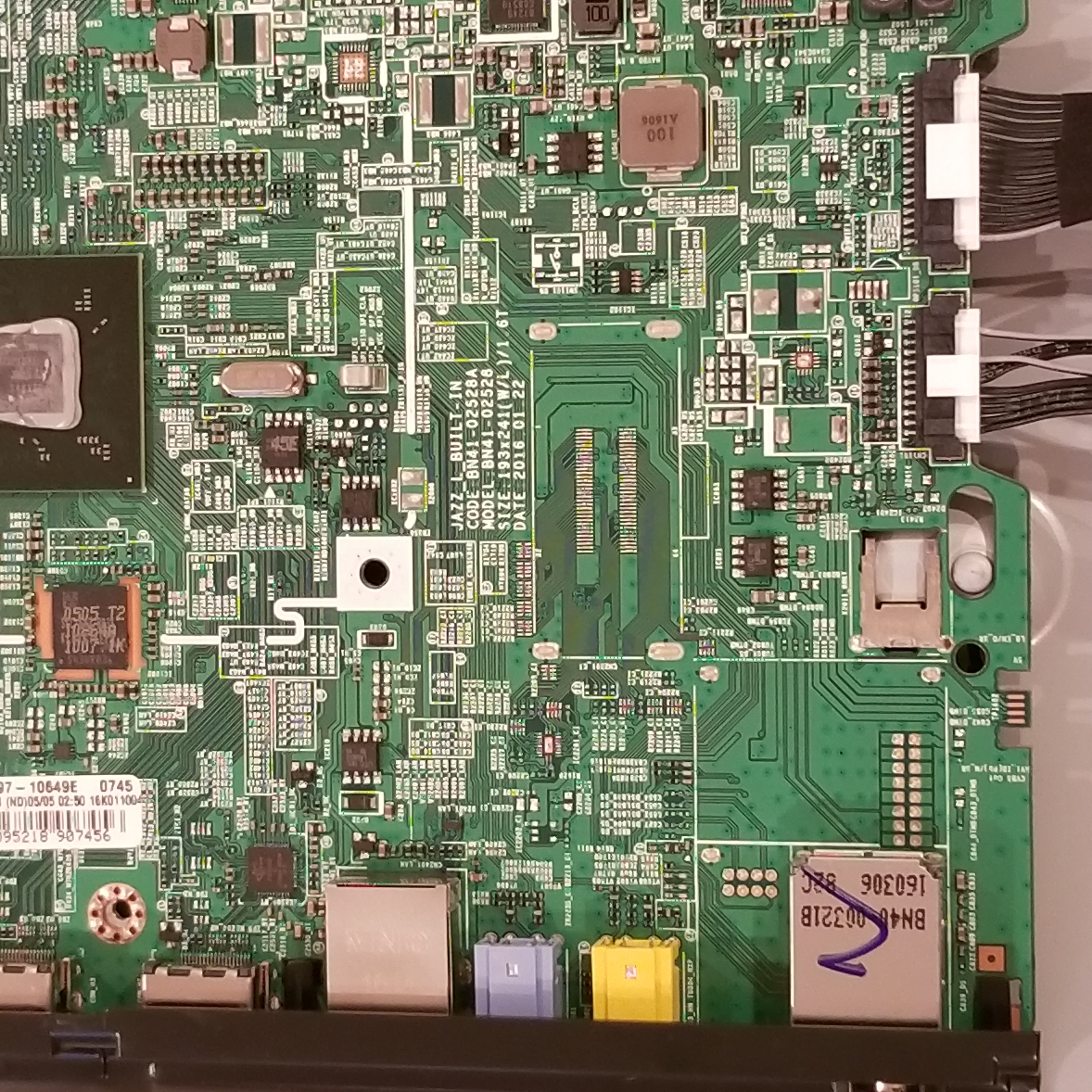

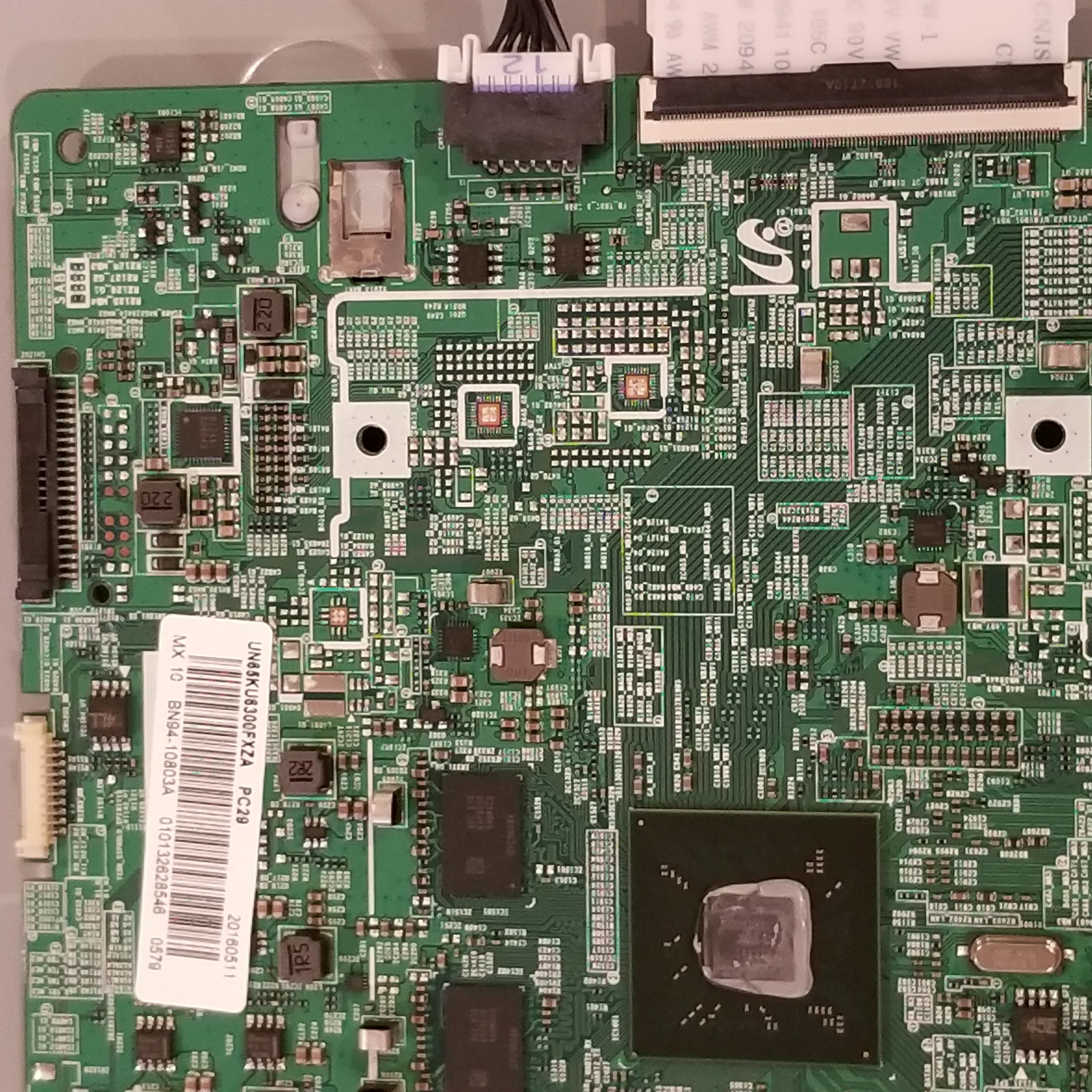

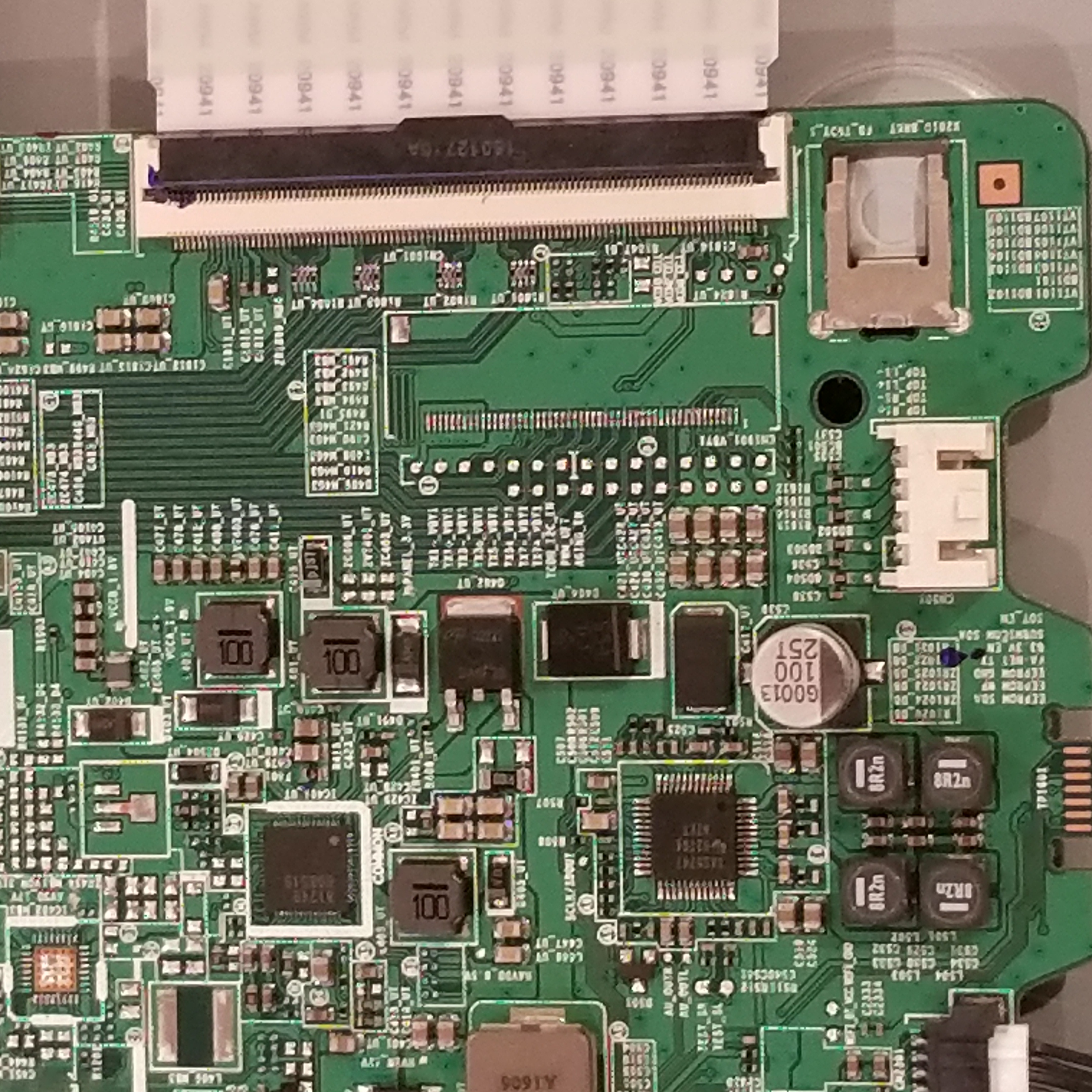

                  Hope these pics work better, the 1st 2 pics are of the 2 testing points i could find on the main board. The next 4 pics are the main board in 4 sections. The next 3 are pics of the screen, 1st pic is with uconnectors in place, 2nd is with the left u connector out and the right side in place. 3rd pic is left u connector in place and right u connector out. The only difference i could see is no matter which u connector was out the horizontal lines on the bottom where gone.
                        OK, I have to look at the pictures of the main board in details to give you the test points to test.
                        BTW, if both ribbon cables between main board and LCD panel are disconnected, is the A13V stable or it still goes up and down?
                              ok after a 2nd check i realized i had VM set on ACv, on DCv i get 12.66v on the power supply with the cable connected to the MB but it drops to 9.4v and shoots back to 12.66v right before the lights come on. i get 3.3v at panel check point but the AVDD is all over the place, seems to be at 2.0mV and goes up but nowhere near the 1.7v it should get with everything hooked up.
                                  OK.
                                  In standby mode the 13V will be about 9V to save energy but enough to keep the main board alive, when PS-ON is present it will jump back up to 13V.
                                  So at this moment the 13V is steady, right?
                                  The AVDD (about 15 ~ 20V) is generated by the boost converter on the T-CON circuit on the main board that converts 12V to high Voltage AVDD. We have to check and see if that T-CON circuit on the main board is getting 12VDC to run or not
                                    with the LVDS disconnected at the MB, backlight comes on bright then dims then off, red optical led comes on at power on and stays on for a bit after the tv powers off then goes out, tv powers back on and repeats.

                                      yes the 13v is steady, i couldn't tell if the AVDD says 1.7v or 17v on the board but i have seen flashes of up to 16v and OL.
                                        please upload photo high resolution on the back side of the main boards
                                        • eagle00799
                                          • May 2012
                                          • 322
                                          #40
                                          Backside of main board
