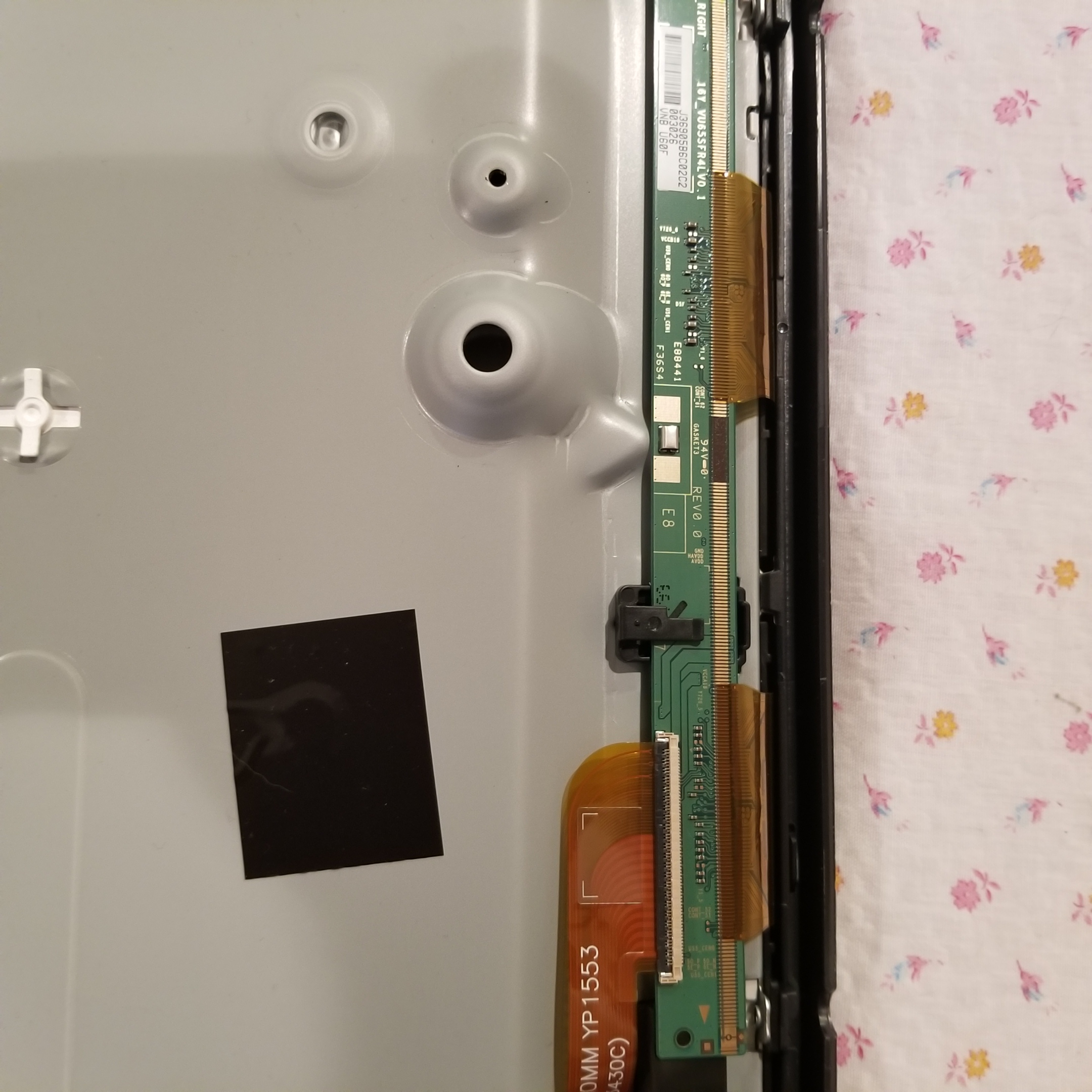

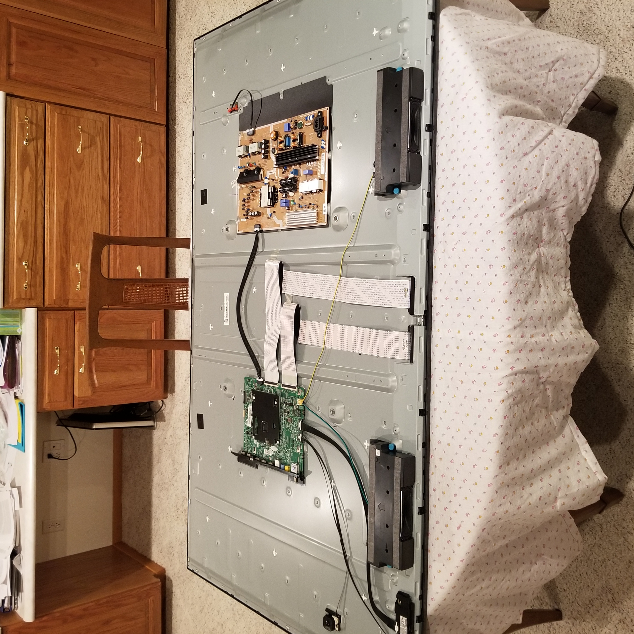

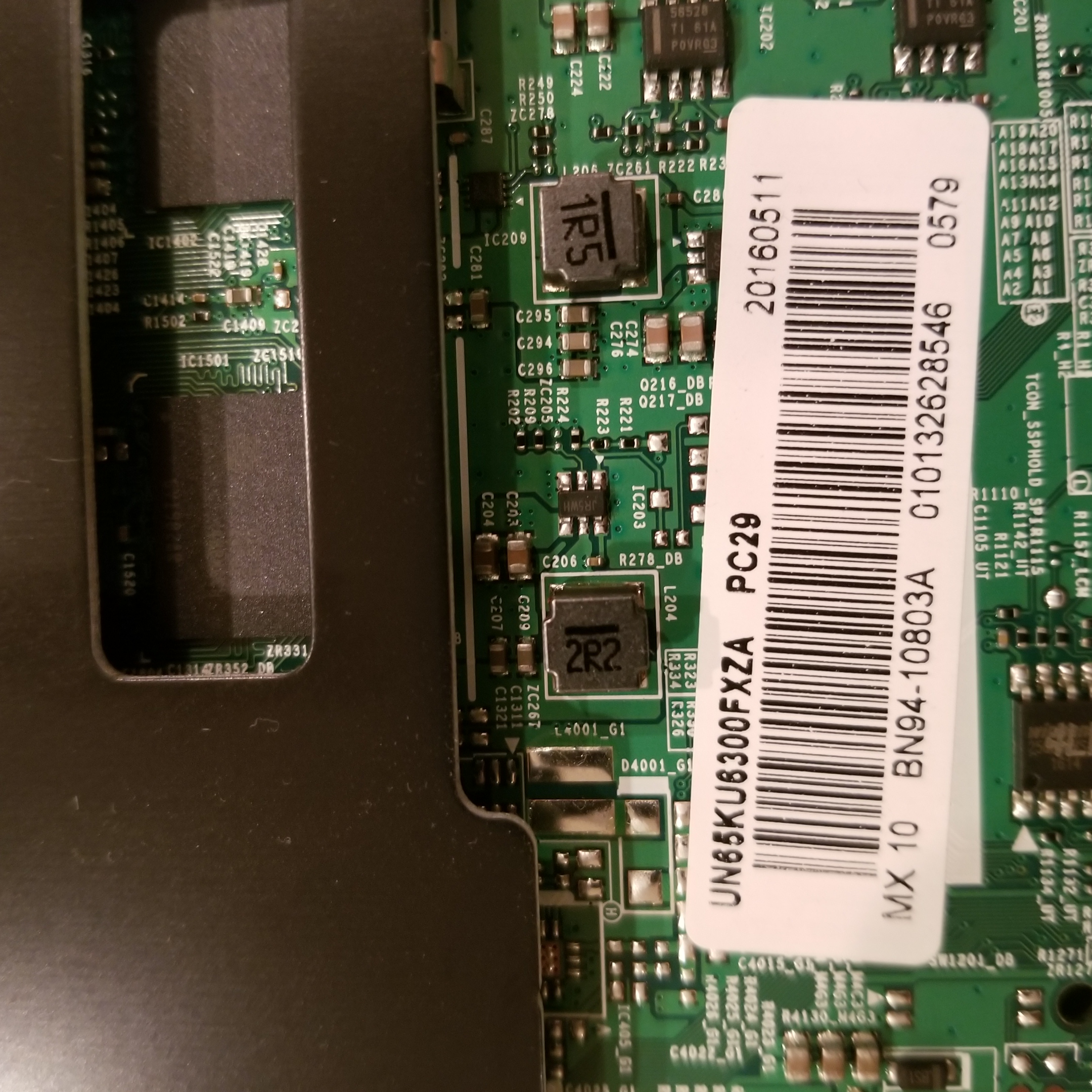

    Good day everyone! I'm looking for some help/advice/direction with this Samsung UN65KU6300FXZA with no picture. When powered on the backlights come on for a couple of seconds then dim down for a couple of seconds then it powers off, powers back on and repeats the same process over and over again and there is never any logo or anything just a bluish screen and the only way to shut it off is to unplug it. when I disconnect the plug connecting the power supply to the main board the backlights come on and stay on, when I disconnect the ribbons on the main board one at a time it doesn't change the screen at all, I've always gotten a white half screen on the side that was disconnected with other tv's I've worked on. Is this a bad panel? I know there have been EEprom issues with these tv's!?!? Advice?
    Here is the layout of the tv.

    Re: Samsung UN65KU6300FXZA no picture
    That model doesnt have a tcon board so you cant do the half screen test. I have seen bad panels (cracked) which will cause no video and unstable backlight. Like the guy in this post, you can try disconnecting the interconnect cable between panel boards to see if the video will come up and isolate which section of the panel is bad and also look for shorted caps on these boards. https://www.badcaps.net/forum/showthread.php?t=87562

      Thanks for the reply neilc6, I pulled the innerconnect cable first on one side with no change at all, then the other side with no change at all. any other ideas?

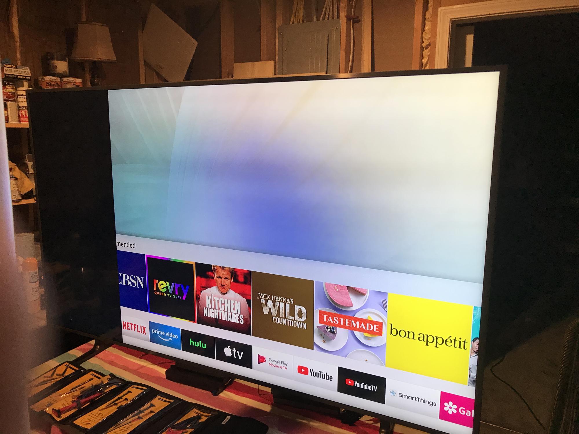

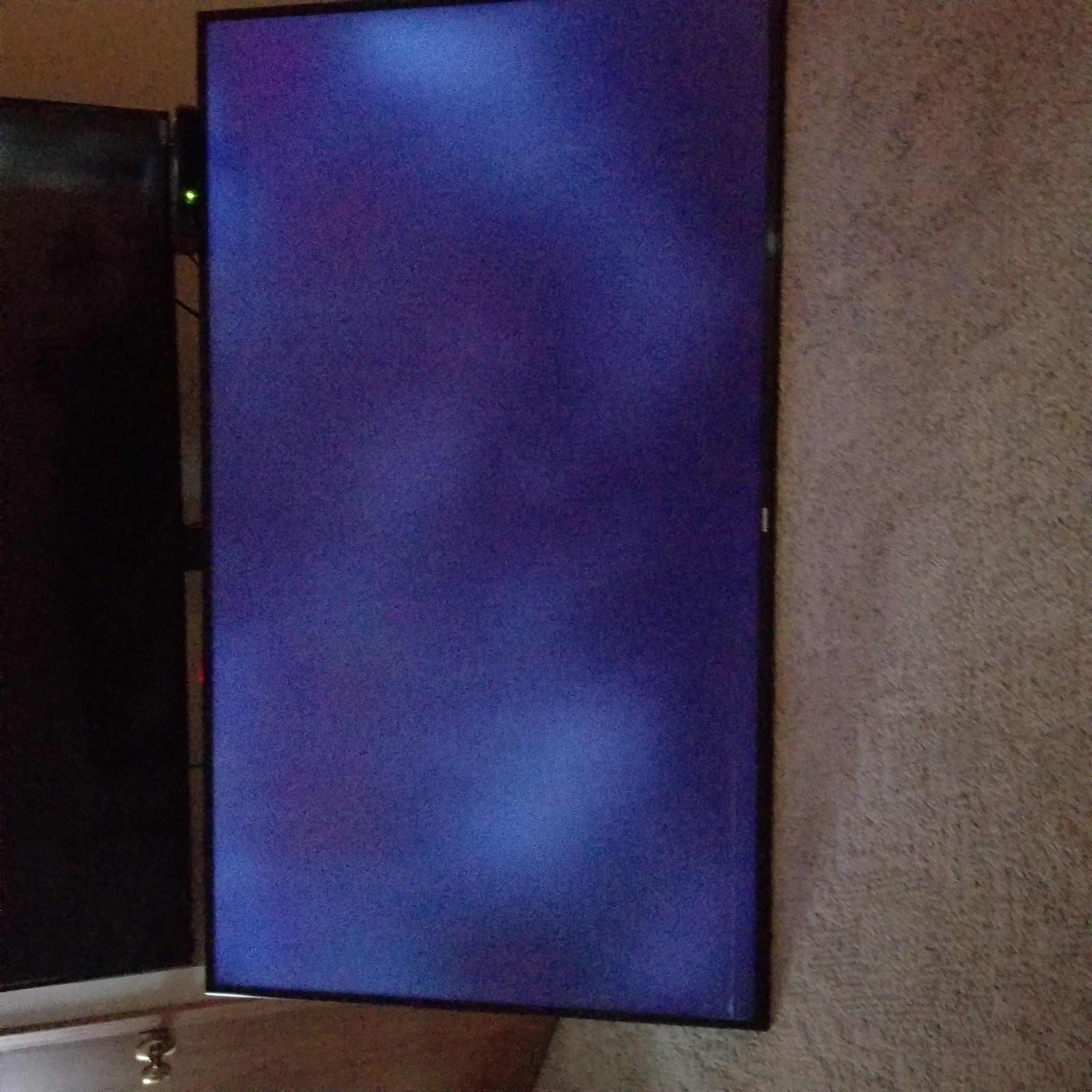

        a pic of the blue screen
            is that a small horizontal line in the bottom left hand corner of the panel or a reflection? IF its a line, you have a panel issue.

              You need to test the Tab bonding/Panel boards next.
              You have to get the speakers out off the ways then remove the two metal shields to see the boards.

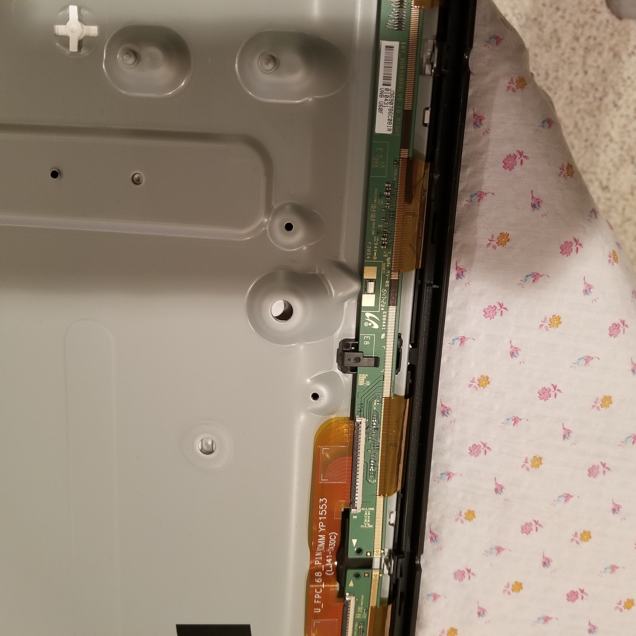

                Budm, I did take the metal covers off and removed the ribbon that connects the 2 boards, first on the left side then reinstalled the ribbon and then I did the same on the right side and it made no difference on the screen on either side. as far as the line, when powered on I get the horizontal lines on the bottom 3rd of the screen but they go away. it's almost like it's trying to display the wifi banner that goes across the bottom of a normal screen but it just can't do it and the lines go away!?!?
                  I need to see the pictures of those boards.
                    like this banner on the lower screen is what I was referring to

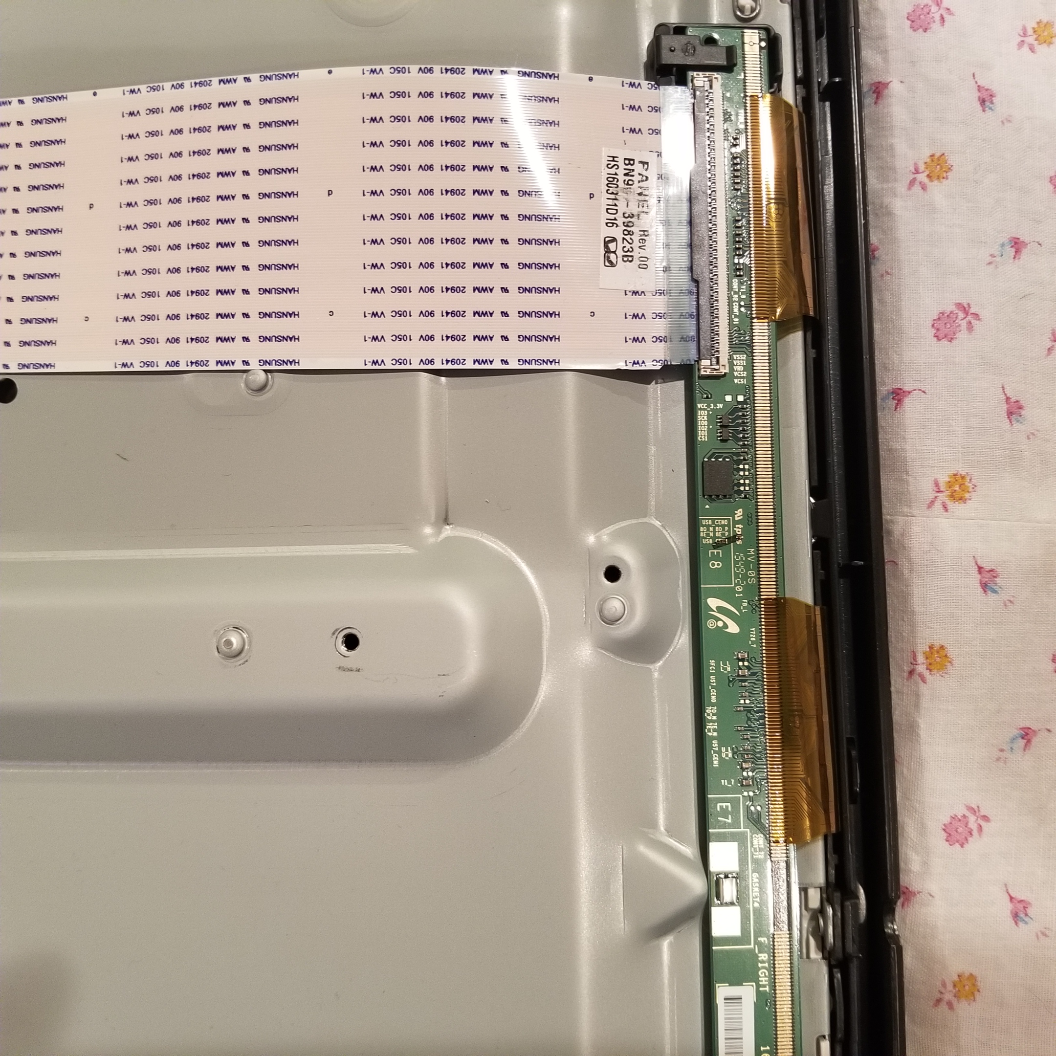

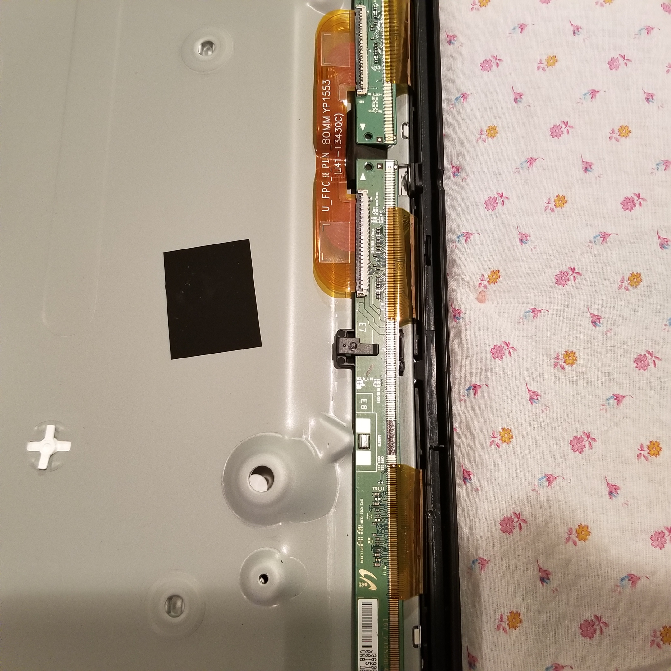

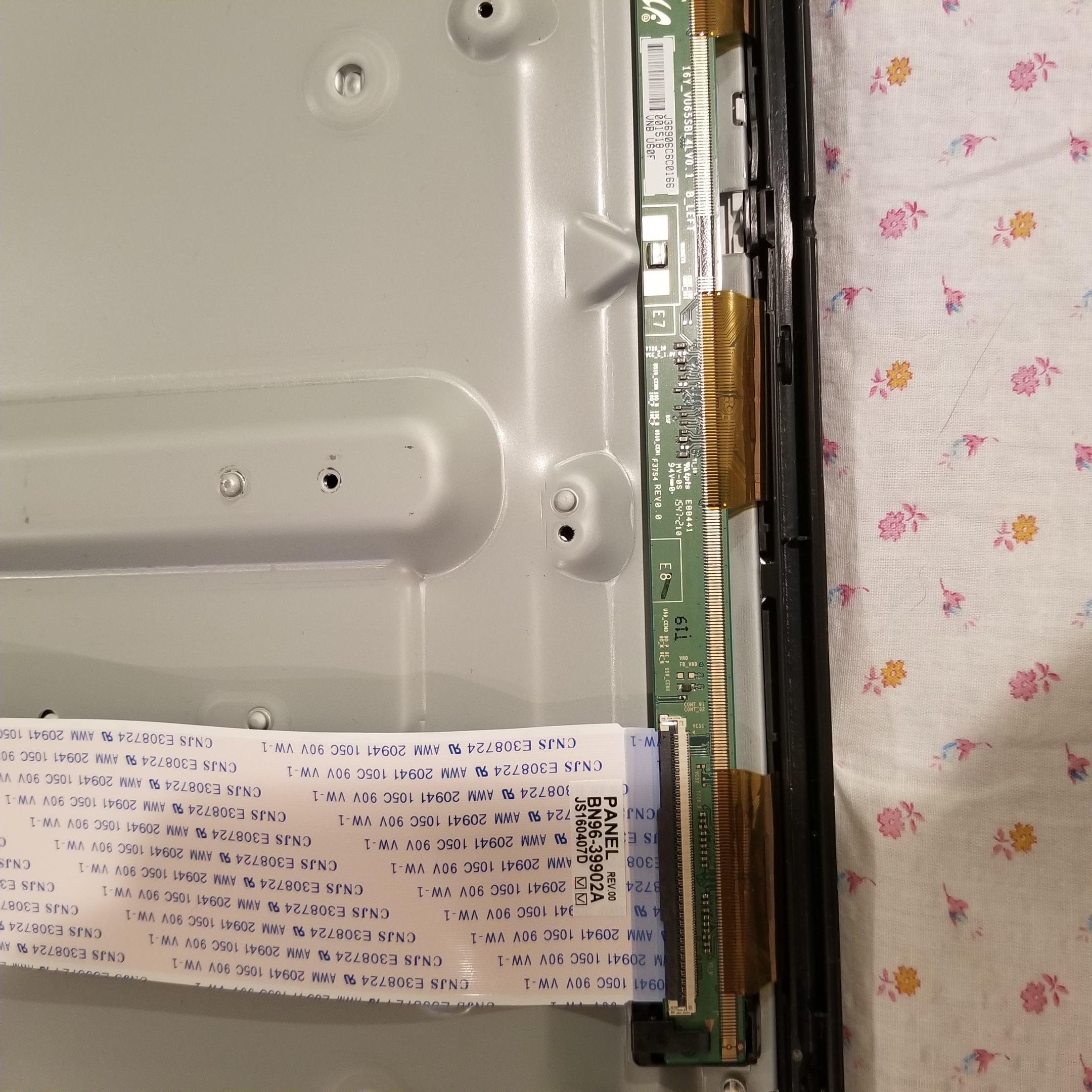

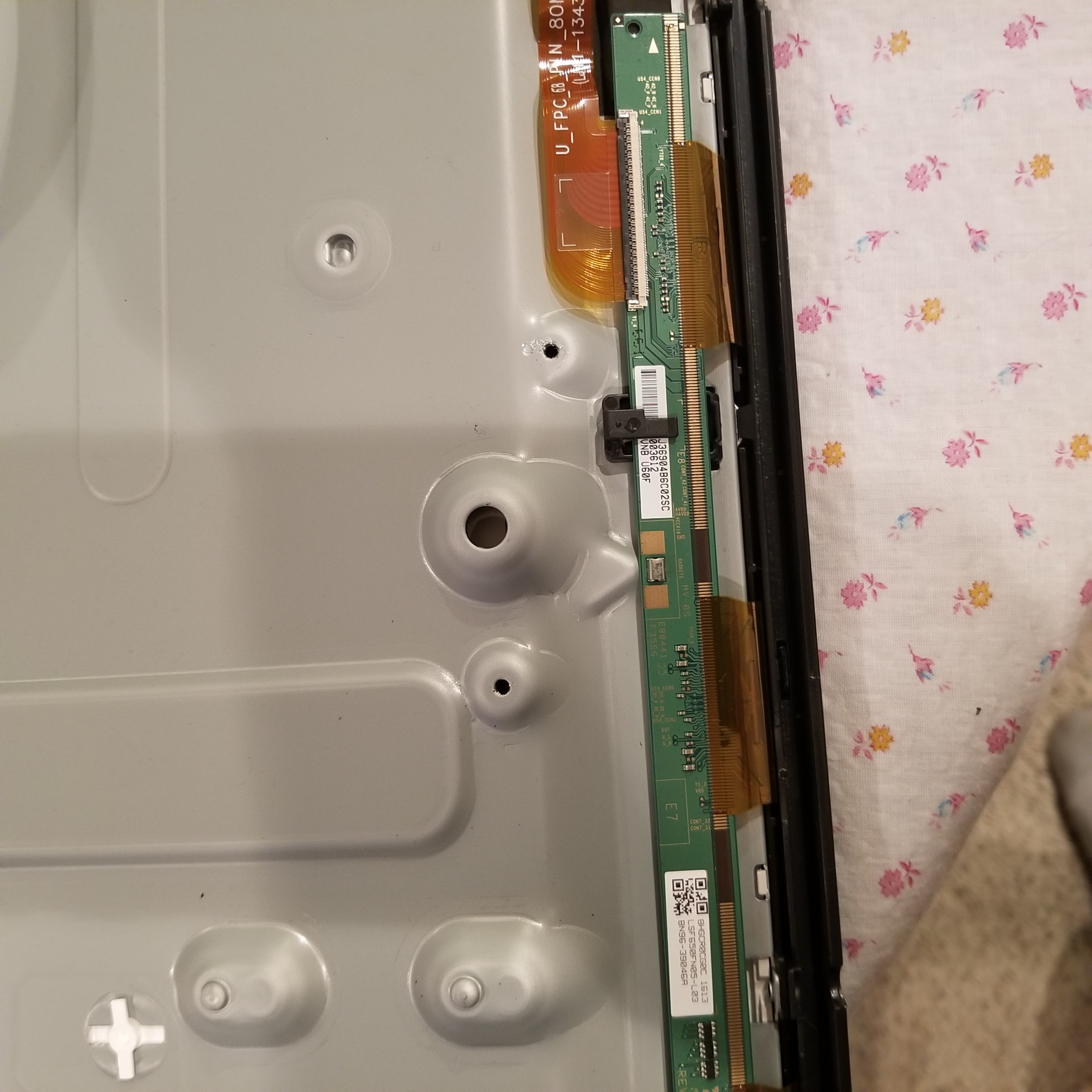

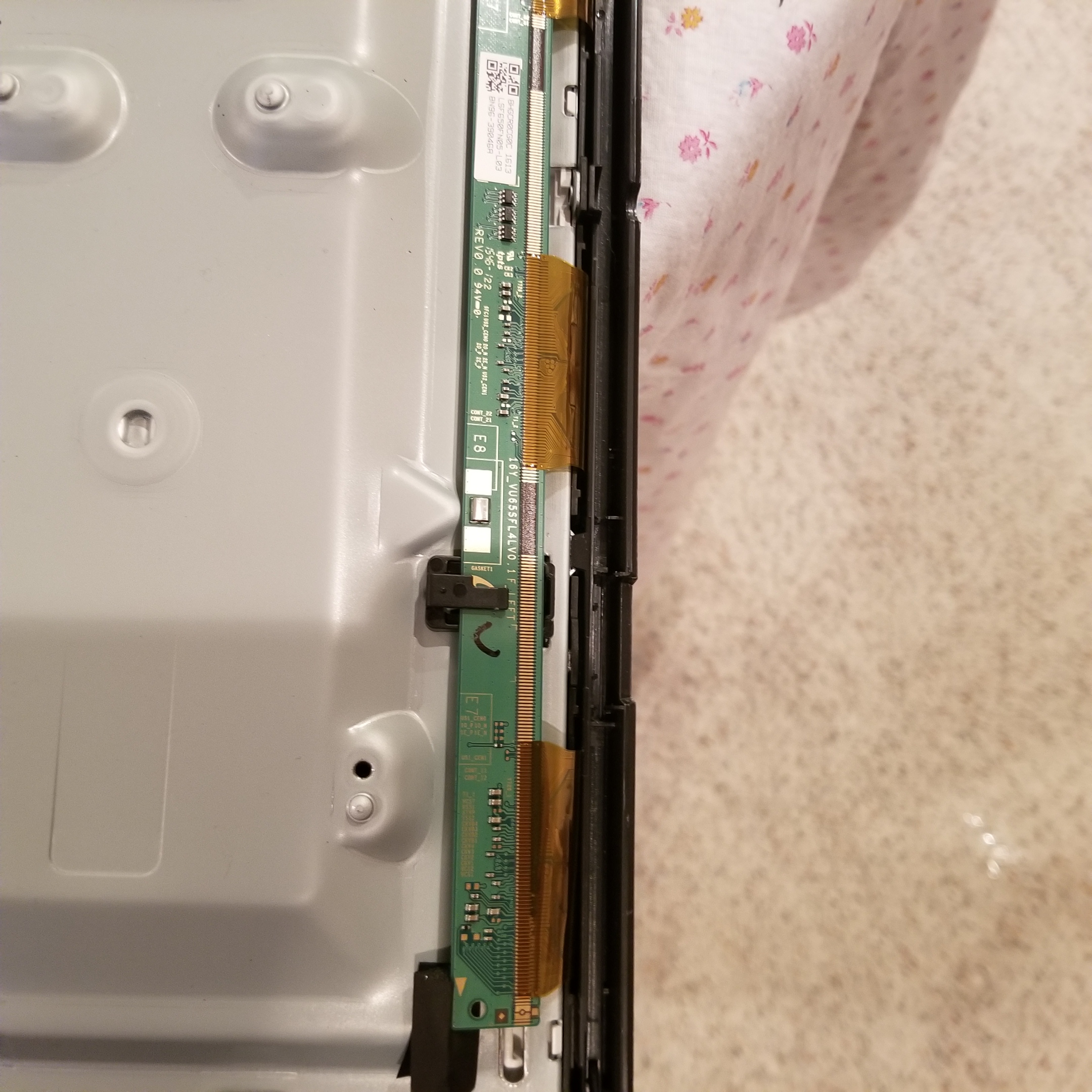

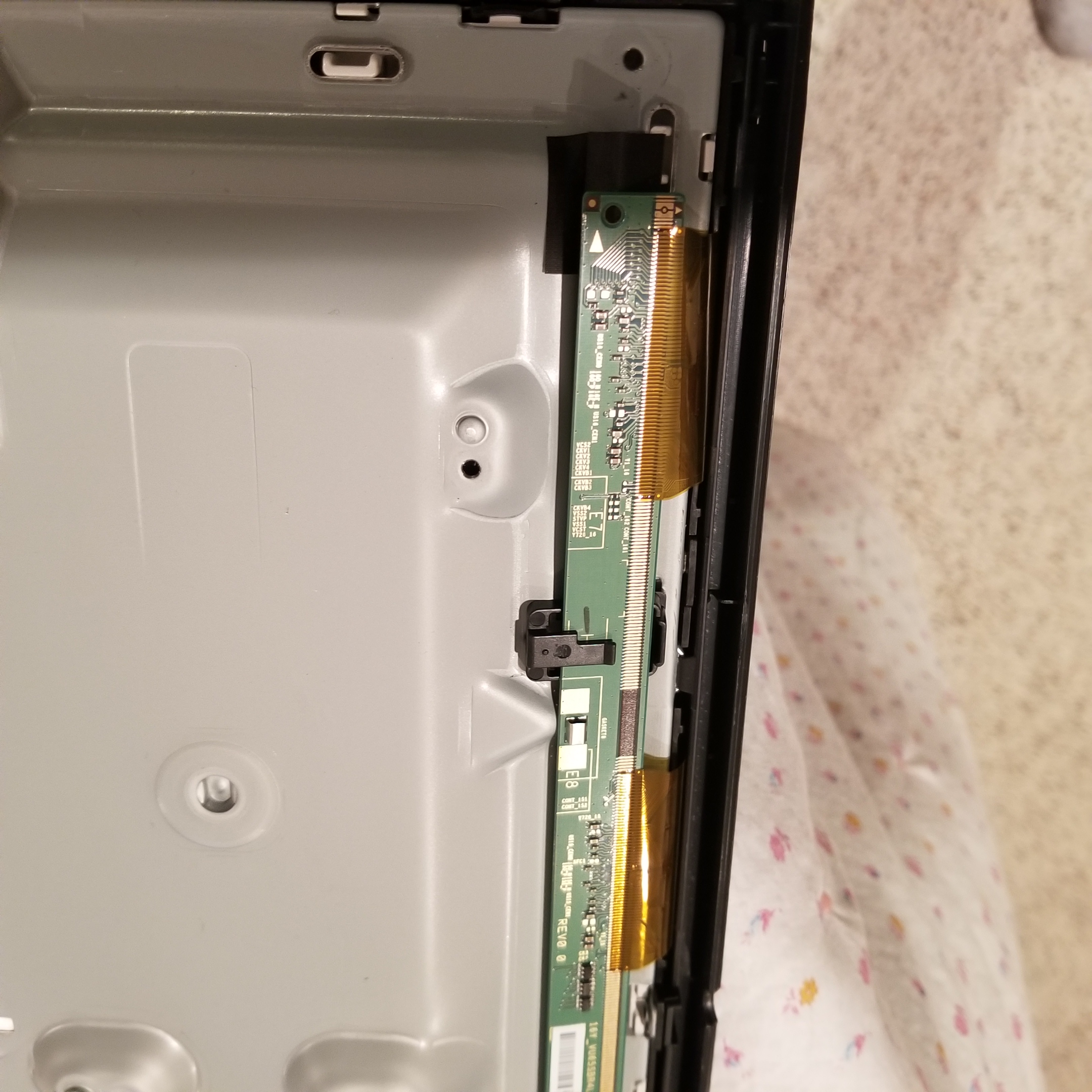

                        pics of tab bonding/panel boards
                          Tougher to troubleshoot possible tcon problems but with no tcon board. I salvaged a newer Samsung RU series and it was down to just a single combined power supply/main board and no screws.
                          The one I referred in post 2 had a L shape crack on the edge and turned on with no video and an unstable backlight. I ripped the tab bond off at that end and got it to display video so confirmed panel problems can cause no video.

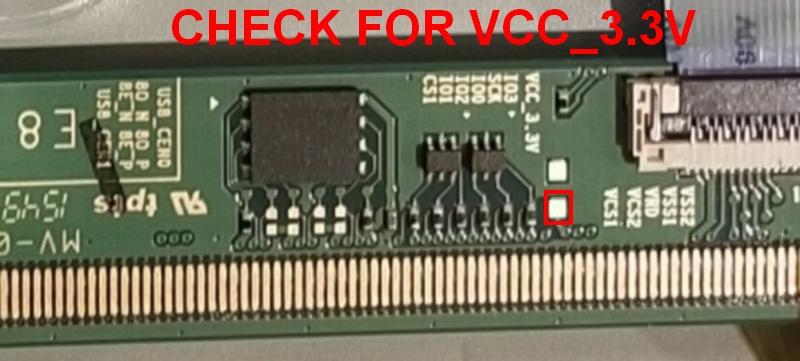

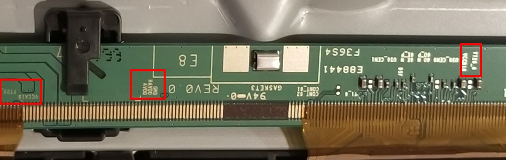

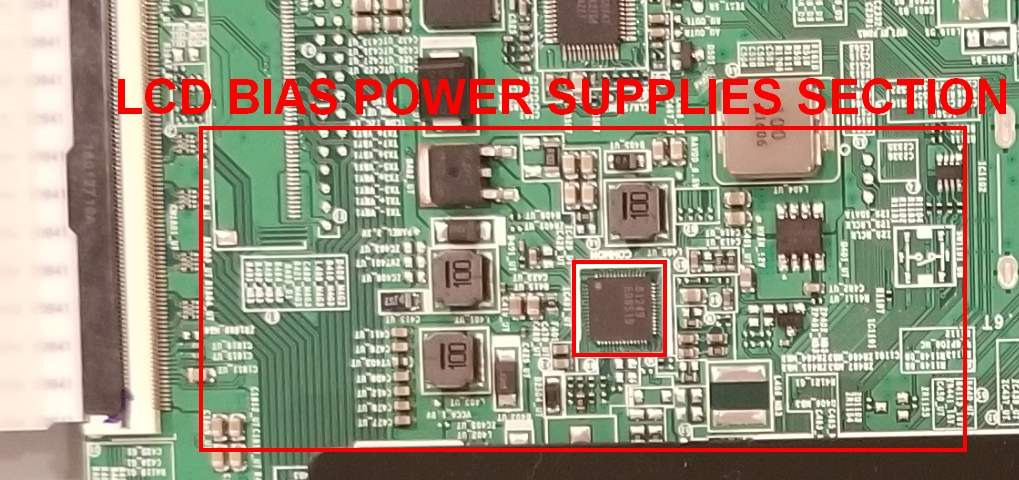

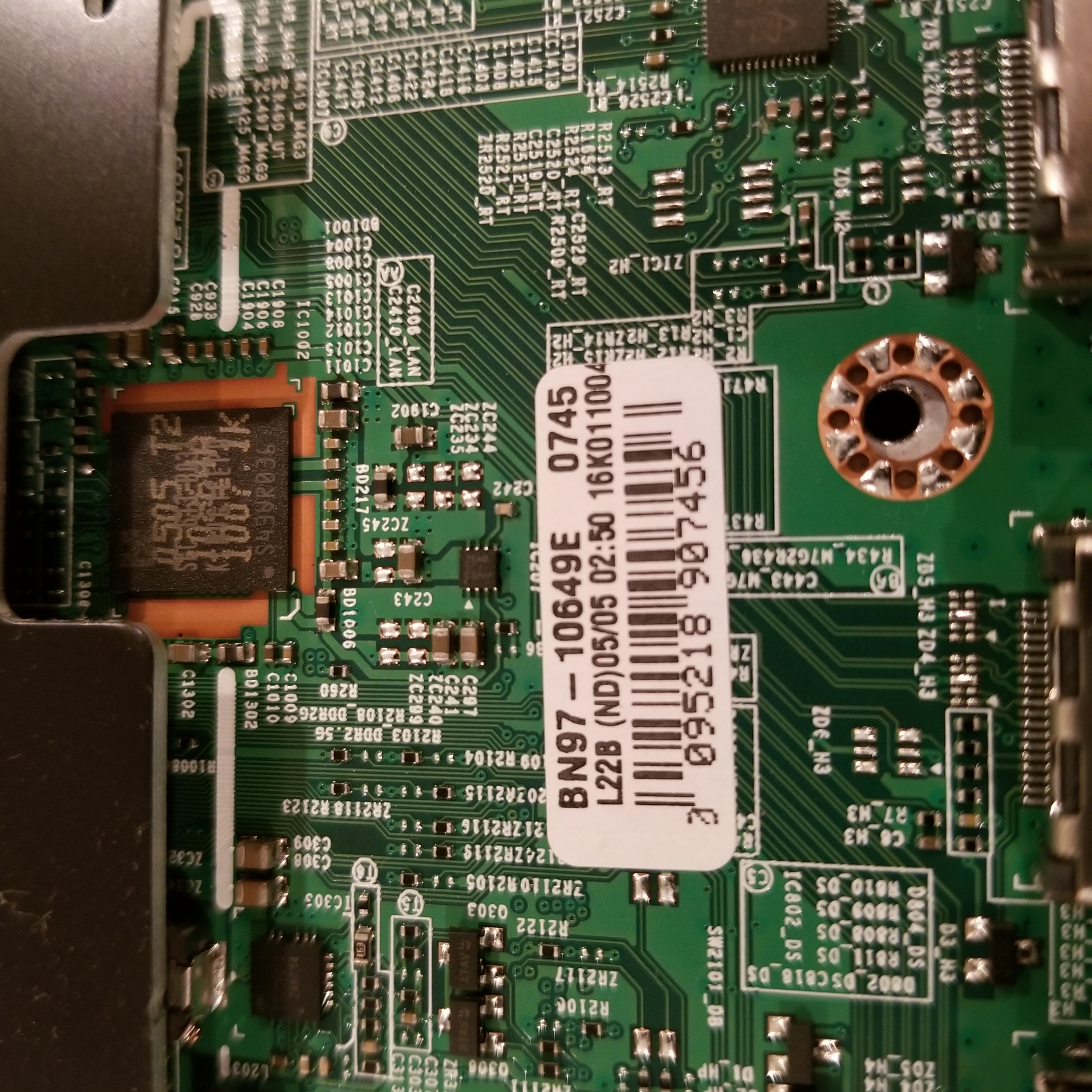

                            Looking at the pictures of the bonding boards, I can see some Voltage test points, I.E VCC_3.3V, AVDD, Etc. that you may be able to check.
                            See example pictures attached.

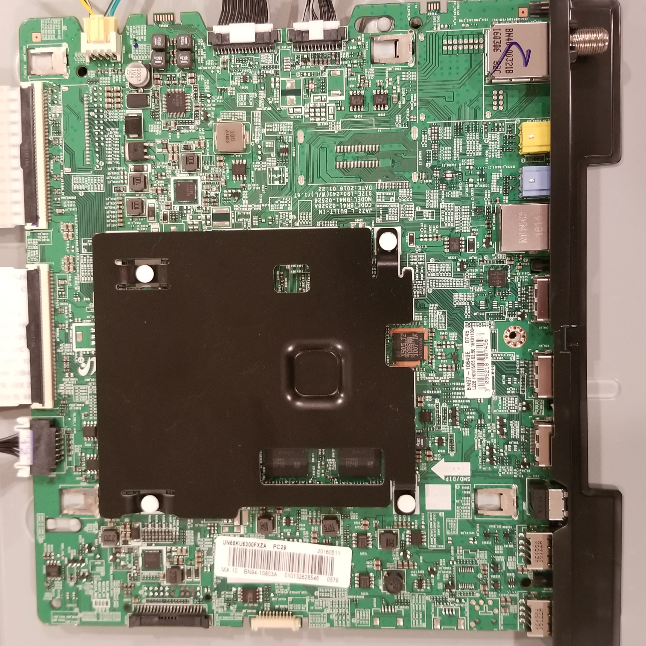

                            The T-con circuits are on the main board in this on.
                            If you can look at the main board around the LVDS connectors may be you can locate the AVDD test point some where on the main board.Picture of the main board is not clear enough to see Voltage test points.
                                  you are lucky though.... you can do some more testing before going after any side tabs.
                                  you posted a picture of the bottom edge / tcon boards. There are "U" cabling interconnecting the sections of the edge board. Although, I can't tell... but it is likely that there are two edge boards per half side of panel. IF so, the "U" cables can be unclamped / disconnected. This will isolate the "1/4" outside portion of the panel along with any side stuff without doing any permanent damage (ie. like tab removal).
                                  With all cabling connected on the set (ie. power, main, tcon), disconnect the "U" cable (with power disconnected / off).... power up and see if anything changes. Try the same test with the other side. IF you are lucky, you may see a display of some sort.
                                    BTW, the picture in your post #10 is what is shown on your screen? I thought you get nothing on the screen at all at this point.
                                    • budwich
                                      • Jul 2015
                                      • 3097
                                      I think that is a picture from another screen... you can see he has a tv in the back of the set that he is working on. He was just trying to indicate what the screen "should" look like if it displayed properly as opposed to that "very little line" in the bottom left corner.
                                        But that picture is from the thread here POST #2: https://www.badcaps.net/forum/showthread.php?t=87562 of difference OP.
