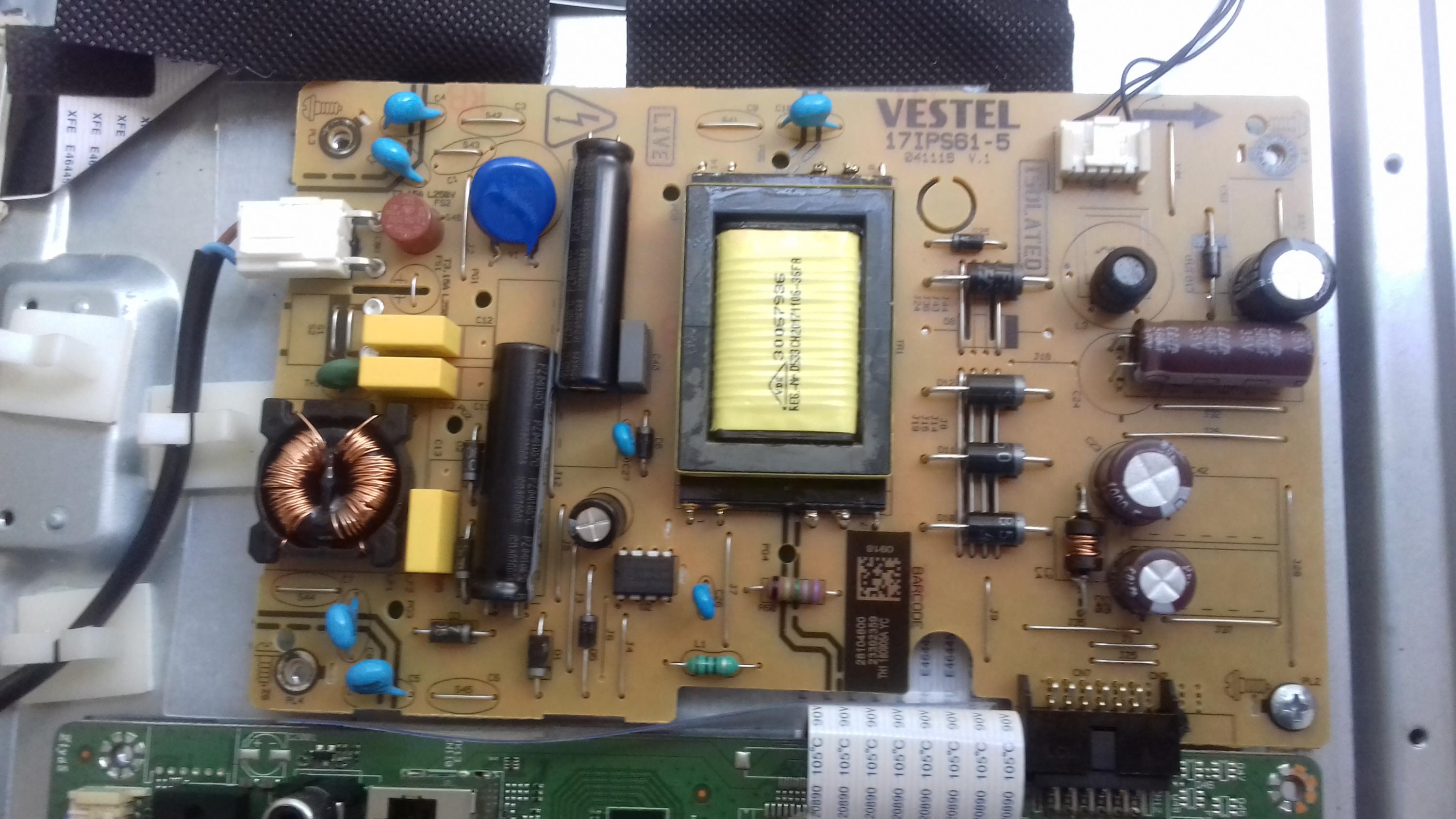

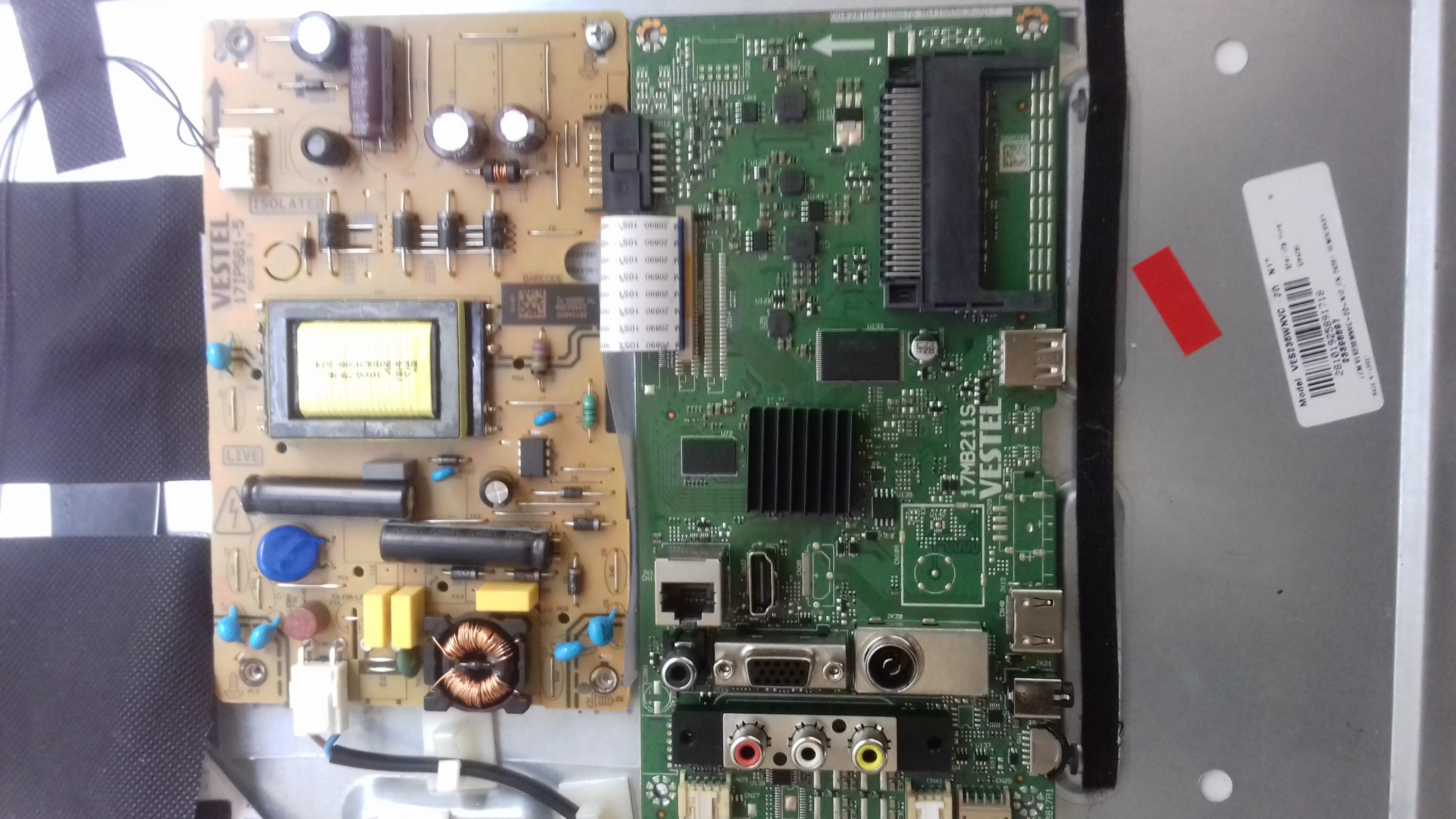

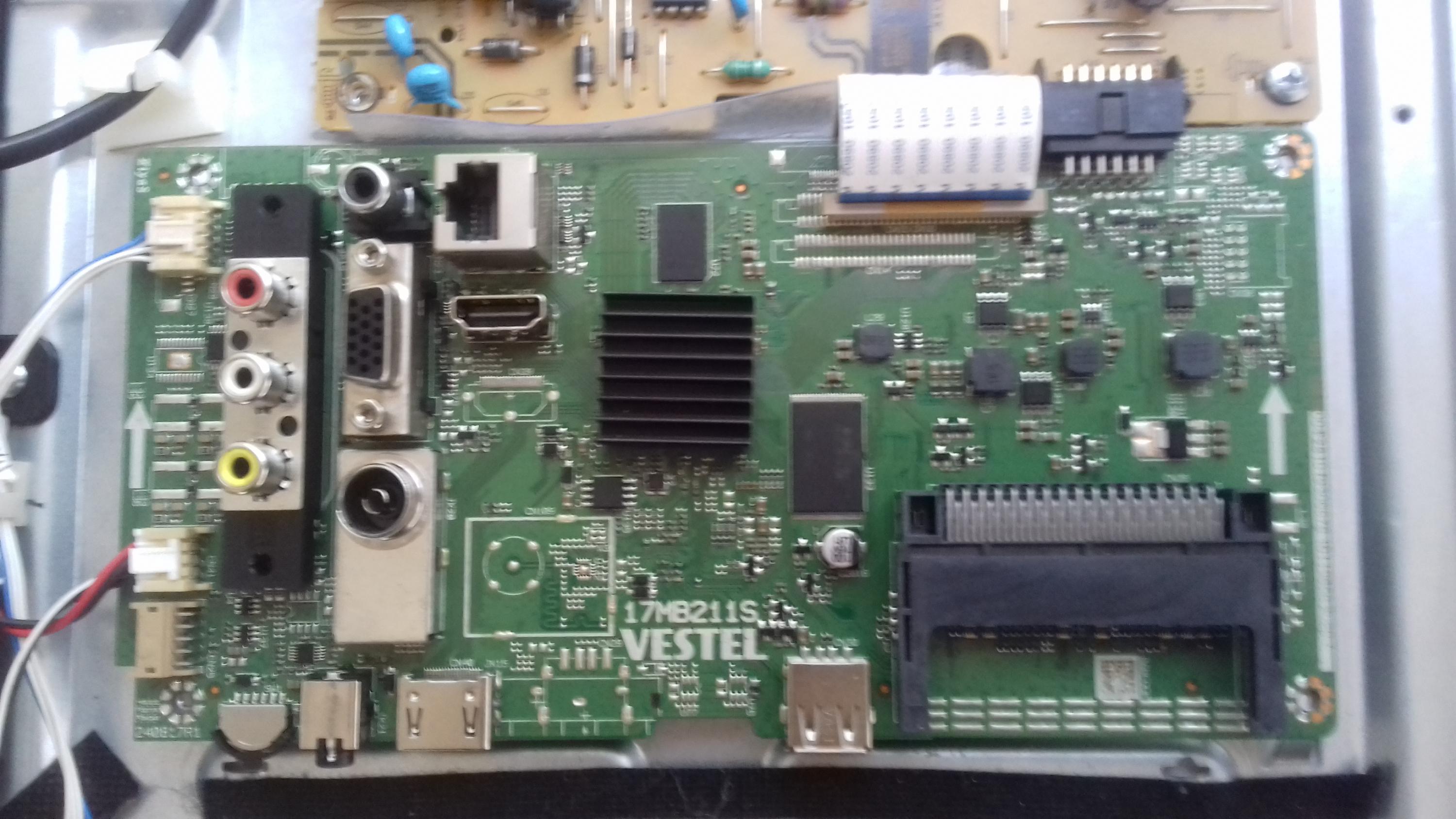

    this one landed here . owner said he plugged in a lightening connector converter to hdmi then the picture and sound went off . i am wondering if its a firmware problem ?
    from what i can figure out the voltages seem to be ok . i can check any again if needed .
    what it does as soon as its plugged in is the standby light flashes then the backlights come on then it flashes some more and goes out . backlights stay on for a minute or so then go off .sometimes it goes through this 2 or 3 times on its own .all the while backlights are off there is a very quiet click sound from the speakers like its tripping . there is no response using the remote or pressing rear toggle switch/button
    here are some pics .

          i found this but cant figure out where to download the 2 files . https://translate.google.co.uk/trans...search&pto=aue
          17MB211 17MB211S Full Software Installation Method:
          the shredder_usb_update.b
          shredder_usb_update.sc is
          Copy the named files into the empty and formatted FAT32 USB stick.
          Plug the USB memory into the TV's USB-1 port and while holding down the “ OK ” button of the remote control, plug the ac cable into the wall socket and hold it until the standby led starts to flash quickly.
          Release the “ OK ” button when the standby led starts to flash quickly . When the standby led lights up, software installation process is completed.
          As a result of this process, do not install " FULL " software with different serial numbers on the TV since the panel information will change !

            i am wondering about the 12v supply as its at 11.3v . would this cause the problem ?

              Just above the comments there are 5 links, Vestel, Toshiba, Telefunken, Hitachi and JVC, they go to google drives, they won't work from the translate page, you have to go from the original.
                Re: digihome ptdr24hds3 backlight only no picture
                yes i already have the core file . as i see it i need the other 2 files
                unless i am being a bit thick here .?

                  well then ..just talked to the owner again and now he tells me the tv worked fine for 2 days after he had used the lightning/hdmi converter then one day wouldn't power on ..and he runs it off a modified sine wave power inverter . but had been fine for months .
                  he had it in his head it must be the hdmi converter that damaged it ..i dont think so myself .
                    righto i might have time to look at this again .if anyone sees this post i would like to know the test points to start with . i find it hard when the schematics are not in one .
