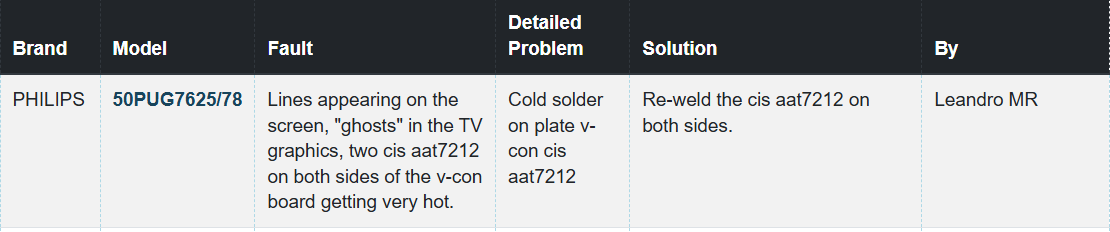

    Update: removed one of the IC's and the T-CON still get's really hot, nothing changes except the fact that the area of the removed IC on the COF PCB doesn't get hot since the chip is not there
    I found this similar report on a website about a Philips tv with identical symptoms. I'm not sure what the issue described is however. There are no cold joints on the IC's and I tried resoldering both and nothing changed.

      I've gone ahead and ordered a couple replacement aat7212 IC's and I'll update everyone when I replace them

        Interesting, i suspect a crack on the screen, VGH shorted to VCOM...
