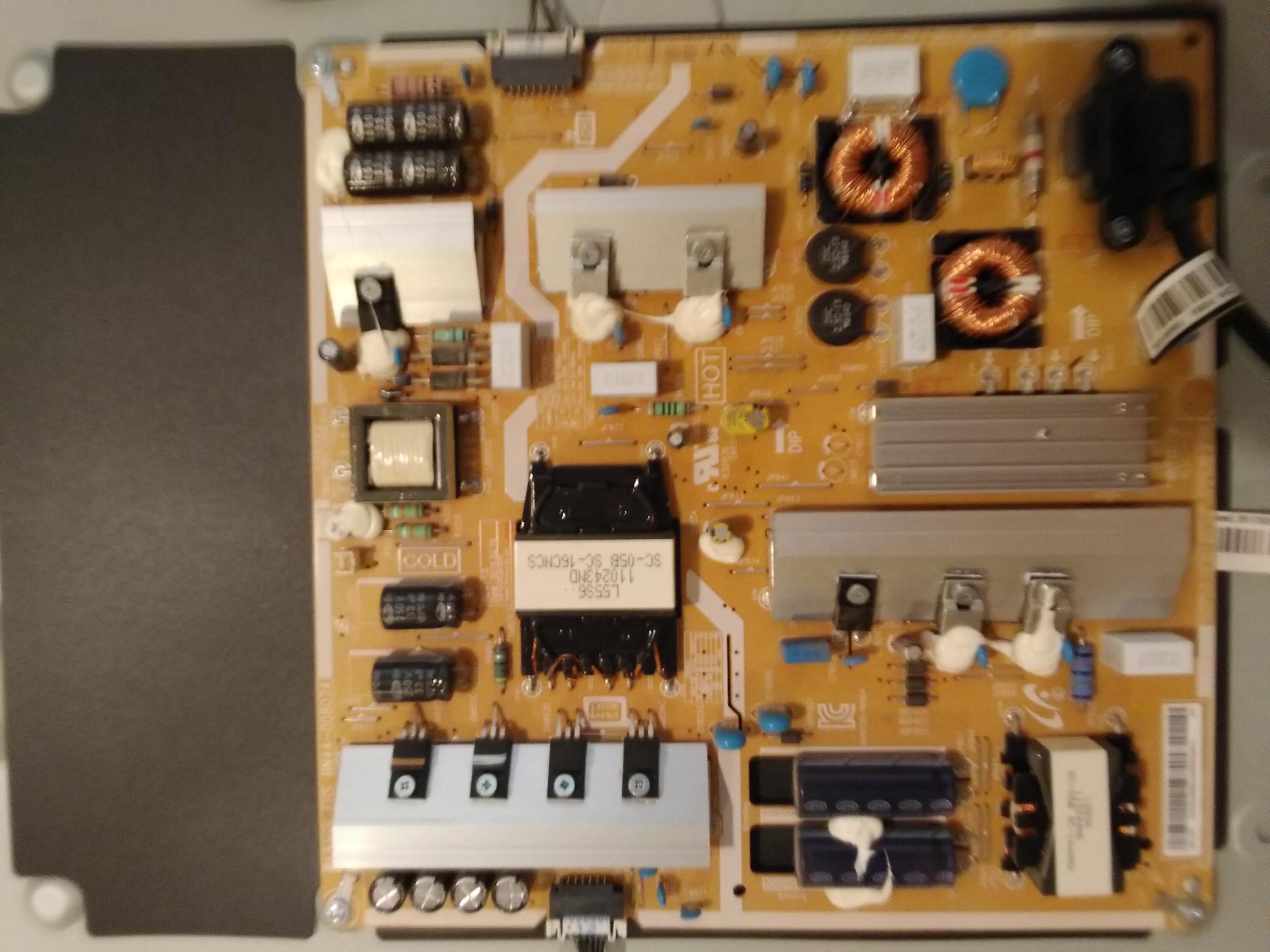

              1- remove the PWB and upload Photo over here of the back side.. same you can look on the table voltage which most time printed downside.

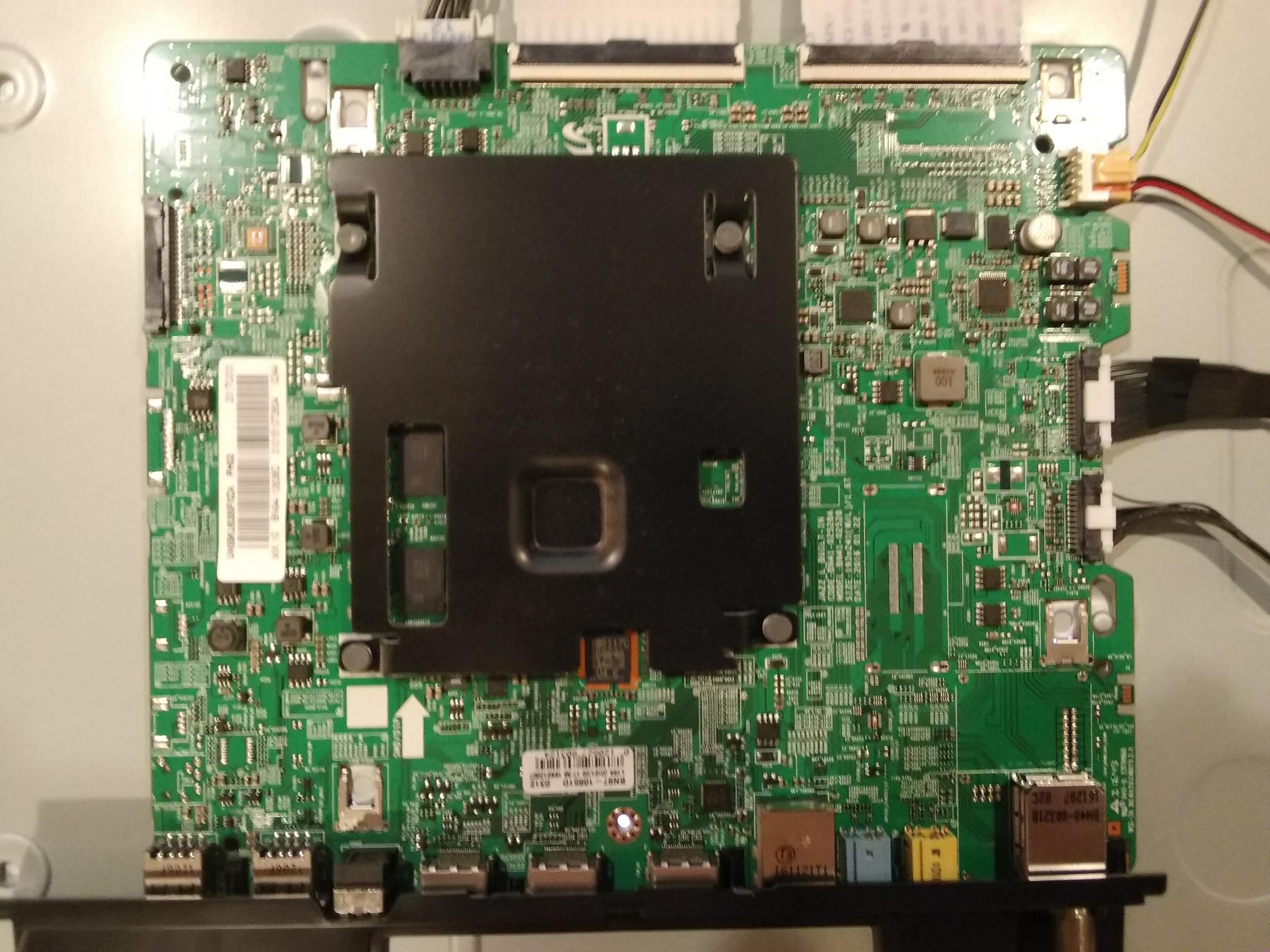

              2- as the BL come on and 12 V reach MB, trace if you have 5.V on any of USB sockt.. also take look on the optical output sockt on MB if its red LED on or off.
                Re: Samsung UN55KU6300FXZA Version CJ05 Black Screen W/BL On
                Please upload better focused pictures of the boards, I can faintly see the pinout chart, if you look at the pictures and you cannot read anything on the board then we cannot read them either so loo at the pictures before uploading them, we do not have the TV in front of us to look at so to do remote troubleshooting we need good clear pictures.
                The connector pinout chart is right by the heatsink with 4 devices mounted on top.
                What is the power supply board P/N? BN44-??????
                The connector pins are setup as ODD and EVEN column, the exposed pins you see on the top side are ODD number pins, the EVEN number pins will have to access them from the wire entrance of the connector or from the bottom side of the board.
                Also inspect connector on both ends of the cable between power supply board and the main board.

                  I did look on the back side of the power board for a pinout, and didn't see one but I found one on the front side almost in the middle of the board so i have a starting point to look at.
