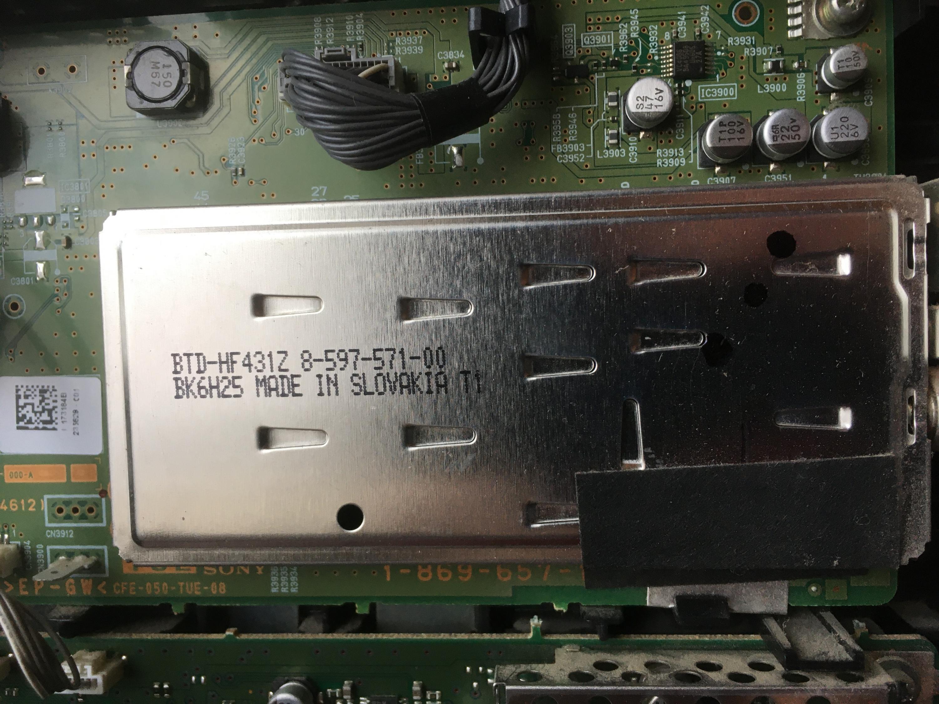

    Hi guys i have just been given a Sony BRAVIA KDL-40S2010 to repair the main issue is when changing freeview channels the tv turns off and then back on its identical issue in this thread
    so far i have tested all power supply voltages etc and they are all fine
    https://community.sony.co.uk/t5/othe...ff/td-p/259942
    Im guessing its a firmware issue as only happens when using digital freeview and the person i got it from said it was fine on analogue tv but after the digital switch over the problem started so i have been looking for the firmware for this set as sony may of issued a fix but cant find any can anyone help
    EDIT!! i have just seen this thread does this sound like the correct firmware? if so anyone have a idea on how too install it
    https://quuq.org/forum/index.php?top...28877#msg28877

    ist the Digital signal T or C ? i wounder this old set tuner will support the new Digital Mpeg rate !!

      when the set works the digital channels work fine i will upload a picture of the tuner and printing on it

        Re: Sony BRAVIA KDL-40S2010 40 in. LCD Television
        Digital now some kind of Mpeg4.. the old one was MPEG2.
        i saw with hisense TV when the format the tv cant handle it will turn the set in boot loop.

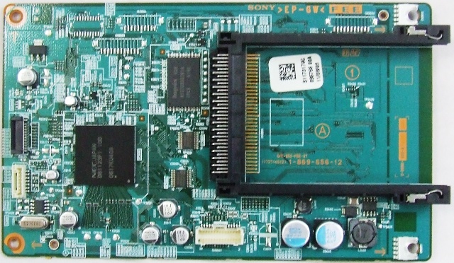

                      The issue you will find will be with the FEE board. I found that using the epg would trigger the issue very quickly with these range of Sony TV's. The firmware that this software is for the FEE board, not the main board.
                      It can also cause the TV not to power up at all and give you a flash code error (I think 9 standby flash code).
                      The firmware doesn't always upgrade as I have had a few issues with these in the past.
                      All the information you will find here including the files to resolve:
                      https://quuq.org/forum/index.php?topic=8523.0
                          The FEE board is the board that is physically above the analogue aerial board which contains the memory card reader access port which is behind the CAM slot on these Sony TV's. The access of the sony memory stick (very old memory sticks (don't use a duo one as it will not work!)) is behind a plastic cover on the outside of the TV, adjacent to the CAM slot entrance.
                          See picture of the pcb board.
                          These boards I have used from different size models of TV's from this range and have so far worked correctly when replacing them if the software didn't resolve the issue.
                              Hi thank you for the information and the link i actually did order these boards from ebay
                              https://www.ebay.co.uk/itm/MAIN-BOAR...72.m2749.l2649
                              the the set now works fine the ebay advert said mainboard but i was not it was the board i needed so i just swapped them both out and the set now works fine and has already been returned to the customer but if i ever have another set with the same fault i may try the firmware so thanks again.
                              The only other issue i noticed on the set myself was hdmi picture size overscan issue (too large) but no option to alter this in any menu settings the customer said it did not bother them so i left it alone.

                                So it was the FEE board that was the issue?
                                • vinceroger69
                                  • Mar 2012
                                  • 6714
                                  • uk
                                  yes the board with the card slot on.
