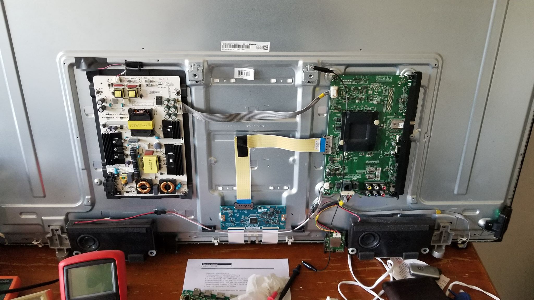

    Hi guys
    I just got this TV which is completely dead, not a single sign of life!
    I have not a single voltage on the output of the PSU!
    I checked the fuse which it was ok, I have 385V on the main Capacitor, beyond that I have nothing. The Mosfets and diodes were checked and tested ok (I might have missed something out). I'm still troubleshooting, but I'm open to your suggestions!
    I didn't find any service manual or the schematic for the power supply yet, I just attached some pictures of the TV.
    Thanks in advance

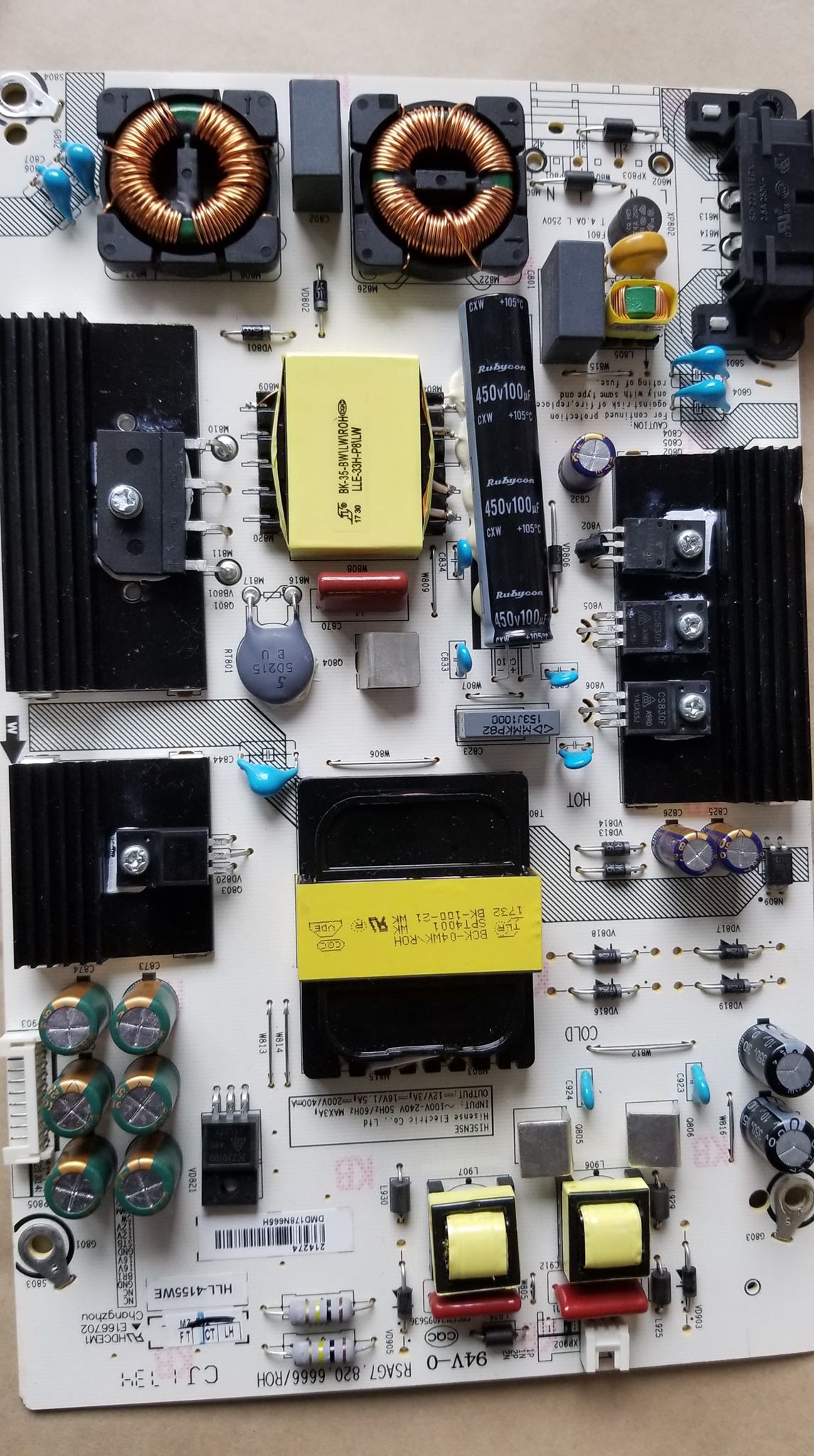

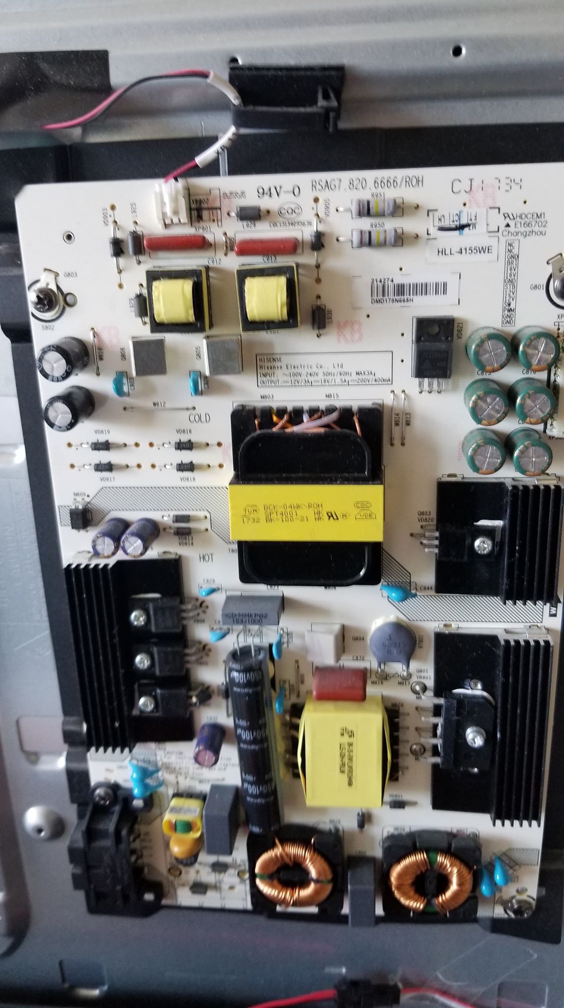

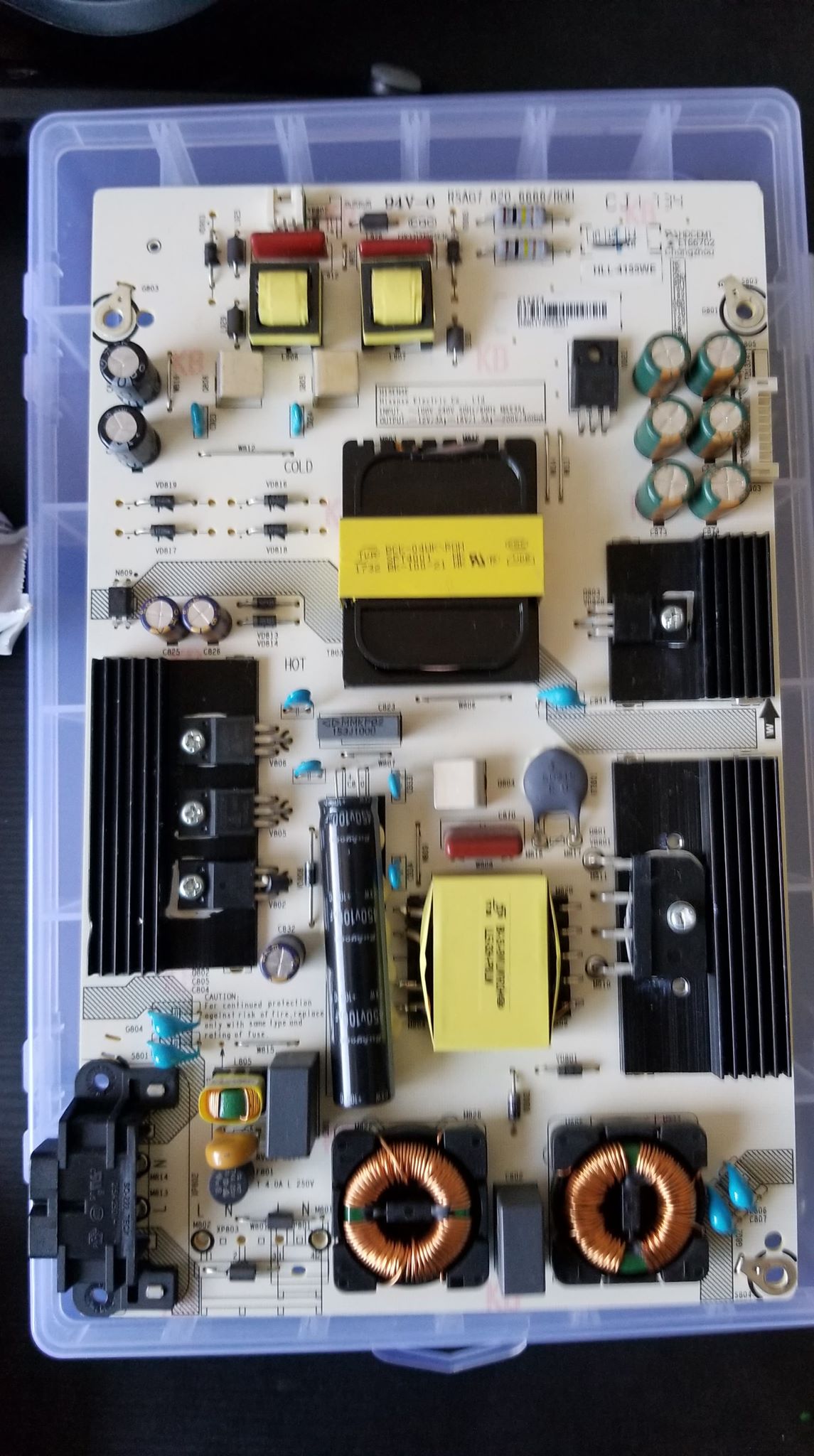

                              Re: Sharp LC-50P66U-completely dead PSU!!
                              I received the power supply board today, but I have the same problem! No output voltage or whatsoever, even with the backlight and main board connectors disconnected!
                              I have 388V across the main capacitor! And I have 245V on v905 anode (backlight)
                              I don't think that the new PSU is faulty either, according to the seller it was pulled from a broken screen TV!
                              To be honest, I never came across a problem when I don't have any output voltage!really weird problem!!

                                1) So the PFC is owrking and also the boost converter for the backlights is working.
                                2) What do you get on the Cathode return of the LED string? You do have the LED connector in place when you measure the Anode Voltage, correct?
                                3) I cannot see how you still do not have 12V and 16V at the connector since the 200V for the backlight power supply is generated from same circuit and transformer that generates t he 12V and 16V, see the schematic. Are you 100% sure that you probe at the correct pins of the connector?
                                4)What Voltage do you have on C878/879, C873/874, C875/876 when you turn on the power switch.

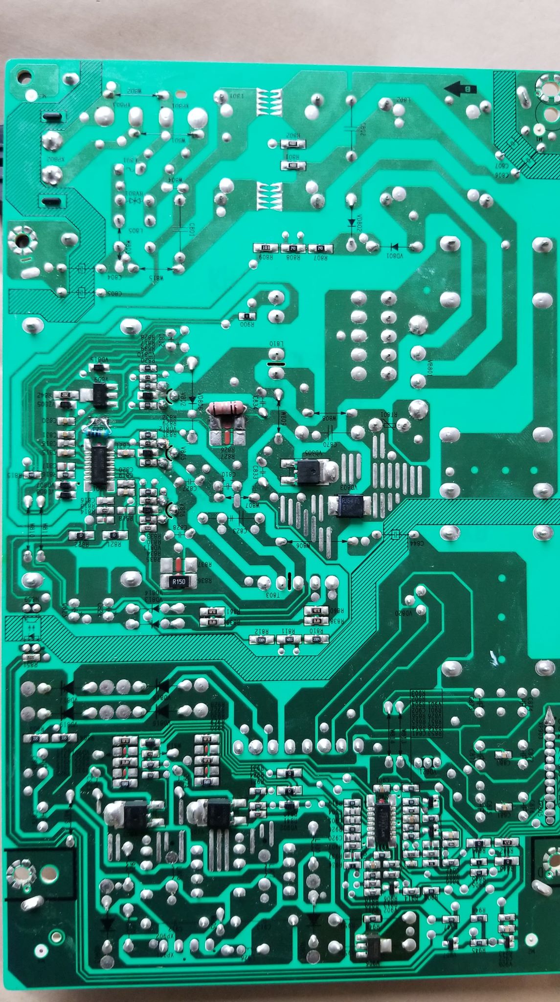

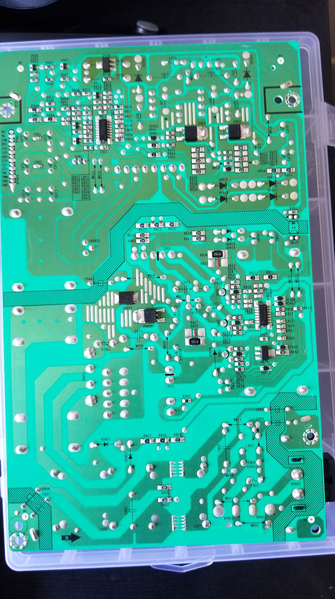

                                  https://www.badcaps.net/forum/attach...9&d=1595096371
                                  Can you provide good clear hi res straight shots of the whole top and bottom side of the power supply board? As you can see, your picture is not in focused for me to be able to read anything on the board.
                                  • kgavionics
                                    • Apr 2017
                                    • 152
                                    i have attached the top and bottom pictures of the old board.
                                      That is better.
                                        1-Yeah, the booster circuit is working fine
                                        2-I have a fluctuating voltage between (112 to 123V) on the anode and (223 to 240V) on the cathode of V905.sorry I made a mistake earlier by saying I had 245 on the anode. I tested the diode and it's good, but how come I have a 100V drop across v905?
                                        3-i'm 100% sure that I have 0v on that connector.
                                        4-how can I take the measurement from the bottom side of the board? Do know a safe way to do it?
