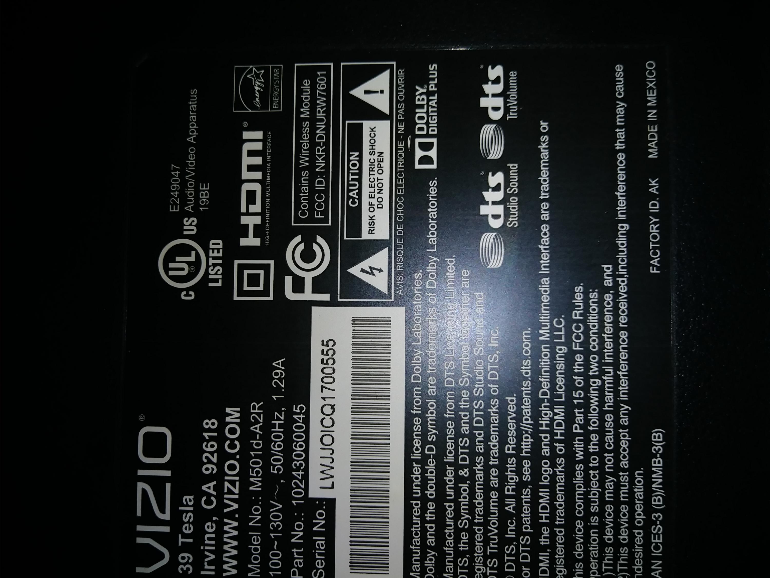

    Vizio M501D-A2R
    Having a convergence type issue.... when the screen jumps (tried to upload video, but issue has arisen.) there is blue and red image copies that outline the original image detail. Anyone seen anything like this? this is similar to what im experiencing on this set except its the entire screen, not any one section:
    https://www.youtube.com/watch?v=OpMo6JzBYKs
