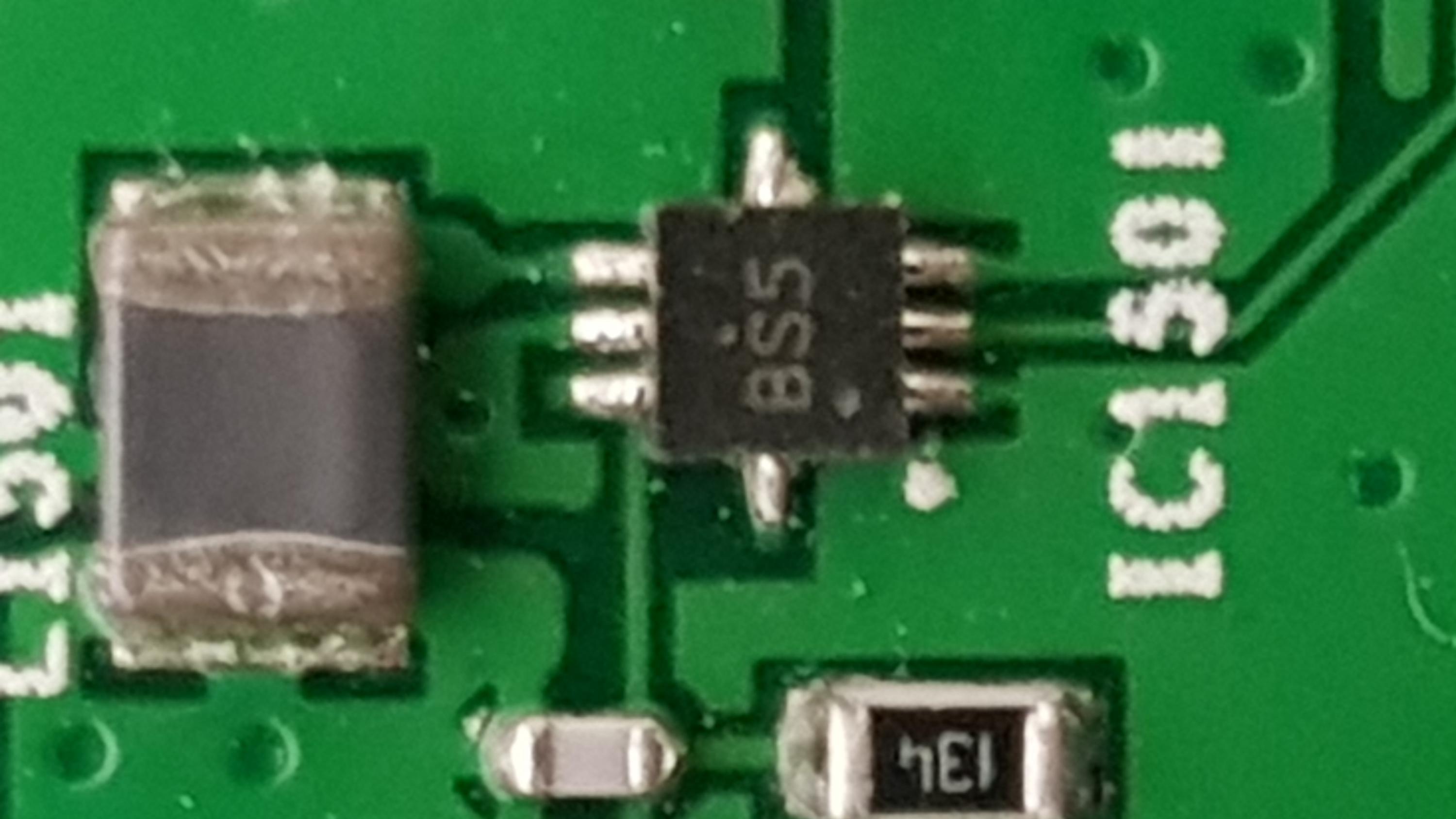

      Thanks for your question, no I do not have 5 volts. There is a surface mount device see attachment, this is where the 5 volt comes from. It is marked BS5, but cannot find this online, this was the reason for a schematic diagram.
      Any ideas what this chip is?

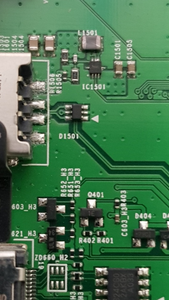

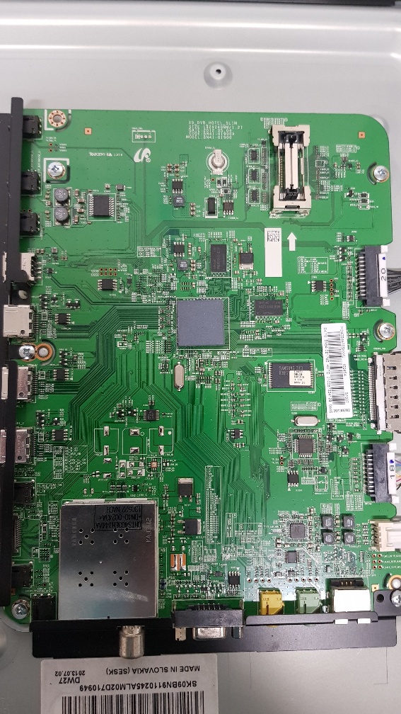

        Please provide straight shot pictures that show more area of the board around the USB port and the whole top side of the board

          Re: USB not working
          Hi budm
          have attached photos

            1) What DC V do you get on both ends of C1501, 1505 with ref to GND?
            2) What DC V do you get on both ends of L1501 with ref to GND?
            3) What DC V do you get on both pin 2 of IC1501 with ref to GND?

              Re: USB not working
              Hi budm
              1) -1.5 volts and dropping C1501 and C1505 joined together at top.
              C1501 bottom 5.2 volts
              C1505 bottom 0.0 volts
              2)L1501 0.005 volts both sides.
              3) IC1501 pin 2 to ground Middle pin bottom to ground 3.3 volts
              Adrian
                Re: USB not working
                Originally posted by ageman
                Hi budm
                Adrian
                OK, so it looks like pin 4 of IC1501 is the 5V input. Pin 5 of the IC1501 looks to be the output pin which then goes to the USB VCC pin via L1501. Pin 2 of the IC1501 looks to be the control pin to turn on IC1501, so far I cannot find any info on this IC1501. I look at some Samsung main board schematic to see if some of them may use the same IC then we can figure out the circuit. That Pin 2 may be Active LO, <1V = ON.

                        OK, I found the info after lots of searching:
                        https://monitor.net.ru/forum/threads/558779/
                        IC1501 is RT8016L 1.5MHz, 600mA, High Efficiency PWM Step-Down DC/DC
                        Converter
                        https://cdn.badcaps-static.com/pdfs/...f042df7b46.pdf
