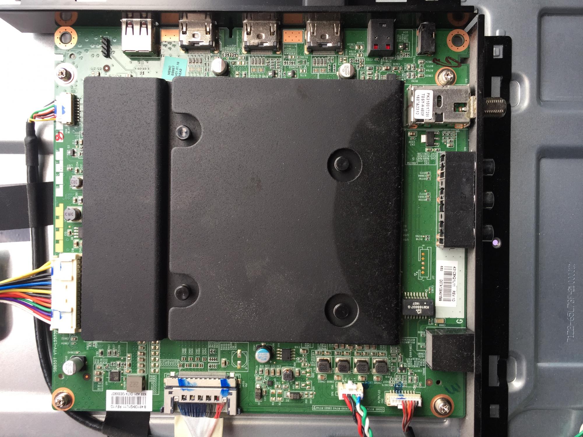

    Hello everyone.
    I don't know how to start because I am new.
    My Toshiba 65 inc 65L621U is turning off randomly, but the sound continues and then it is hard to turn on.
    Sometimes just blink the logo and the red light is blinking.

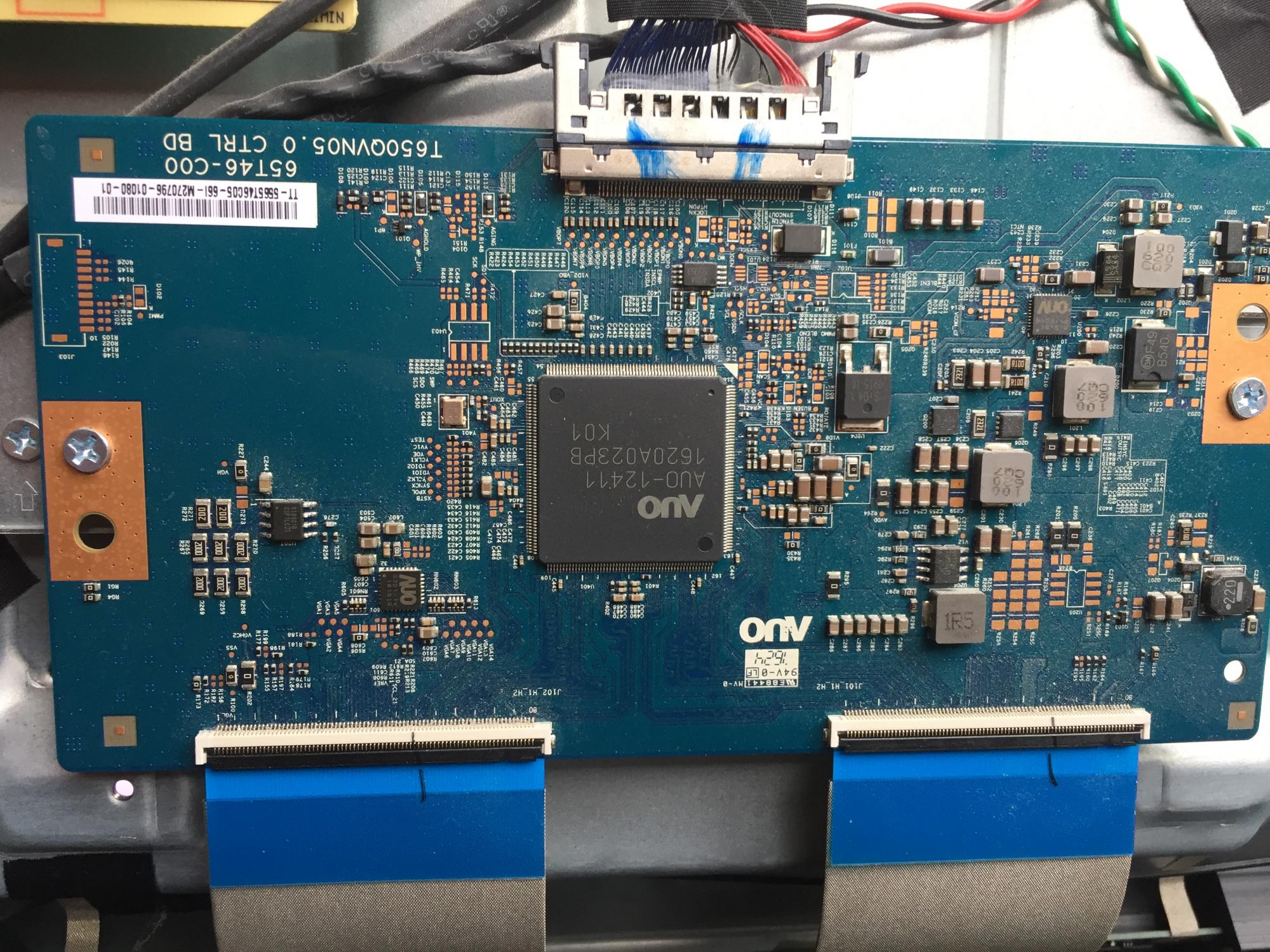

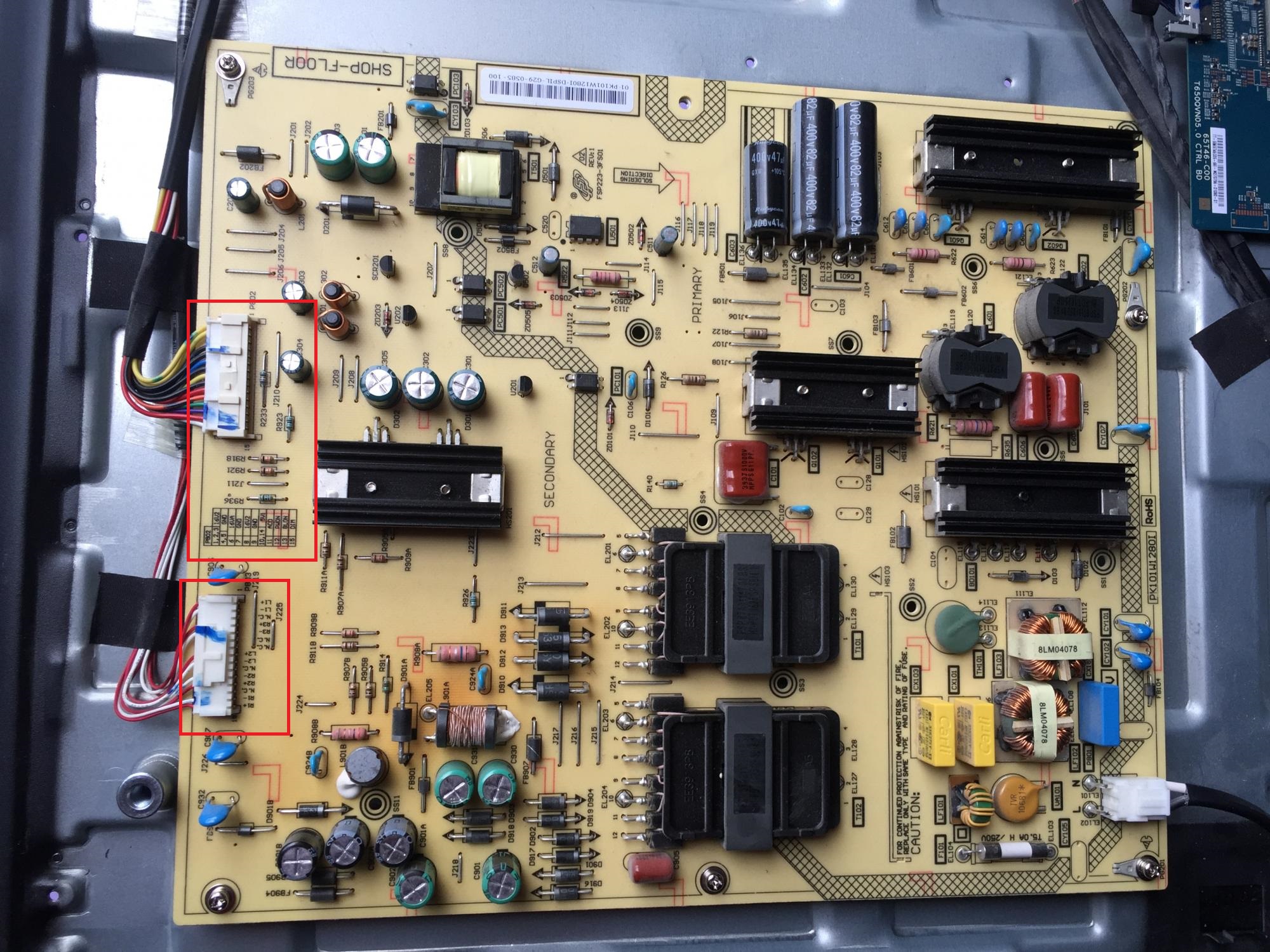

    I switch the T board 55.65T46.C05 Toshiba T-Con Board and the PK101W1280I Toshiba Power Supply, FSP223-3FS01.
    I don't find a reasonable priced the 461C8K21L11 Toshiba Main Board.
    I am lost and I don't know what to do.

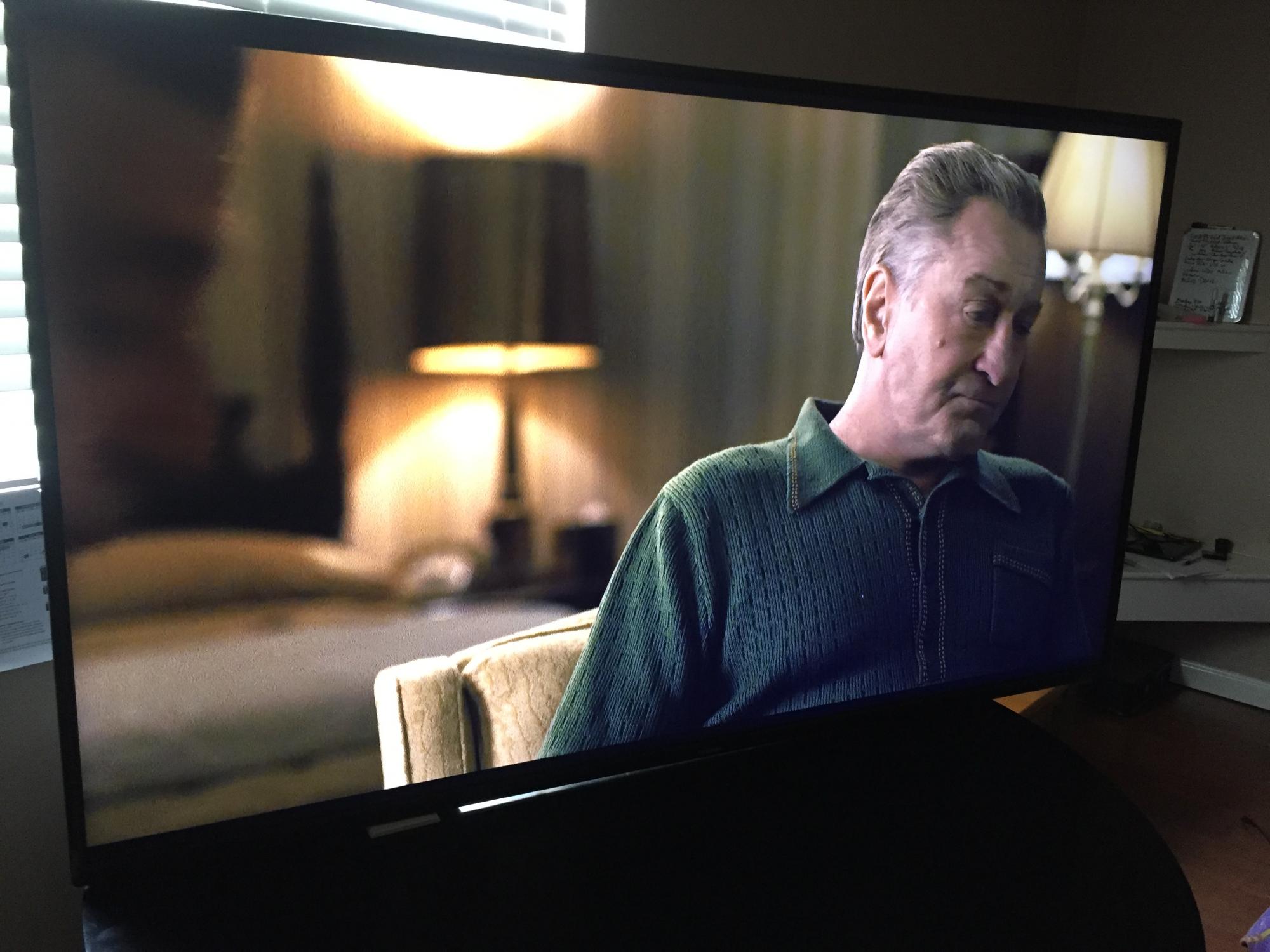

    As you can see in image 1 . When it works the image is good.
    Any help welcome.

    Sounds like failing LED backlights. Turn down the backlight level and see if it improves. Also turn off Dynalight or any feature that automatically adjusts the backlight level like an ambient light sensor.

      Thanks neilc6 . I will try tomorrow, but I believed it had to be with the main board for the hard time turning on.

        If it is hard to turn on then possibly mainboard if your voltages are stable. You may have multiple issues. Trying to stay away from Toshibas.

          If you turn the backlights down will it stay on longer?
          It could be a led(s) problem which when heated up in use is failing especially since you say the sound continues.
          Other than that you would need to take voltage readings to see what control signals are failing

              So DID it stay on longer if backlights are turned down??

                Hey amansilla... I bought your TV..
                Yes, your backlight was out.. but there was panel damage at some point.. shadowing and slow refresh on the right hand side.. Parted out. Oh yeah, there was a section of bad pixels on the panel.
