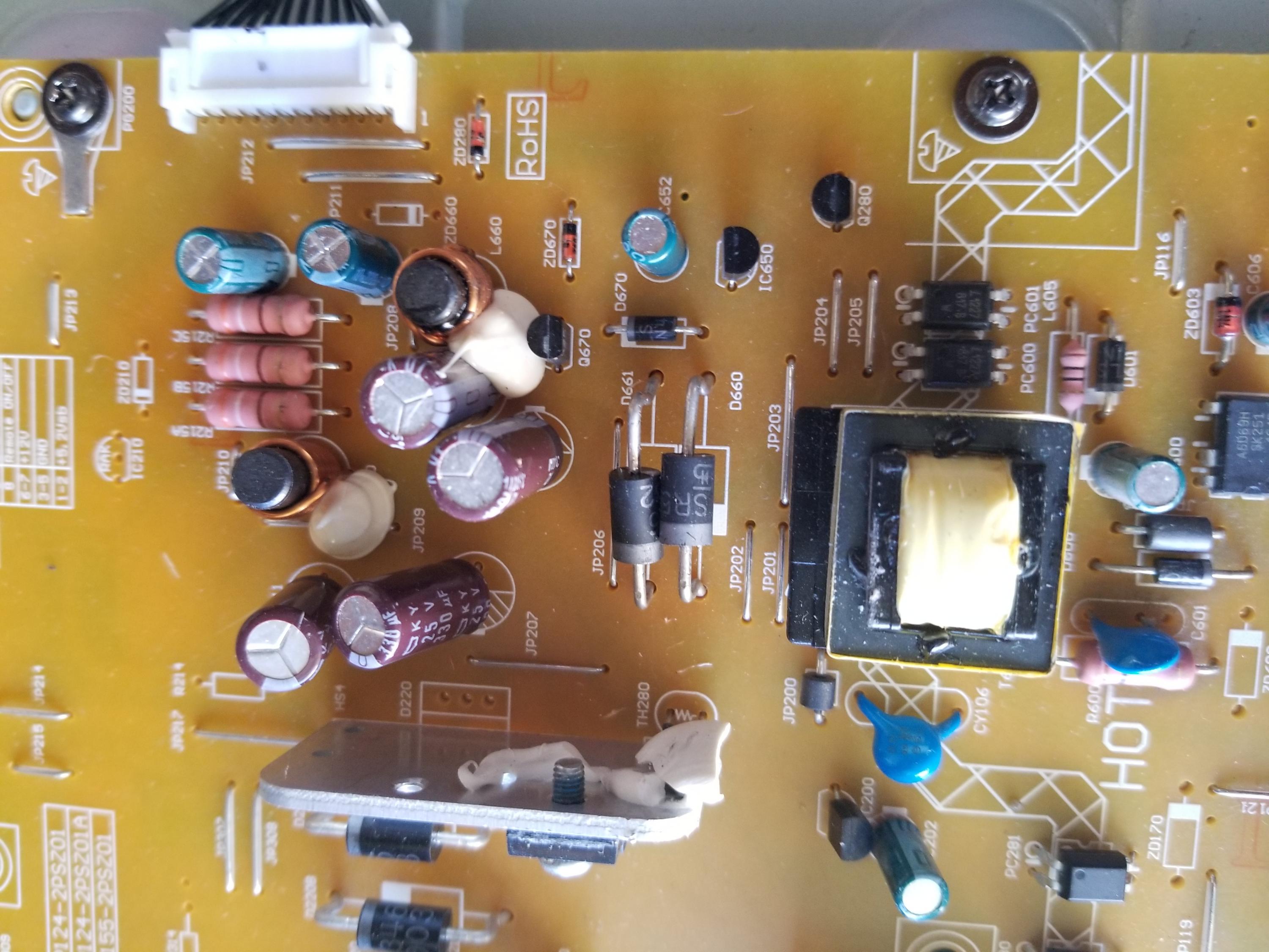

Vizio E500i-AO dead, no sound or video

    Found there is no 12v on pins 6 & 7 of CN201.

        Sorry for the Finally did all readings with one of my Flukes and here they are:
        CN201-
        1 & 2 = 5.2v
        6 &7 = 0v
        8 =0
        9 = 0
        10 =0
        11 =~ .01~.03V
        using hot gnd:
        C120 = 169vdc off - 305vdc on
        jp113 = .12 off - 14.5v on
        jp116 = 16.7v off - 21v on
        ON = led lit - OFF = led off
        Sorry for the delays but things happen.
