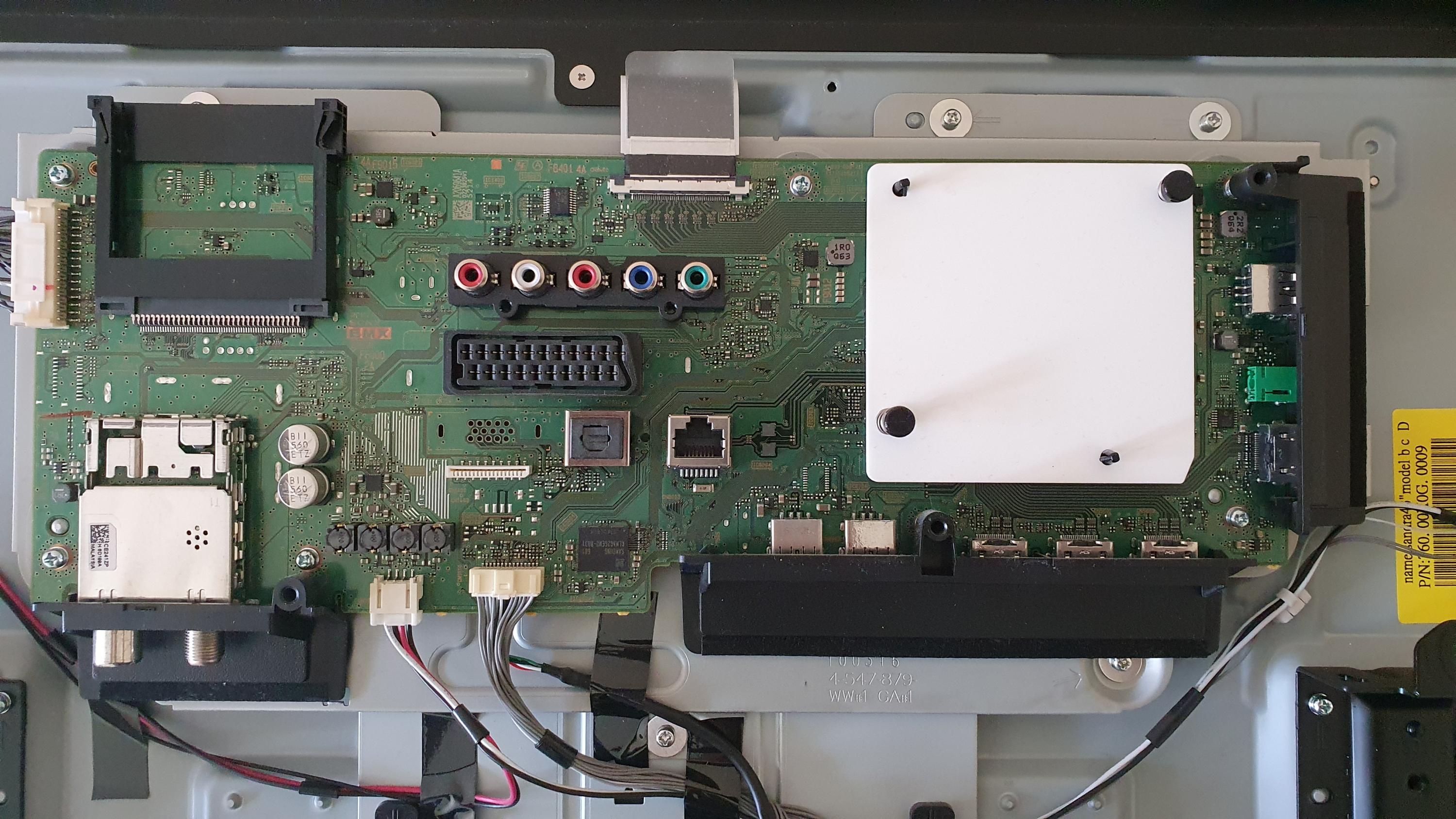

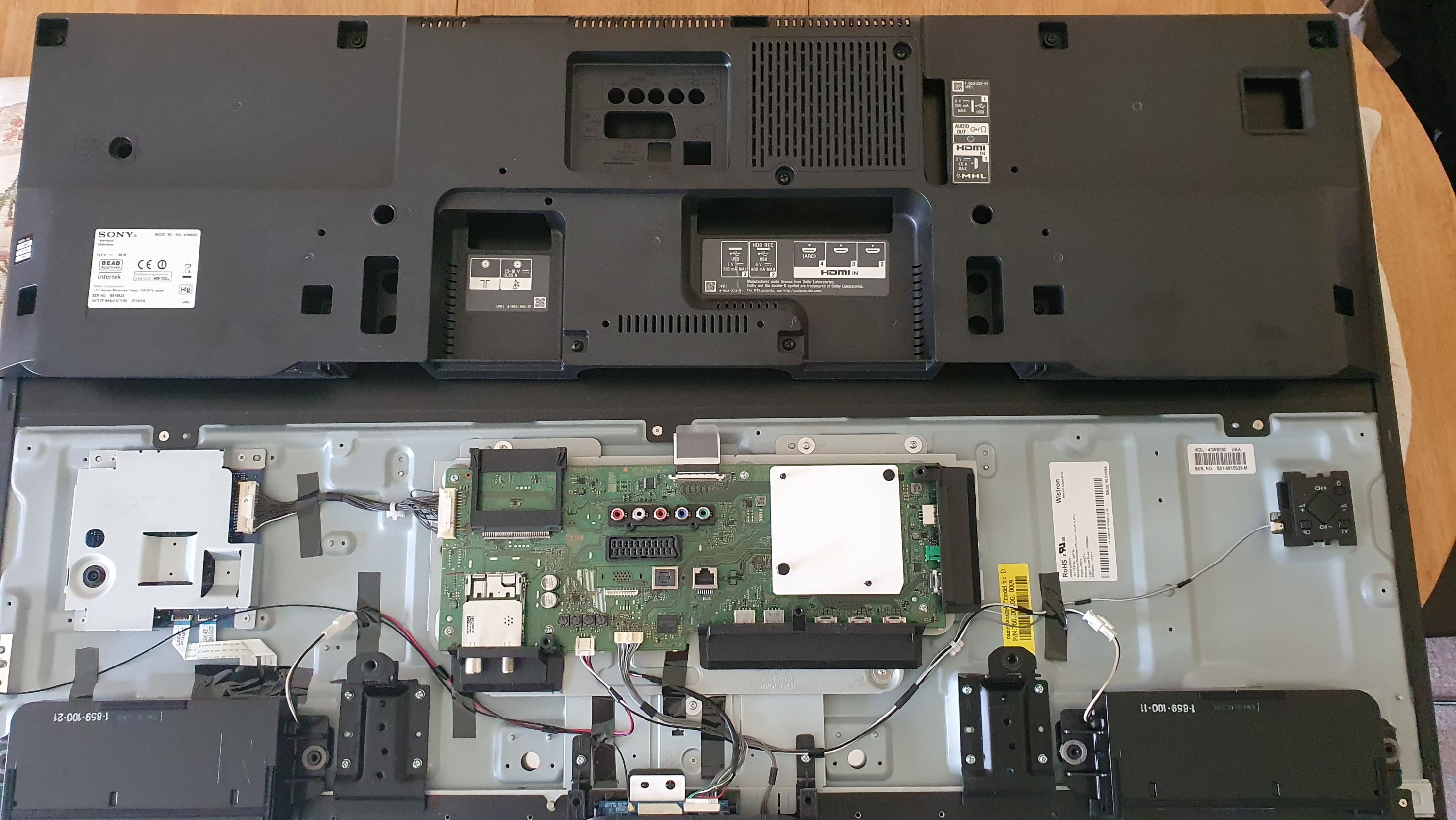

      Please attach good clear pictures of the whole back side of the TV showing all the boards.
      Do you know if this LCD panel has integrated T-CON board as part of the LCD panel?

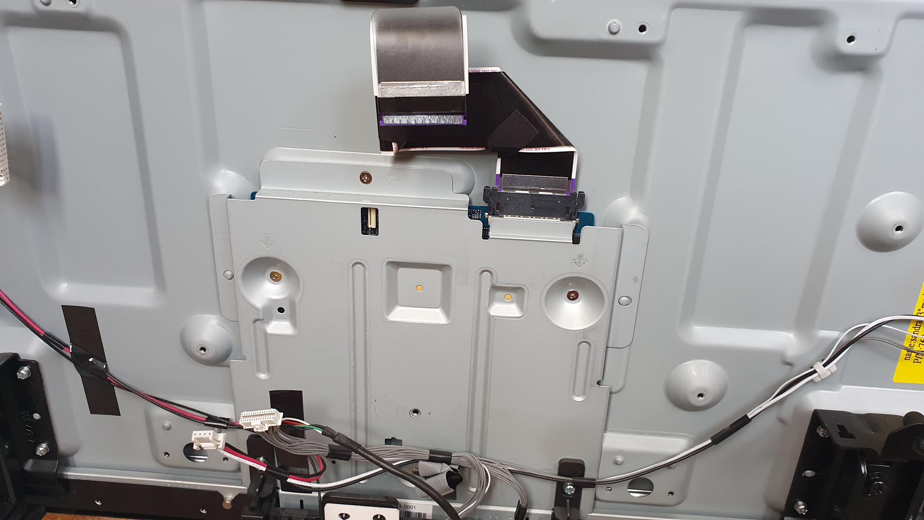

        Re: KDL-43W805C - backlight and sound work but no picture
        I have not open it yet. But i will upload photos as soon as i start work on it. Just wanted to have more ideas and to hear more suggestion before to start.

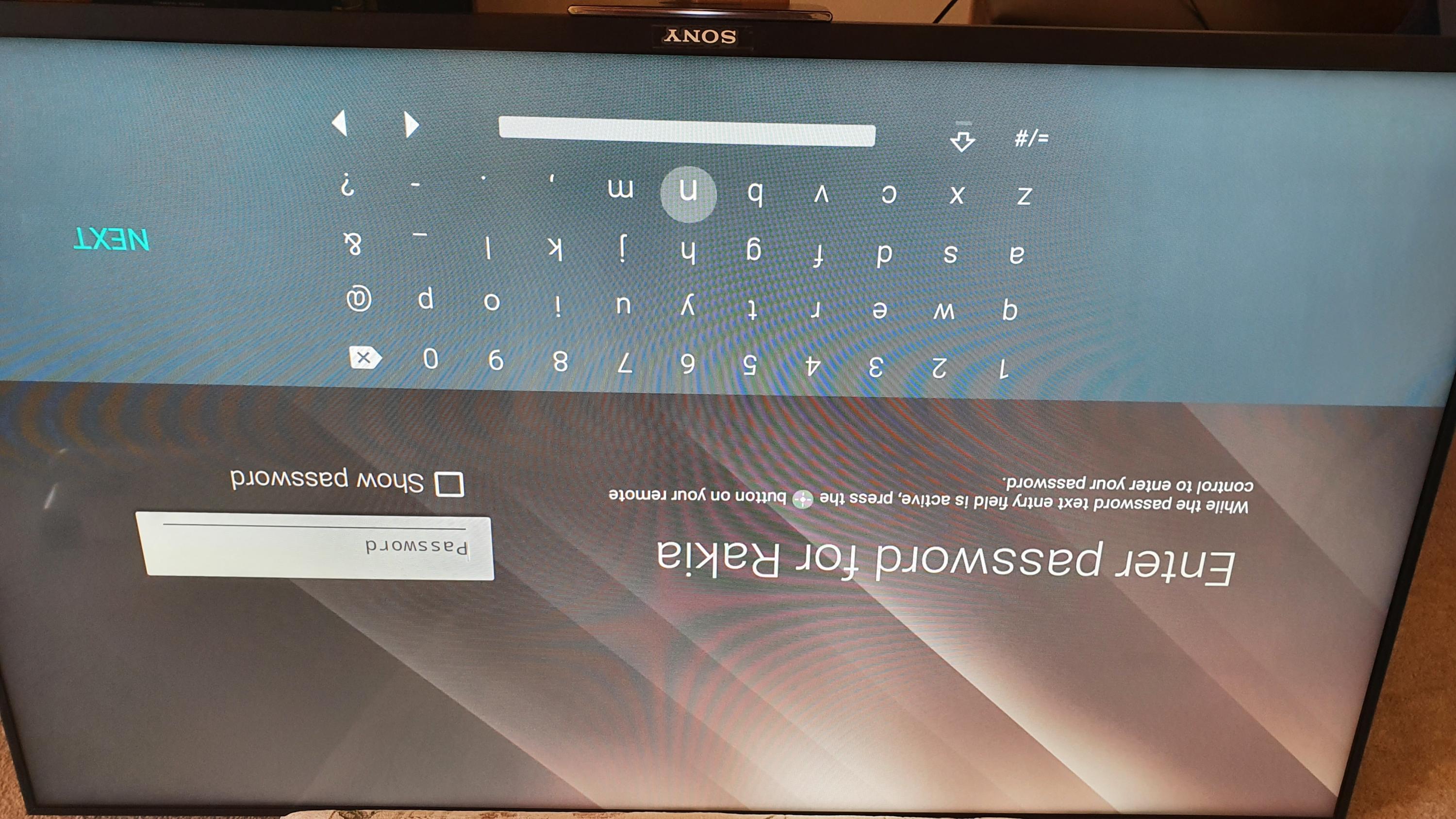

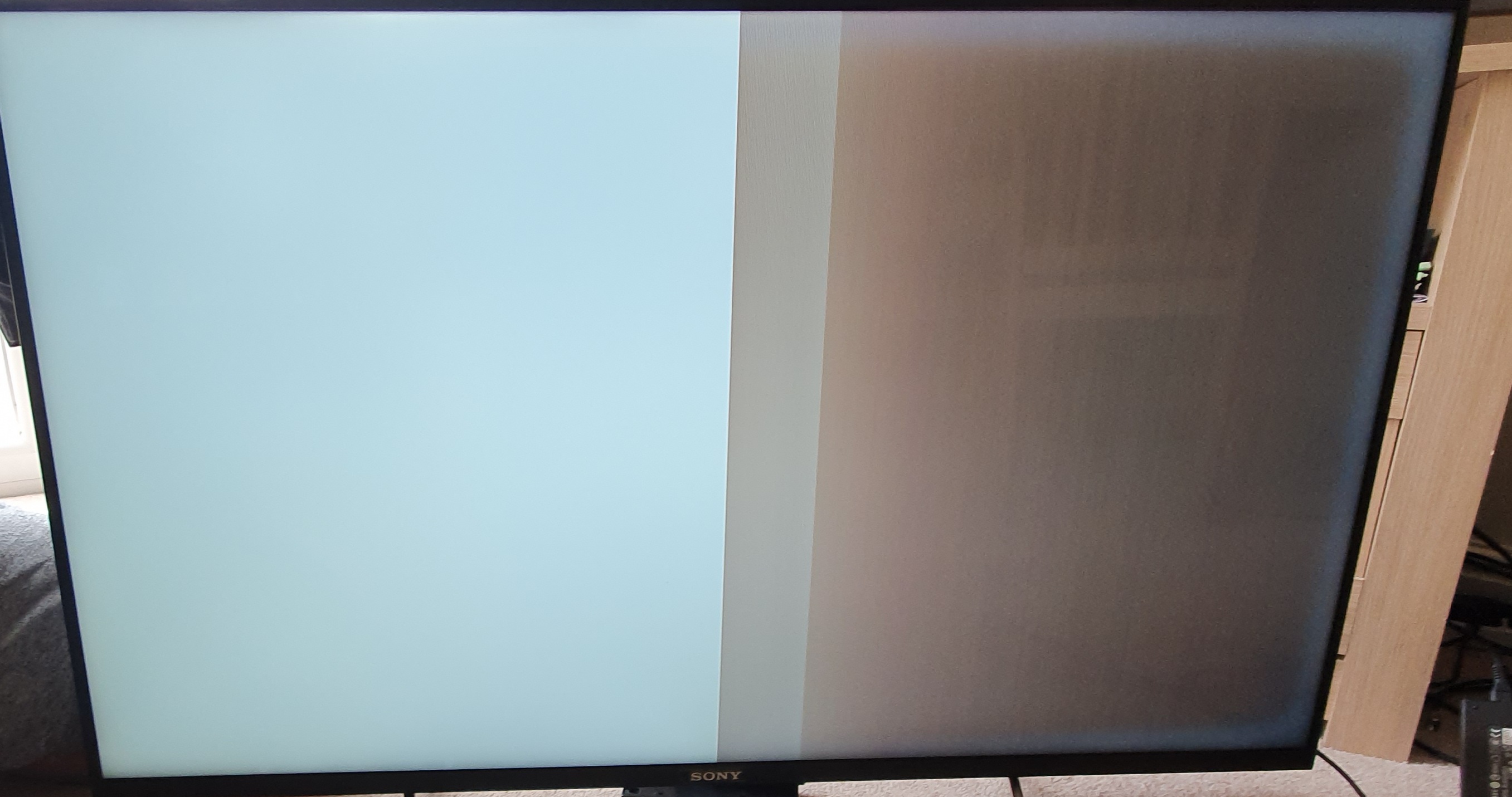

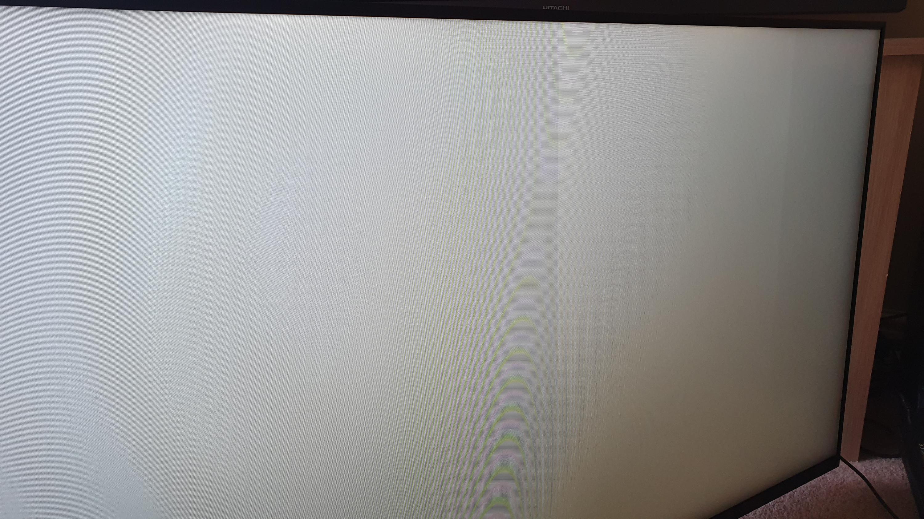

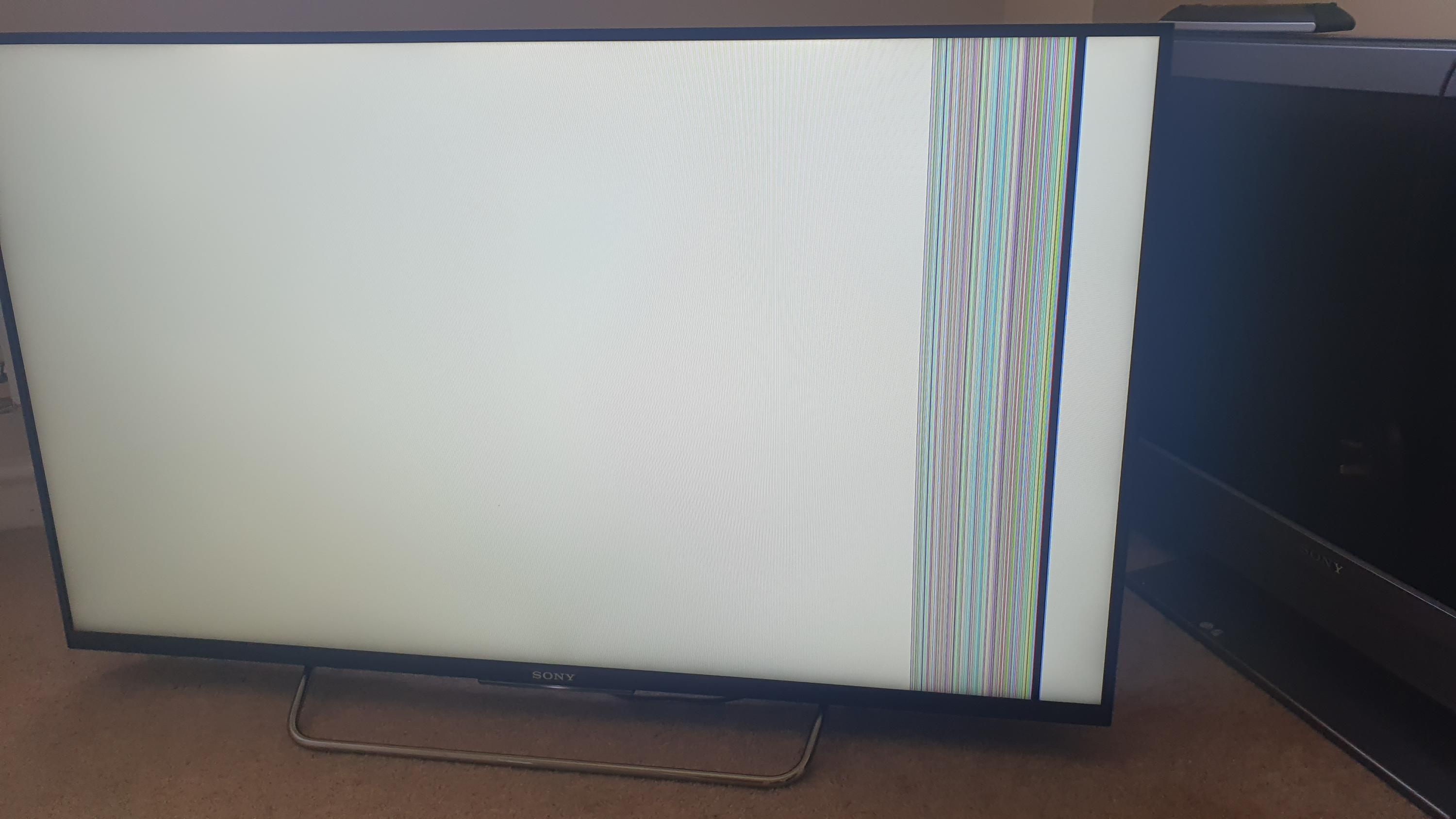

          Ok guys. I found time today for this tv and i've got some success but just a little These are the boards:
          So i tried to remove some of the ribbon cables and then i saw full SONY logo then Android starting but in few seconds screen disappeared and i saw 6 blinking codes which should be normal because of the disconnected cable. It was the same with the other ribbon disconnected. Then i connected both of the ribbon cables and the tv was working normal for a while:
          I did the first settings and then checked for updates but it said that it is up to date. Then the screen went white again:
          And now i have it working sometimes and then it is going to white or other colors screen.
          I am waiting for some advises. Thank you
          P.S. I checked the firmware version and it is 4.33. The last one on the sony's webs site is 4.35. It could not find it automatically and now i am trying to update it via USB drive but it is pain - waiting to come on for a while
            you might still trying a usb update as opposed to letting the "system browser" look for an update on line. The "usb process" may bypass "you are already updated" checks and just check to see that the file type is correct along with any basic checks (ie. checksum, etc).... in essence being at a "boot load" level as opposed to full operating mode.
            Some of the earlier display pictures don't give a good feeling about the panel or connections to.... this may be stopping the system from fully operating.

              May be a dirty connection, make sure the connections are clean, try unplug and re-plug on your connections, can clean the ribbon connectors with a pencil eraser or a q-tip and some isopropyl alcohol, not to hard they can be delicate.

                I can't tell if you have a stand alone tcon there but a whitewash display can mean a bad tcon board.

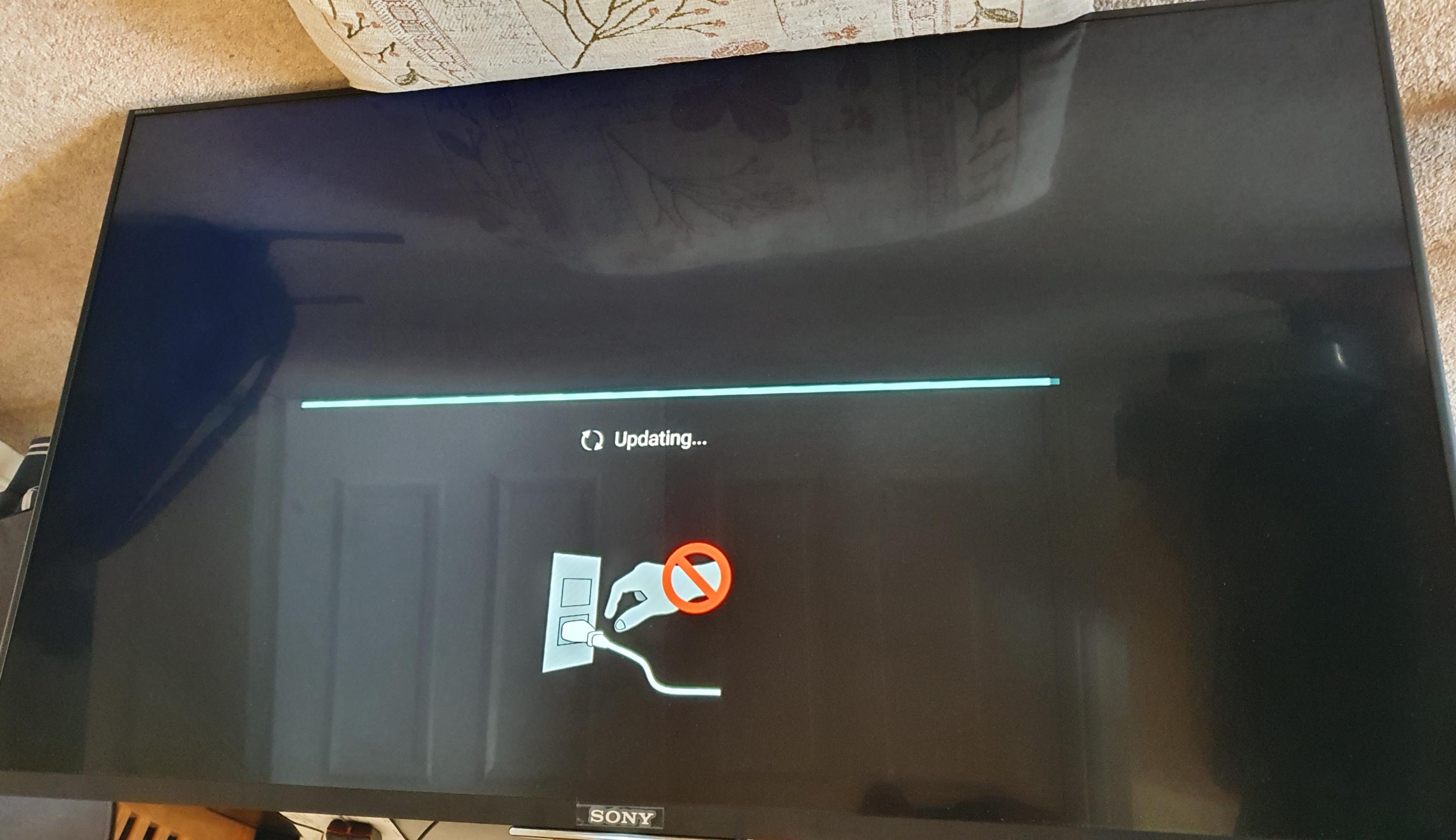

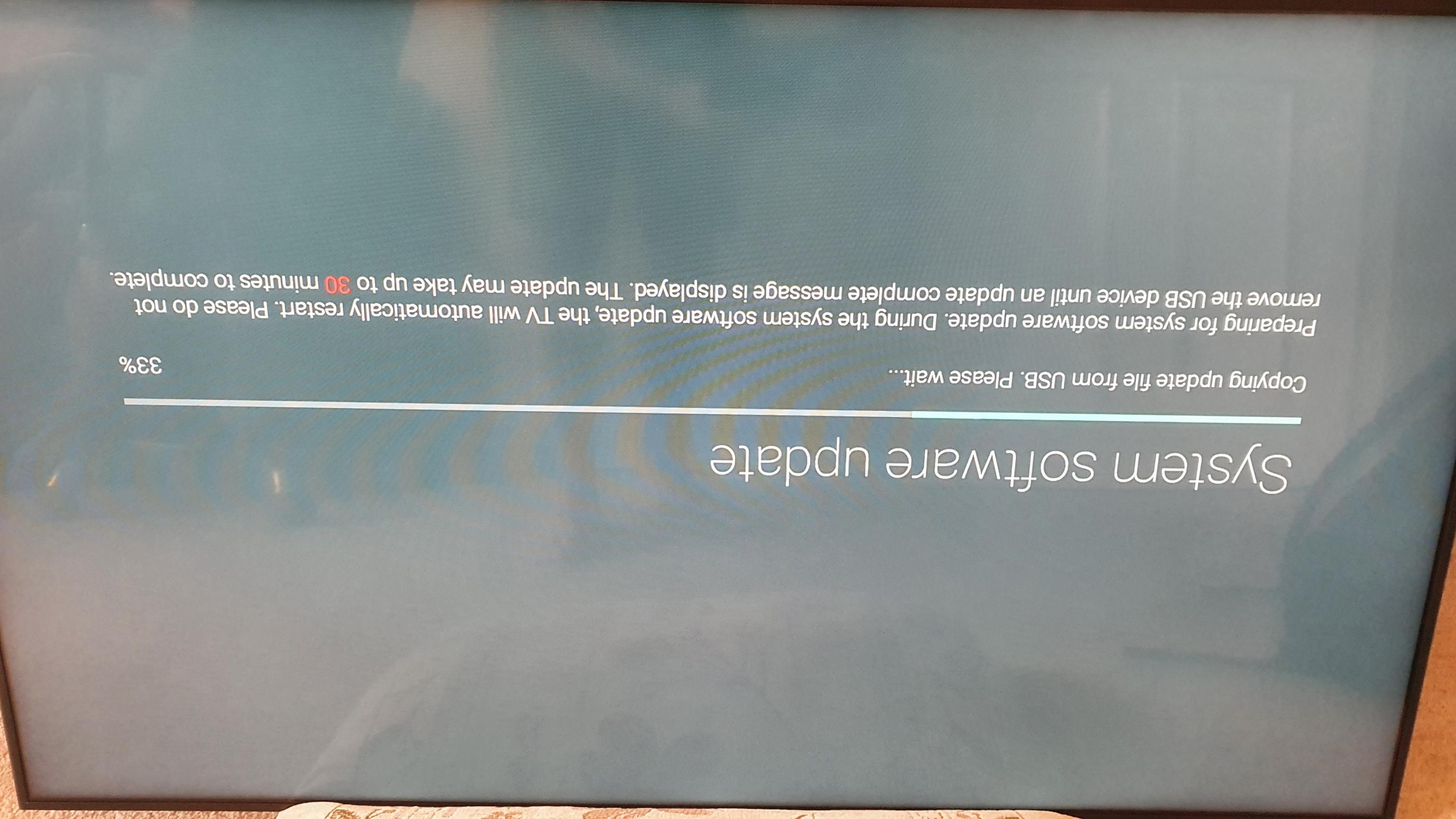

                  Ok. I updated it succesfully via USB:
                  And i was able to monitor whole of the updating process about 15mins and the picture did not go off. Then it restarted few times and when i switched it on again i saw some color lines again and then the picture came on. I am watching it now only in TV mode only to check if the picture will go off again.

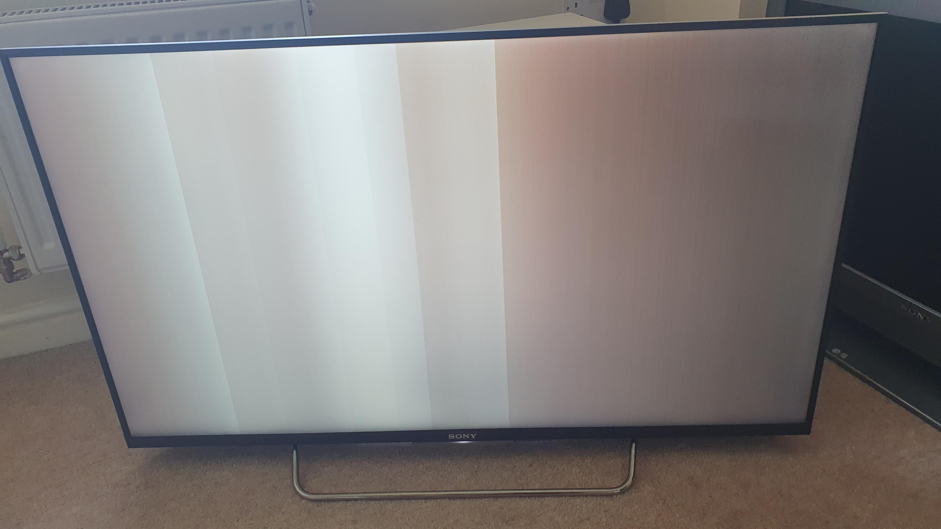

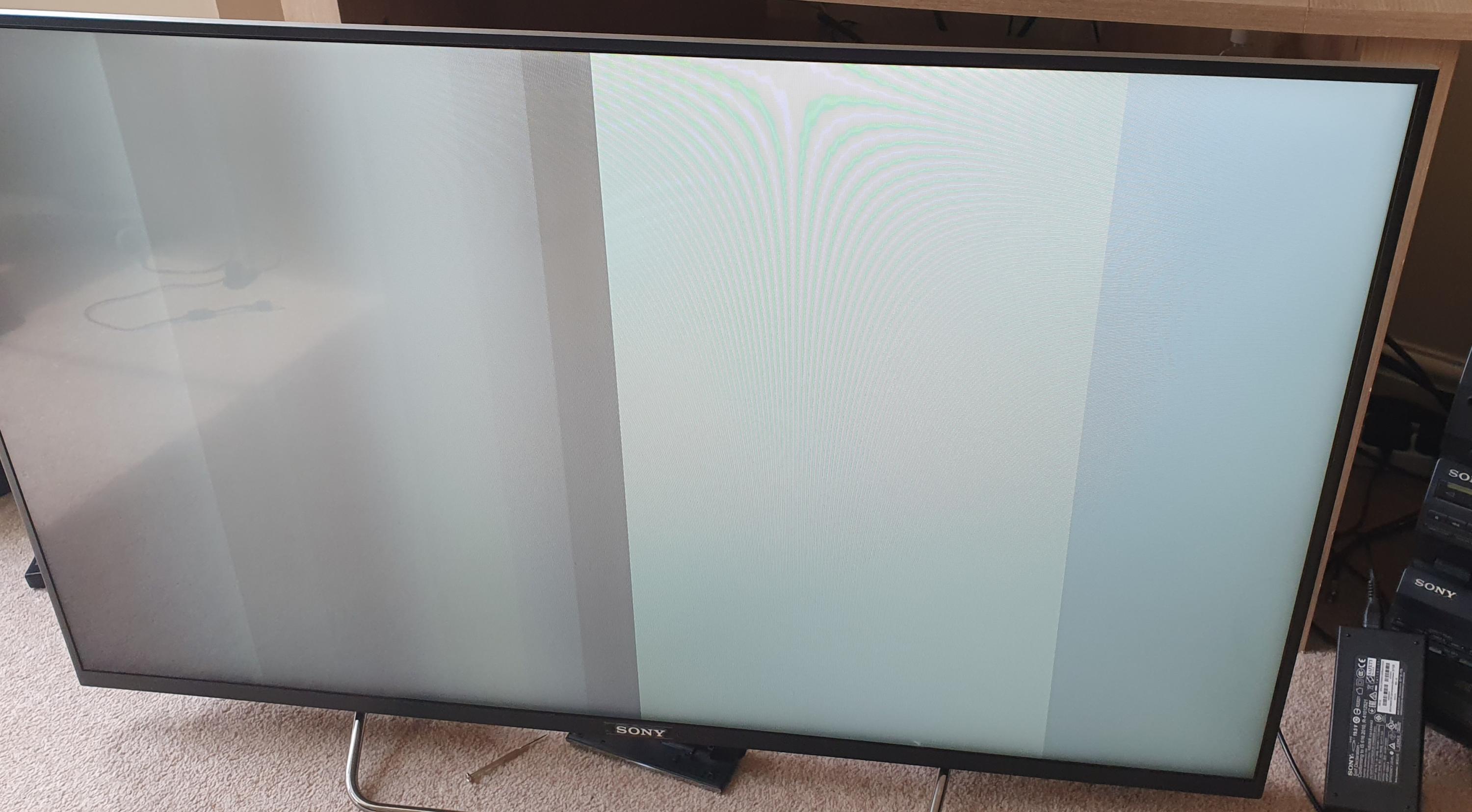

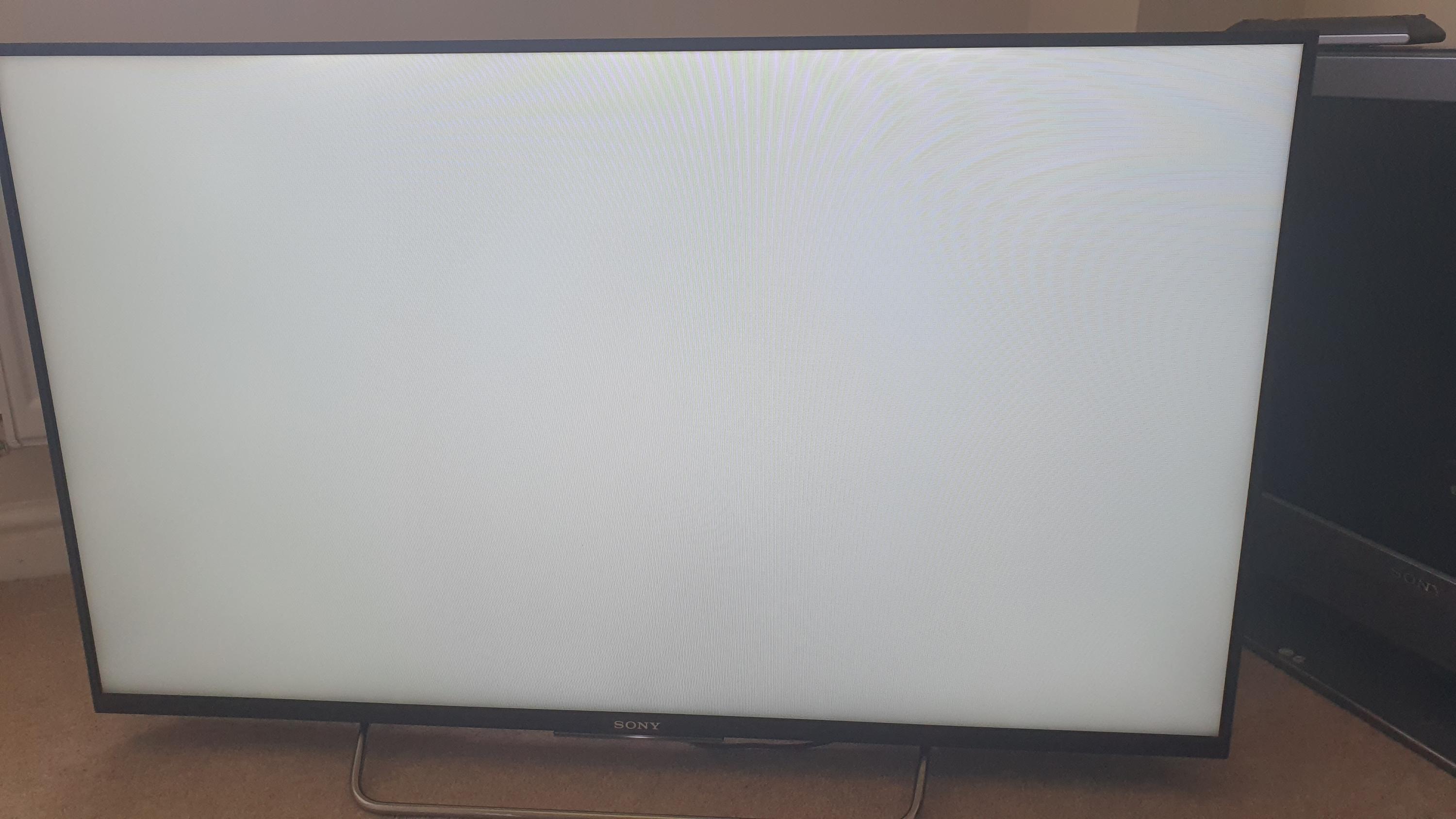

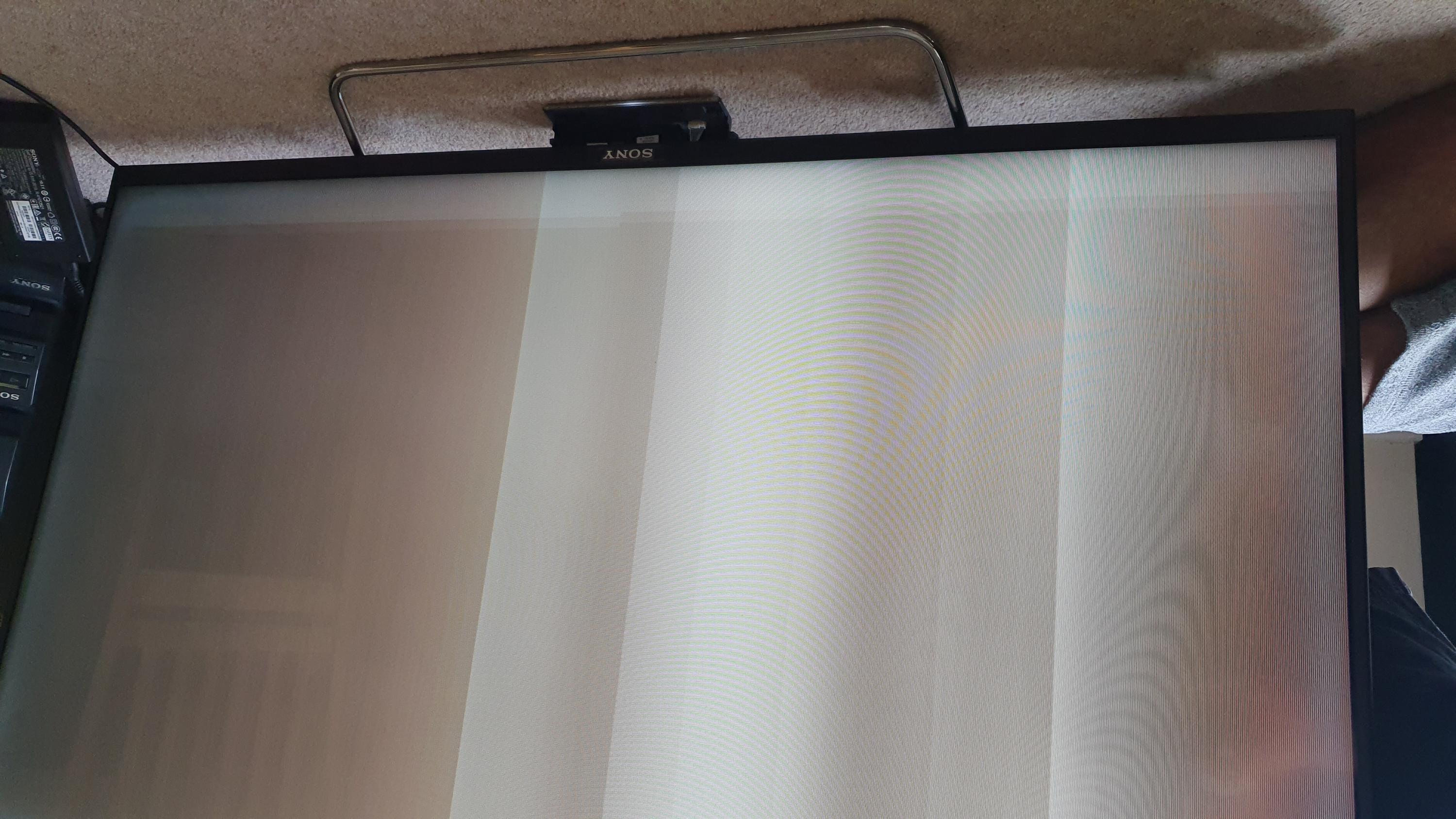

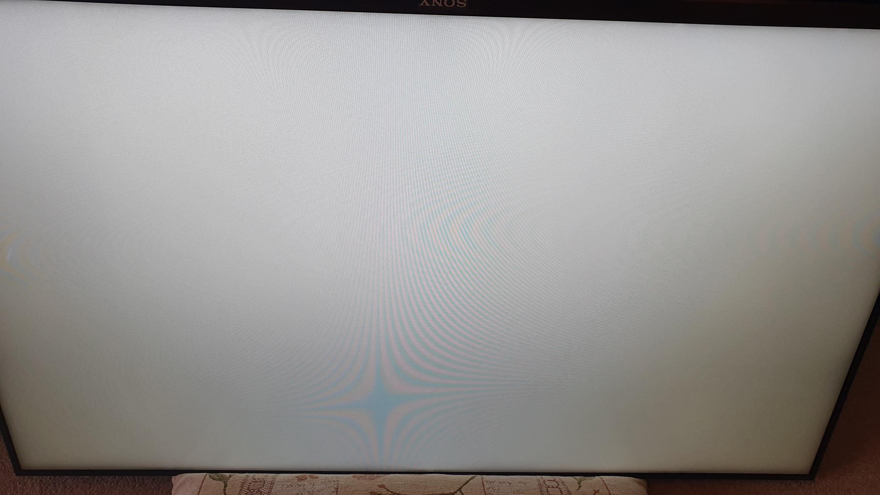

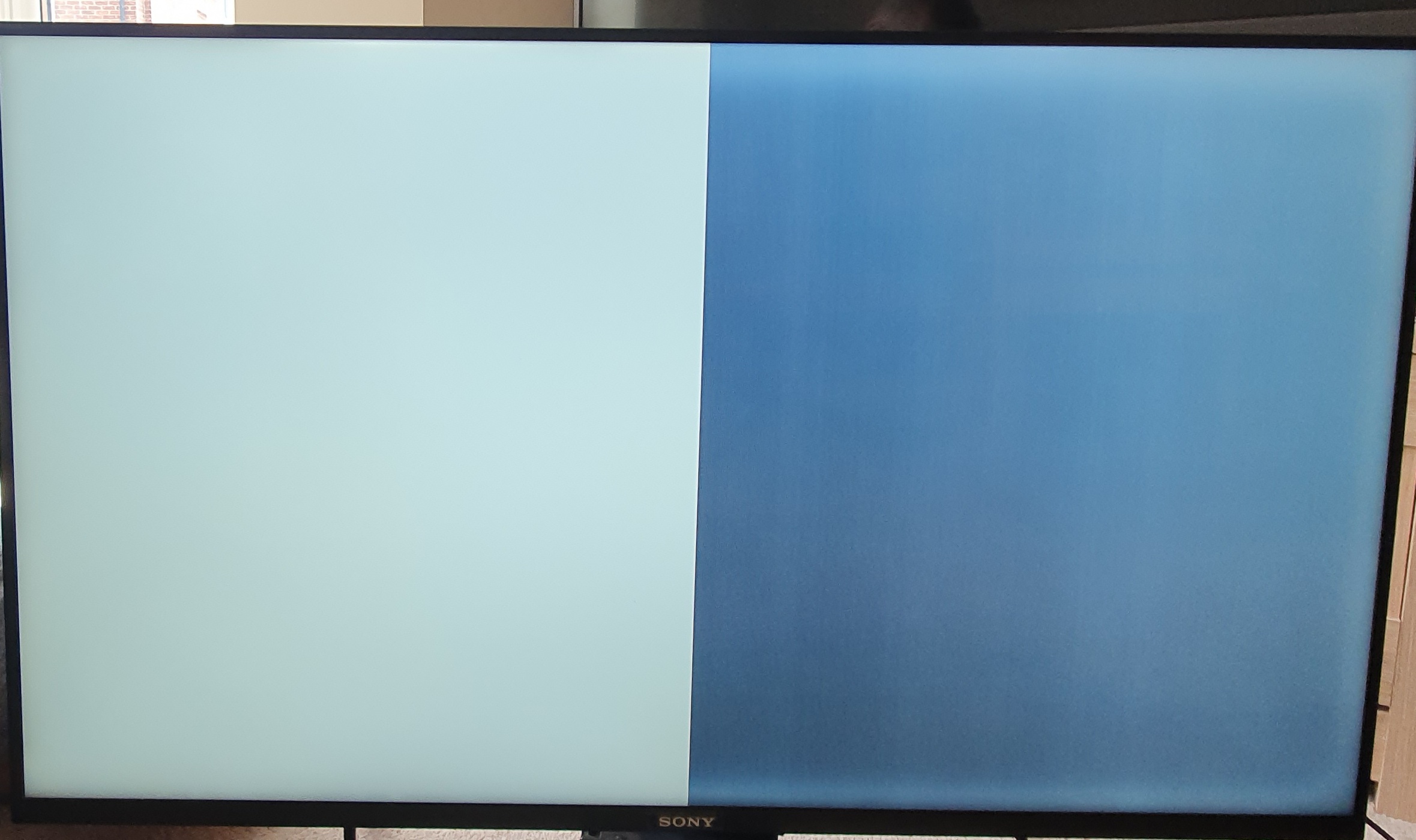

                      Unfortunatelly it is the same �� The picture is comming on and off when it wants.... I cannot link it with anything. The only thing that i found now is that this colored lanes depends on the color of the background.
                      This color is from Android first welcome screen after factory reset (because i did it again after the firmware update). If i am in the setting screen where the background is grey/blue i will see lanes with this color.

                        you need to remove some of the frame member / covers along the bottom of the set to provide a better view on how things are interconnected. From limited "reads" on a previous thread dealing with a TCL / Roku based set, there is "significant comms" between the main / android based operating system and the tcon / panel drivers. If that is interrupted for what ever reason, the set (tcl) seemed to lock up. Of course, this was based mostly on observations as opposed "design intent knowledge".

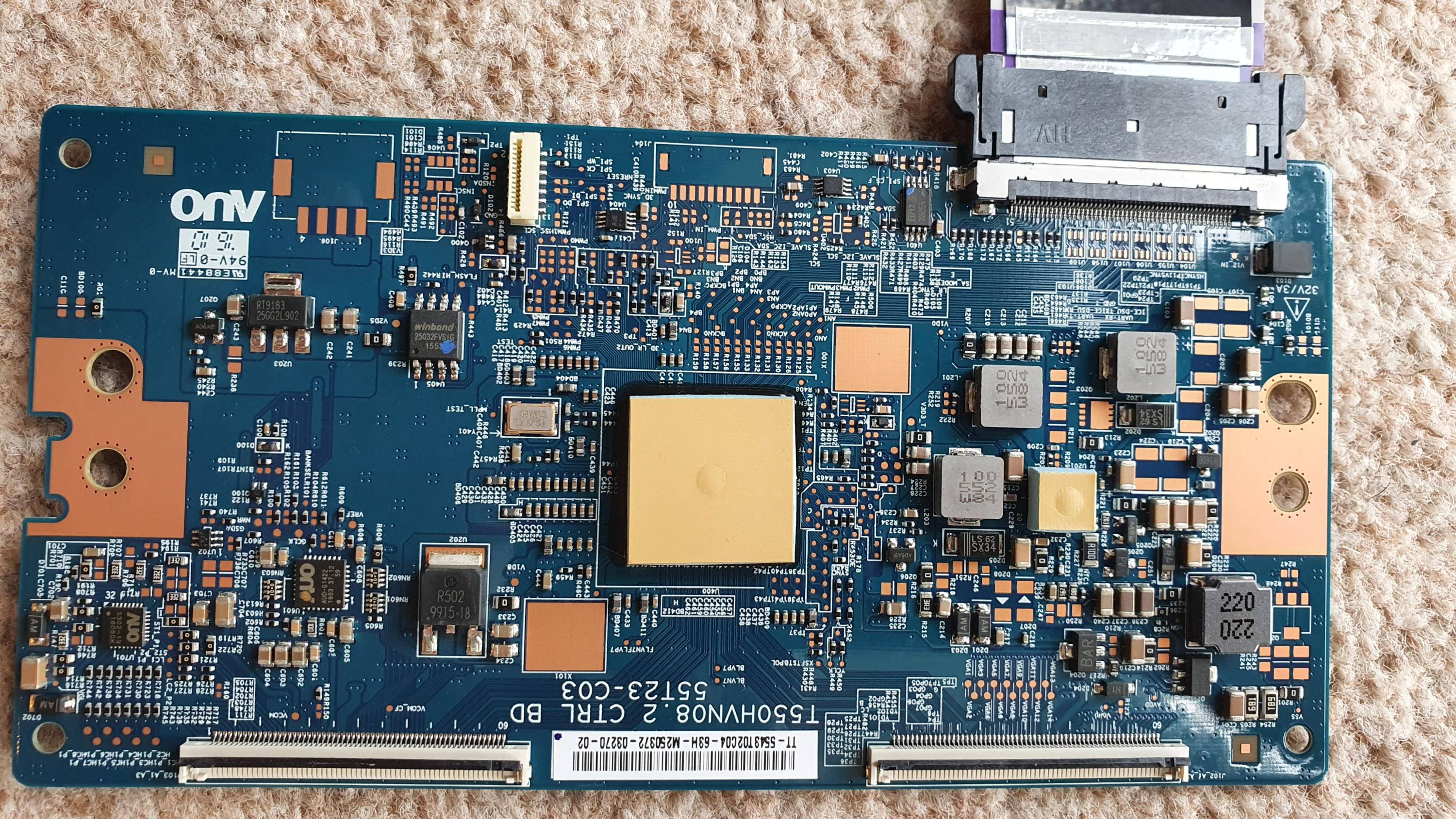

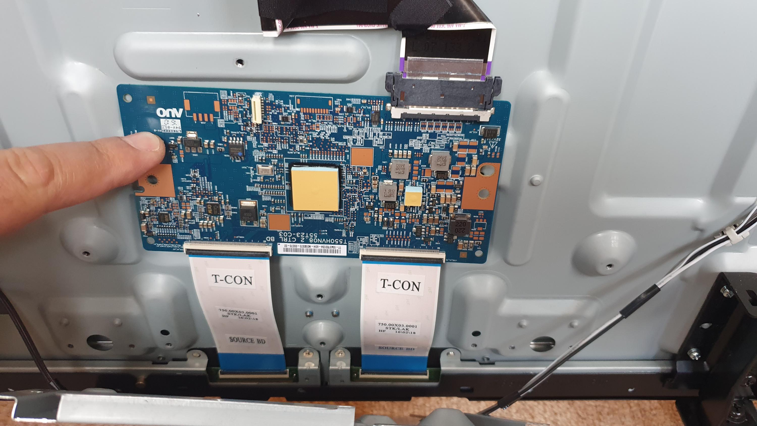

                          This is the TCON board. It is so hard for access and quick tests as it is just behind the mainboard.
                                because of its position, troubleshooting of the signal from the tcon past will likely be ugly. As you see on the tcon, there are a number of voltage points that can be found (eg. Vxxx... but not VGAxxx which are likely image signals). Anyway, if you can't turn on the set and measure the values at those points with the main board in place, then you are going to have to trace / transpose those points to accessable points on the bottom edge boards that the tcon to panel cables connect to. Voltages of interest might be some thing like VCOM, AVDD, etc. It is likely one of those voltages is not there.

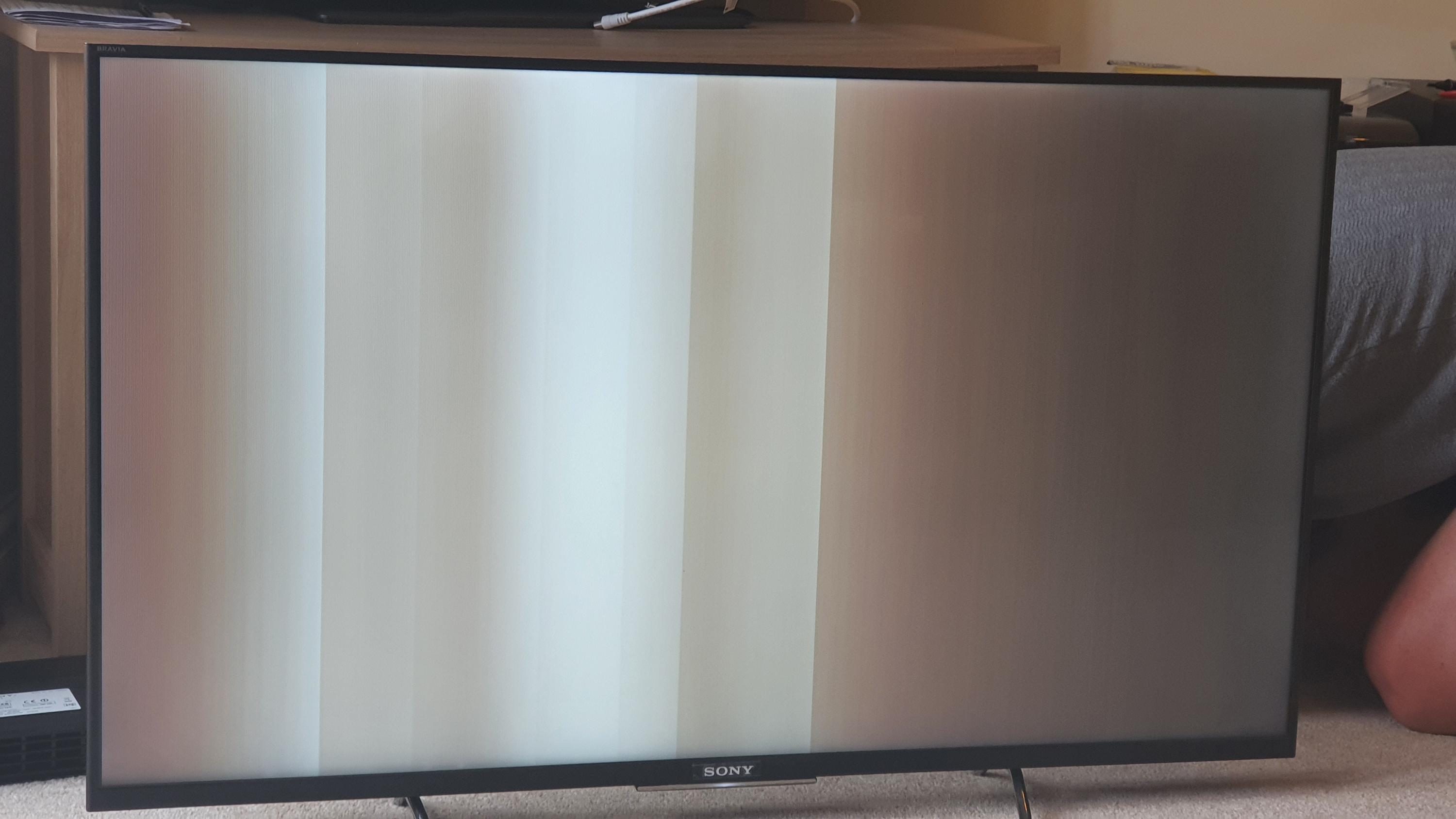

                                One other question: when you disconnect one of the cables from the tcon to the panel, what happens to the display on that side? what happens if you do the other side with a similar test? Post a picture.
                                  Just that half of the screen is going white and the other half is working how it wants... I can make photos tomorrow as well. I've had enough for today.
                                  I cannot make it work normal in the last few hours. Thank you all

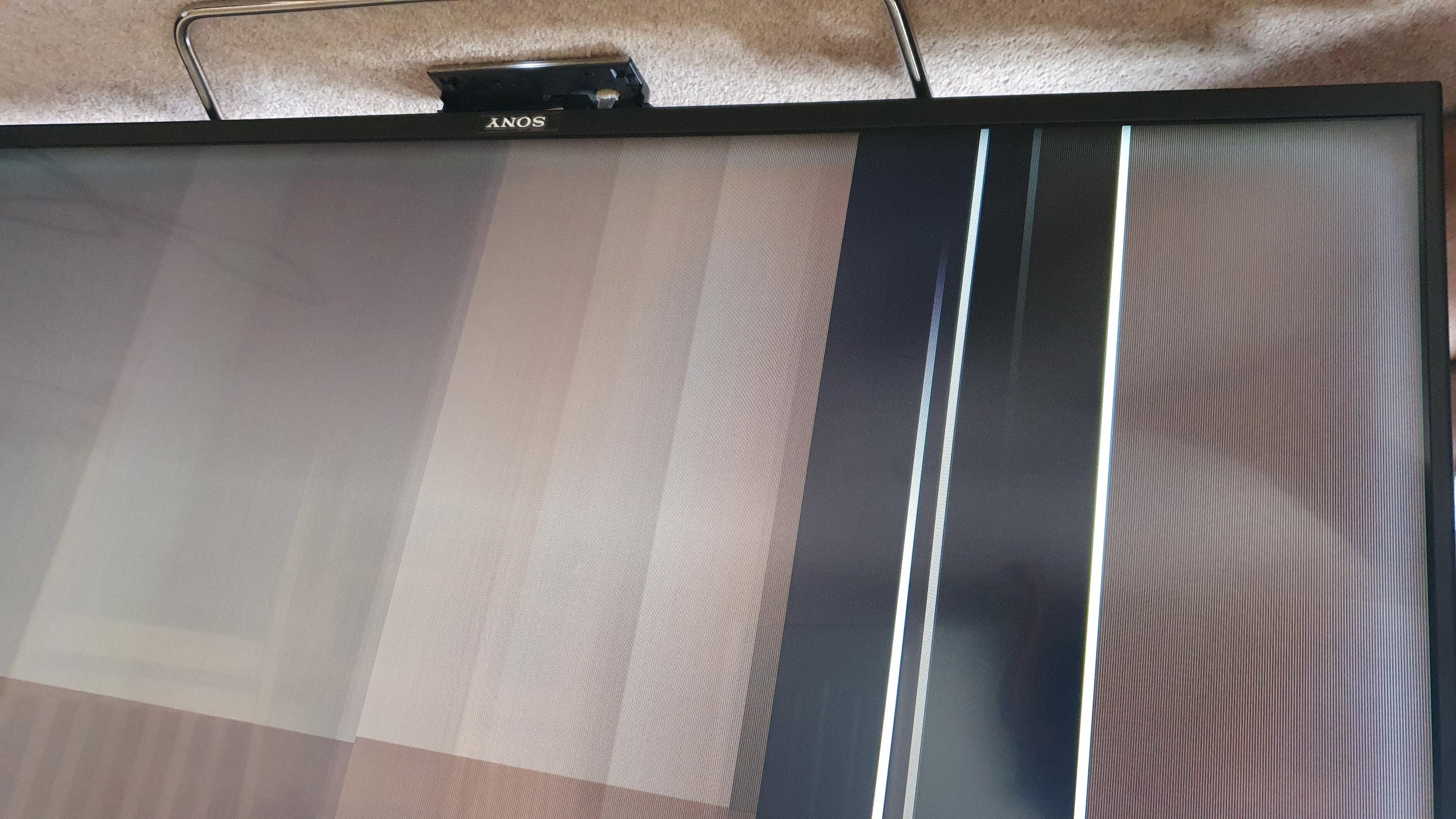

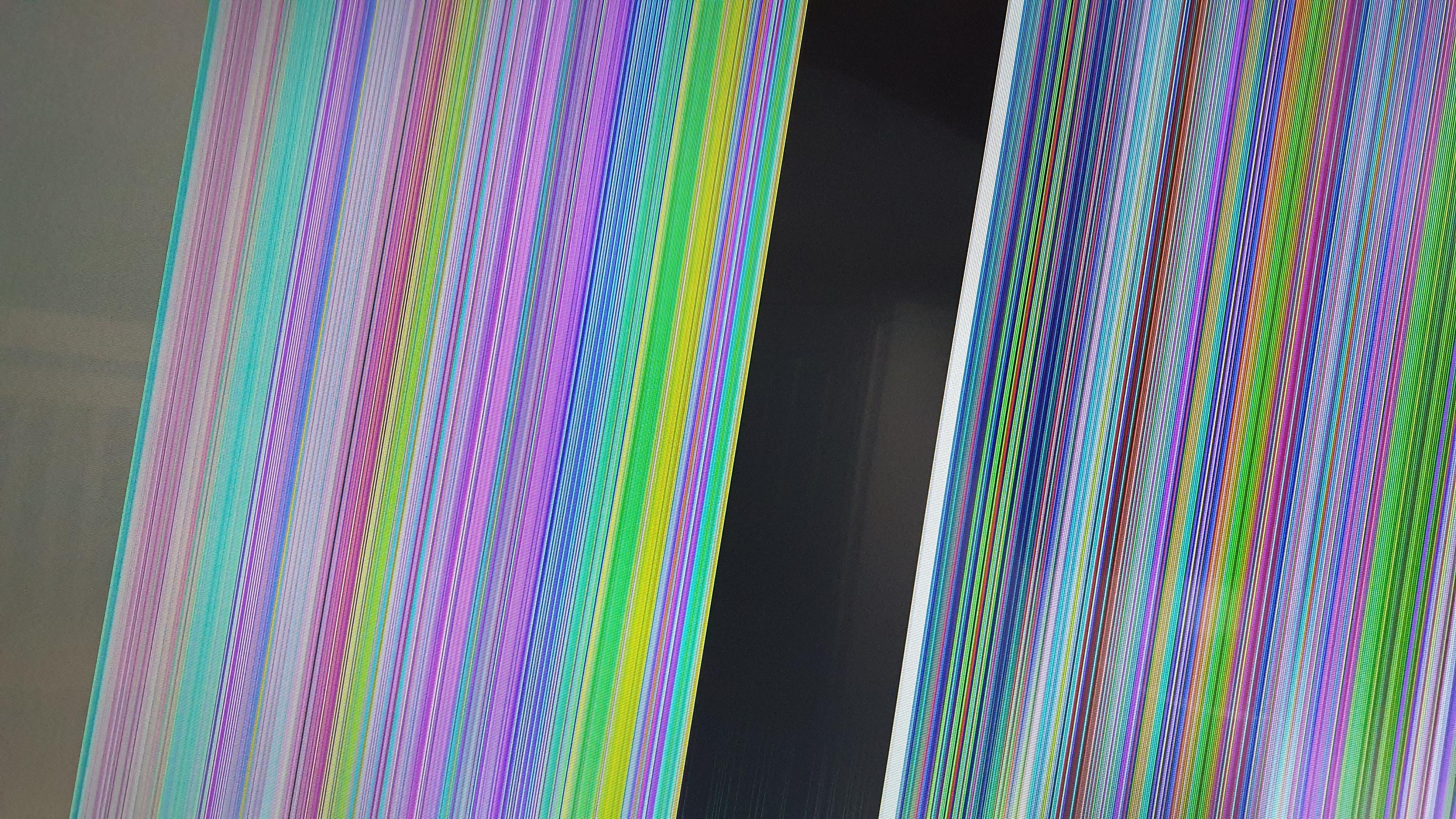

                                      Ok. I took some measurements:
                                      AVDD: 15.68V
                                      VSS: 7.09V
                                      VCOM: 6.47V
                                      VCOM_CF: 6.47V
                                      VGHD: 0V

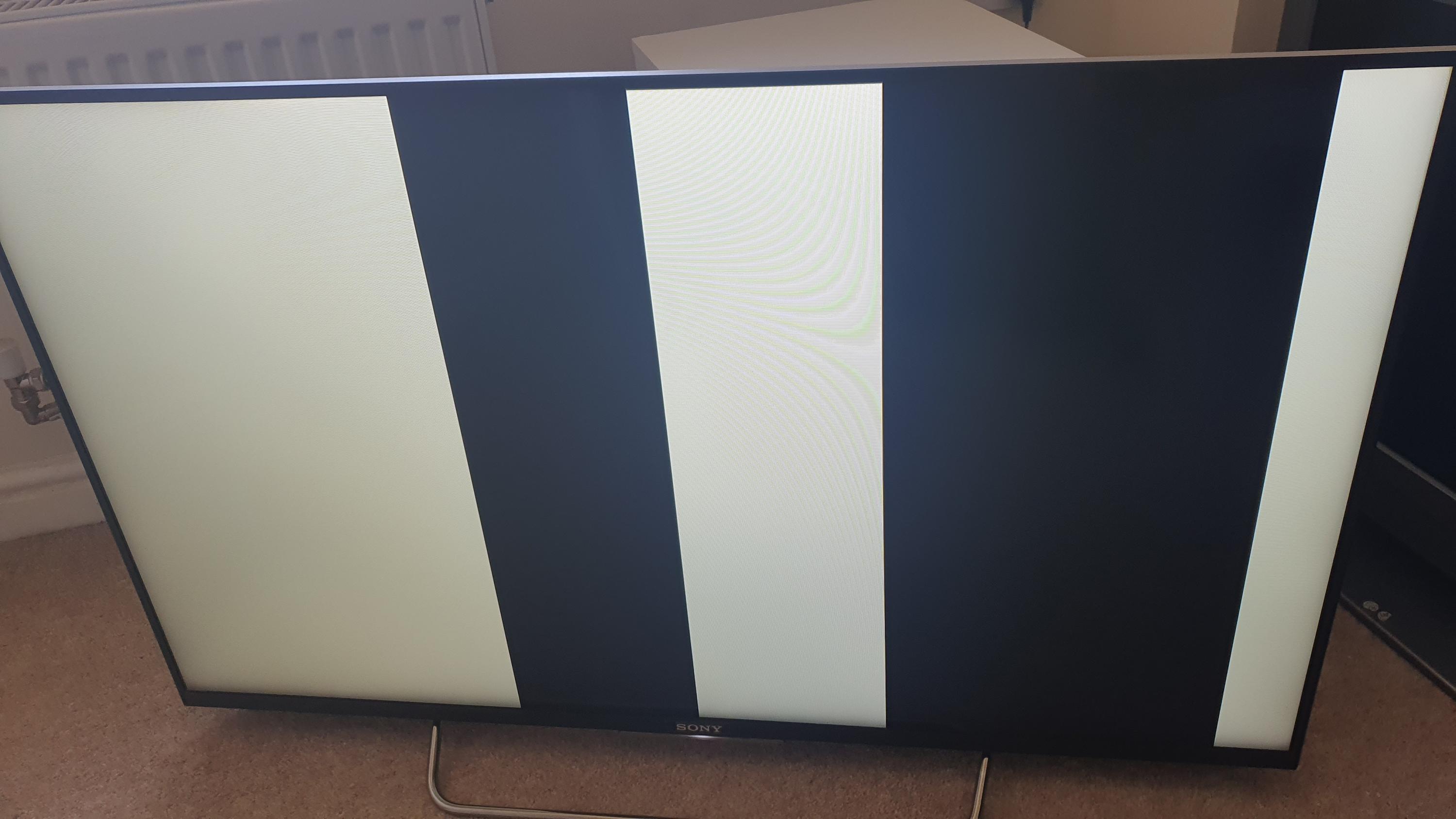

                                      I found and that i have got some display changing when i tap on some of the ribbon cables but not everytime. It is so temperamental:
                                      Here are some photos of the ribbon cables disconnected.
                                      Right side disconnected - I can see clear white right side but some times i can see and one darker part of that half. Some time it is just clear white:
                                      Left side disconnected:
                                      I forgot to mention that these lines are comming when i tap/move the ribbon cable on the middle. Nothing happens if i tap on that end which is connected to the panel.
                                      P.S. Nothing is changing now does not matter if i tap on the cables or not
