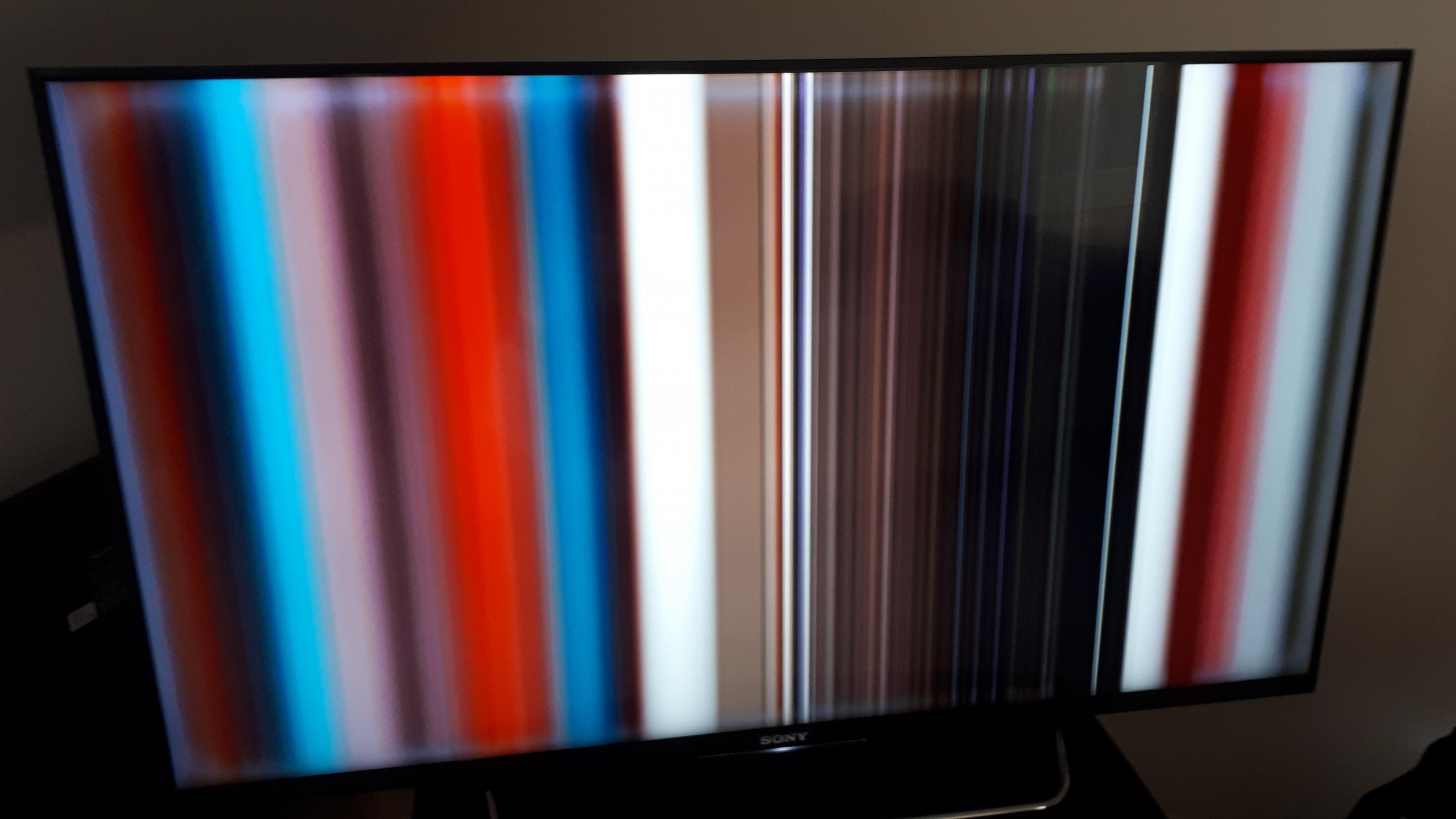

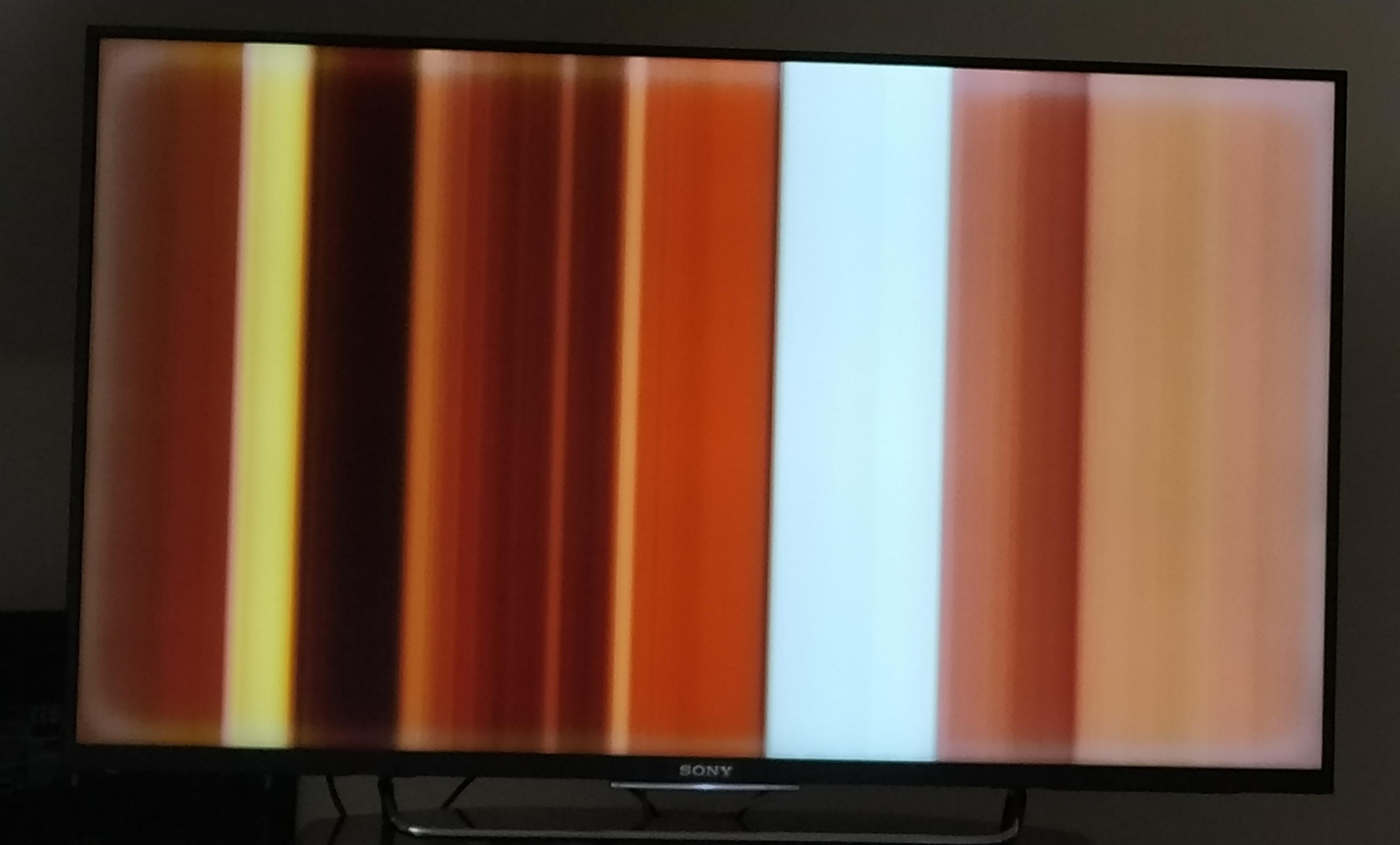

      One more ting which i found today. When i have the TV lying down - screen faced to the table i can see the normal picture more often than if it is normal position. For example - i've had the TV in normal position since yesterday i did not see picture at all after my last reset. I tested in thousands time but nothing. Today i put it lying down and i can see normal clear picture more often now. I now it is weird.... BTW - yesterday when i did the software update etc.. the tv was upside down....

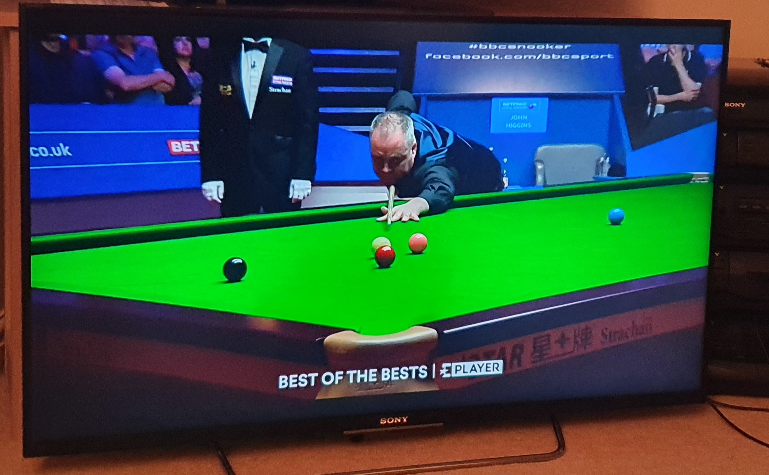

            OK, So, it was with screen down facing the table and it was working normally about 1 hour. Then i turned it upside down (back side to the table) and it was still working. In 15 mins i decided to put it in normal standing position and it was still working - about 3 hours, nice and clear picture.
            Then i switched it off and on few times and it seemed to work ok. Now will see how it will be tomorrow. I believe it is something about the bottom edge boards as well. I will check them once it stops work again.
            One more thing which i noticed now - Before that when i had problem with the picture and I was doing some tests, measurements etc. i found that the bottom edge of the tv is getting warmer. Not too hot but warm. I thought it is normal. But now after 3hrs working the bottom edge was nice and cold. One more reason to make me think about the problem with that connections on the bottom boards.

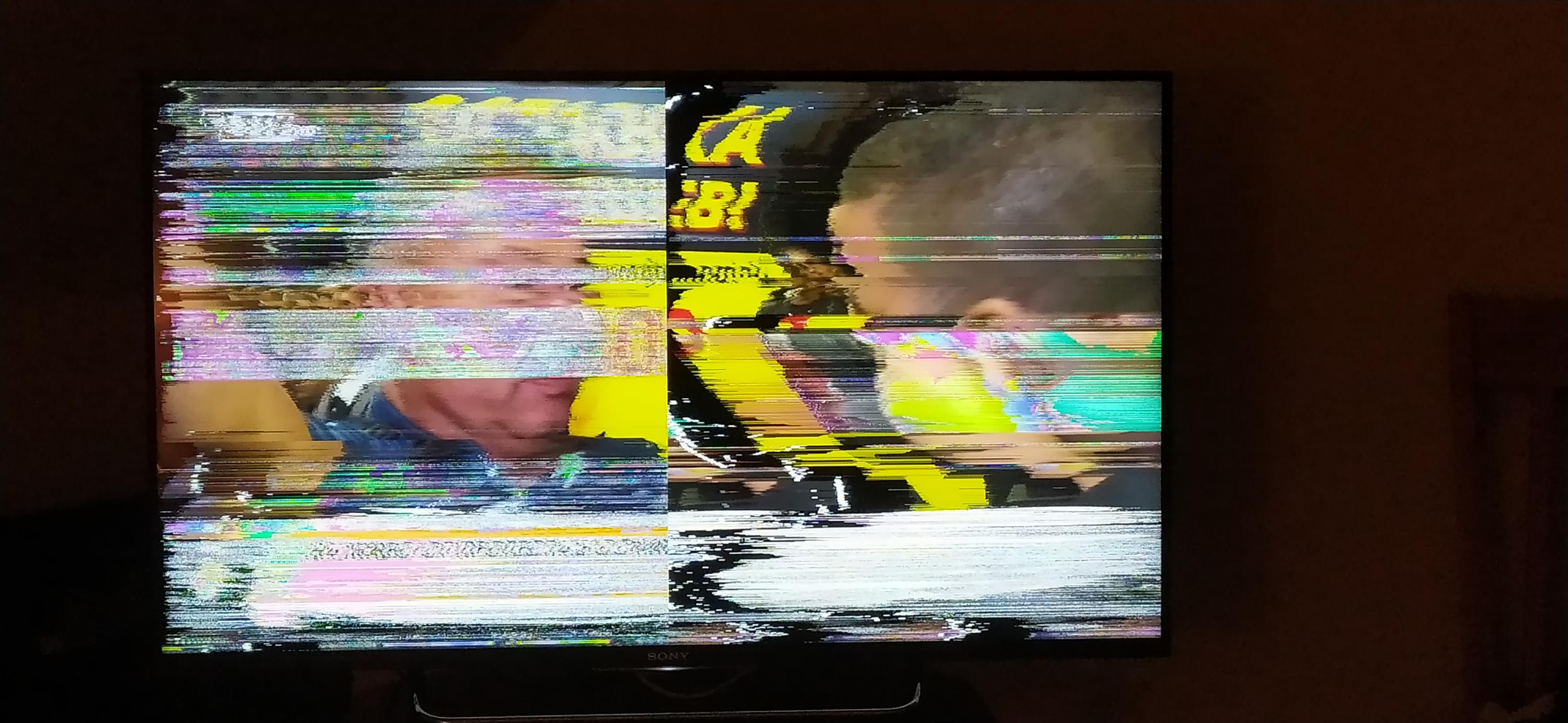

                            Hi, guys. I am back in the game with this tv It was working in the last months but now the problem came again. This time the tv is set so i can change the channels, play youtube etc. So, the tv starts with white screen every time. Then if i have something on the background the colored lanes are coming in few minutes.
                            If there is no moving picture on the background nothing is happen - just white screen. And after these colored lines the picture is coming normal in another few minutes.
                            In the last few days after the white screen and then the colored lines when the picture comes it is with big distortions:
                            Can i believe it is something about the TCON board or?!?
