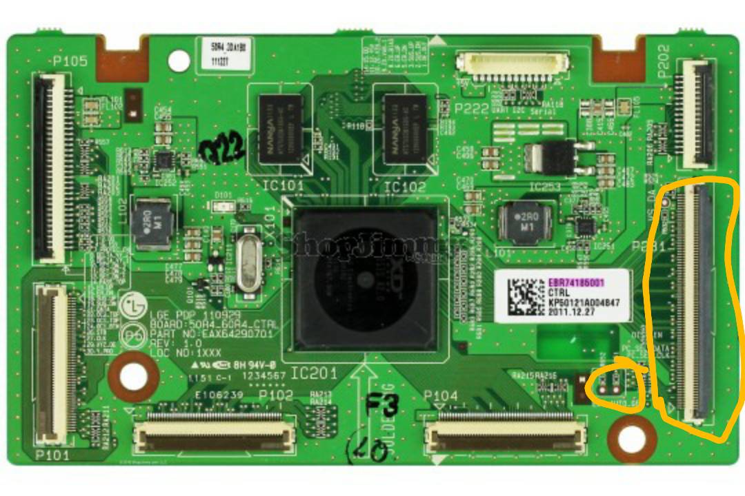

    Now I hear a faint buzzing, logic board green led is on and center board where flex multiple flex cable goes it green led blinking sequence. Also chips going to warm to touch.

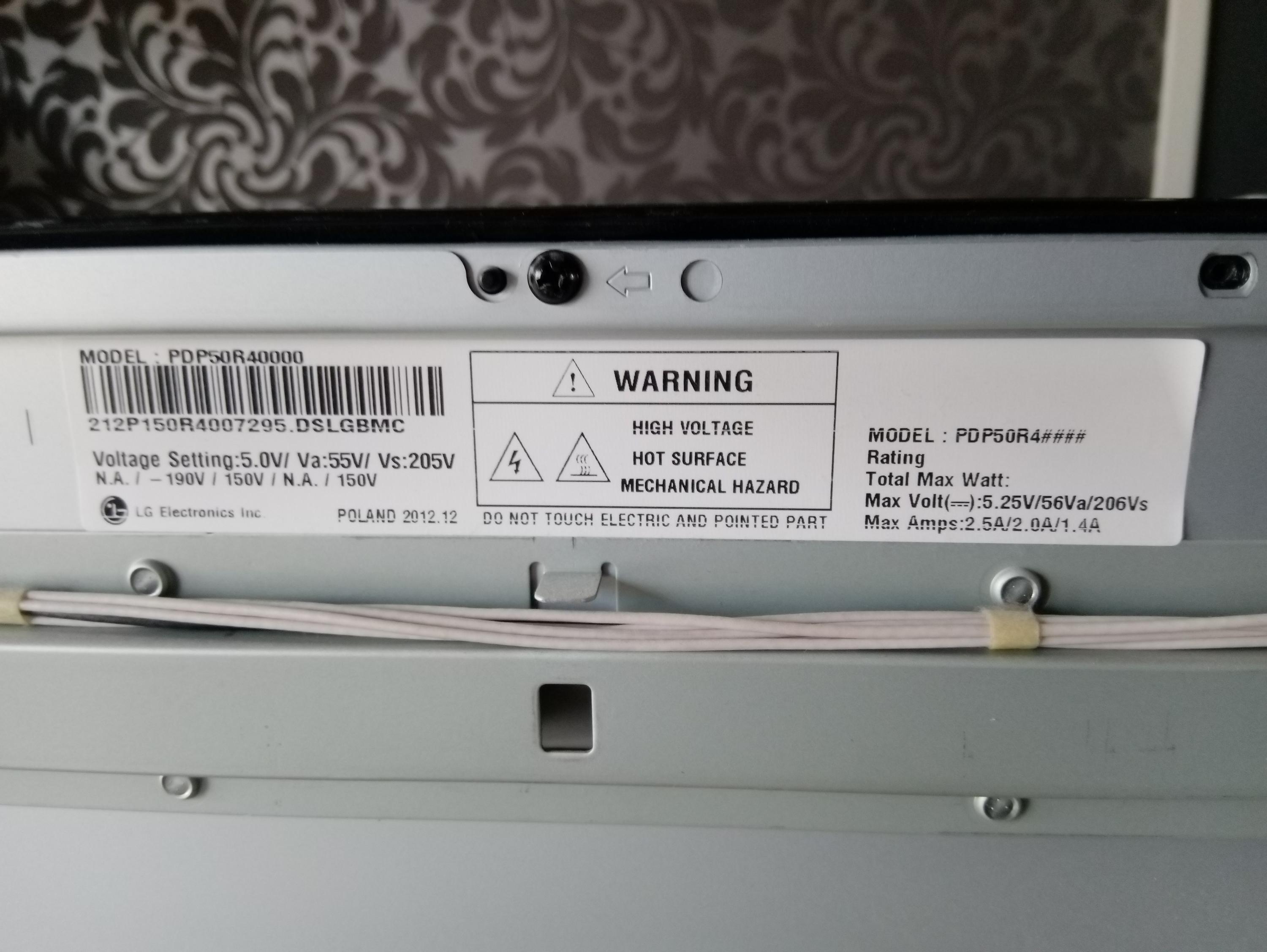

          Vy and vsc dont look right.
          Upload a photo of your panel sticker just to confirm.
            See attachment.

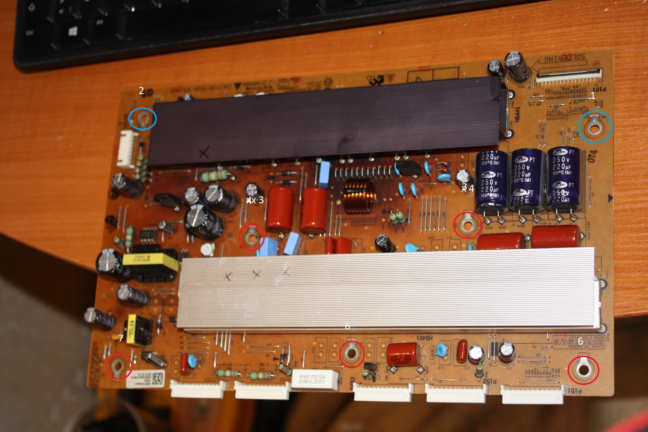

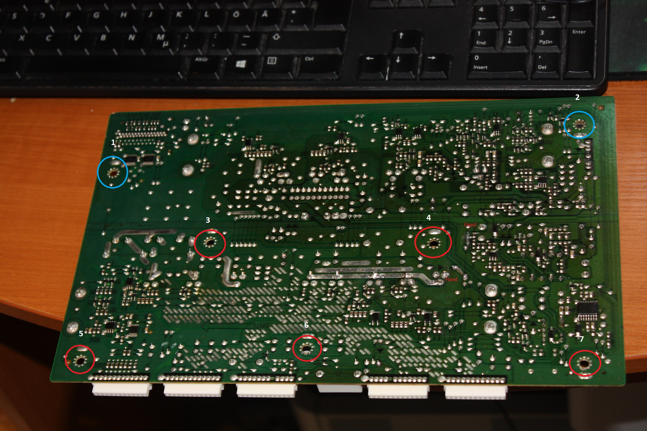

                  Found another problem from Y Sus board.
                  Can place screws only 1 and 2 screwholes and tighten. When trying place screw or tighten screwhole 3-7 tv not start (only standby led off for few seconds).
                  Screwholes 6 and 7 have small crack around hole. Tried place screw to hole 4 and got sparks. (holes shorting (?)) they are ground points to chassis??
                  (See photos)

                    -Vy should be -190v according to sticker. You are reporting 204v (-204v is using the proper test points?)
                    Maybe you're sending that circuit into shutdown ? Trim down -Vy voltage.
                    Re the 15v on the Zsus I don't know which cap you're referring to but there is usually a 12-15v supply on the Zsus. Comes from the Ysus and is usually routed through the logic board.
                    If the ground points around the screw holes are oxidized from previous arcing then rub them clean with emory cloth or similar so they make good contact. Otherwise you have more serious issues.

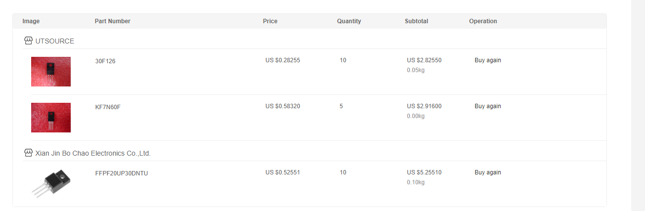

                                    There was a discussion a while ago about the number of fake Mosfets on sale on eBay so I would only buy replacements from a reputable supplier.
                                    • tietoharrastelija
                                      • May 2019
                                      • 24
                                      • Finland
                                      Re: LG 50PM670S no image
                                      Can't find 30F126 from any a reputable supplier. Purchased components from UTSource. 30F126 looks like used (thermalpaste residue on component)...

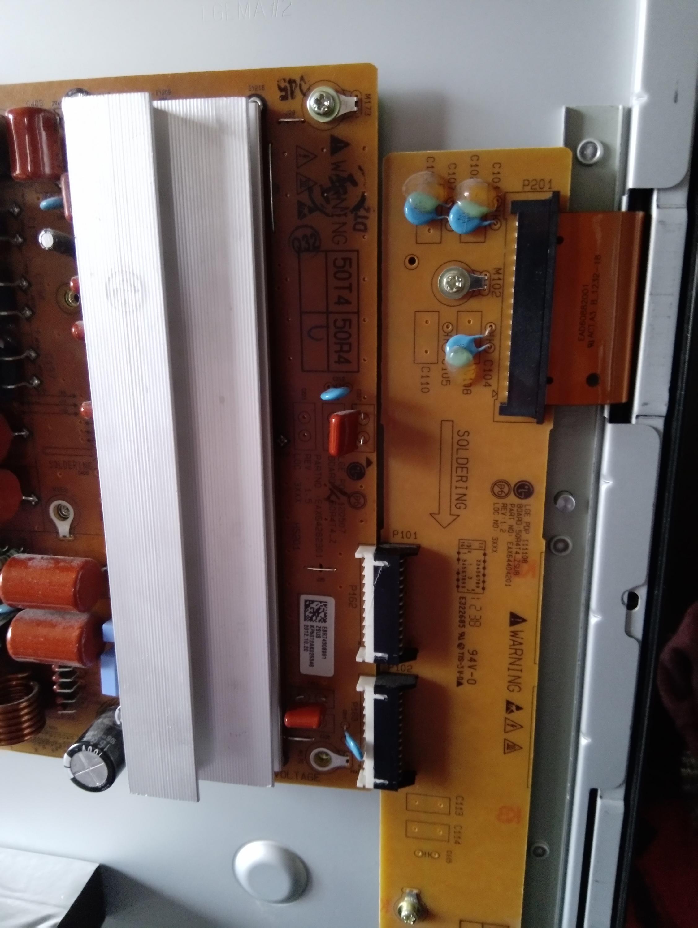

                                        Tested Y Buffers without TV -> no shorted. I put everything back (also screws) and tested. No magic smoke, TV started internally logic board green led and center board led blinking. Also standby goes to on. But still no picture. Yesterday I was turned trimming potentiometer (Maybe VY voltage), changed it yesterday same position but maybe not same position (Can that cause no picture??) How to set it correct position?
