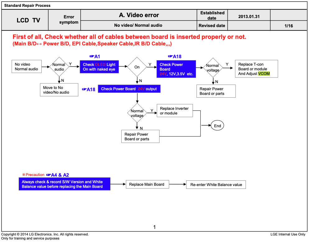

        Vcom may be in the service menu
        Here is what it's about
        https://www.edn.com/simple-vcom-adju...upply-voltage/
        https://www.youtube.com/watch?v=S2bFK_vm-cw

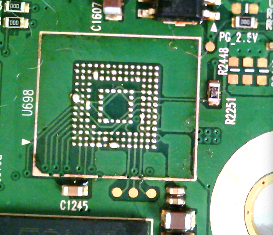

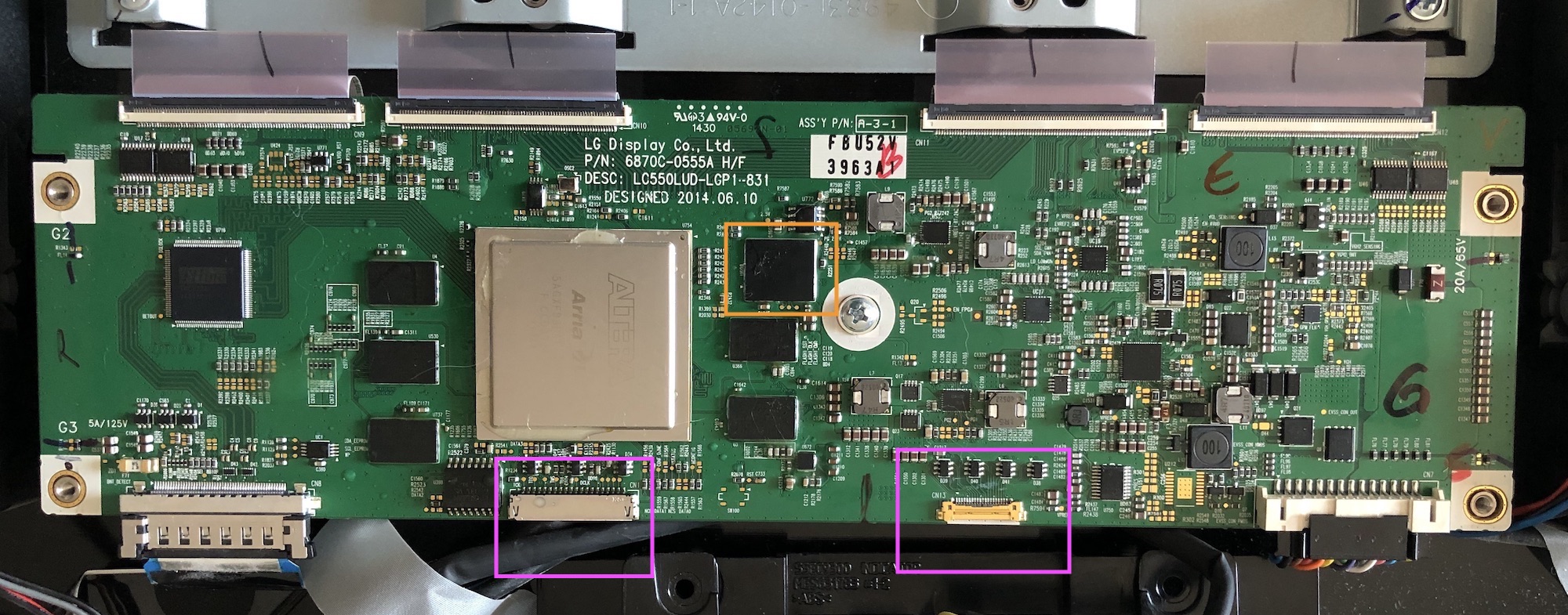

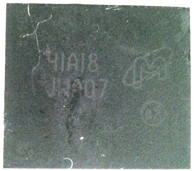

              Finally I found the damaged component. Is a Micron eMMC 8GB memory next to the FPGA named U698, (41A18 JWA07 NAND MTFC8GLDEA-1M WT) responsible of storing the basic OSD (volume control, source info, ecc..) and unfortunately, the screen factory calibration. Replacing it with an identical component of a donor board, works but the screen vertical lines remains. So no definitive fix for now.
              The only way that pass in my mind, is to read both the original and the donor board NANDs, find the location of the screen calibration by comparing the two, and then flash the new one with a custom merged ROM.
              If someone have some knowledge in this matter and want to help... thank you!

                  these bands shows with a new TCON. When LG replaces an OLED panel, the kit came with a TCON altready installed on the panel, probably because the TCON is custom calibrated only with that OLED panel.
                  When I soldered the old TCON eMMC on the new one, the TV showed exactly the same behavior as I opened the topic, so it is clear the problem is the defective eMMC that stores the factory calibration. In fact, the lower bar, the only piece of image the TV shows with the new TCON with the old eMMC does not show any vertical band.
