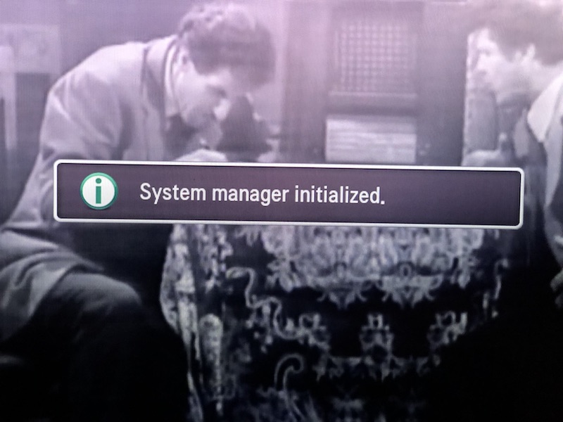

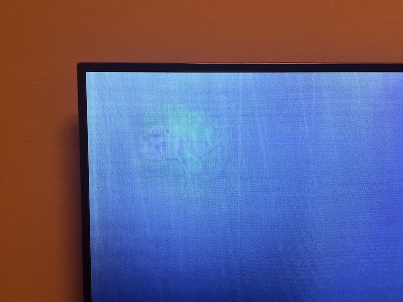

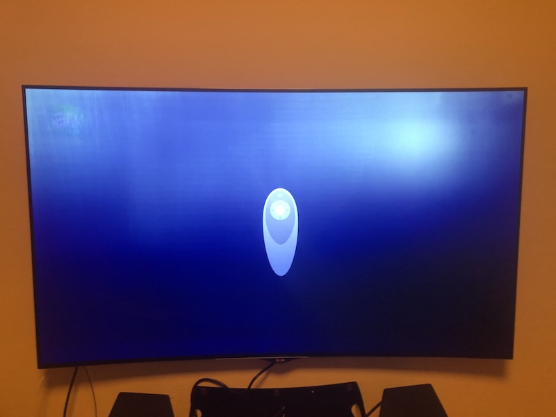

              Good news and unfortunately bad news, today I replaced the TCON board with a refurbished one, the picture now is almost everywhere lit at high "OLED light" settings (Standard value is 60), but at normal viewing light (set 10-30) the screen shows a very strange behaviour! In the upper left corner, I see something strange, an "a" that in my opinion is a part of a TV emblem. The rest of the image especially at the bottom is faded out a lot.
              Just to clarify, this TV was never used with TV sources, only for BD movies and streaming service like Netflix, so TV emblems are really unlikely to be there...
              Correct me if I'm wrong, it seems the used TCON is retaining the picture of the old TV from where it was taken. Is that possible?!?
              Please kindly see the pictures below, I already did a factory reset and then a IN_STOP to reset the TV, but with no change.
              Thank you!

                I have yet to come across an OLED but won't that clear itself up after a few power cycles ? I remember freakafter8 had something similar happen to an OLED he was working on and the problem vanished without him doing anything iirc.
                • maxino

                  Unfortunately, the TCON did not refresh by itself, but as per LG website, the screen do a pixel compensation every 4 hours of use (when then you put the set in Stand by). BTW, I have another issue here, it seems the firmware have something wrong, I never saw a volume indicator like this one, also the loading screens are very strange (see pictures) is there any way to force a firmware update? The set is connected to the internet but it does not show any available update (current FW 5.05.70), so part of the firmware is stored inside the TCON!?!?

                    #29
                    Re: LG OLED 55EC930V Horizontal flashing lines problems
                    05.05.70 are the last version of this set firmware.
                    T-CON ram saved part of panel driver and refresh rate, this will be reset at IN-STOP and you did it already.
                    as mmartel wrote. this behavior could be corrected by time or via build in pixel scan at setting.
                    it help too to use build in player to play movies.. or test jpg pictures with one color, also play YouTube on the set.

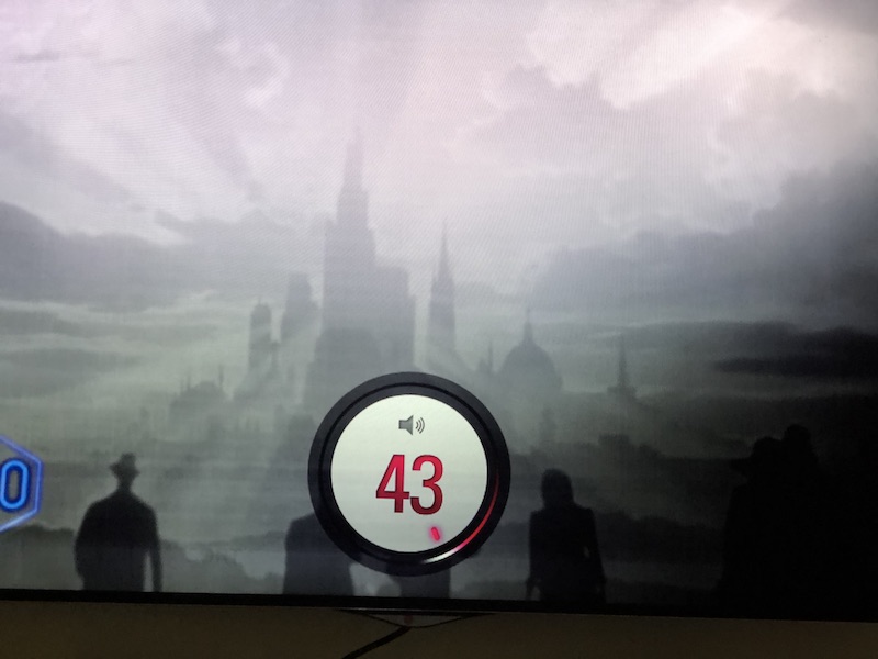

                              PS: playing movies, using HDMI ports, all is working 100%, now I'm running some movies waiting for pixel resynch, tryed the EZ-ADJUST pattern but it doesn't remove the image retention stored in the TCON.

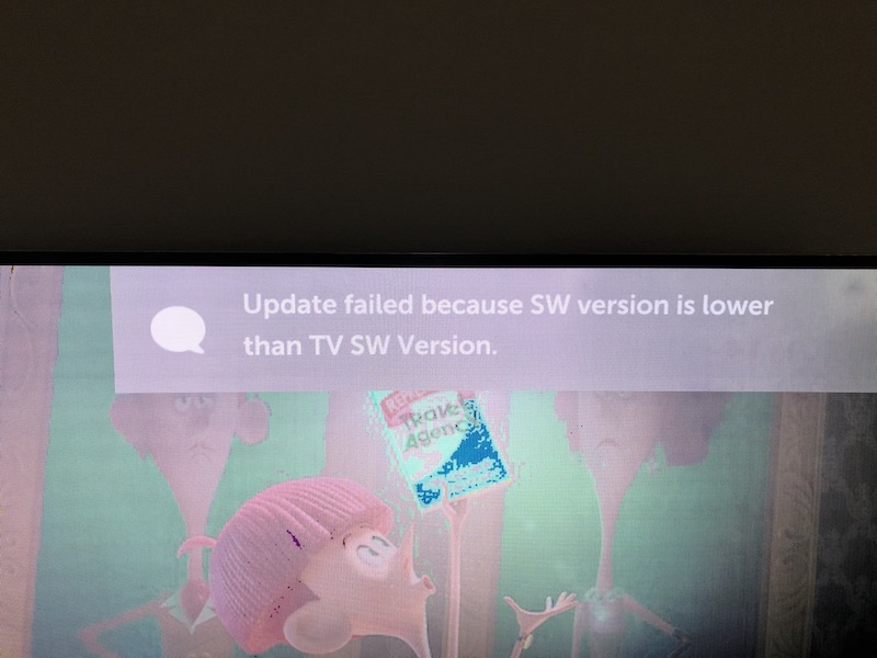

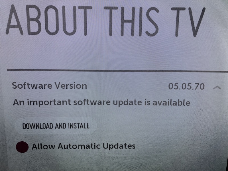

                                Tried to downgrade the FW with LGDTVUPDATER but it doesn't work, please look at the attached pictures.
                                Original Content From: https://www.lgwebos.com/topic/1997-h...ware-tutorial/
                                Now I'll try with the tool NSU Emu by SMX
                                https://github.com/openlgtv/nsu_emu
                                NETFLIX doesn't work, it seems the HDCP chain is not working properly

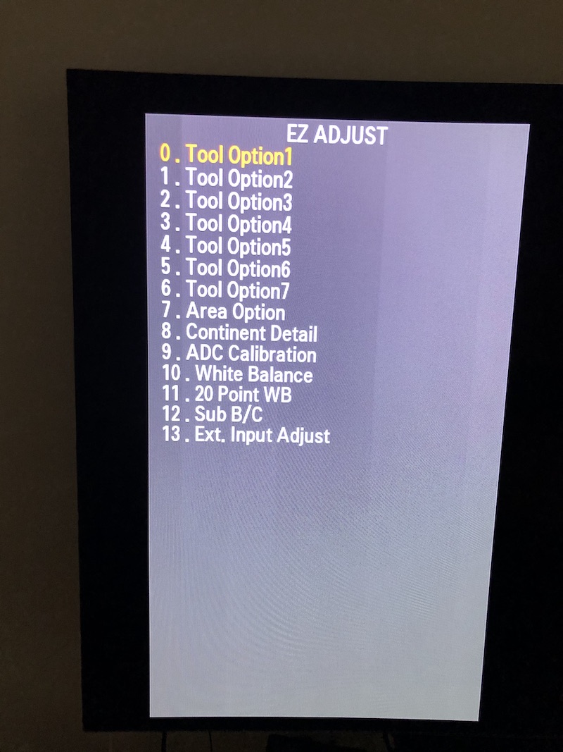

                                  post photos on first page of service menu IN_START and E-Z Adjust
                                  about NETFLIX ... dont forget you need to bring the network setting after downgrade to normal setting :-)

                                    So thank you for your patience, after 4 hours of random viewing, the TV did the pixel compensation as you described, the picture is finally better than before, some persistent vertical lines are there, almost same behavior as Billsy here https://www.badcaps.net/forum/showpo...4&postcount=53
                                    BTW, emblems almost vanished, no solarization and no color banding so I'm already happier than before
                                    Pictures Below (please note the moiré effect does not come from the TV)
                                    So have I to wait for a second compensation, so it will eventually make the image even better?
                                    Please also find IN_START and EZ_ADJUST pictures below.
                                    The Firmware problem still remains, but at least the TV is "usable", I'll try to reflash the same firmware next days.
                                      yep it look good.. as its just did compensation 1, when the count come high it will clear it more.. the effect as billsy caused by removing the ribbon cable. it will disappear later..
                                      i would say dont touched it any more or doing any to the firmware.. always if you want to refresh the firmware and clear TEMP of using.. IN_STOP always the only answer.
