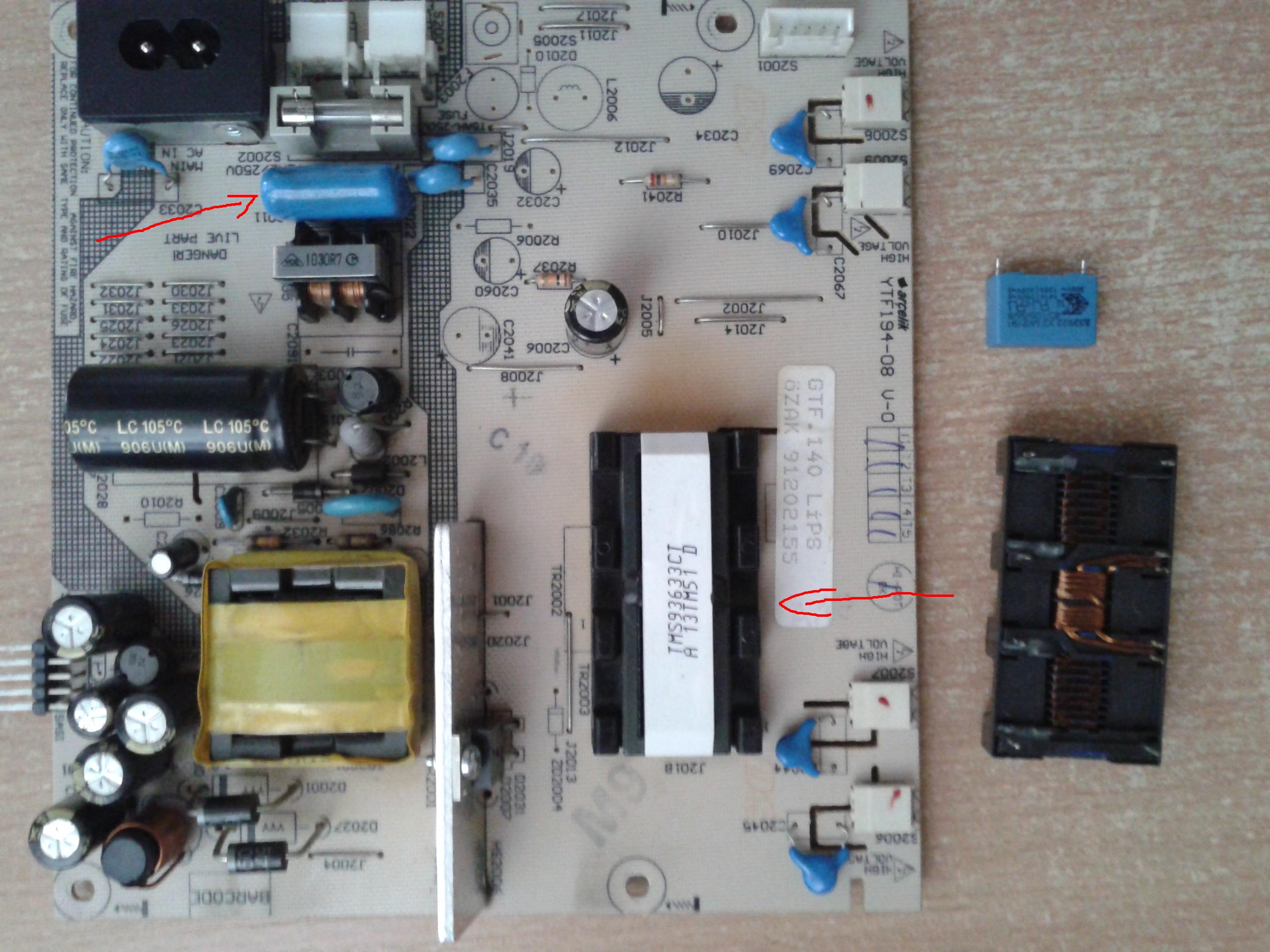

    this TV stays on standby, but when i try to switch on via remote it
    start for 2sec and goes to standby again.
    Before this i change backlight transformer, dut to problem
    in secondary windings. Also i change 220nF X2 capacitor.
    It has PSU YTF194-08 V-0
    Also i notice that voltages are 5.3V and 13.5V, but no idea
    why both of them are ~10% up.
    Capacitors on output are with low ESR - tested with MESR100
    Any ideas what/where to check?

    Can you post some photo's of the circuit board as an attachment. Also of the capacitors and the transformer you replaced

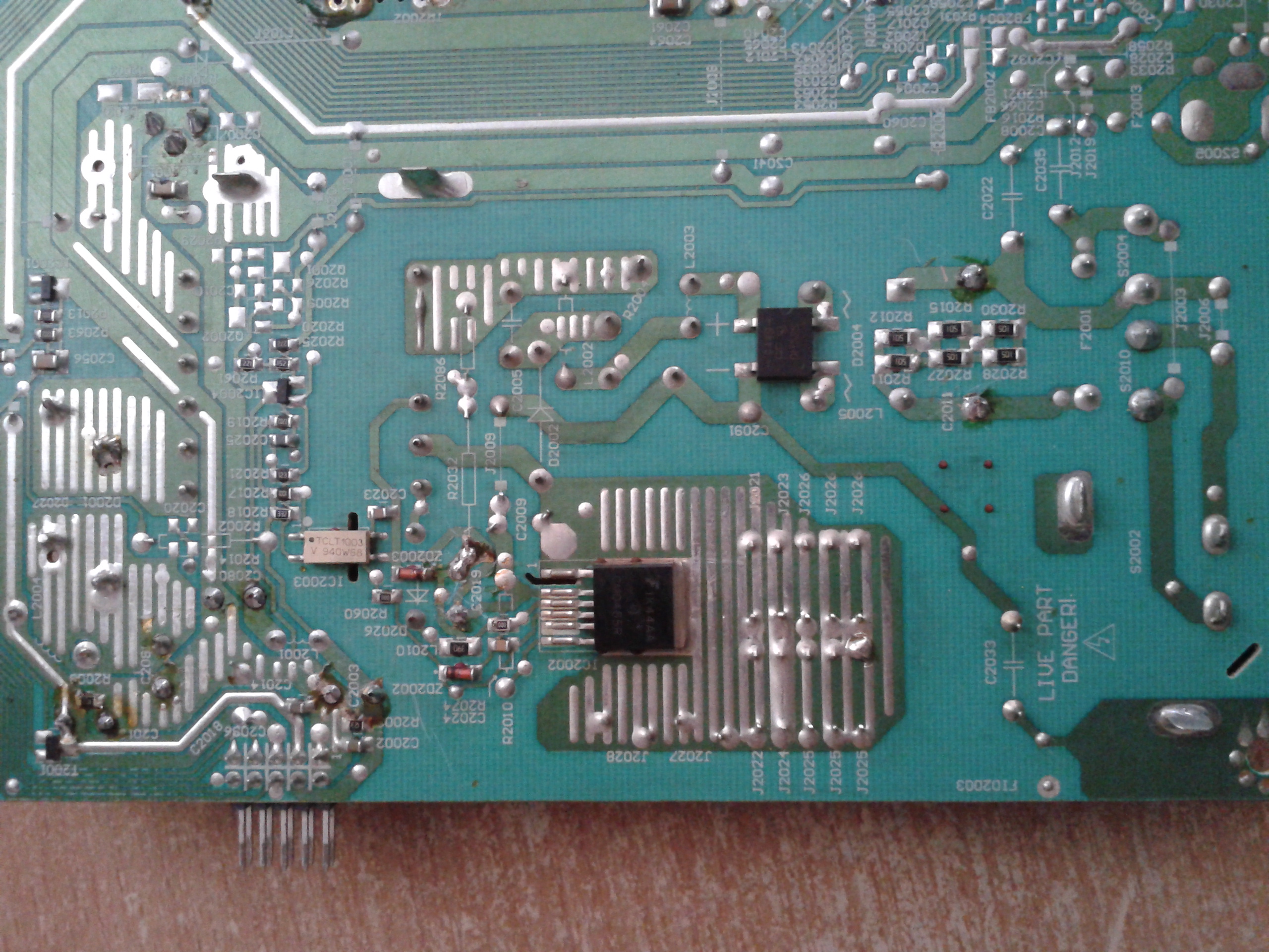

      Yes. Here are pics of both sides of PCB.
      There is signs of flux because i remove some parts from PCB to
      measure them. All parts that i test seems to be OK

        So the transformer is the same part number (TMS93633CT) as the original so that cannot be the problem.
        I would check that the ends of each fluorescent tube are correctly seated into their connectors and not damaged.
        Open lamp protection overide using 560 ohm resistor from Pin1 to ground

          Are those burn marks on S206 and S207?
            may be you mean S2006 and S2007 - CFL connectors?
            No, there is no burn. On the top there is some red mark with
            marker...
            Btw optocoupler seems to be a little burned around transistor side...

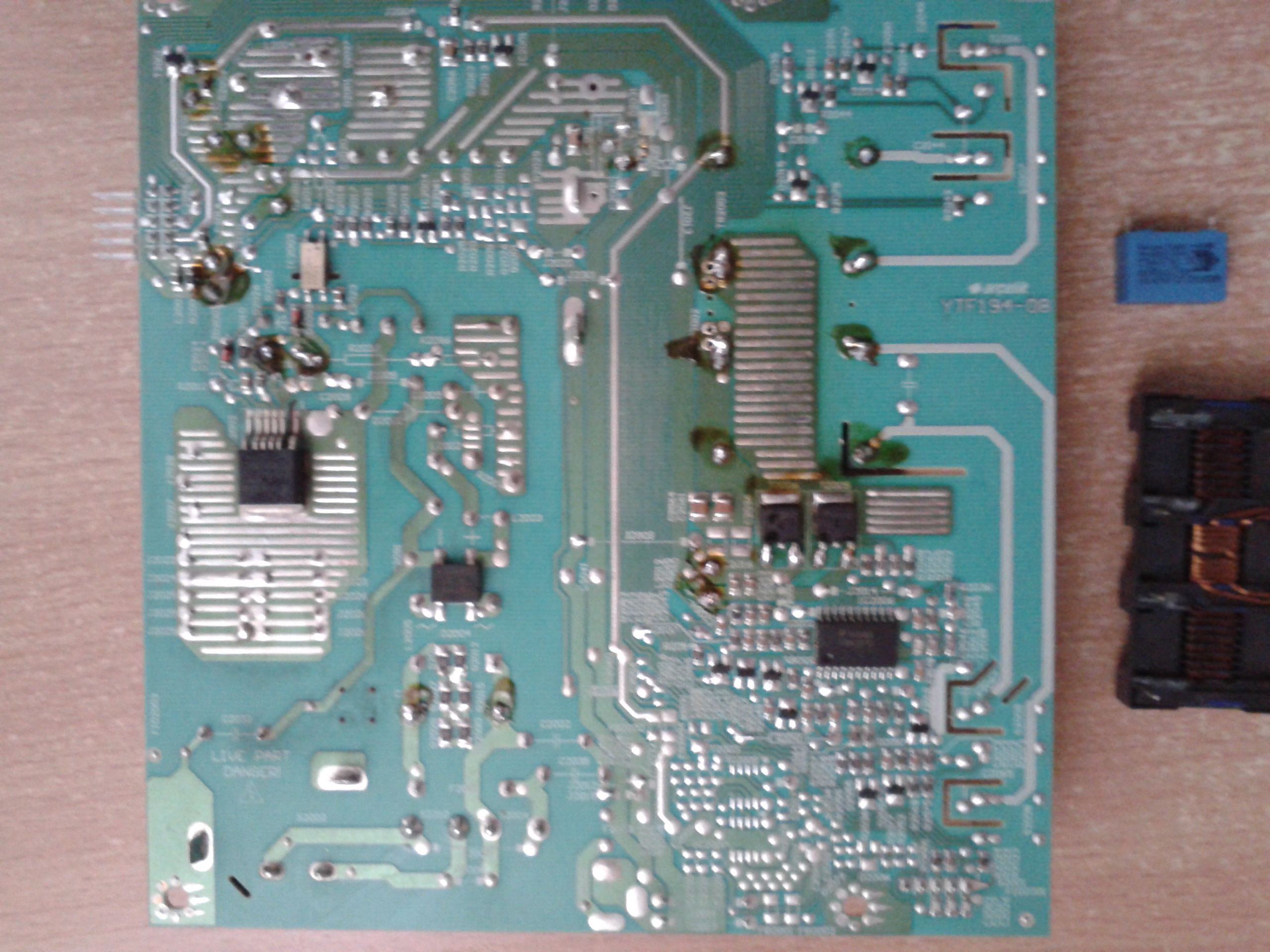

              I do not think there is a problem with the opto-coupler since you have the 5V and 13V supplies.
              The photo of the back of the board is very out of focus. Perhaps you could post a good focused one.
                But why 5 and 12v are high?

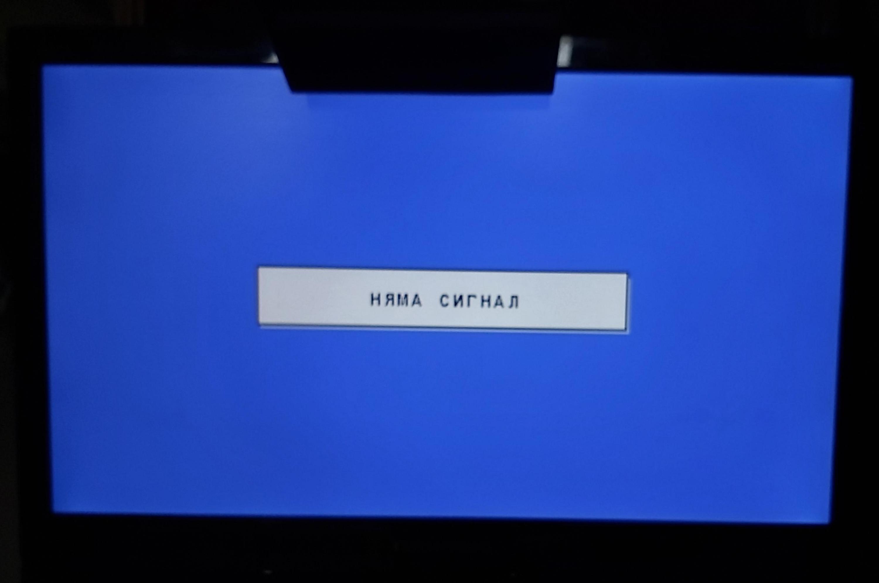

                I make test with resistor - it work for 5-6 secs and
                picture (blue sreen + no signal message) looks good, then
                i turn it off.

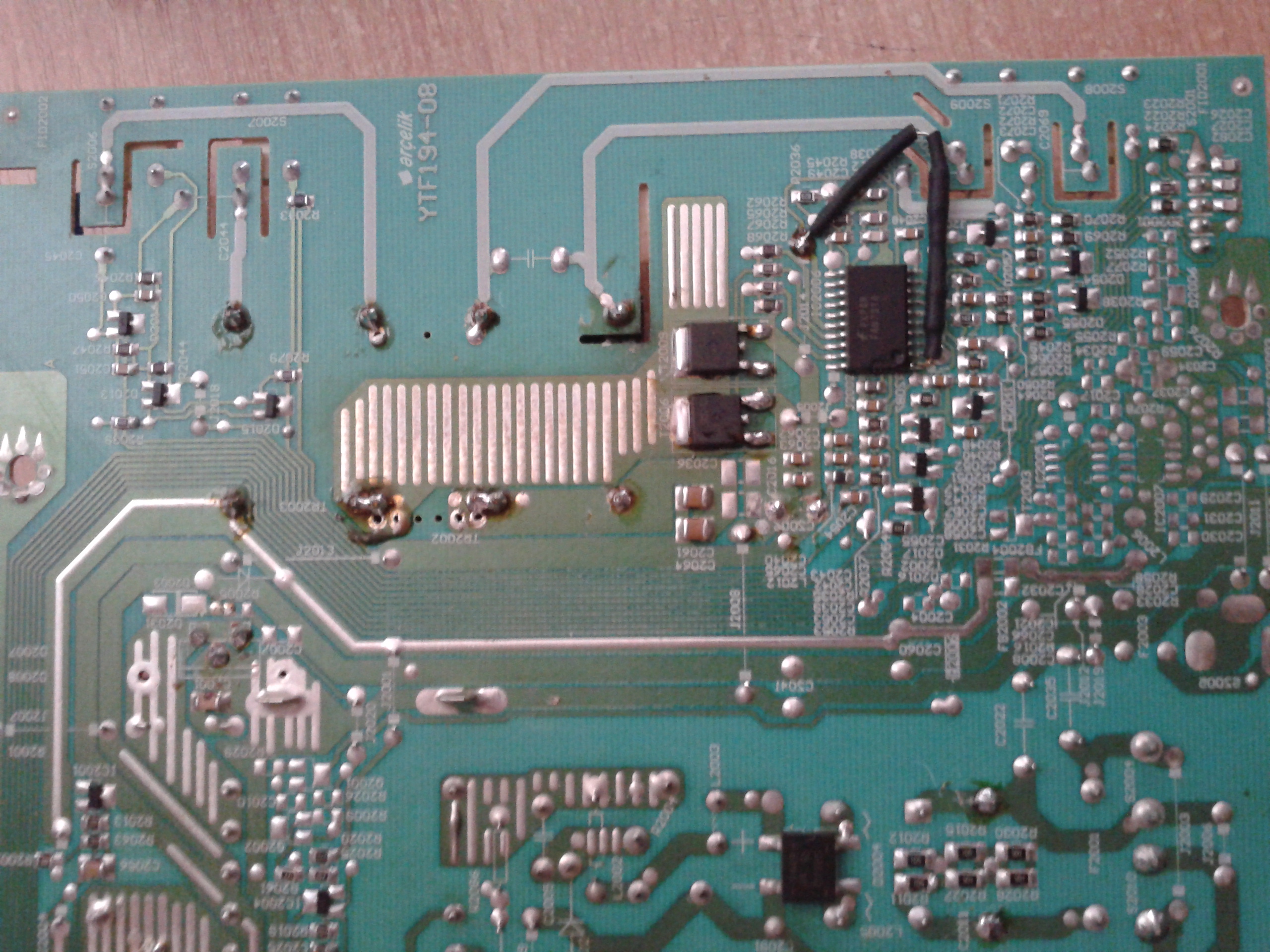

                I upload new pictures of back side.

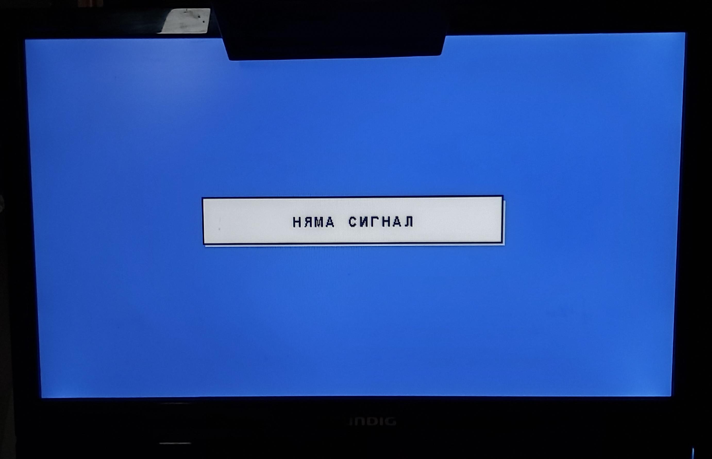

                      Are you 100% certain that all the lamps were working. With the overide resistor added did the lamps stay on until you turned off the set or did they turn off by themselves?
                      Yes, i`m sure and they work.
                      Here are 2 pics with 14secs between them + some secs before
                      start camera

                              The bottom left of the board in your picture looks kind of tore up.
                                  Which side - solders+smd or PTH elements?
