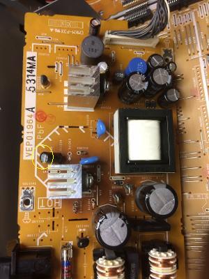

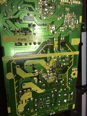

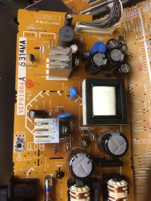

        So..lost power again on vcr. I used the hair dryer heat to bring it back, to no avail. Now, my voltage testing does not bring power. C1108 is marked on board, but there is not a cap there.I am getting voltages on one side of board..but not the other. Attached pics of power supply board. thanks Al

          The half of board with ac cord ...gets power the other side does not

                Re: Panasonic DMR ES30V Power supply problem
                It might help to upload a larger picture than the thumbnail. Try replacing the cap beside the heatsink in the primary side
                  also check the back of the power supply for bad solder joints, specifically on heavy or heat sink mounted parts. And as RJ already said, change that little cap next to the heat sink.
                    I would also check the solder joints in the area where it has been getting quite hot, by the two large caps and transformer.
                          OK...I received all the caps, and first replaced 68uf 35 v next to heat sink. She powered up. I left it on for a few hours then unplugged. When I plugged it back in no power. The heat sink was very hot. My question is...should I replace all the caps, or should I suspect the IC mounted on heat sink? Thanks Al
