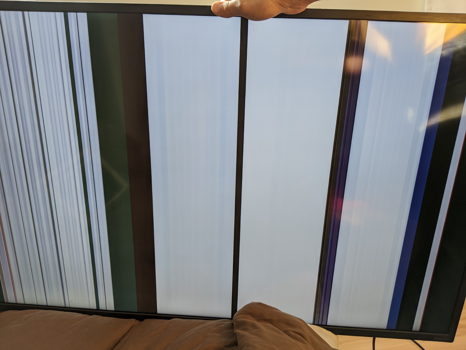

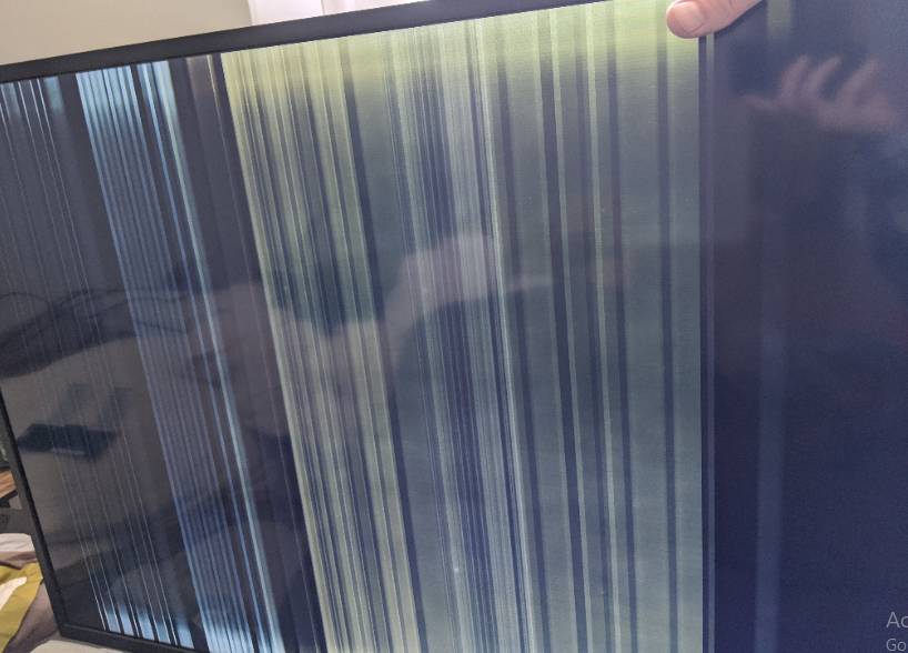

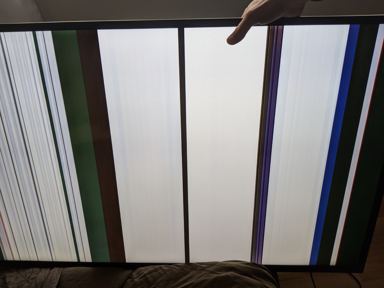

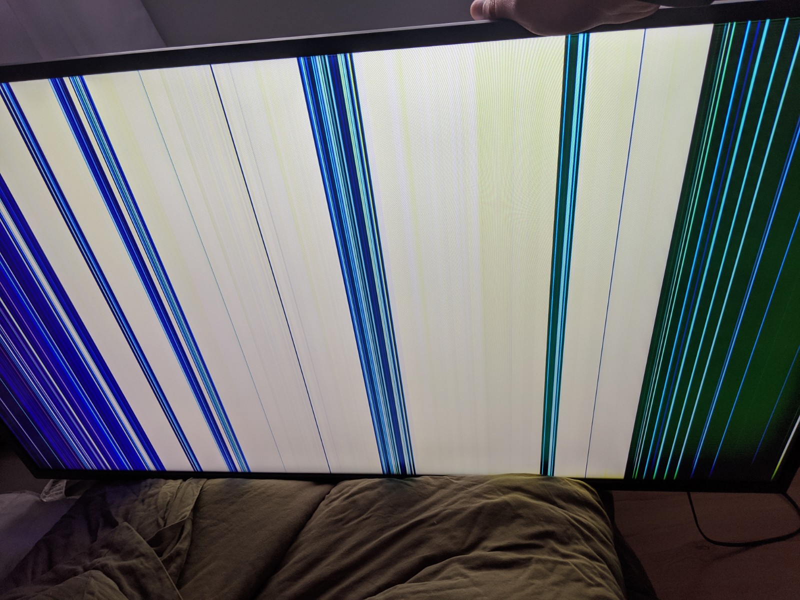

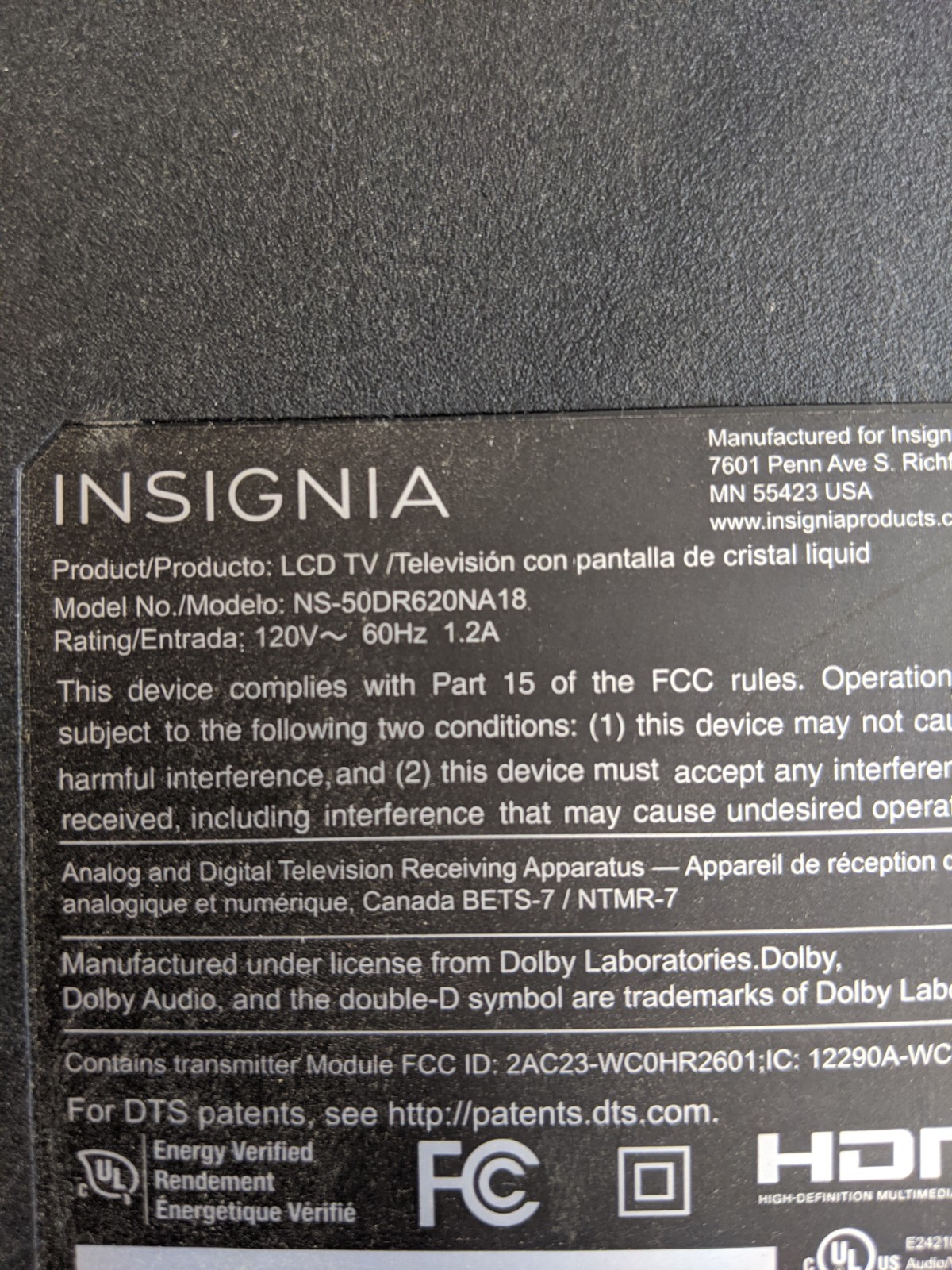

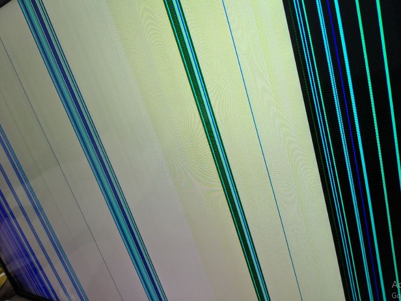

    Insignia NS-50DR620NA18 has vertical colored lines, no picture. swapped out tcon board but same issue.

    Re: Insignia NS-50DR620NA18 vertical colored lines no picture
    Welcome to Badcaps!
    Can you give some history on this TV unit?
    - Did this just happen one day?
    - Did you get this used?

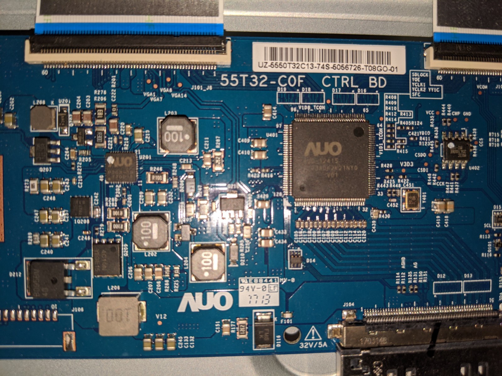

    - What's the ORIGINAL T-CON part number, whats the NEW T-CON part number?
      Purchased used. Trying to fix. New tcon and old tcon are the same as I made shopjimmy check 55t32-c0f. The menu seems to scroll behind the bars/lines. Can not see though. I think the tv is 3 years old.

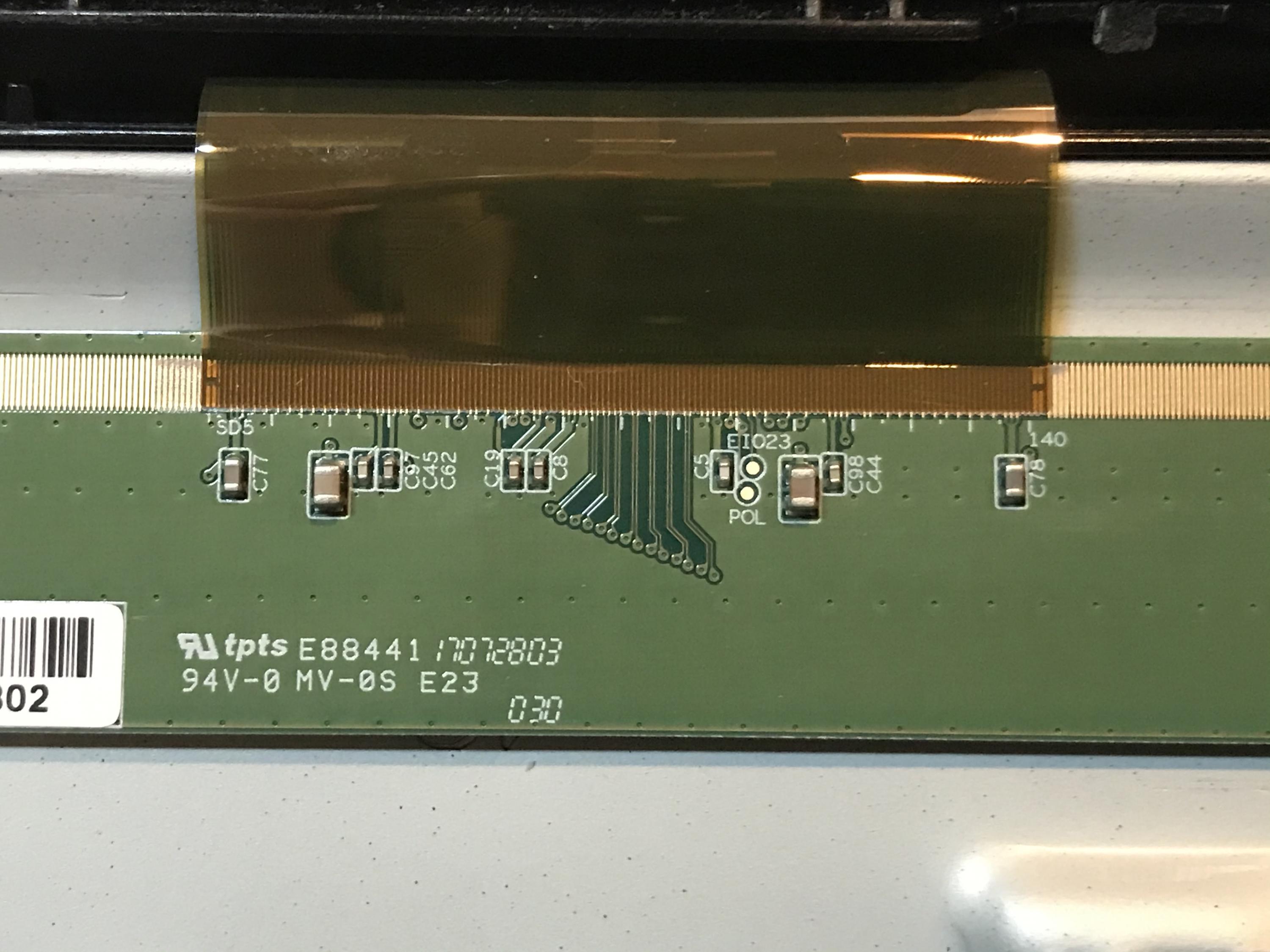

          Any idea if the original owner took this thing apart?
          With the back cover removed and the TV on, what happens if you lightly press on the flex cables between the LCD display and the narrow PCBs that connect to the LCD? Does it change the output behavior?
          (Example picture attached).
            with my experience, vertical colored lines are cause by main board failures. tcon board issues are usually either no picture or half of a good picture. from your picture however, they didnt look like colored lines i usually see. being that you replaced the tcon, that leaves the main board and the display panel itself. main board is cheaper, id start there.
              I applied pressure to the PCBs and there was not a change.

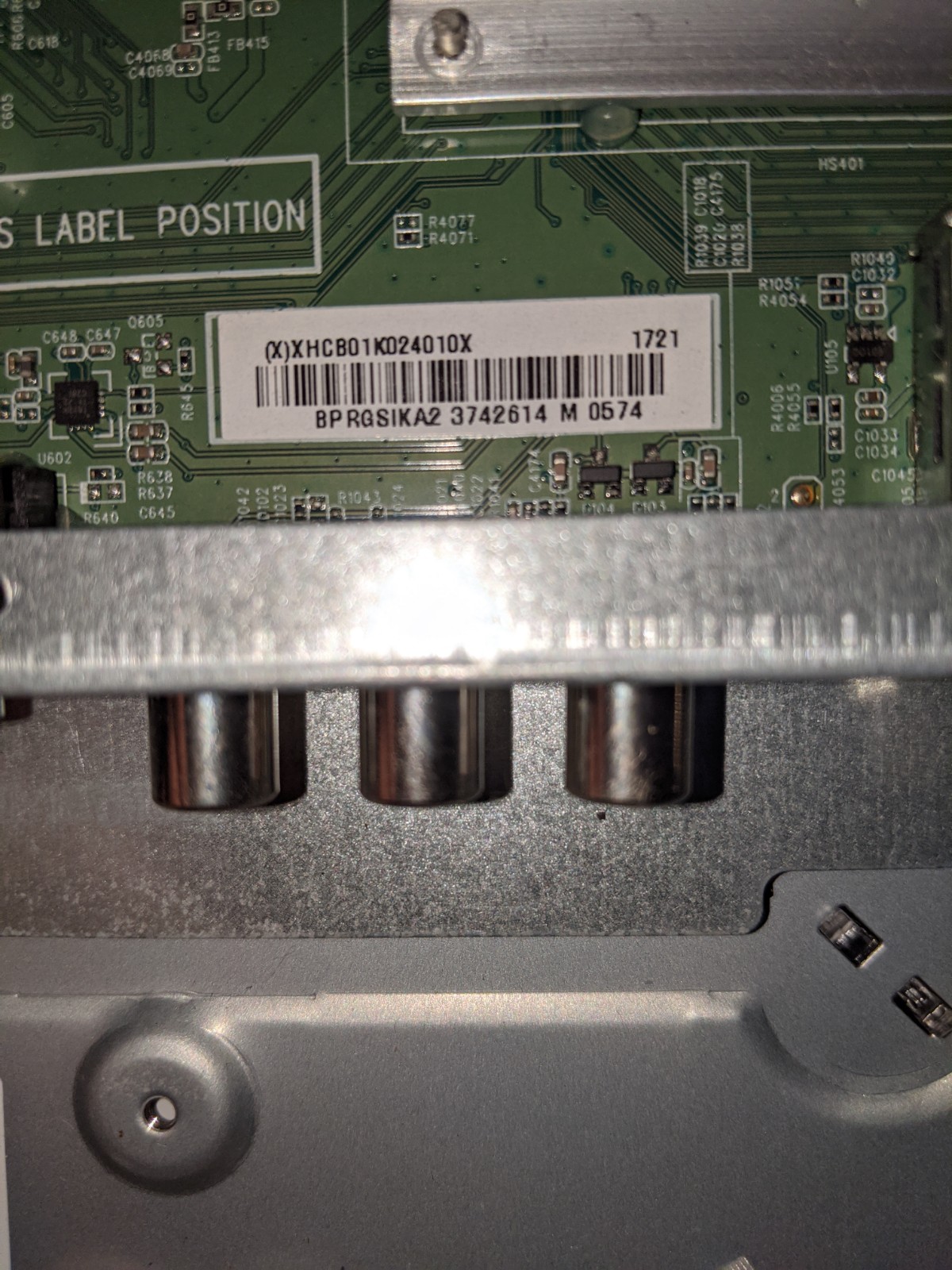

                Replaced main board and tcon. same issue. possible new tcon is bad?

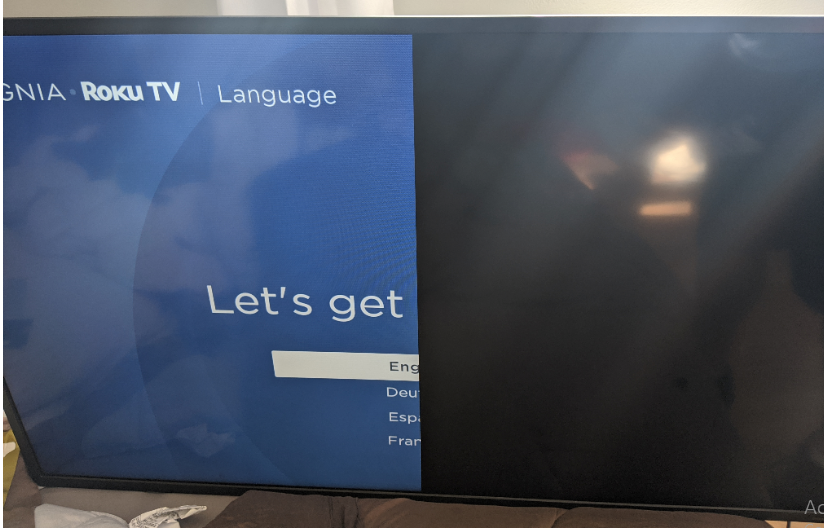

                  Vertical lines are usually signs of a bad panel. You can try powering up one side of the screen at a time by disconnecting the ribbon cable and see if one side shows a good picture.
                  • daxlw
                    daxlw
                    • Apr 2020
                    • 17
                    yes. Half the panel works with one side ribbon off.
                    Is it worth fixing?
                    • nomoresonys
                      • Jan 2013
                      • 12128
                      • U.S.
                      What do you get when you do the same to the other side??
                      • daxlw
                        daxlw
                        • Apr 2020
                        • 17
                        I get the colored vertical lines on that half
                          Did you remove the metal frame of the LCD panel assembly to get the tab bonding board (as shown on post 5) and inspect them? Right now the problem is the LCD panel not T-CON or main board.
                          Can we the whole backside of the TV showing all the boards?
                          Is the tab bonding board located on the top or the bottom edge of the LCD panel?
                            Check the MLCC caps on the driver board between the tcon and panel for low ohms, ohm mode with tv unplugged from power.
                              The narrow pcb's are on the bottom. I pressed them and it did not have any change. I will inspect again. I do not have any way to detect ohms.
                                Big problem when it comes to testing and finding out what's wrong, I'd grab a digital multimeter from one of the big box stores, about 10 bucks or so.
                                    There's a ton of posts here regarding that, basically if you find one reading off, involves removing the small MLCC caps on the board one at a time and checking it and rechecking the rest on the board, til you find the right one, they are in series so one bad one can make others read bad. It could also be a different problem on the panel but many times it was just one of those silly little caps at fault.
                                        Well, if you do not have meter to check the resistance of the caps on the tab bonding then you will have bigger problem removing the bad caps and install new caps due to lack of tools and experience.

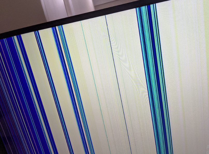

                                          Insignia NS-50DR620NA18 w/ large vertical lines & no picture
                                          by srs
                                          I'm not sure what to do next and came here since y'all helped me fix a 50" plasma TV back in 2014, which is still working!
                                          A friend gave me an Insignia NS-50DR620NA18 50" TV that suddenly developed large vertical lines on it. He said he had no idea what might have caused it and has replaced it with a larger TV. He was going to throw it away.
                                          I did not notice any bulged or leaking caps on any board, the voltages produced by the power supply match the voltage that the pins are marked. The backlight leds are working. I have tried cleaning the ribbon cables...
