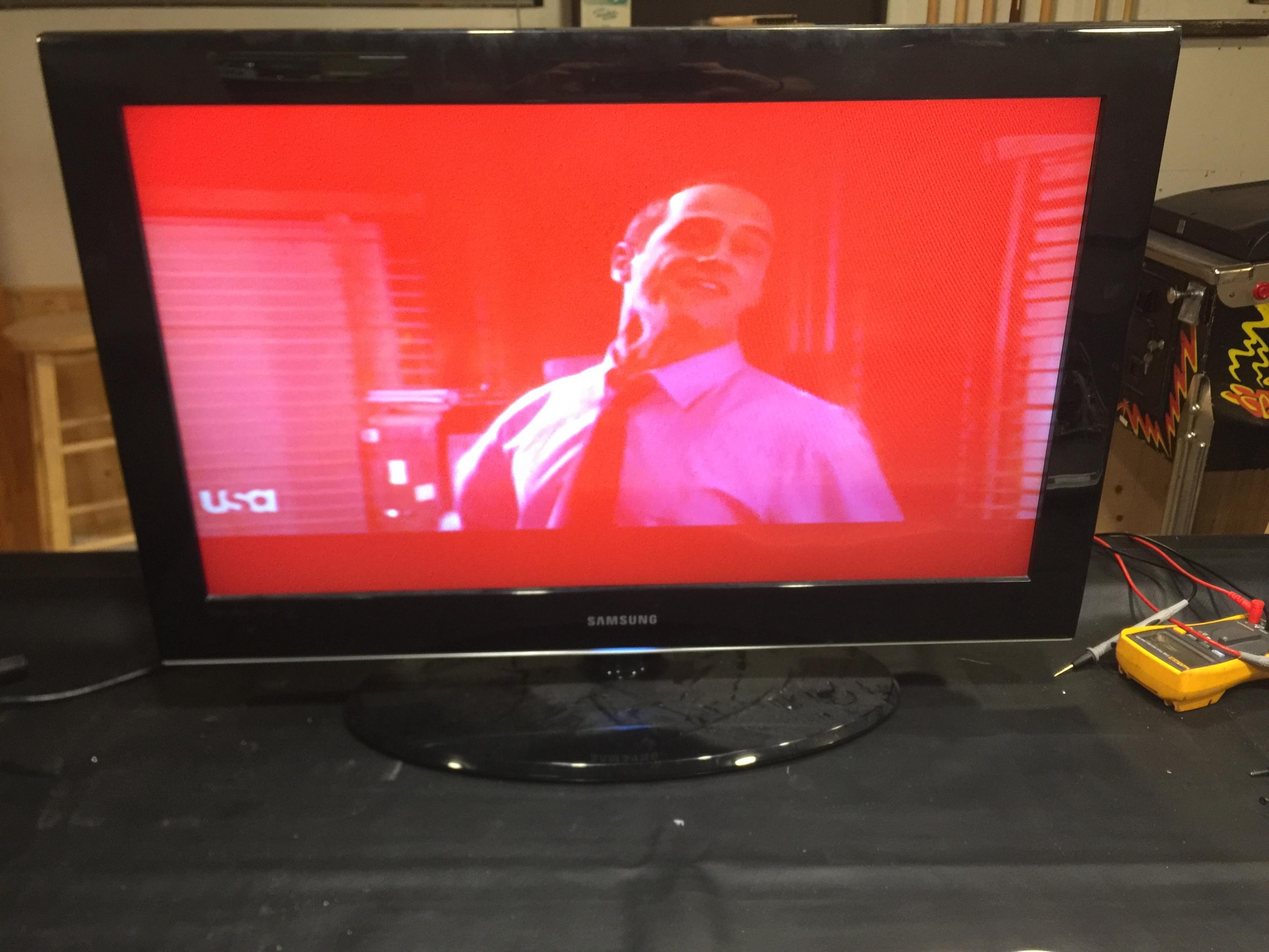

    LN-32A550P3F No screen and squealing

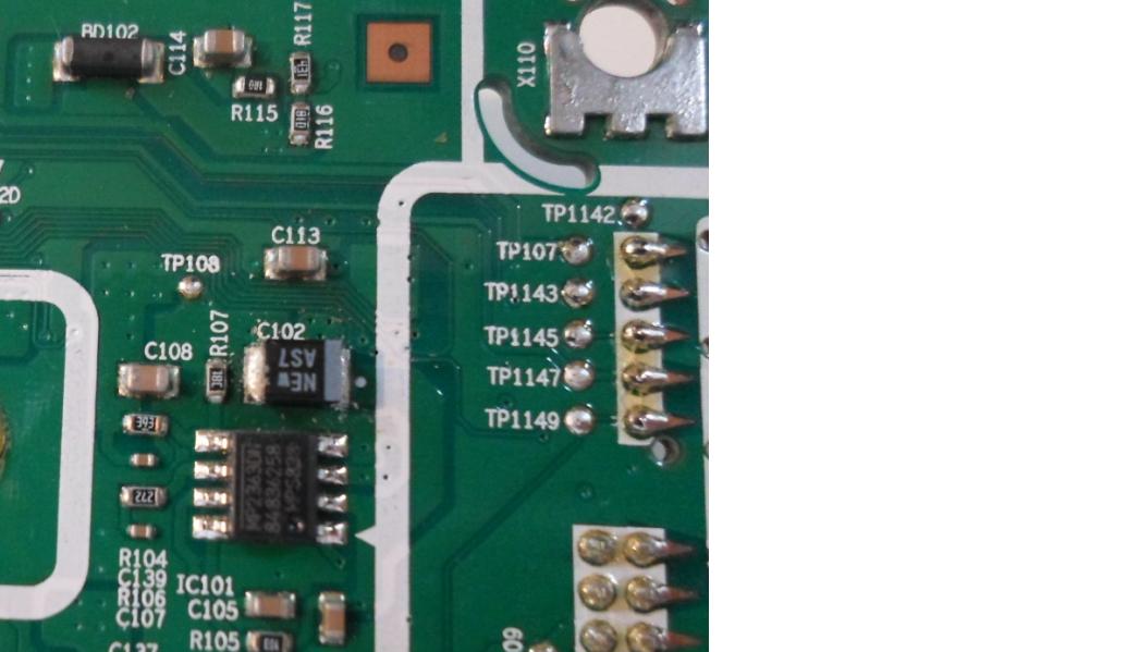

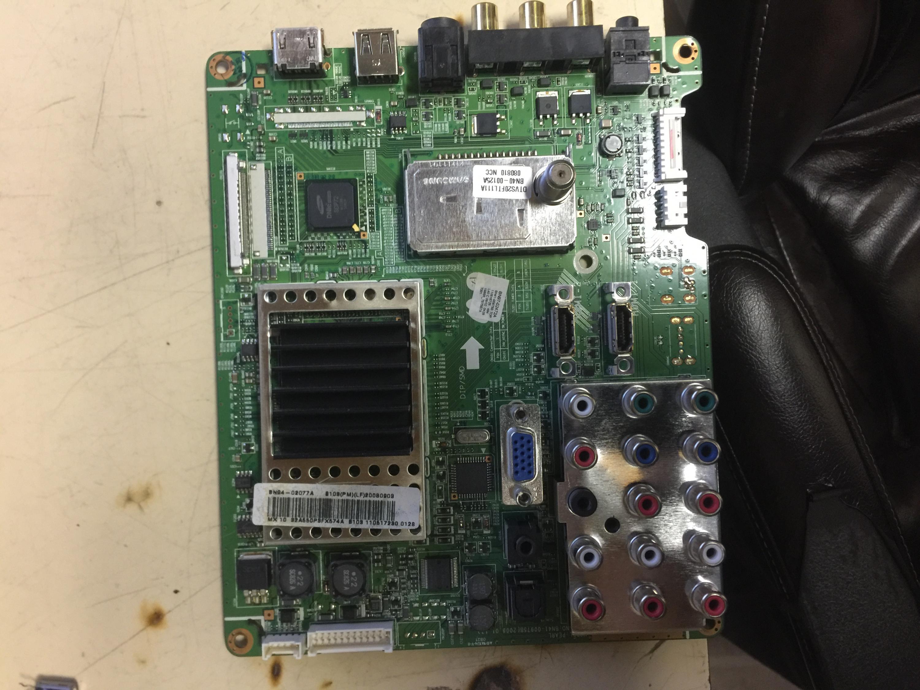

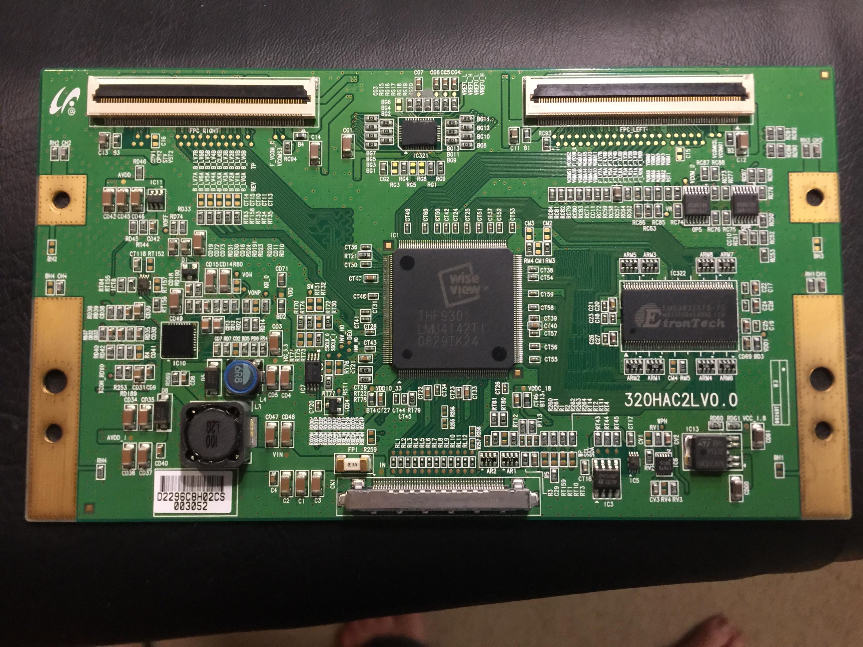

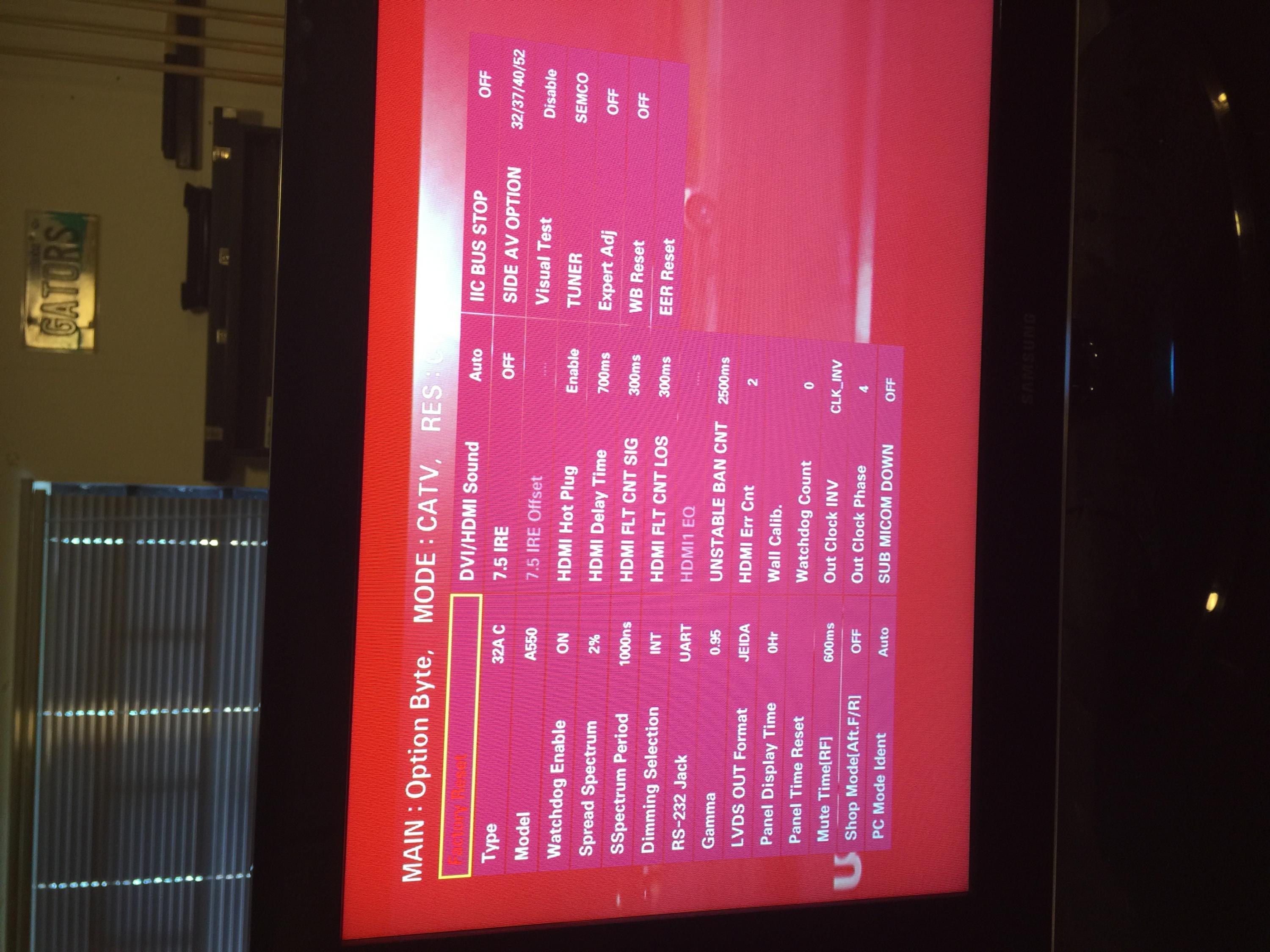

    The blue Samsung led in the center at the bottom lights up and the red power light blinks but no backlight. Then after a few seconds, it starts to squeal. I changed all the power supply caps even though they were not bulged. I metered the coils on the inverter board, and all reading fine. So I found another mainboard that I had. I installed it and went into the service menu to change it to the model I that I am working on. Well now the tv turns on, it doesn't squeal and I get video except the video is red. Is the tcon bad?

    Search C102 in the forums since this cap on the main board can cause squealing and green screen.

      Re: LN-32A550P3F No screen and squealing
      But I replaced the main board and now I have a red screen. Should I find an old Samsung mainboard and replace C102 on the board I pulled out?
        It could be a mismatch between the main board and t-con, or it could be a service menu setting that is still wrong. Check the other settings in the service menu IE: LVDS OUT Format, Panel Option.
        The cap at location C102 is only on a certain main boards, not all of them.
        This thread has pictures of the main board and the model: https://www.badcaps.net/forum/showth...highlight=c102

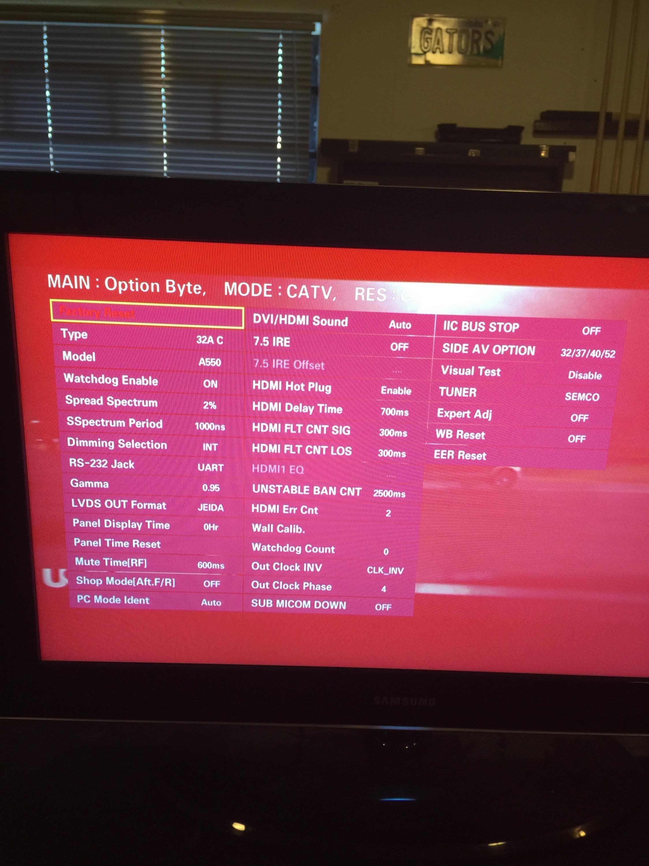

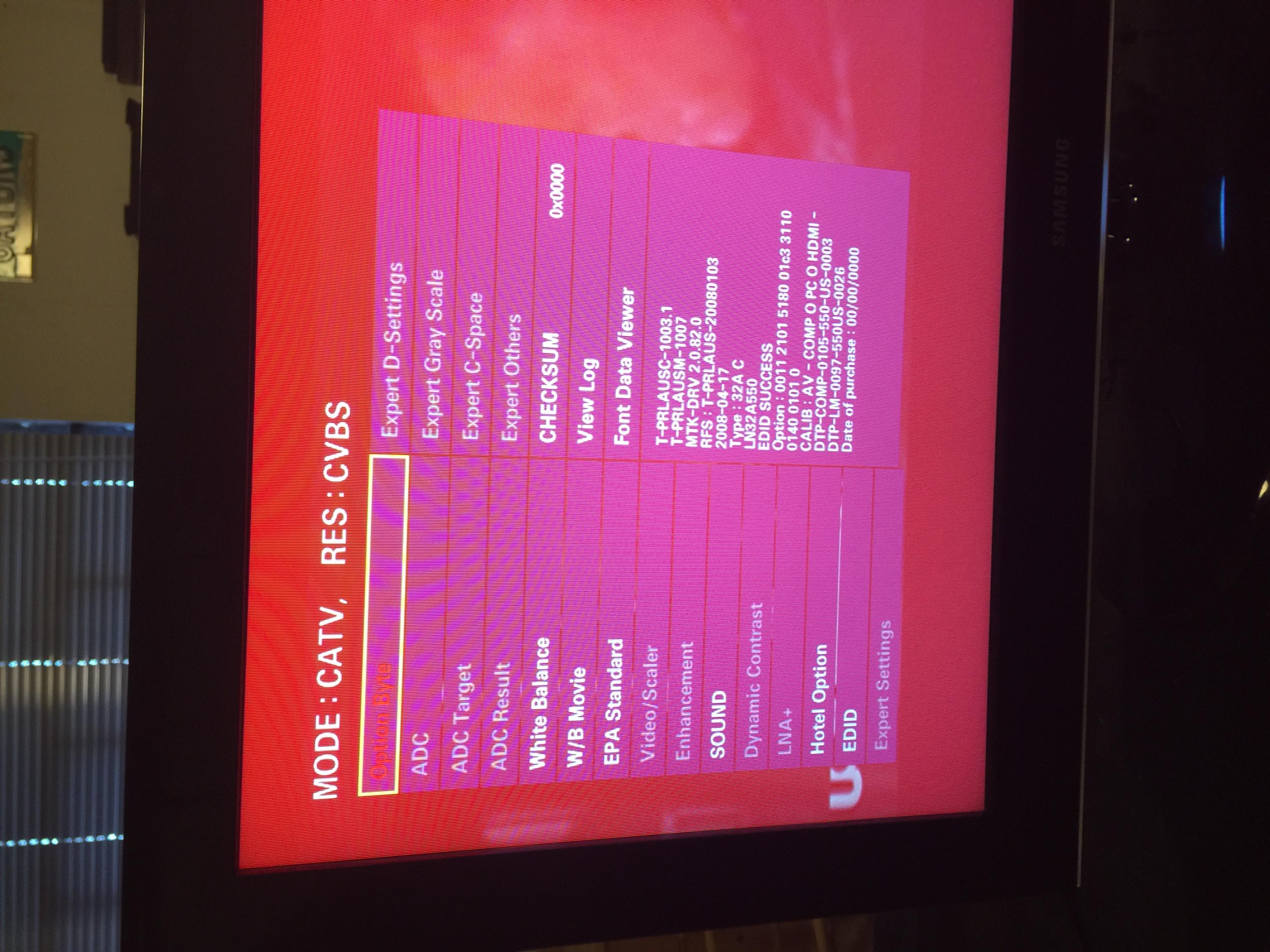

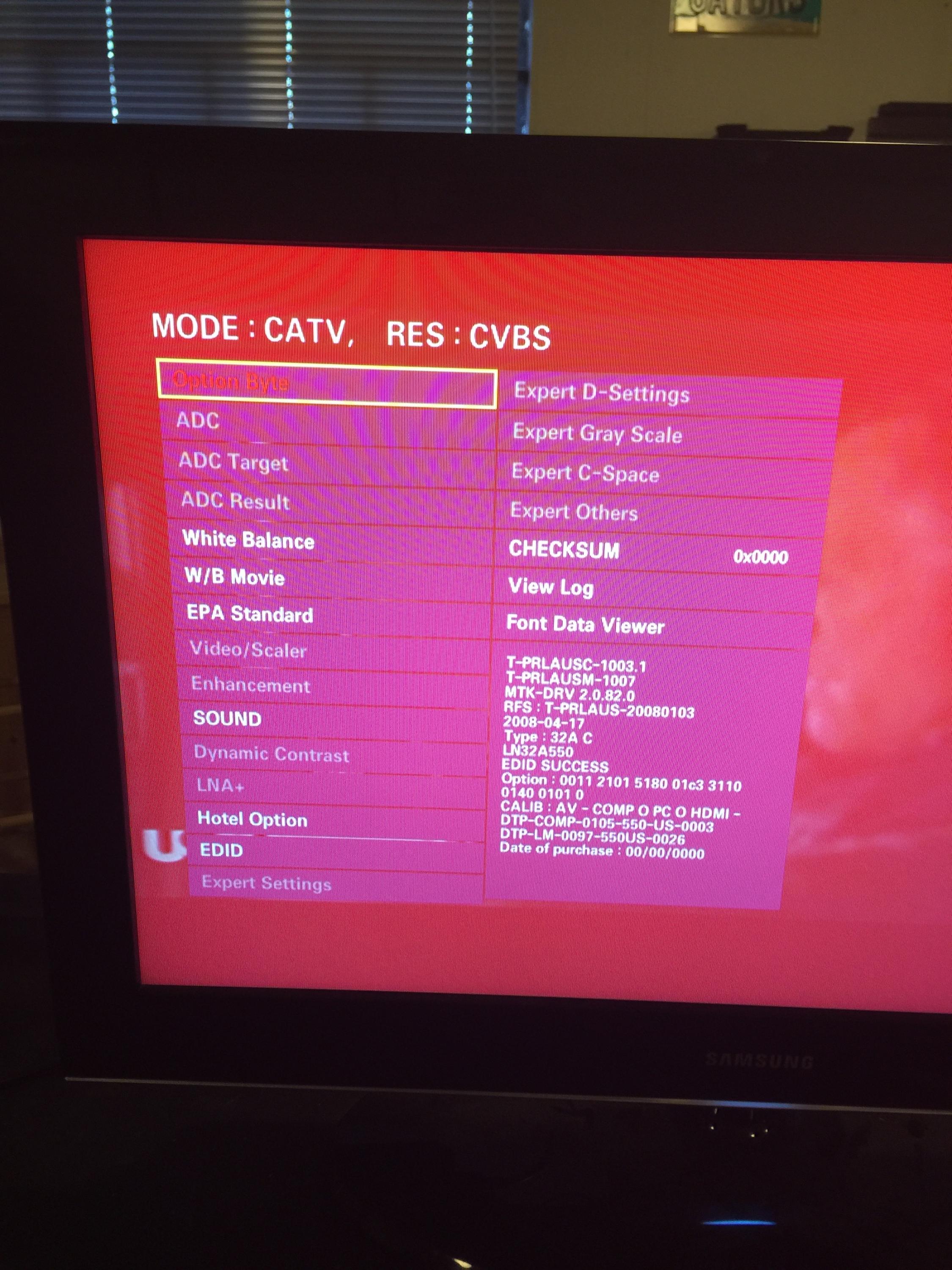

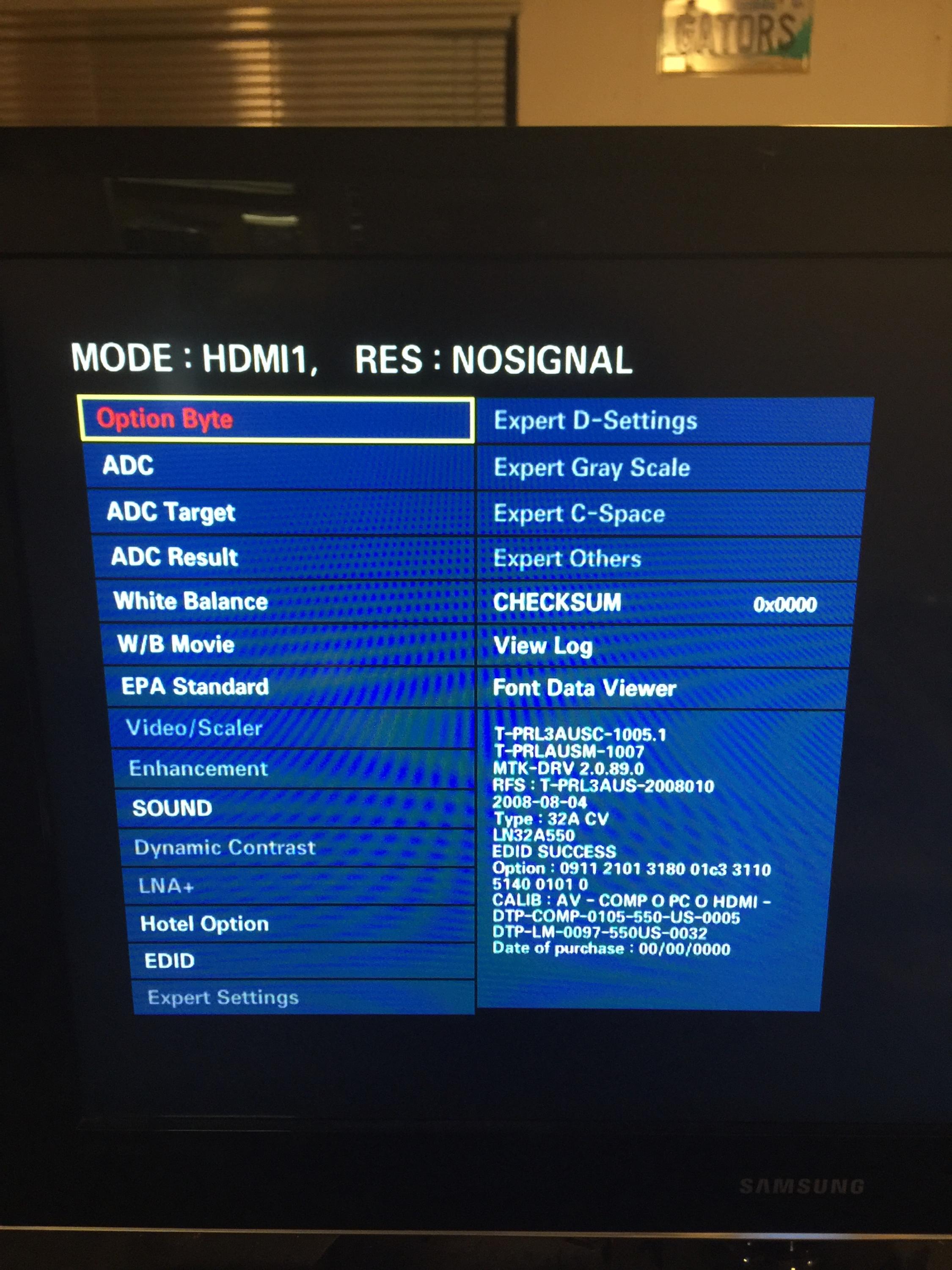

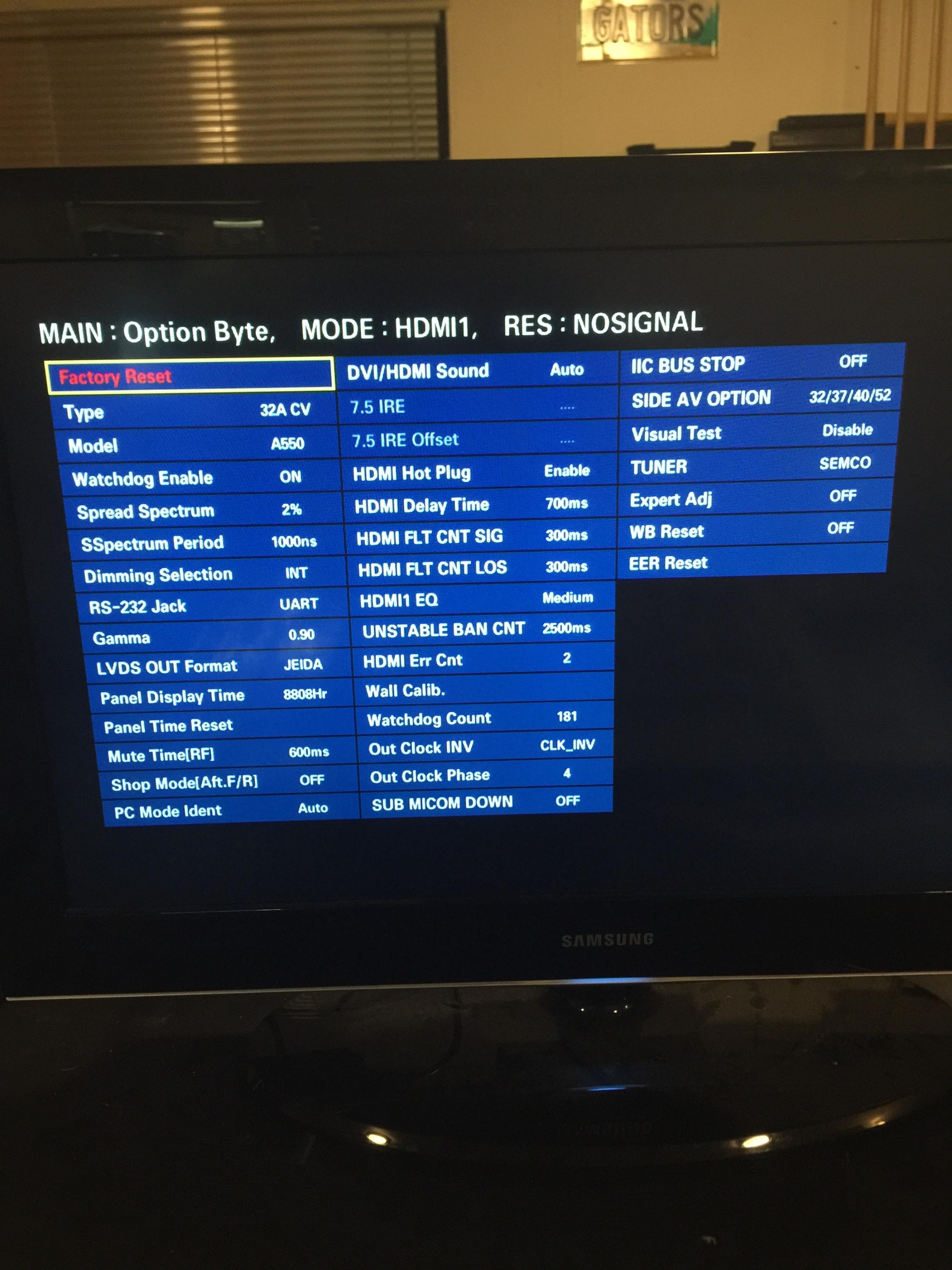

            Do these settings look right? Maybe I'm missing something.
            • nomoresonys
              • Jan 2013
              • 12312
              • U.S.
              Too hard to see the settings, it's sideways.
              • dcapper
                • Dec 2013
                • 496
                I know I'm trying to set it straight. Let me repost.
                • nomoresonys
                  • Jan 2013
                  • 12312
                  • U.S.
                  Maybe the LVDS out format, make note of what it is now, see if you can change it, on some when you change it the picture clears up and you can see it right then.
                    I ended up doing Budm's mod on the original board from the other thread. The tv is working perfectly now! The only difference I see is the 32A CV vs. 32A C and Gamma .95 vs. .90

                      So are you saying that your main board DID have the cap at C102?
                      • dcapper
                        • Dec 2013
                        • 496
                        Yes the original one had the cap so I did the Budm mod. I tried replacing the mainboard originally with one I had but I got the red screen. I couldn't get rid of the red screen so I tried the mod and it worked.
