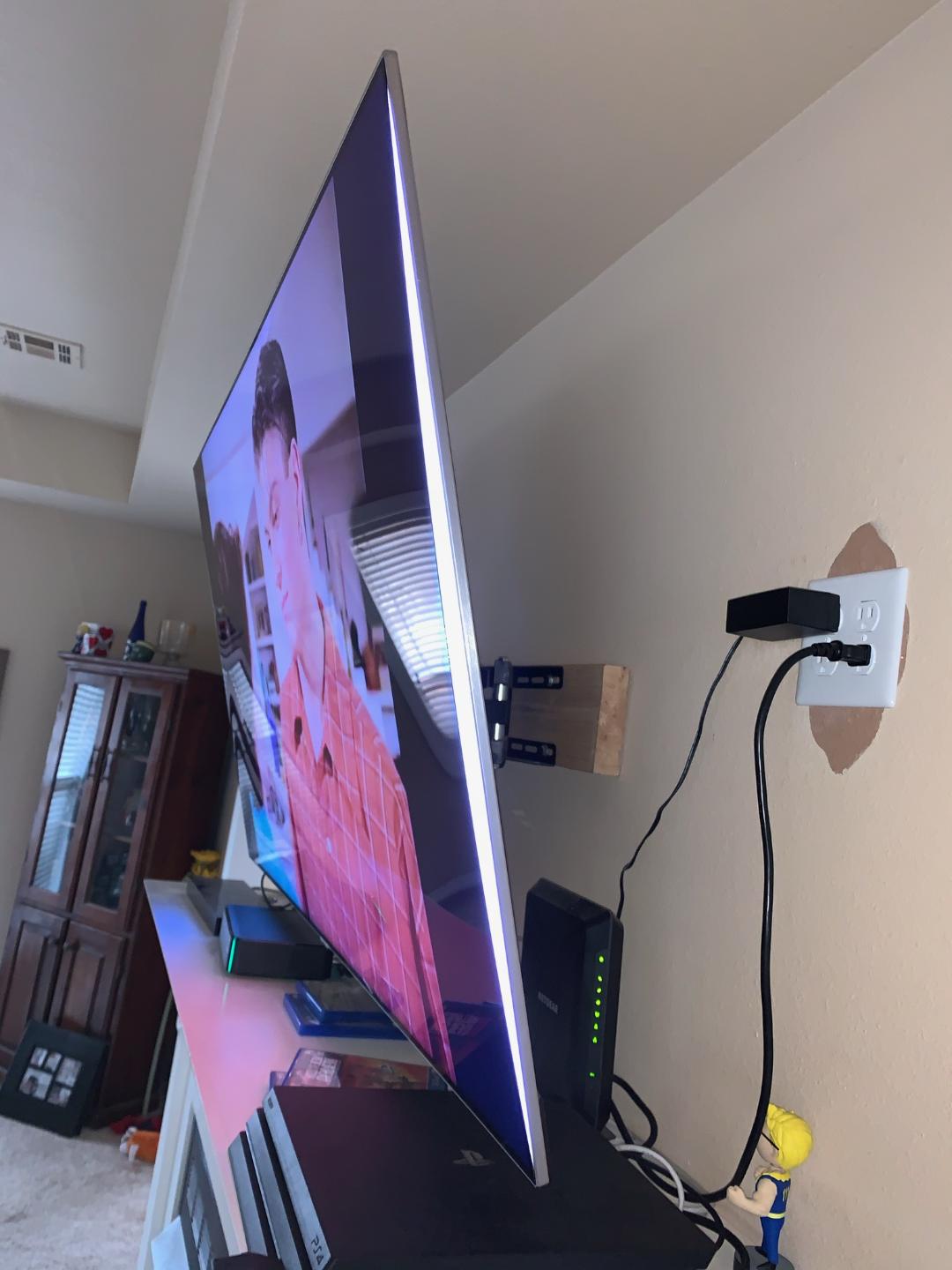

        Backlight repairs are by far the most riskiest repair but if you examine how the panel lays down into the plastic trim properly and use tape or a marker to show where it was originally positioned it will save you a lot of headache. TCL's seem to be the ones we have to be more careful with as they use cheap plastic trim and that panel has to lay down flat in those slots and there is very little room between the plastic trim and the bezel. Make sure that panel is laying properly in that trim before you put the bezel on. Now we are seeing Qled bezeless Samsungs coming in and we refuse to do backlight repairs on them due to the fact the panels are taped in with a 2 sided adhesive tape on the sides and top. That's all that is holding that panel in. Even a thin bezel is better than no bezel at all especially since the panel picture still has a gap of about 1/8" thick with no picture all the way around. As soon as Yuppie Scum puts that Tv above his fireplace that adhesive gives way and the panel starts bowing. Poor engineering Samsung.
