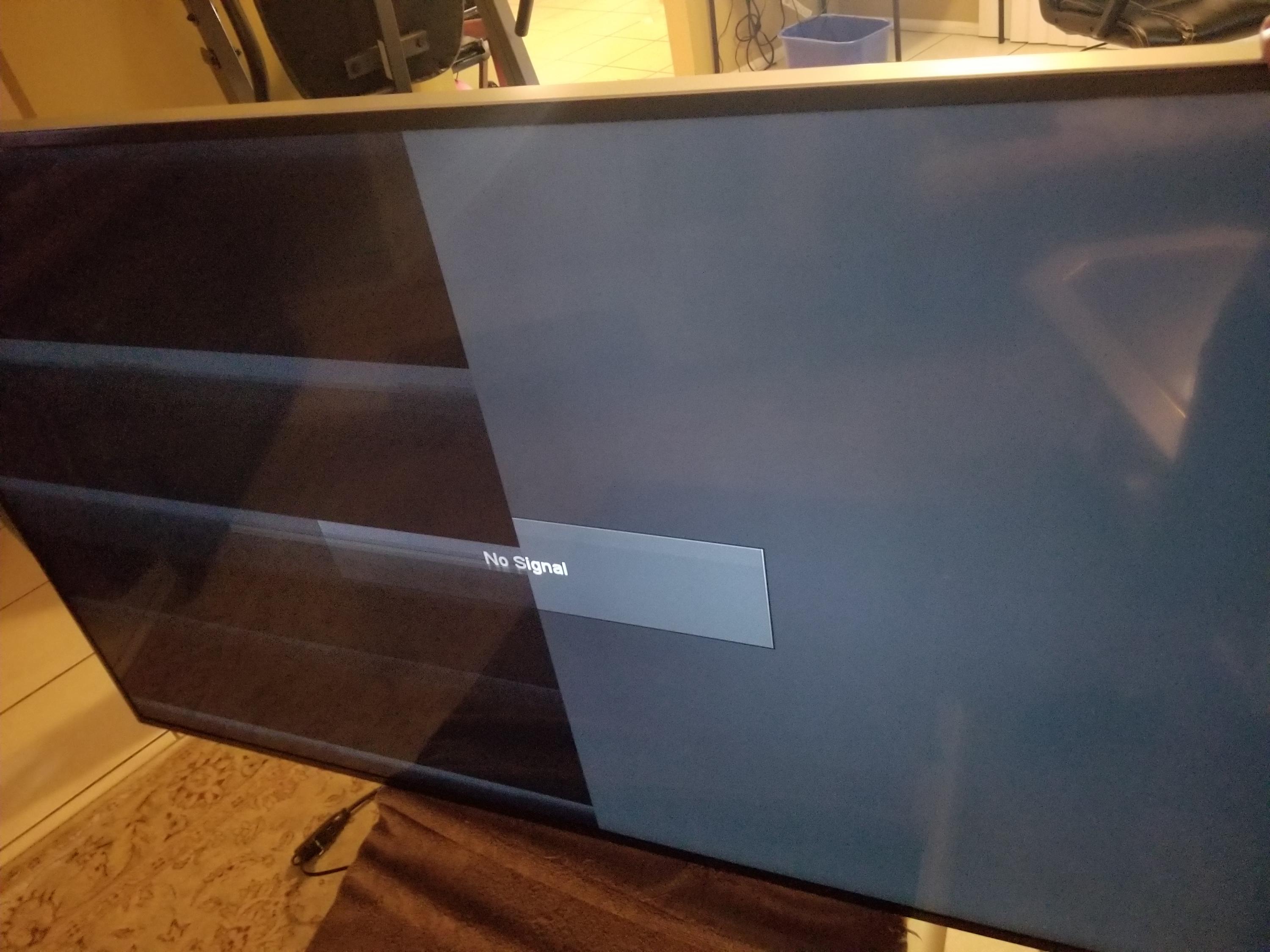

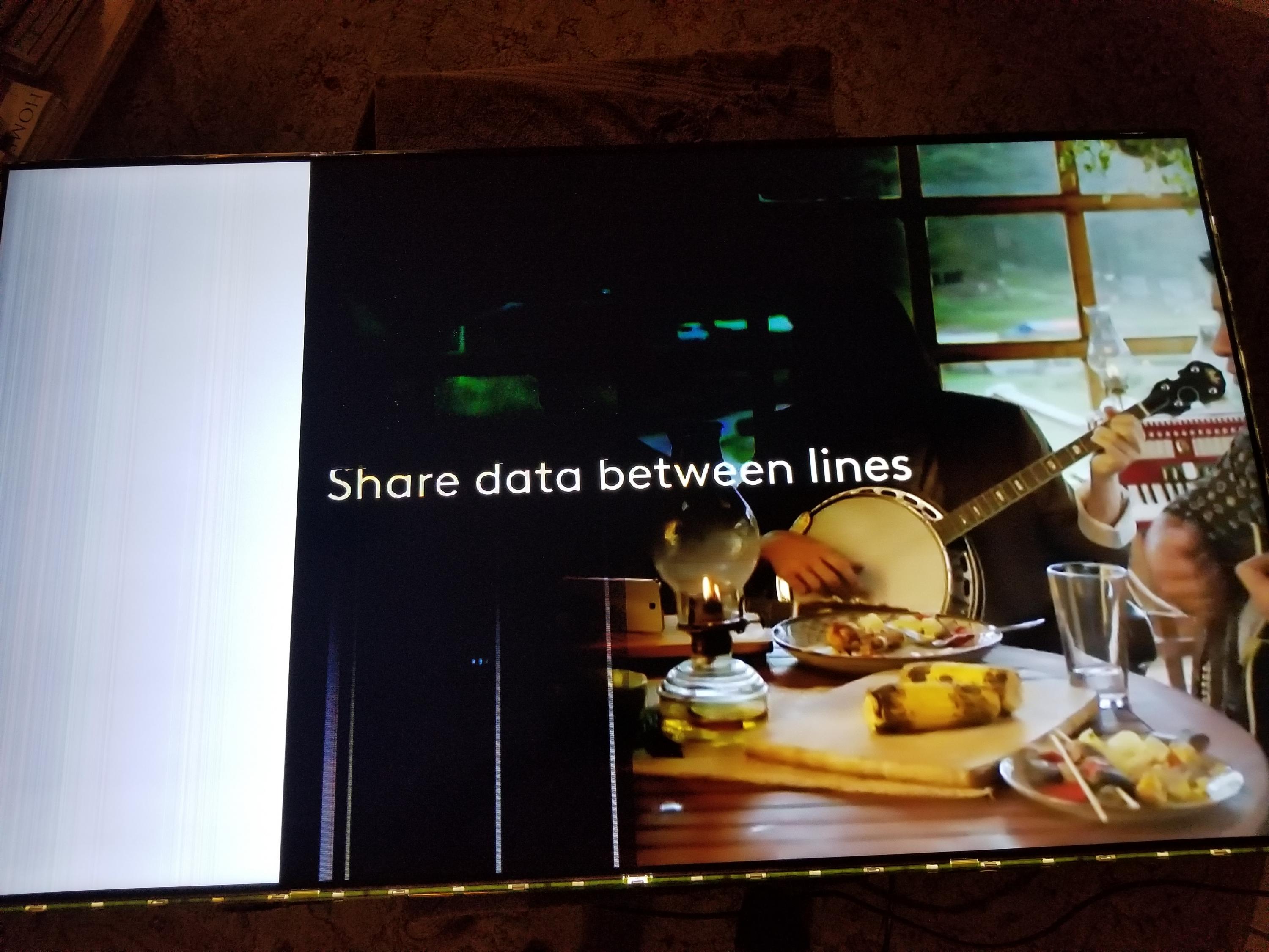

        OK so panel is bad on this one but has the side tabs to remove. This one is a little different though. With all 4 ribbons going to the panel connected, I have a good pic on the right half, and ghosting on the left.
        If I remove the 2 ribbons on the left side, I don't get a good pic on the right side.
        Only when I remove the last ribbon furthest to the left side, do I get a good half picture on the right.
        Typically I've needed to remove both "bad" side ribbons to make a good pic on the good side.
        Does this tell you anything? My inclination is to remove the side tabs on the left side, but I want to make sure first!

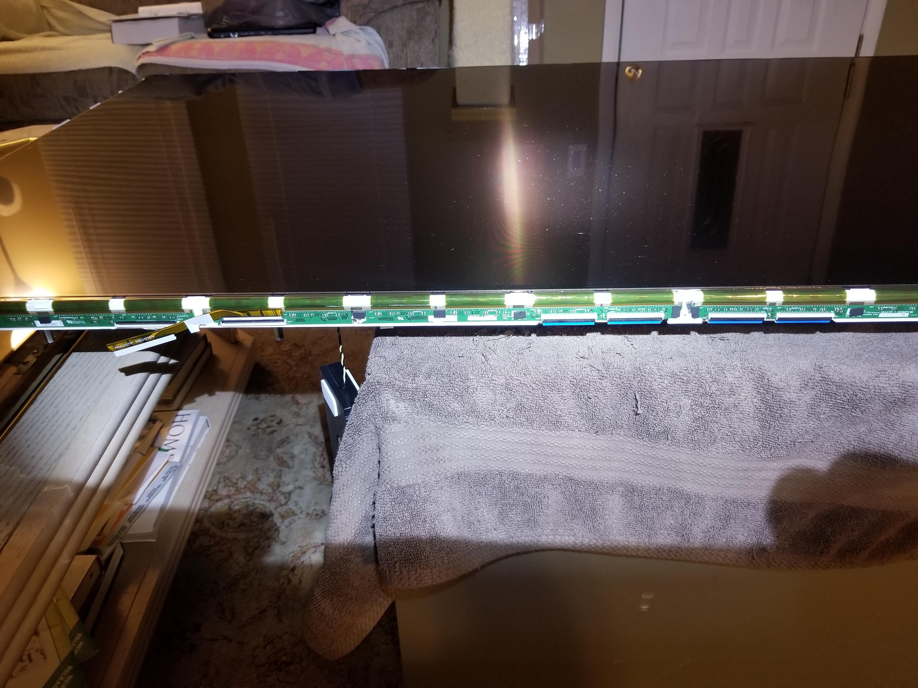

            do the edge boards along the bottom have "two halves" ... ie. are there two per side? IF so, there should be a "U" type interconnection ribbon between the two. It is unclampable. You can use that point to do the same "disconnect" test to see what the results are like. this may confirm whether you have a problem with any side tabs.
            one other thing that you can try is swapping the "bad" cable for the one on the opposite side to see if the problem moves.... which may mean you have a bad cable. Just a further check before going down the "remove tabs" mode.
            still one further check.... since you had found bad caps, you might have some more on the bottom edge boards. you can do some resistance type measurements at the pin of the "bad cable" (going towards the pane) and check / compare those with the equivalent on the opposite side... see if anything jumps out at you. you might get lucky and find a bad smd cap in the edge board as oppose to a bad tab... but the picture that you posted with horizontal lines does appear to be a side tab problem.

              I disconnect each of those "U" cables one at a time and still don't have a good pic on either side. Only with everything connected I hadve a good right half, and also with the far left ribbon from t-con to panel.
              If I have that far left ribbon disconnected, and then disconnect the left side "U" ribbon too, I get bad pic on both sides again.
              Didn't find any shorted SMD caps on left side bottom boards.
              So should I just tear off the left side tabs?? Nothing I've tested gives me any confirmation but maybe I'm missing something??

                        hmmm :-( something certainly not right. With all tcon to panel cables connected and with the one "u" disconnected (on the side that you think is bad", you should be getting something as the "U" disconnects the "1/4" panel along with the corresponding side.
                        I am having trouble reading / understanding your reply / post ... can you re-read and redo the test?

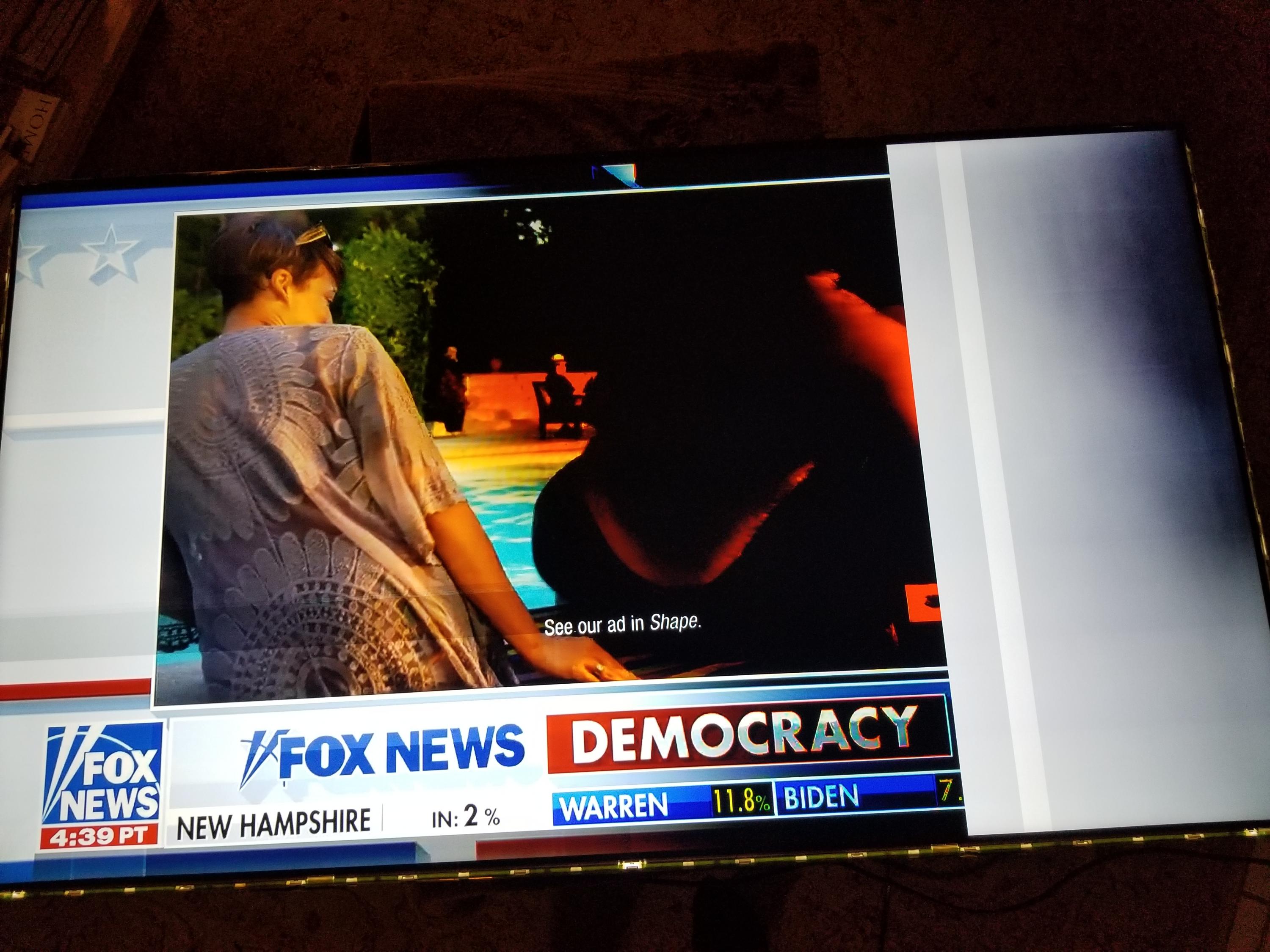

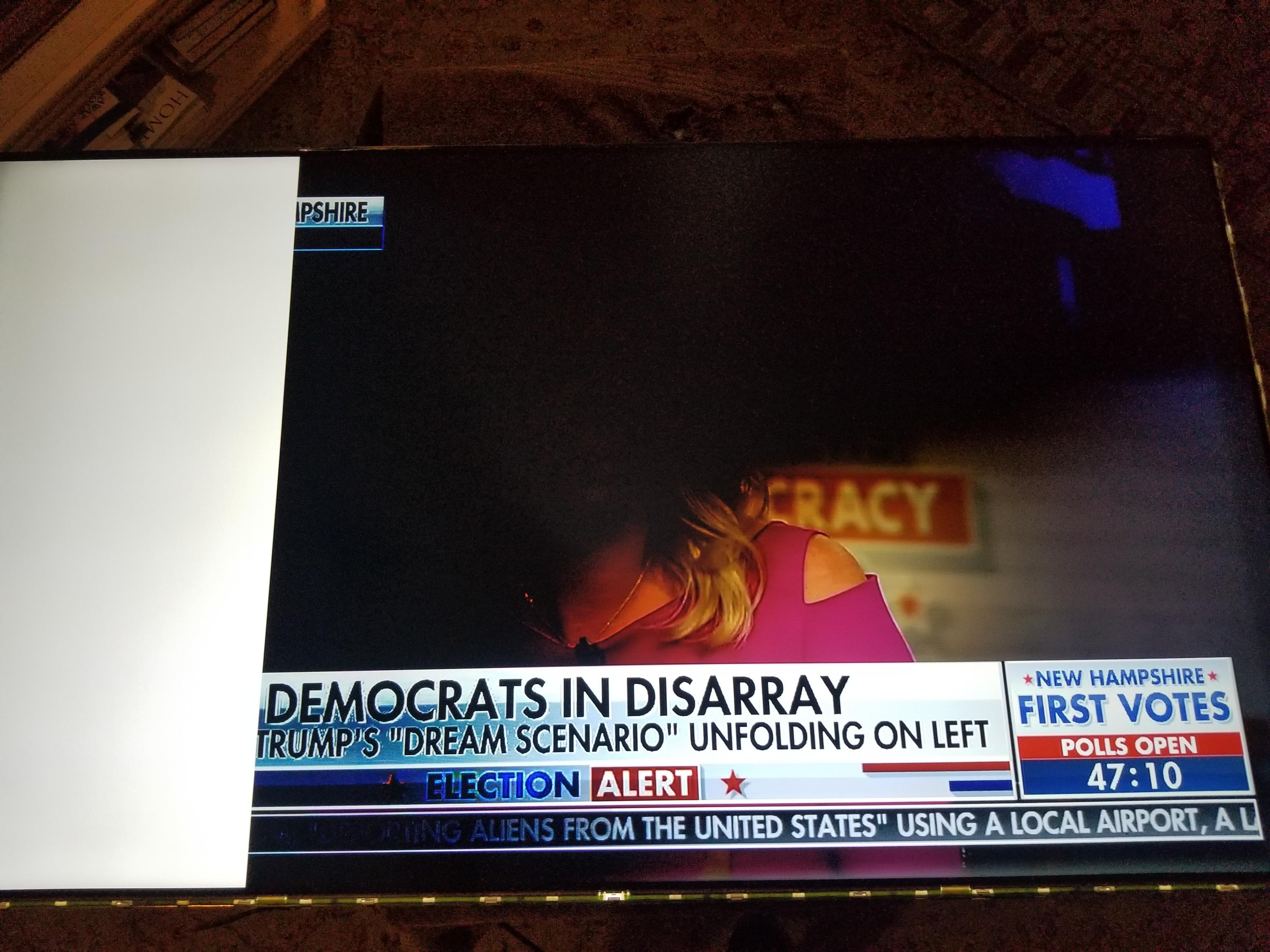

                          Sorry I know it gets confusing.. Here's the picture with all t-con > panel ribbons connected, and the left side "U" disconnected.
                          • budwich
                            • Jul 2015
                            • 3097
                            #33
                            Re: Vizio M60-C3

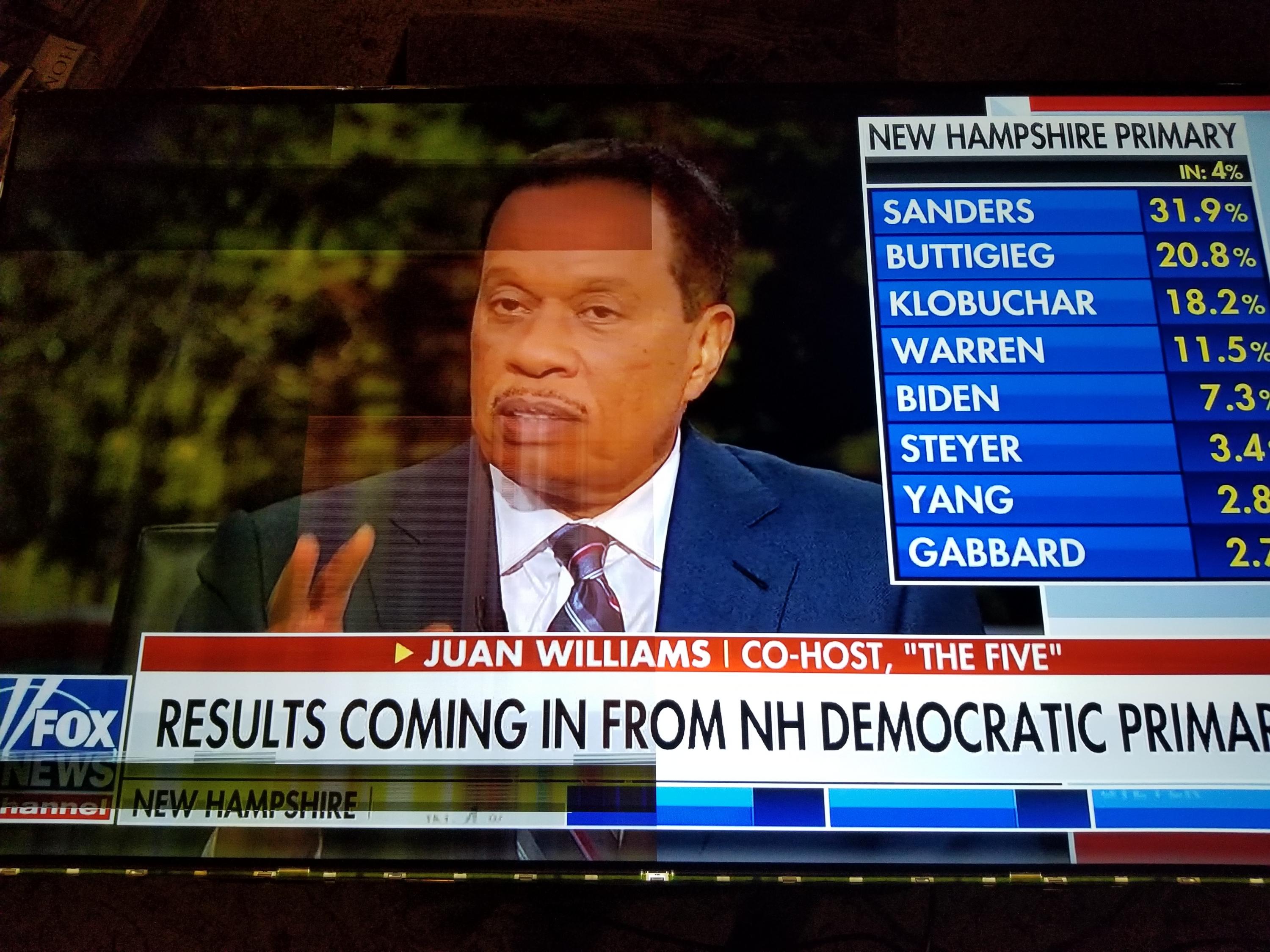

                            ok,,,, that helps a bit but the picture of the panel isn't the whole panel so I can't judhe what is happening on the whole panel at this time and setup.
                            Having said that, it does appear to be a side tab issue. you might be able to confirm that by physically looking and touching the tabs on the side to see if you can confirm an issue.
                            NOTE: good picture at this point is somewhat relative.... you are not going to get a perfect picture in this mode at this point. These types of tests are used to isolate panel areas so you can determine where a problem might lie. Your previous picture(s) showed some dark half of the screen along with horizontal lines. This last picture shows a white screen and no lines (although that might be hard to see because of the choice of input... a screen using a known smpte color bar pattern is better).

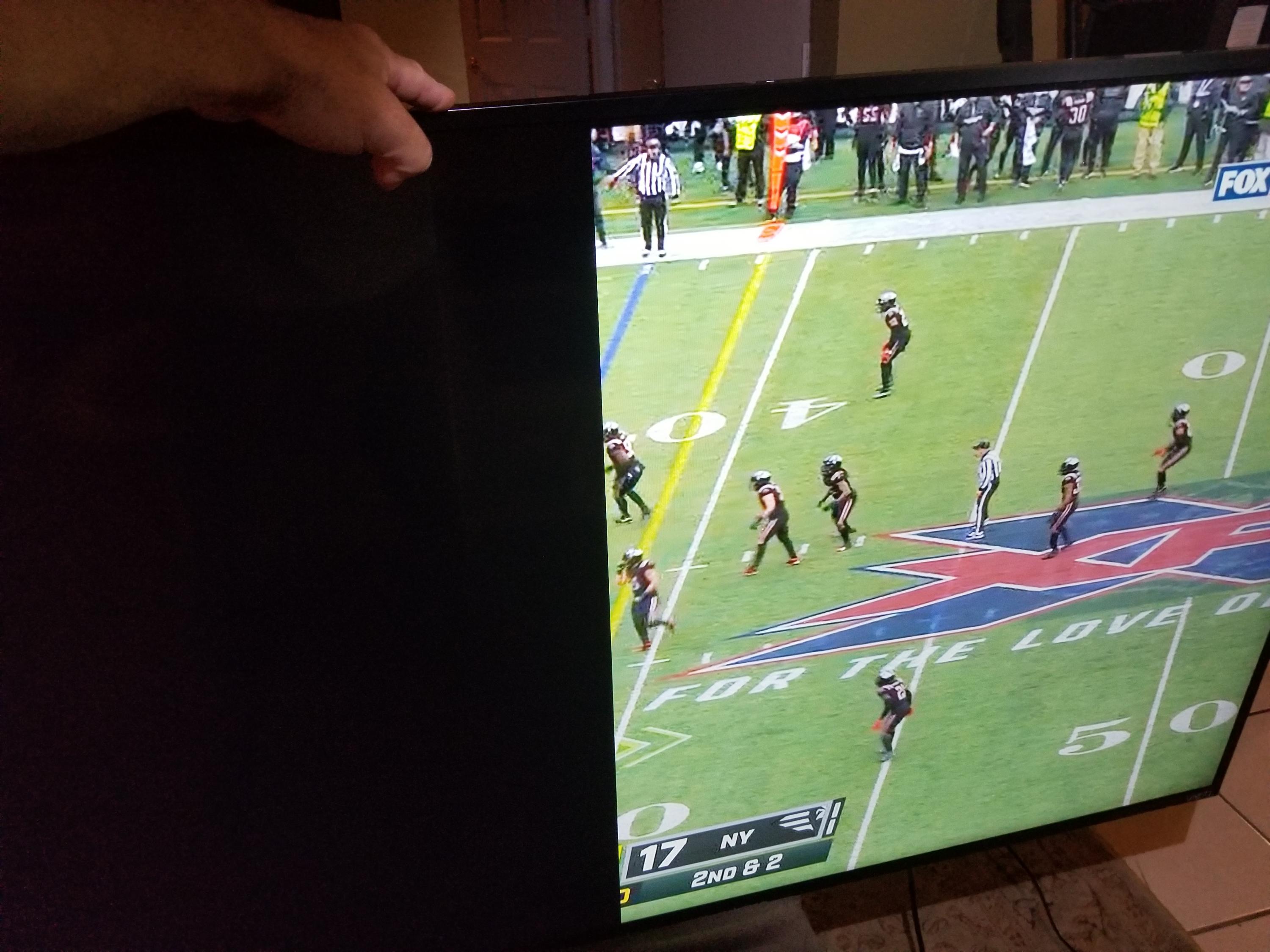

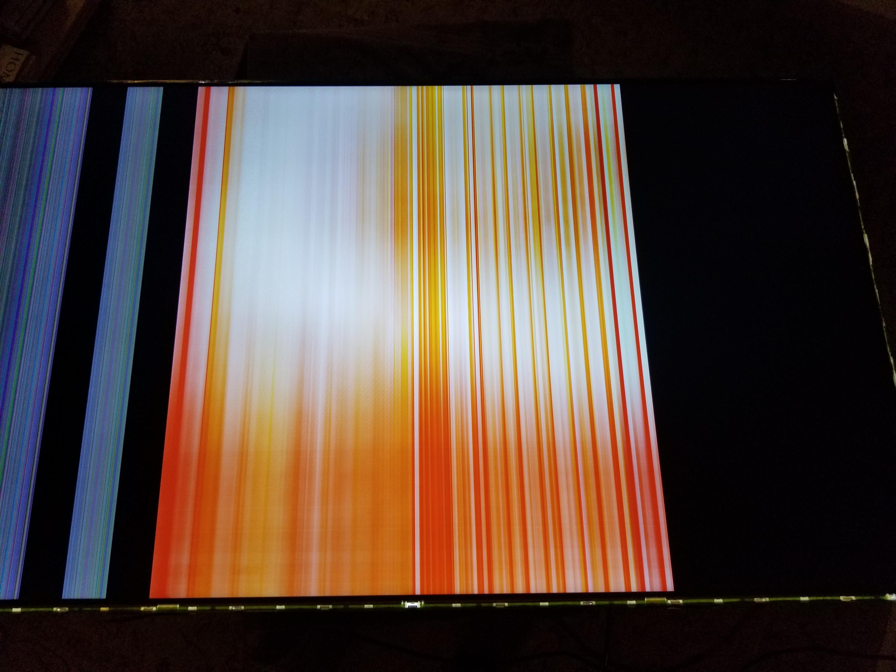

                                  In order:
                                  Everything connected
                                  Left side "U" disconnected (that is a dark spot on the right side)
                                  Right side "U" disconnected (can't catch it but left side is flickering)
                                  Both "U"s disconnected
                                  • budwich
                                    • Jul 2015
                                    • 3097
                                    #37
                                    Re: Vizio M60-C3
                                    ok.... couple of points. you will never get a "good" picture with both "U" cables disconnected. This is because no signal can make it to either side because there is no electrical connection to drive the horizontals.
                                    the second picture show more than a half a picture which is expected because roughly 1/4 of the bottom panel is now disconnected with the "u" disconnected. That same picture appears to show vertical lines on 1/4 of the half of the screen that has been "modified" (some form of disconnected). That is not good. That likely indicates a problem with a panel tab at the bottom, in or near that area. You might try lightly touching the tabs in that area to see if you can cause those lines to disappear / change.
                                    At this point, it is not looking good but some people have had significant side tab issues causing issues with vertical lines also so they may be a small sign of hope.
                                    Have you checked the side tabs yet?
