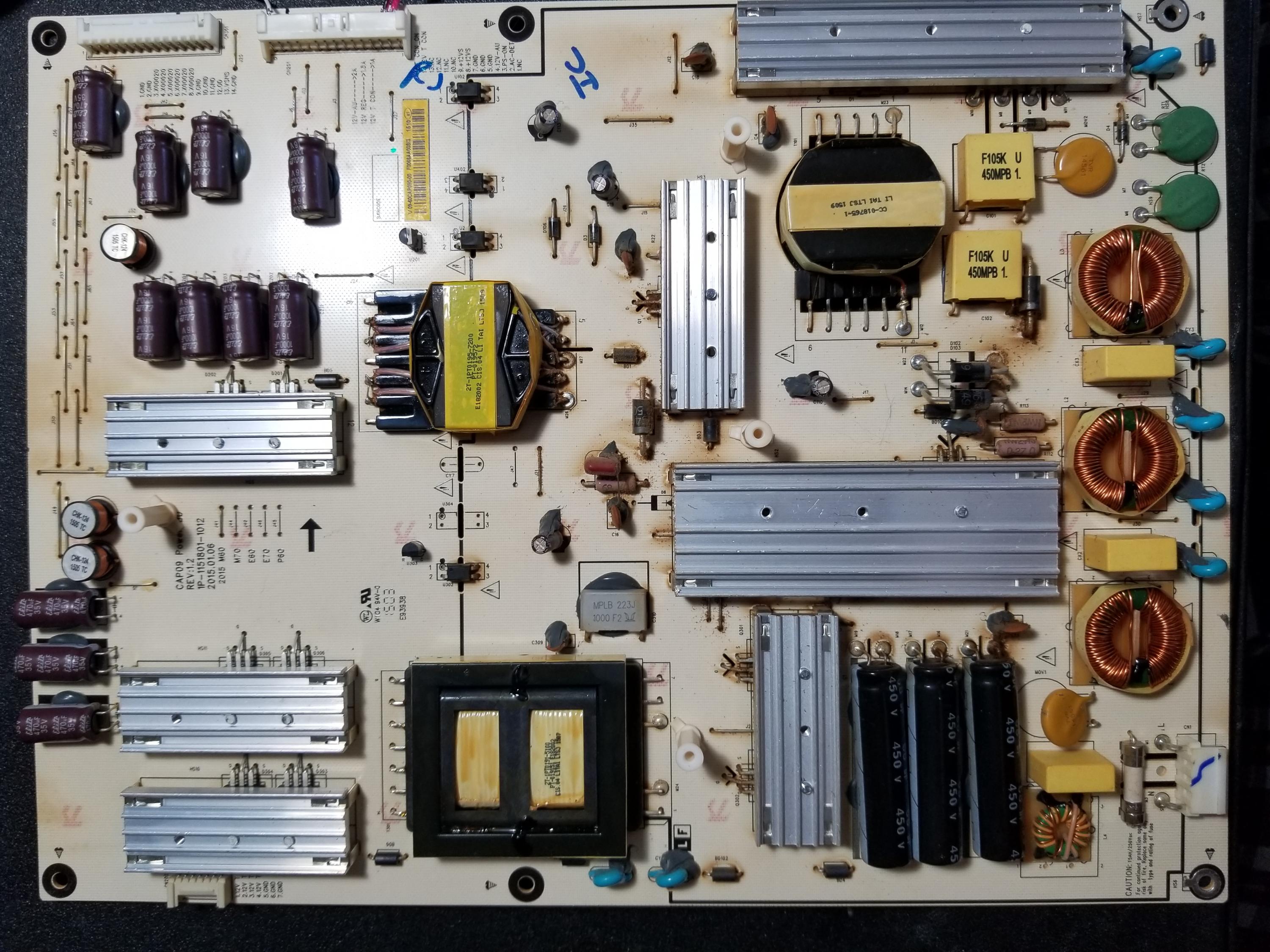

    Looks like there's multiple problems with this one, but I need help figuring out something on the PS. When I force it on, I get all voltages good, except the 24v that goes to LED driver board is fluctuating all over the place from 16-24v and everywhere in between. It's not connected to the LED driver board.
    (I have 2 diodes unsoldered as I was testing)

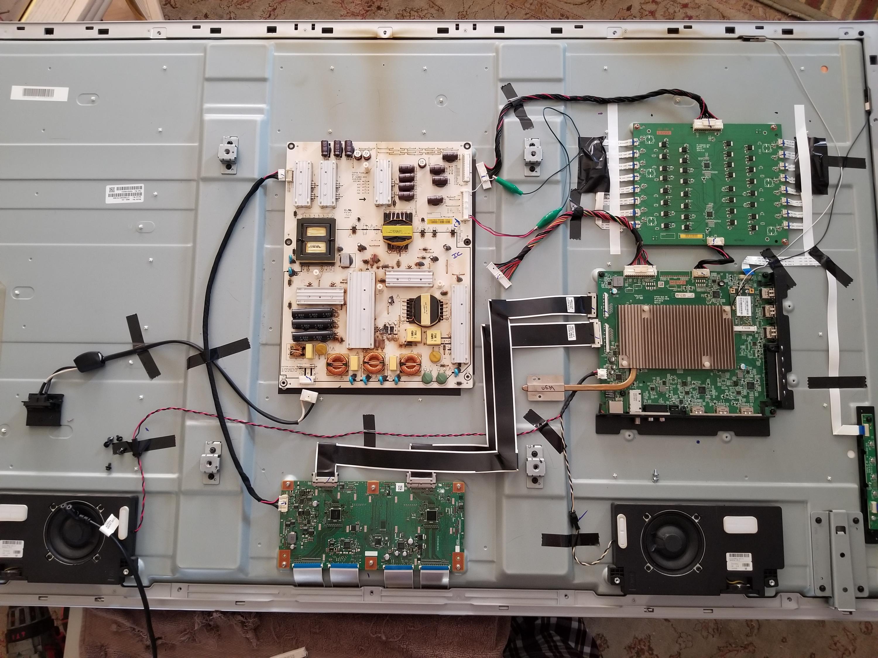

      I'm really confused with this one because I thought it was the main board after testing the other 12v voltages were ok. When plugging in main board the 12v turns to 4v PS-ON is always on. So I bought a new main board and same thing. And then the 12v going to the t-con is causing that line to fluctuate when connected to the t-con but OK when not. It appears someone put in the wrong t-con for this panel.

                                  That's what it should be in standby, and when the PS-ON is changed to a High, the pfc should start and the voltage should be a solid 360vdc.
                                  The other thing I might try is connect the main board, then check the voltages on CN201. Something must be different when the main board is connected to tell the pfc to operate at full voltage.

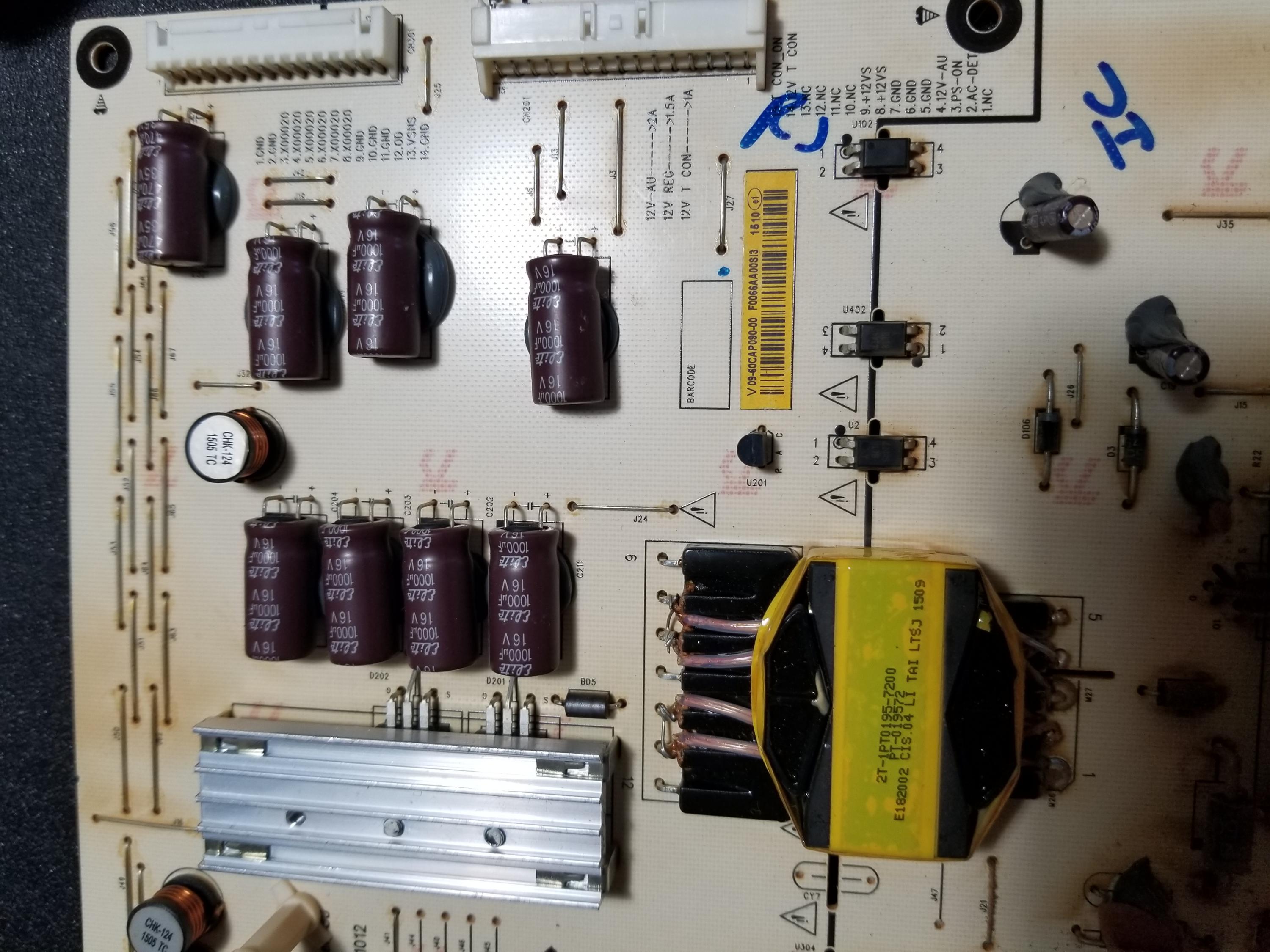

                                  I just had a closer look at your board picture (#3) and C202, C203, C204 & C211 look slightly bulged, or is that just the way they look in the picture?

                                      If C202, C203, C204 & C211 are bad, that could explain the low +12VS

                                        Wow I never noticed those caps bulging, or to be honest don't expect to find bad caps in a "newer" tv. Replaced those 4 and the other 3 470uF 35v caps for the LEDs and plugged it all back in and it came on! I still have to figure out the T-Con situation, but thanks R_J!
                                        Do you think just those caps would cause all of that?!?
