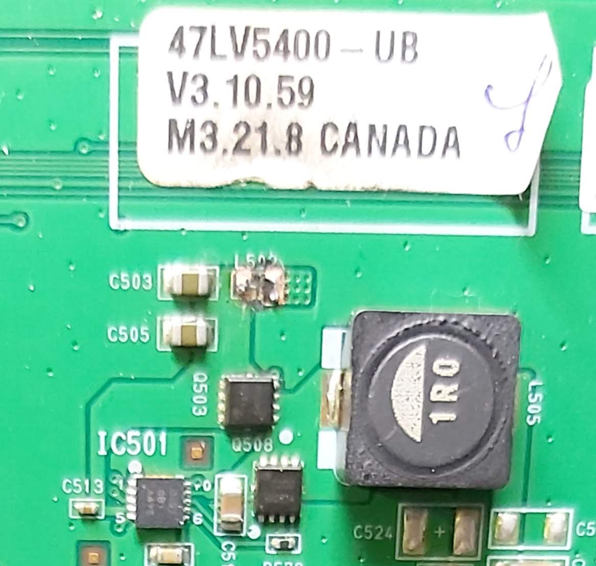

    I'm not ready to troubleshoot this board yet because there is a visible component failure. L502 blew! Can anyone tell me the value of this inductor? I tried reaching out to the folks who sell the repair kits for this board and they said that component is not a common failure item.

    I don't think it's value is too critical, but I'd suspect something else maybe shorted, like the mosfet(s) below it.

      Correct. I don't think that coil is faulty either. Only if it is interrupted. The defect is elsewhere.

        ummm look closely at the image. The choke is not there. It disintegrated! If you have a schematic and/or could tell me the value of the choke it would be helpful. If you have the part/no for the mosfet maybe I can check that it is not shorted.

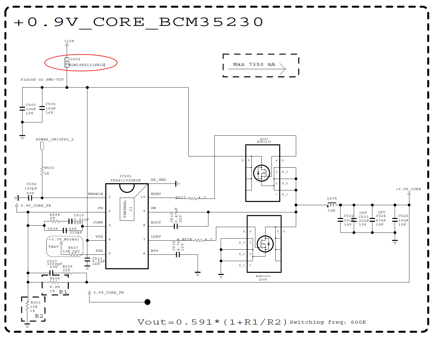

          Looks like the 42LV770s uses the same components for the 0.9v power. I think that L502 is a BLM18PG121SN1D. As others said, that's probably not your only problem.
          Edit: added a SM that may help

              Thanks for the info Will62! I saw your reply this afternoon and couldn't wait to get home to give it a go. I tore into it and removed the caps. Still shorted! Damn. I immediately felt sad. Next, I cut the trace leading to IC501. Still Shorted. Removed, Q503 and of course no more short. I will try Digikey and Mouser unless anyone has a better suggestion. I'll order a couple of each just in case. Any other suggestions appreciated.

                Shorts between what?
                So the high side MOSFET Q503 is shorted between S and D, but was there shorts between GROUND and the output side of the L502?
                MOSFET Q503 is on the high side, if it shorted out it will not cause you to see short circuit between GROUND and the output side of L502.
                Check the resistance between Ground and L505 to see what you get.

                  If removing Q503, removed the short from L502, and Q503 was shorted, you will likely also have Q508 shorted as it's Source connects to ground, Also check R577 & R578, if either one is open, IC501 may be damaged. I would also check from L505 to ground to make sure there is no short on that +0.9V_core line.

                      Looking at the schematic, How could you have a short from gate to ground within Q503? Q503 drain or source does not connect to ground.

                          ok, so Q503 must have ALL pins shorted, gate to source and drain.

                                  That is not how it works in this case, it does not mean you will see 0.12 Ohms at the output because the loads not resistive loads, if your meter shows < an Ohm right now you have right now it means you have short circuit. The loads in this case are active loads, I.E. Transistors, IC's, not constant loads so some of the loads may not come into play until they are turned on (or bias on). Those loads will not be able to be turned on by your Ohm meter so the resistance reading should be in K Ohms range at the output of that power supply.
                                  You need to check that lower MOSFET Q508 to see if it is shorted or not by removing L505 to isolate the loads from that Half bridge drive MOSFET's. The MLC caps on the output can also be shorted too if the lower MOSFET tested OK.
