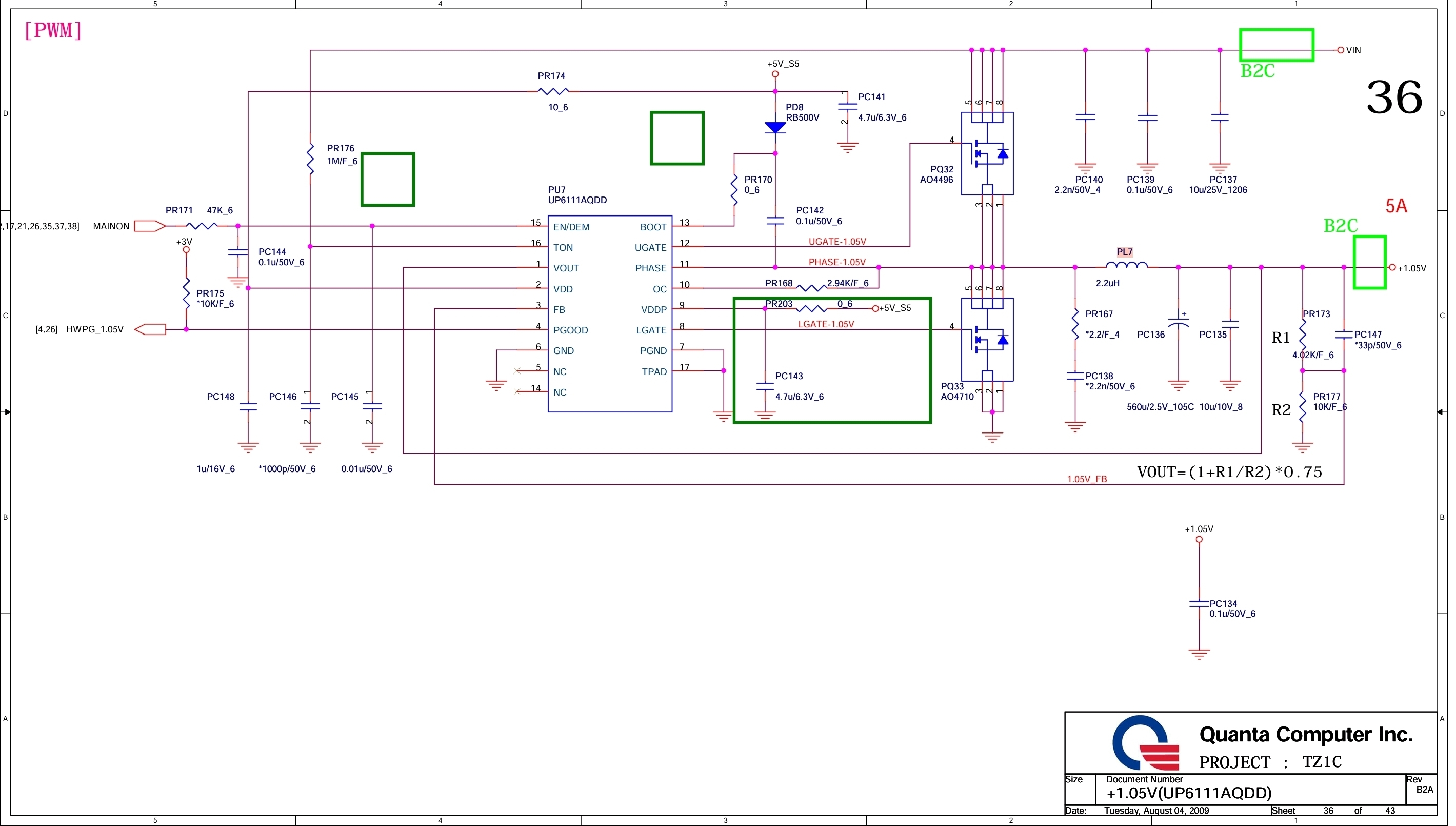

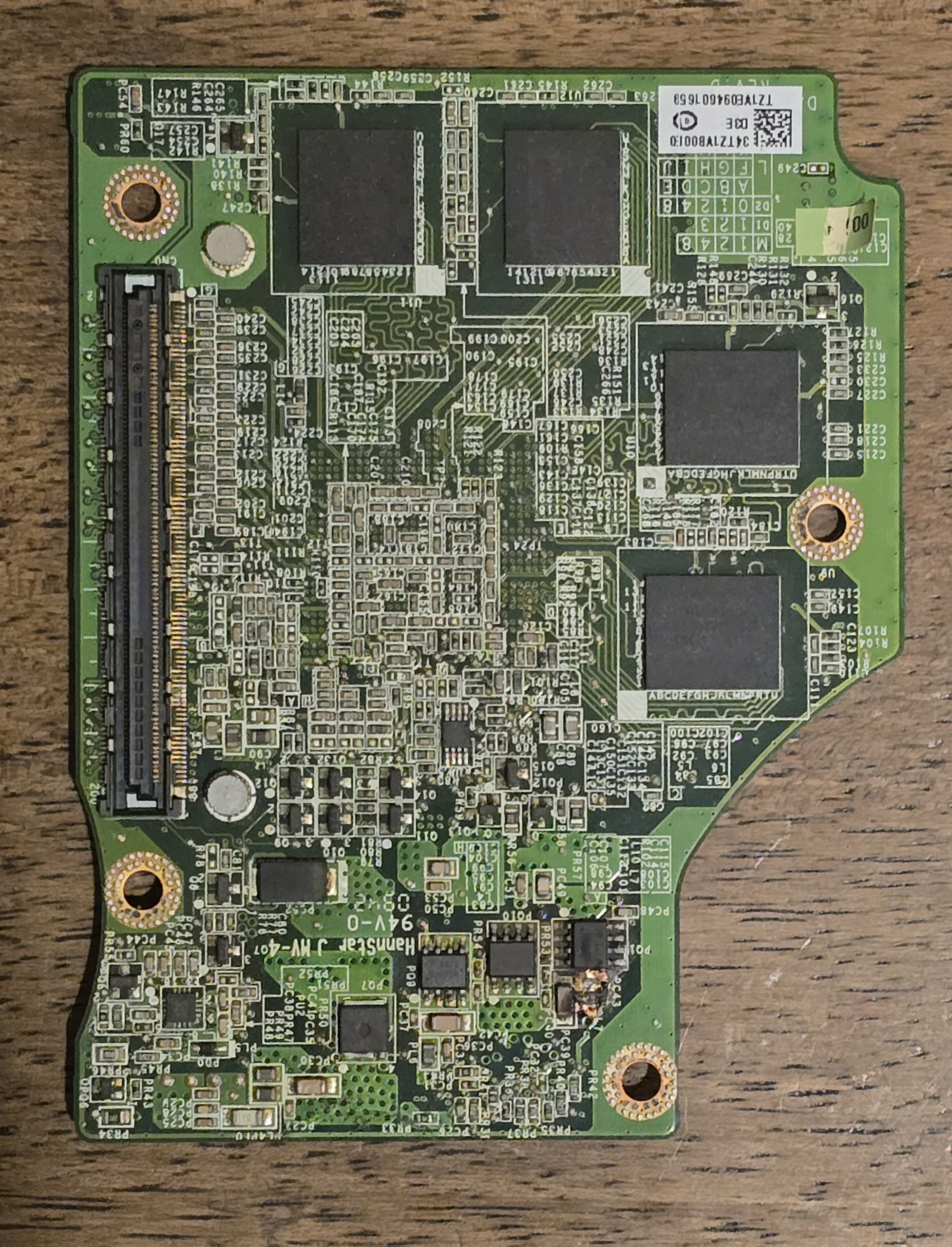

    I am looking for capacitor & Inductor values for my TOSHIBA Qosmio X500-110 - mobile graphics - Nvidia GTS 250M Laptop.
    Values for :-
    PC43 : Capacitor [3x1.5mm]
    PL7 : Inductor [2x1mm]
    PC39 : Capacitor [1x0.5mm]
    Any ideas would be appreciated.

    I can get Capacitor values from nearby components but wanted to know the max ratings also I dont have equipment to measure inductors.
  • rashidjafar
    • Jul 2025
    • 5
    • United Arab Emirates
    I somehow arranged a schematic.
    Now for PL7, It shows 2.2uH & looks like 0805 package. But when ordering they asking further details like Max DC Current rating & Max DC resistance.
    Can some one guide me please
